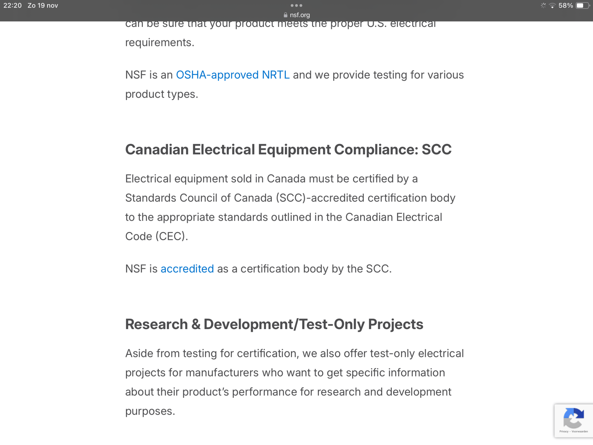

^ Perhaps you are trying to inform politely, but it is simply a communication style or a language difference. However, I'd suggest if you continue to post that you try a change in tone.
If I may...
Are you trying to say something like below?
In my experience and to the best of my knowledge all consumer electronics are required to carry a label on the product noting specific information with regards to the regulations set forth under the Radiocommunication Act (R.S.C., 1985, c. R-2)
I've noted Canadian legislation, but these labels and similar may required for sale or import of certain electronics devices into (country) ...
Then... people with knowledge can openly discuss whether or not that labeling is necessary and/or and any regulatory requirements around the legislation. Tom could certainly have the opportunity to weigh in or not.
In my opinion, one should not assume (and I don't think you are assuming this) that a label indicates compliance or conversely that compliance always requires a label.
That takes a lot longer to type, but I hope it is an example of how a polite discussion may be started vs. implying or openly stating ignorance or violations.
For my own part, I have no idea whatsofrickingever whether that legislation / regulation applies to this product or not... it is just an example of how I might go about asking a question. If I had a similar question of my own, I'd probably ask the most relevant person via PM vs. starting an open debate in a forum.
  • Thank You

@Koifarm - I think we all agree that it can be difficult to discuss. It is always best to post actual links if practical to ensure context.
FWIW + a bag of ketchup chips, I am inclined to think that some labeling and certification is appropriate for the sale of a completed electrical product in Canada. With that said, I haven't looked at the web page advertising the product nor have I looked at a completed product. So, I am content to say... I don't know. I have supported the compliance for electrical products imported into, sold in, and manufactured in Canada, but my thoughts are irrelevant.
I have seen Tom specifically share what he's done to ensure compliance.
However, that is best left to Tom and his team. If you have concerns re: specifics or even some kind advice for Tom, I've found him an absolute delight. He likely would take any serious advice under consideration and act accordingly based on his extensive knowledge.
Here is what the Canadian government advises consumers... from this site.
https://www.canada.ca/en/health-canada/services/home-safety/electrical-products.html
Electrical products that plug into an electrical outlet must meet Canadian national safety standards and be certified by an accredited certification body.
Always check for certification marks, such as CSA, cUL, or cETL, before purchasing electrical products that plug into an electrical outlet. These marks indicate that the products are assessed and conform to the required Canadian national safety standard.
Do not buy or use electrical products that plug into an electrical outlet without a certification mark.
I'll allow others to continue the conversation, but I hope it is polite, and we can all learn.

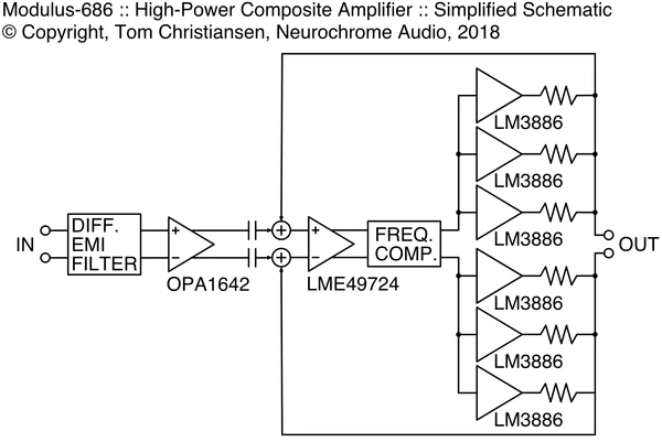

@TioFrancotirador
What do you mean by “SE output connected to Modulus-686?” Why do I ask? The 686 is inherently a balanced bridged output. Both terminals have voltage on them during regular operation. It is not like an SE output where one terminal is held at ground potential, while the other terminal has an output voltage such as his Modulus-86, and 286 designs.
So to answer your question, there is no “half of amp is working” issue on the 686.
And before there is a misunderstanding, one very important consideration is noted in the 686 design document:
Do not connect any of the speaker output terminals to ground. The Modulus-686 is a BTL design, hence both output terminals will provide output voltage.
This is an important point. There are many plate amps for subwoofers (particularly modern Class D) that have an option to use speaker input terminals. They expect to derive their input voltage from an amplifier ‘source’ that has an SE output. If you connect the Modulus 686 bridged balanced speaker output to these types of plate amps, you will/can damage the plate amp.
Best,
Anand.

@tomchr
"Do not connect any of the speaker output terminals to ground. The Modulus-686 is a BTL design, hence both output terminals will provide output voltage."
I understand that this is regardless of source connected to Modulus-686. Be it either: SE (+/G) through pseudo differential XLR cable, where (-) is connected to Ground or true balanced signal +/G/- through differential XLR cable?
@tomchr
That's correct. The output topology of the Modulus 686 amplifier which is a bridged output has no relationship with the input (with regards to the discussion here). The input (to make it easy) is entirely addressed by the circuitry surrounding the OPA 1642 input stage, i.e. it handles the input signal whether it is a pure differential/balanced signal or a single ended one. This is one of the advantages of this type of circuit. Gain also remains the same for both RCA or XLR inputs at either 26 dB (stock) or 20 dB (adjustable by removing a resistor at build/order time).
Best,
Anand.
