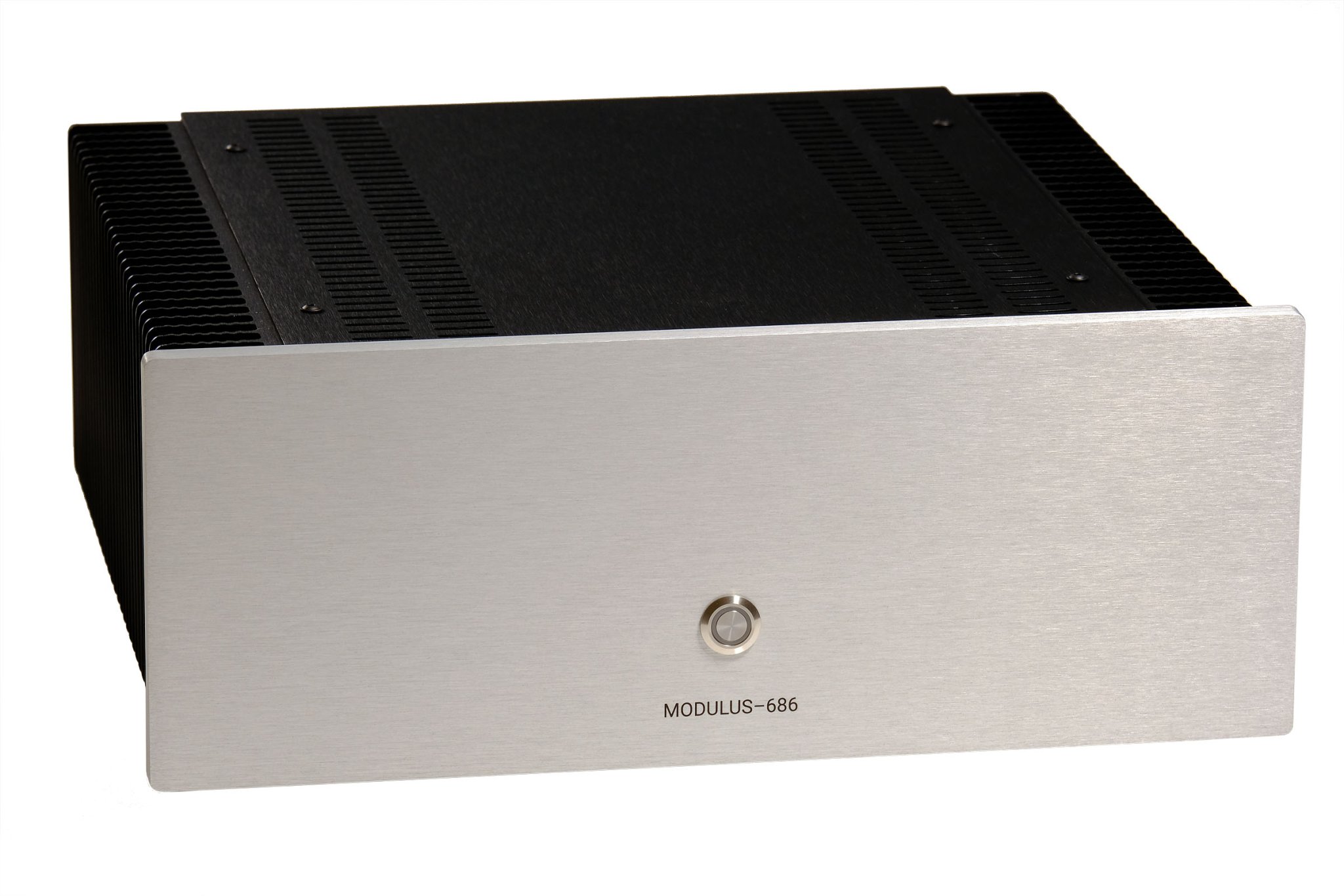

I'm building a short stack of three Modulus-686 in the Safe-n-Sane configuration. 125 W into 8 Ω, 200 W into 4 Ω. 340 x 330 x 150 mm (WxDxH), 6 kg.
Two of them I'll sell. One has sold already. The last one I'll keep.

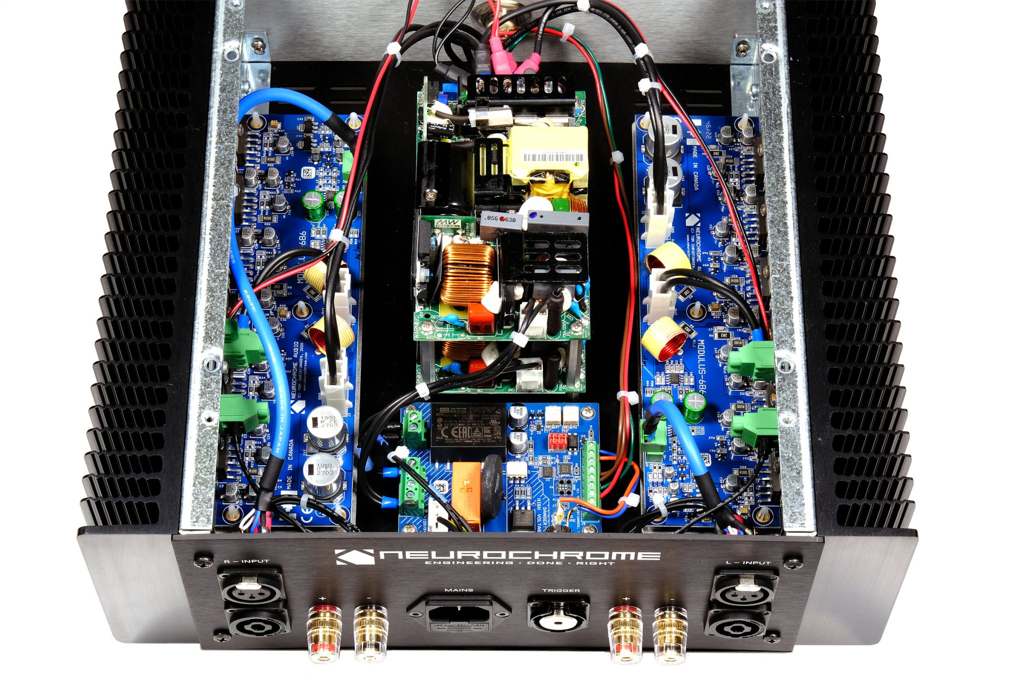

Very nice, you never get tired of seeing cool gear like this. Are those the Mean Well RPS-400-27-C PSU's without cages? And is not having the cages any disadvantage at all? Aesthetically I like them, but you can see the benefit this setup has without the cages with regard to layout and available space.

Yep. Those are indeed RPS-400-27. Not the -C (caged) version. The purpose of the cage is to prevent fingers and other objects from getting at the high voltage. It doesn't do anything electrically.Are those the Mean Well RPS-400-27-C PSU's without cages?
In my first Safe-n-Sane build I used the caged version and mounted them vertically. The cage has a couple of PEM nuts for this. I did ask Mean Well if this was the intended mounting method. They hemmed and hawed and gave a wishy-washy answer that wasn't exactly a no. So I went ahead and tried it. Those were the amps I had with me to Burning Amp 2018.
Unfortunately the amps got banged around enough on my return flight (and also in transit to customers) that the cages on the power supplies got bent. This meant the supplies were wiggling a bit inside the chassis. In most cases this was solved by tightening the screws. In one case, the customer had to open the amp and bend the cage back into its original shape. There was no damage to the electronics, but obviously this is not the high-end experience I aim to deliver. So I had to find another solution.
In this build I stacked the two supplies using threaded standoffs. I got the 6 mm hex version for rigidity. Those supplies aren't going anywhere.
The power to the supplies is controlled by an ISS. Mike also requested speaker protection, so I added the Guardian-86 (Rev. 2). 'Tis a nice amp.

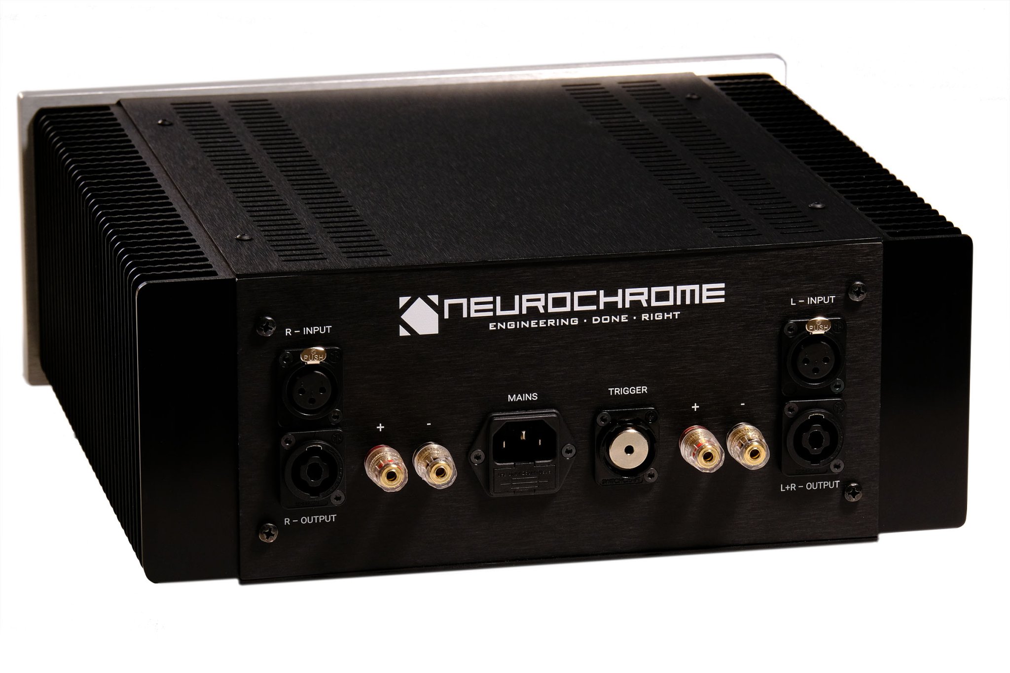

Well. That's your opinion. Which you are entitled to. I use an industry-standard connector. Ain't broken so I won't fix it.

No problem just my 2 cents. If you have no powercon in pro audio equipment you do not sell any products.
You wil see in a view years all the better consumer products will also have powercon.
Further using big heatsinks as side walls is a nice design option but they radiate a lot of heat back in the housing. So isolating the spare surface inside the housing can prevent that.
If you're willing to pay me to make a custom amp for you I'm happy to include whatever power connector you want as long as it'll fit in the chassis.If you have no powercon in pro audio equipment you do not sell any products.
99% of my customers use my products in residential settings. If I don't have an IEC320-C14 on the chassis I won't sell any amps. Similarly, if I don't have binding posts on the chassis I won't sell any amps. It doesn't matter that the speakON is vastly superior to any binding post. Know your market!
I'm pretty conservative in my heat sink sizing. I ran the amp for about 90 minutes at 2x40 W output (about the worst case for power dissipation in the heat sinks). The heat sinks reached 58 ºC. That's very comfortable for all the components involved. The chassis is well ventilated so the components will last a long time.Further using big heatsinks as side walls is a nice design option but they radiate a lot of heat back in the housing. So isolating the spare surface inside the housing can prevent that.
BTW: Some have expressed concern about the thermal interface added by the mounting bracket/heat spreader. So I measured the temperature of the bracket in the middle between LM3886 #3 and #4 and the temperature of the heat sink at that spot. The difference was 0.8 ºC. Not enough to worry about.
