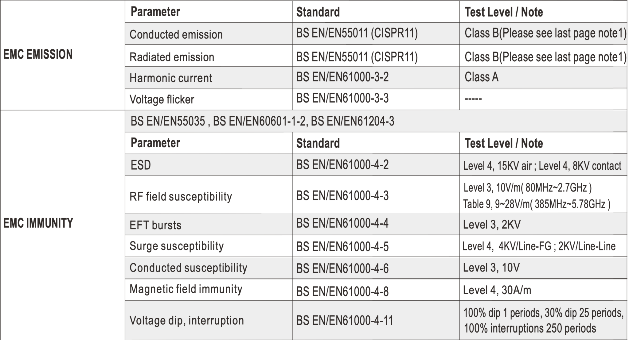

@Koifarm would you care to share an example of a design that you have been solely responsible for from start to finish? Please make sure to share the performance measurements and the reports from the compliance labs.
Anybody can be a keyboard warrior and spread fear, uncertainty, and doubt. It takes skills and persistence to actually accomplish something. What skills do you have? I'm curious.
I have spoken with lawyers in the past regarding my business setup, product liability, and such. None of them have expressed any reservations regarding the legality of what I'm doing. Would you care to share the specific US or Canadian laws that you believe I'm in violation of. Please be specific and keep in mind that defamation is illegal too.
Naturally, I take electrical safety seriously. That's another one of my design constraints: Do not kill the end user. That's in part why I use the Mean Well supplies. Here are the safety standards they comply with:
It is also important to me that my equipment plays well with others. That is in part why I include EMI/RFI filtering on the input of the amp. As for emissions out of the amp, the creator of that would be the Mean Well supplies again. Here are the standards they comply with:
You can find the test reports at the bottom of this page: https://www.meanwell-web.com/en-gb/...cal-power-supply-output-27vdc-rps--400--27--c
Naturally, that doesn't prove that the finished product will pass compliance testing but I certainly give myself the best chance of passing both on electrical safety and on EMC compliance.

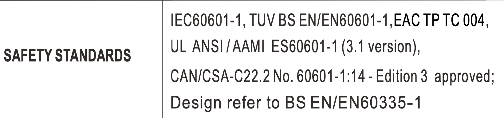

Tom, just using a power supply which is in compliance makes not the complete amplifier legal and in compliance.
I doubt if leaving the cage of the powersupply make them still safe for consumers.
My point is try apply in the future the right safety and compliance certificates. You will see for export every continent/country has his own rules.

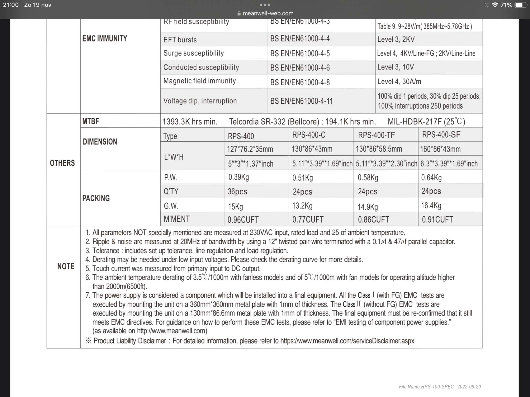

As I mentioned in Post #1567, I used the power supply exactly how it was provided to me by Mean Well. I made NO modifications to it of any kind. The end user will never come into contact with the power supply.

Read note 7 from the meanwell manual and study class 1 and/or class 2 insulation directive.
It,s always in the small letters.
