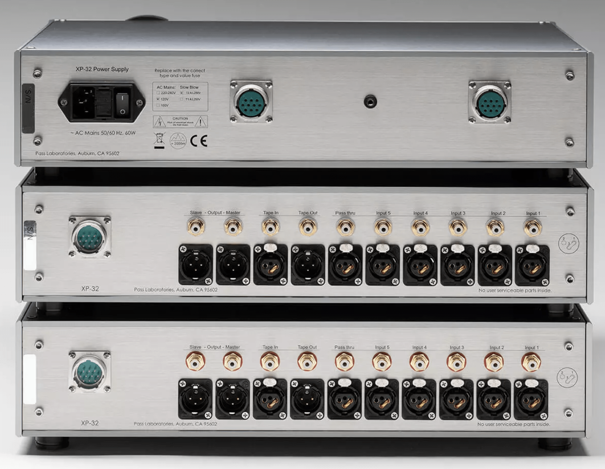

Let’s look at another example. This time from our beloved Nelson Pass. This is his flagship preamp, the XP-32.
You will notice the CE mark but no FCC mark even though the power supply and control unit (top box) clearly contains a display and supports remote control which would require either a micro controller or some digital logic operating at or beyond 9 kHz clock frequency to work and, thereby, require FCC certification. There’s also no mention of which standards the equipment has been certified to, so we are left to guess which EU directives this power supply/controller was tested to. Also note that the equipment is not cUL or CSA marked. Nor is it ISED certified, yet, it is available for purchase in Canada. Go figure…
I’m not here to knock Schiit or Pass. I’m just pointing out that even those who sell hundreds or thousands of products yearly and have been doing so for decades get lost in the standards and marking requirements at times.

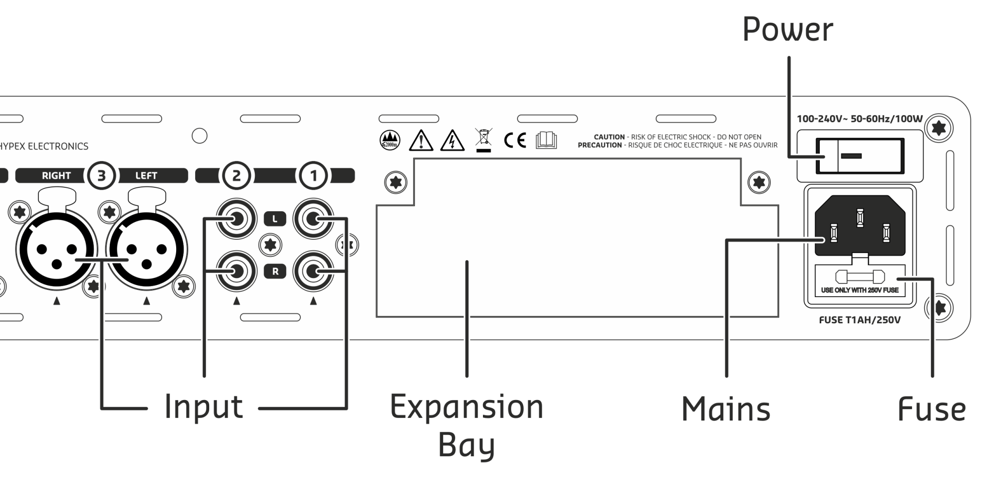

I could do that. For sh!ts & grins here's the rear panel of the Hypex preamp. I grabbed it from the manual but you can just barely see the markings in the official product photos.The idea was mentioned on the last page to sell kits like Hypex does.
Once again we note the CE mark but not much else. Don't throw the product in the trash. Don't electrocute yourself by opening it. Don't use above 2000 m altitude. I think the latter has to do with electrical safety. There're some changes in creepage and isolation distances at higher altitude. I find it ironic that a DIY kit has a warning on the back, "DO NOT OPEN - RISK OF ELECTRIC SHOCK". But maybe that's just me... 🙂
I'm willing to bet money that Hypex self-certifies wrt. electrical safety and EMC. That's a bit risky in my view. After all, they have no control over how the product is assembled. But, hey... It has a CE mark so the customs officers are happy.

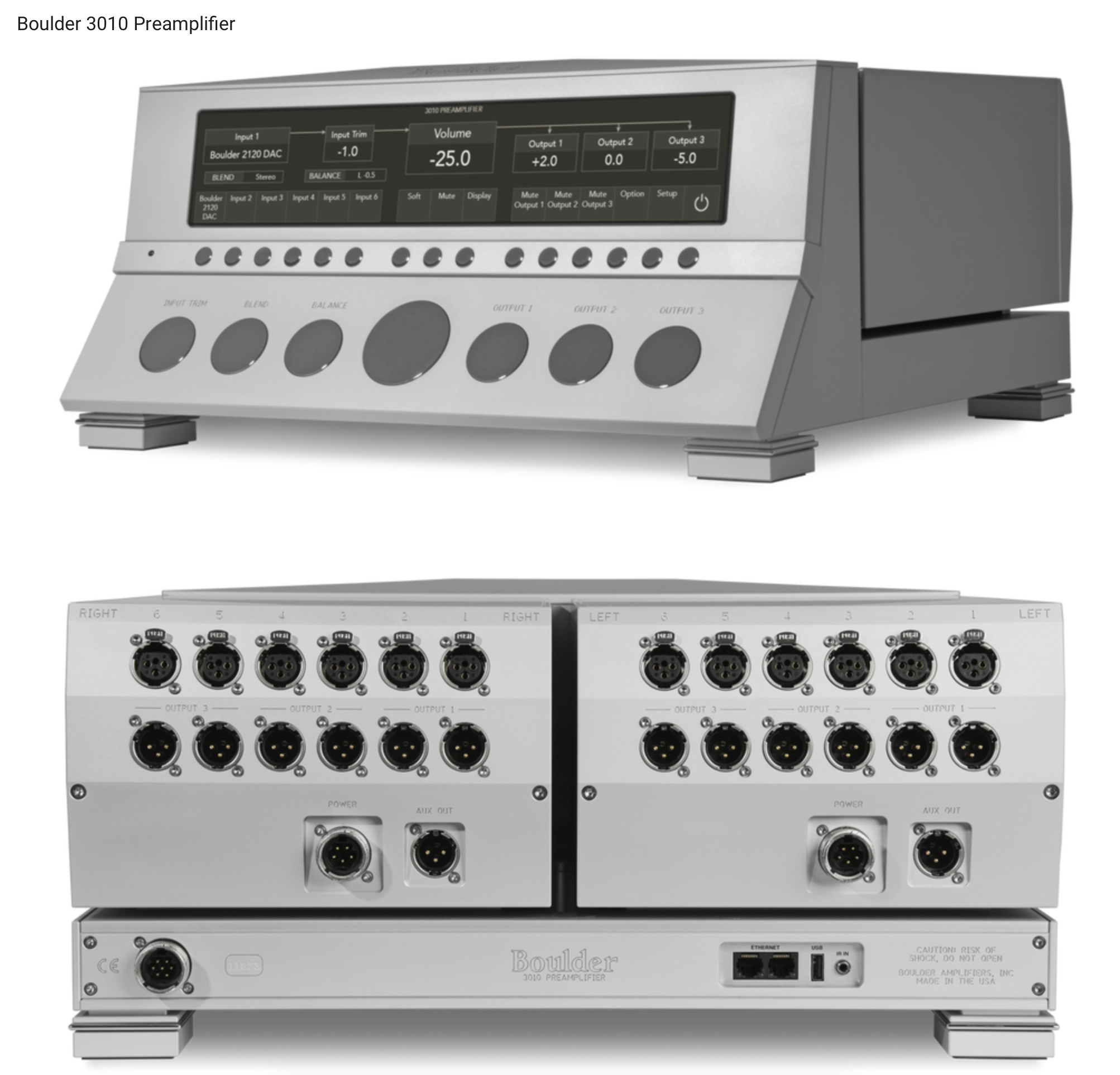

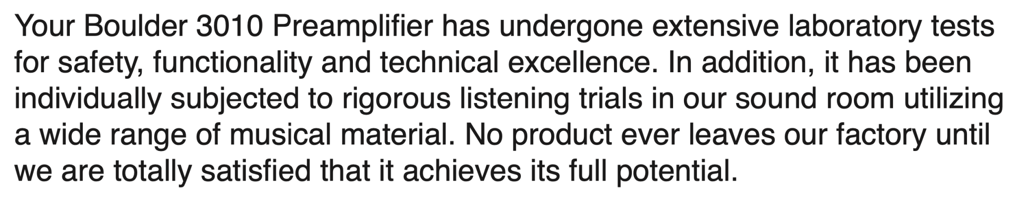

Once you start looking it's remarkable how few products are certified. Here's Boulder's 3010 preamp for example.
It clearly contains some processing power to drive that display. It also features a built-in web server so you can configure it through HTTP. I would be surprised if the micro controller that handles that doesn't contain an oscillator running at or above 9 kHz. And it would need to talk to an ethernet PHY so there's certainly opportunity for emissions. Yet, all it sports is the CE mark. No FCC...
I did check the manual. At it says is:
There is no mention of which standards they've tested to. But ... hey ... it sounds wonderful. That's good...
Am I the only one who's left a bit underwhelmed? This is a $130k preamp for F's sake! One hundred and thirty THOUSAND dollars!! For a preamp. One could buy a house in some parts of North America for that. Or a pretty nice luxury car. Surely they could find a few $k in the budget to get the gear tested ... or do it themselves (as they say they do) and mention the standards in the manual.
