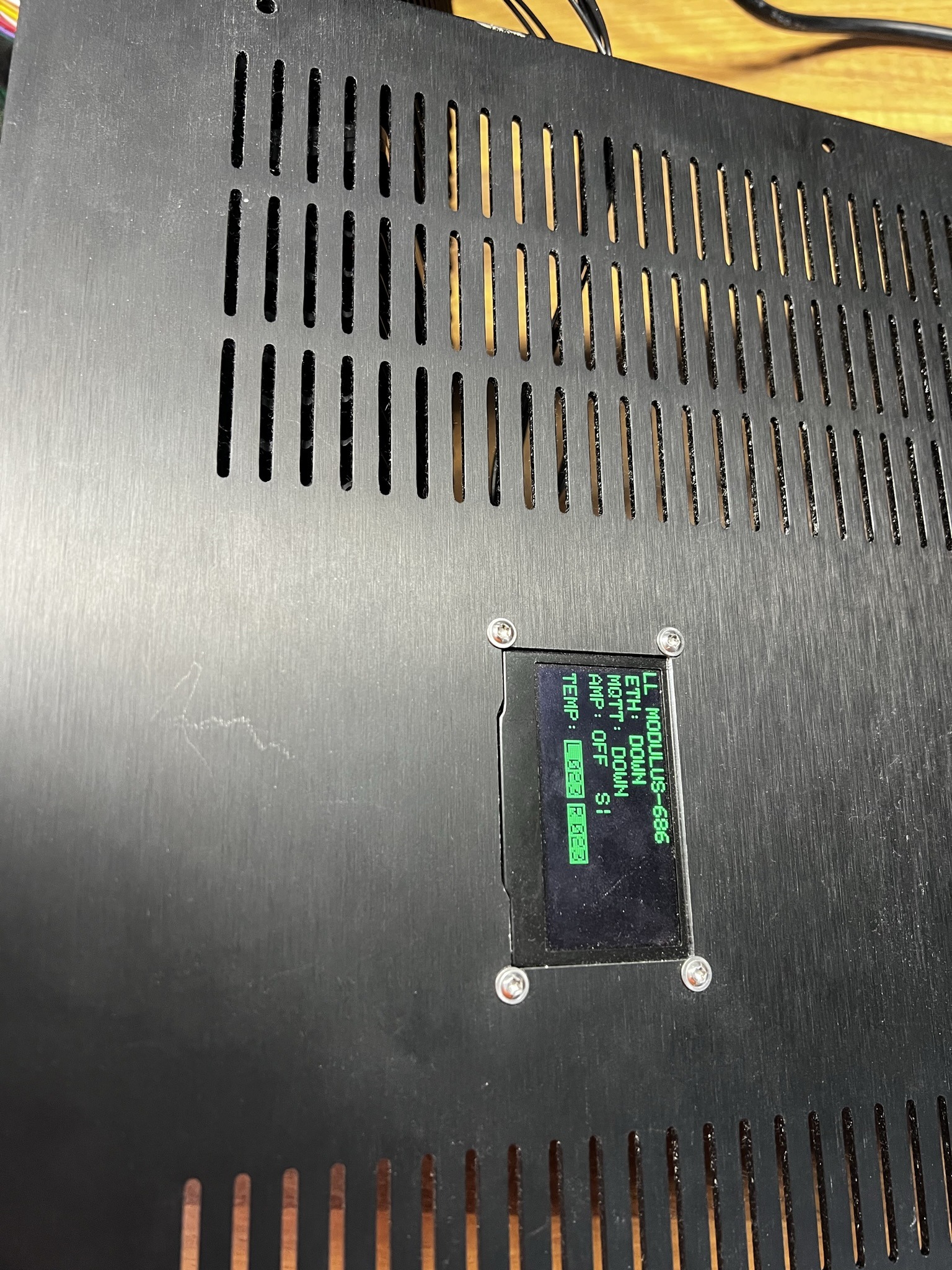

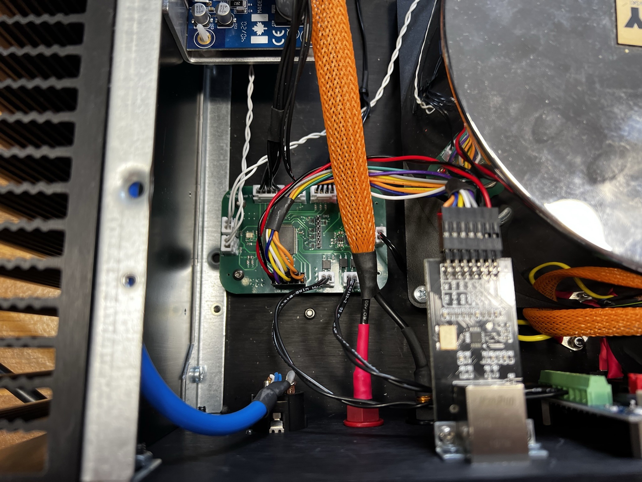

Hi All!,

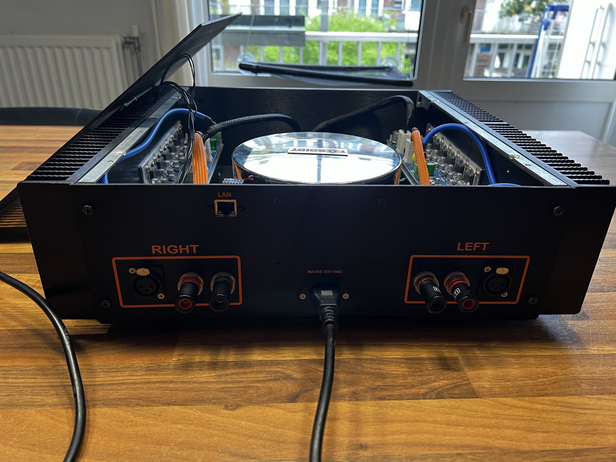

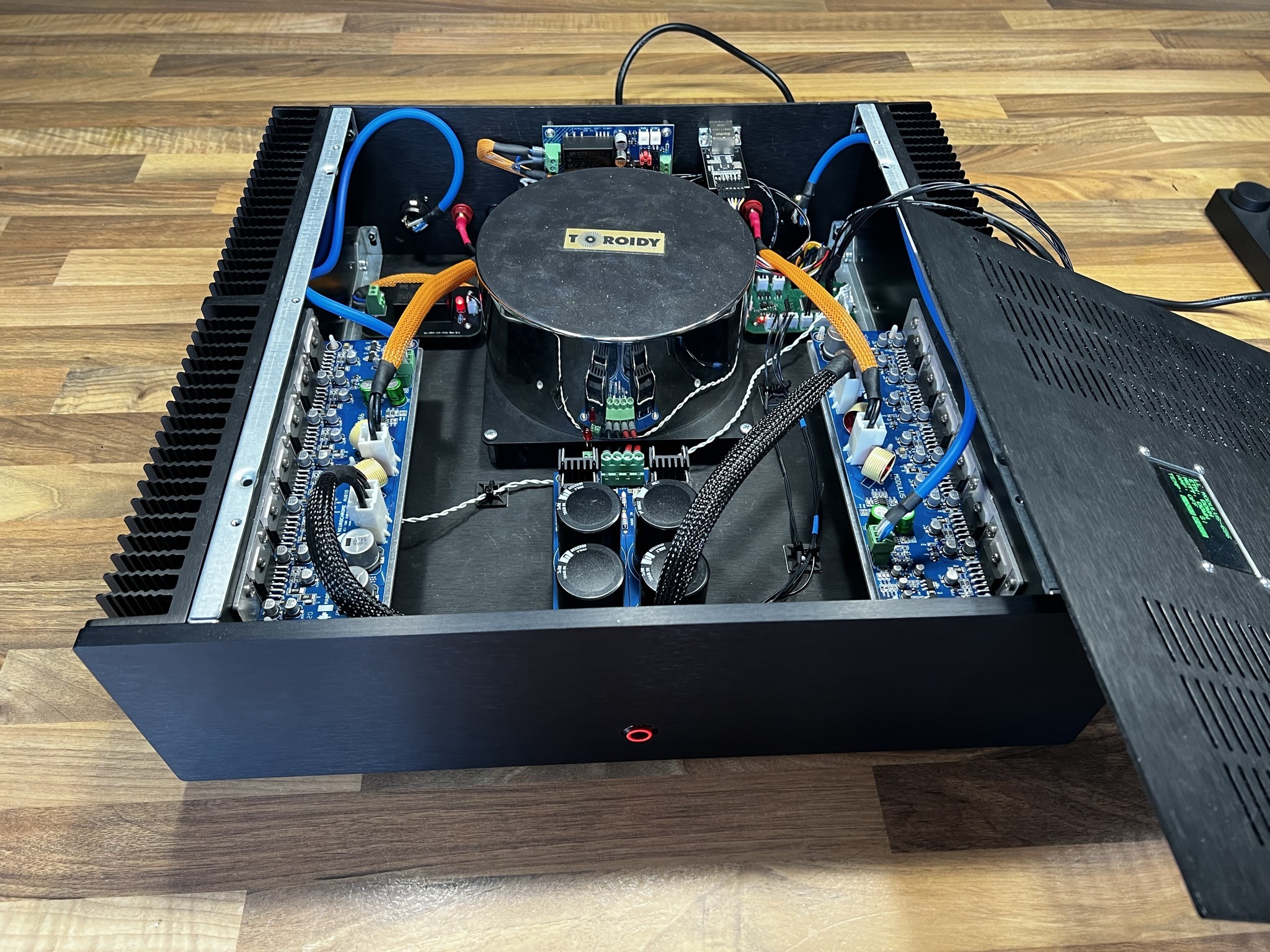

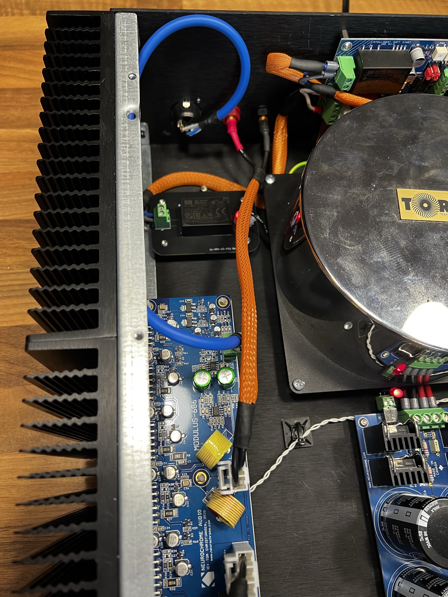

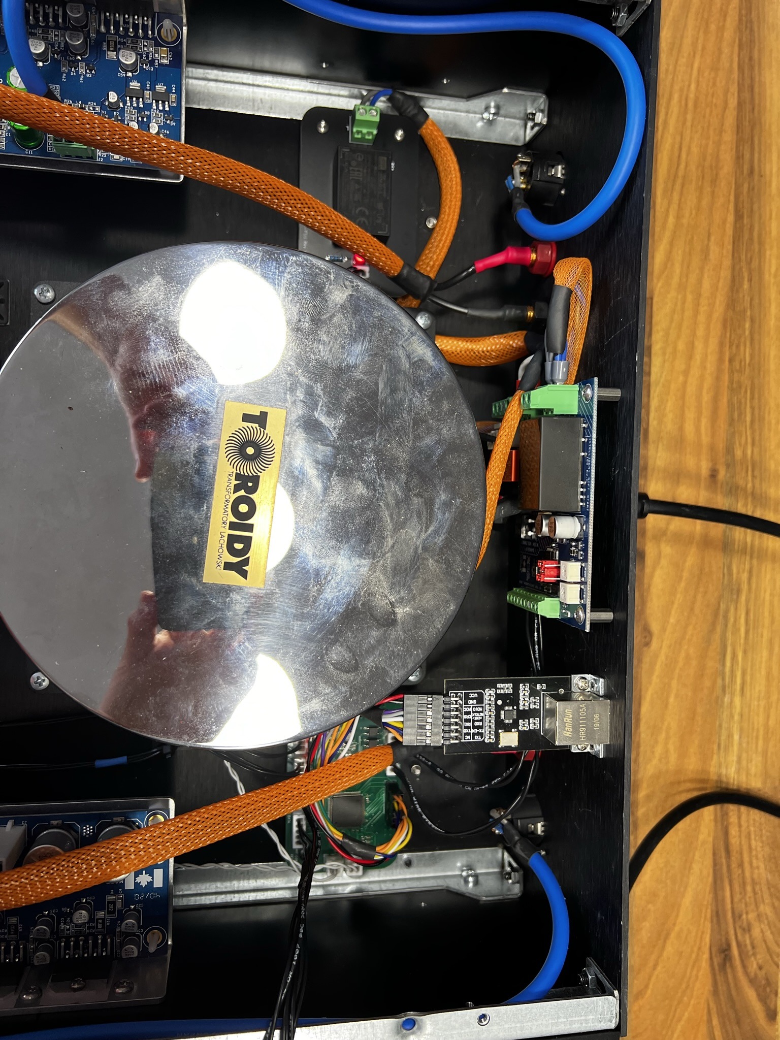

I recently finished my build around Modulus-686, finally after almost 2 years 🙂
I built a stereo version based "Safe-n-Sane" Build as described in Neurochrome website, to have about 100w per channel using 500VA Transformer with 2x22 VAC. The amp is configured to have 20db gain. (lowest setting I believe)
I also built at custom Board with an STM32F4 MCU to be able to control the amplifier via Ethernet and integrate it wit Home-Assistant software via MQTT. I can also monitor the temperatures of the Heatsinks using an NTC.
Main parts used:
2 x Neurochrome Modulus-686
1 x Neurochrome Power-686
1 x Neurochrome Intelligent Soft Start
1 x Toroidy 500VA 2 x 22 VAC SUPREME AUDIO grade transformer (TSAS500VA)
1 x Custom made board with STM32F407VET6 MCU
1 x Modushop Dissipante 3U 400mm
I'm planning to pair it with an Arcam ST60 Digital DAC/Preamp.
So far I'm pretty help with build and all support given by Tom 🙂 I like the sound the a lot, but I'm planning to upgrade my current Monitor Audio Bronze to an LS50 Meta in near future. Maybe if it was now I would chose a smaller Toroidal transformer as this one taking a quite a lot of real state inside the case.
I also had to learn a lot about electronics, MCUs and develop my soldering skills. That's why it took so long!
Now I'm just improving the firmware of the MCU so I can add more functionality and configuration, i.e. the possibility to chose the color when amp on and off (completely useless I know 🙂 )
I'm sharing some photos as well!
Please let know if you have some feedback or suggestions for improvements!
Thanks all and happy builds!!!
Leandro

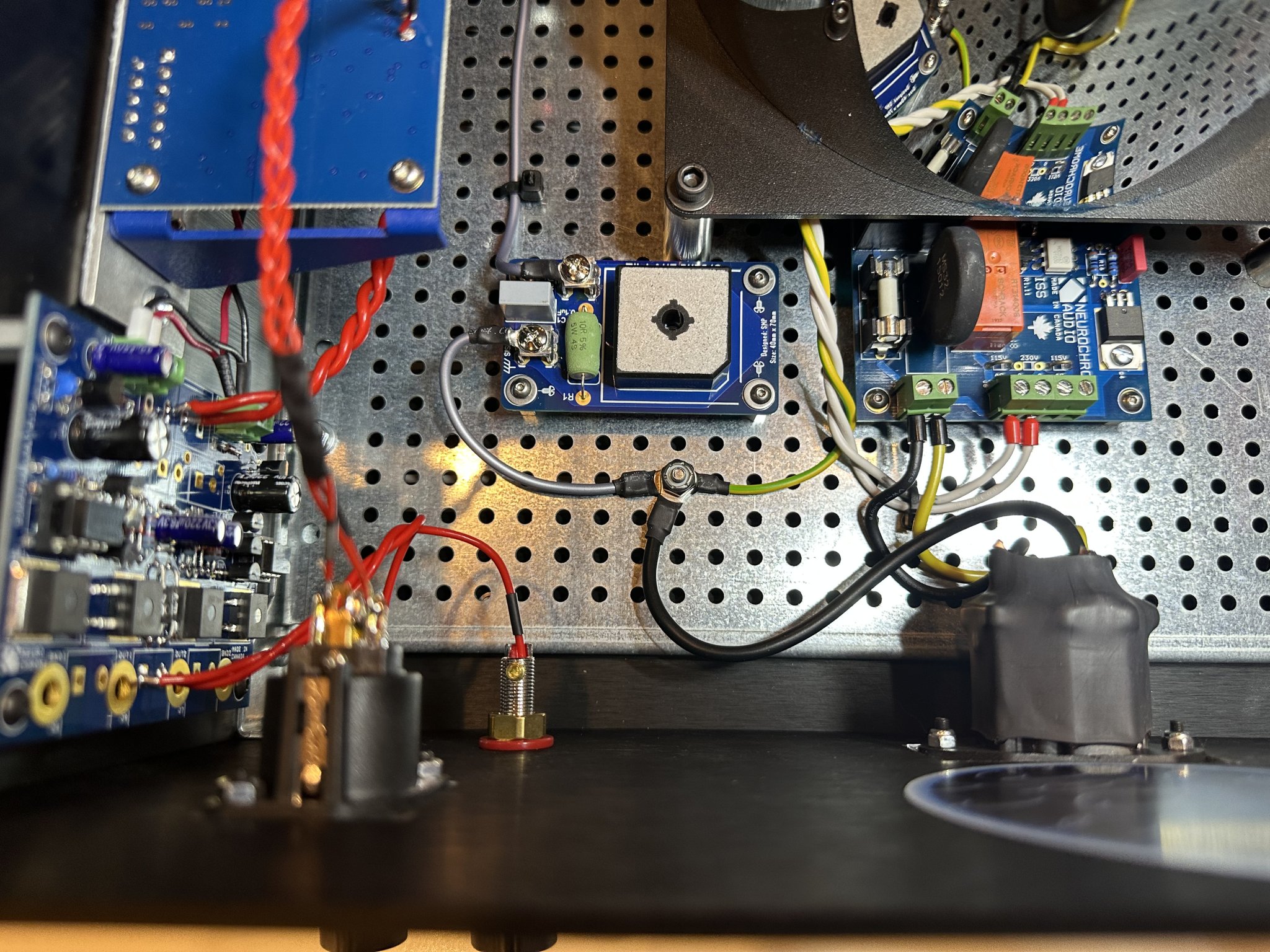

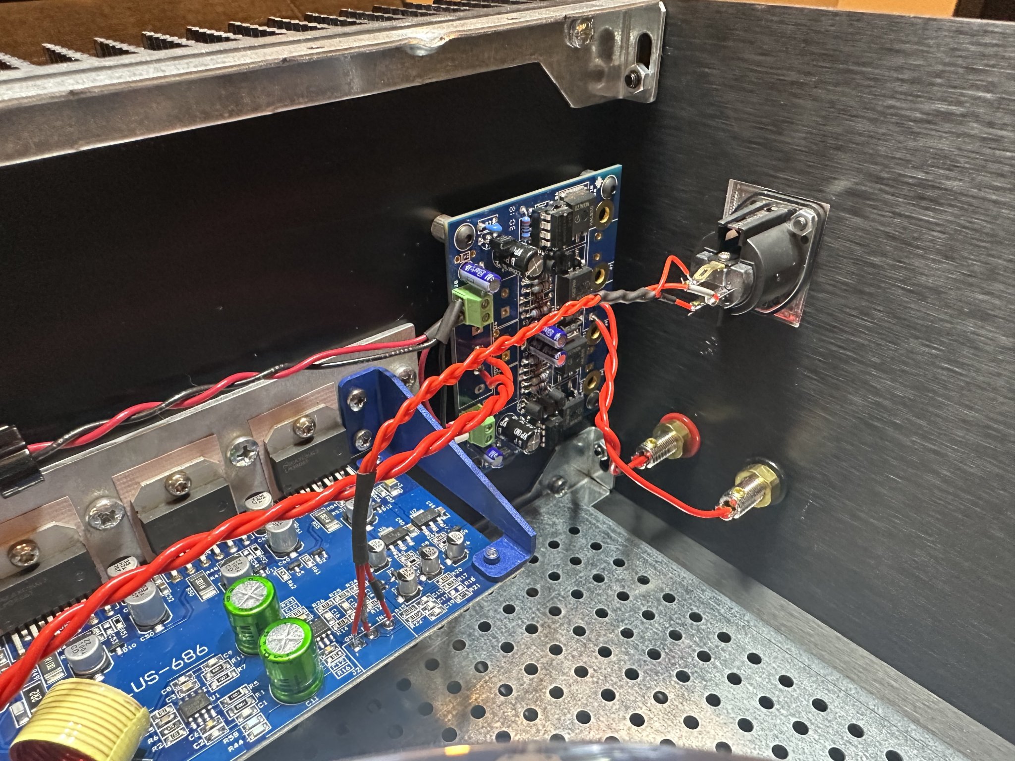

Great looking build! What are the large white connectors on the PCBs? They appear to be mating parts with one connector soldered to the PCB, and the other plug in/pull out. What company and model/series are these?
Thank you!
Not sure exactly what you mean? Which photo?

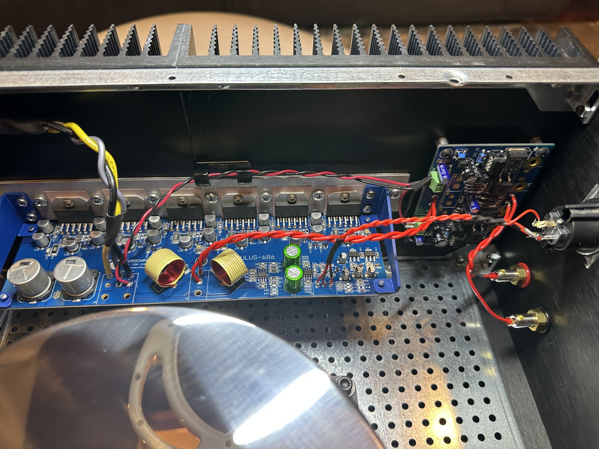

https://neurochrome.com/products/mo...66694&pr_ref_pid=4097695744070&pr_seq=uniformWhat are the large white connectors on the PCBs? They appear to be mating parts with one connector soldered to the PCB, and the other plug in/pull out. What company and model/series are these?
JST VL series

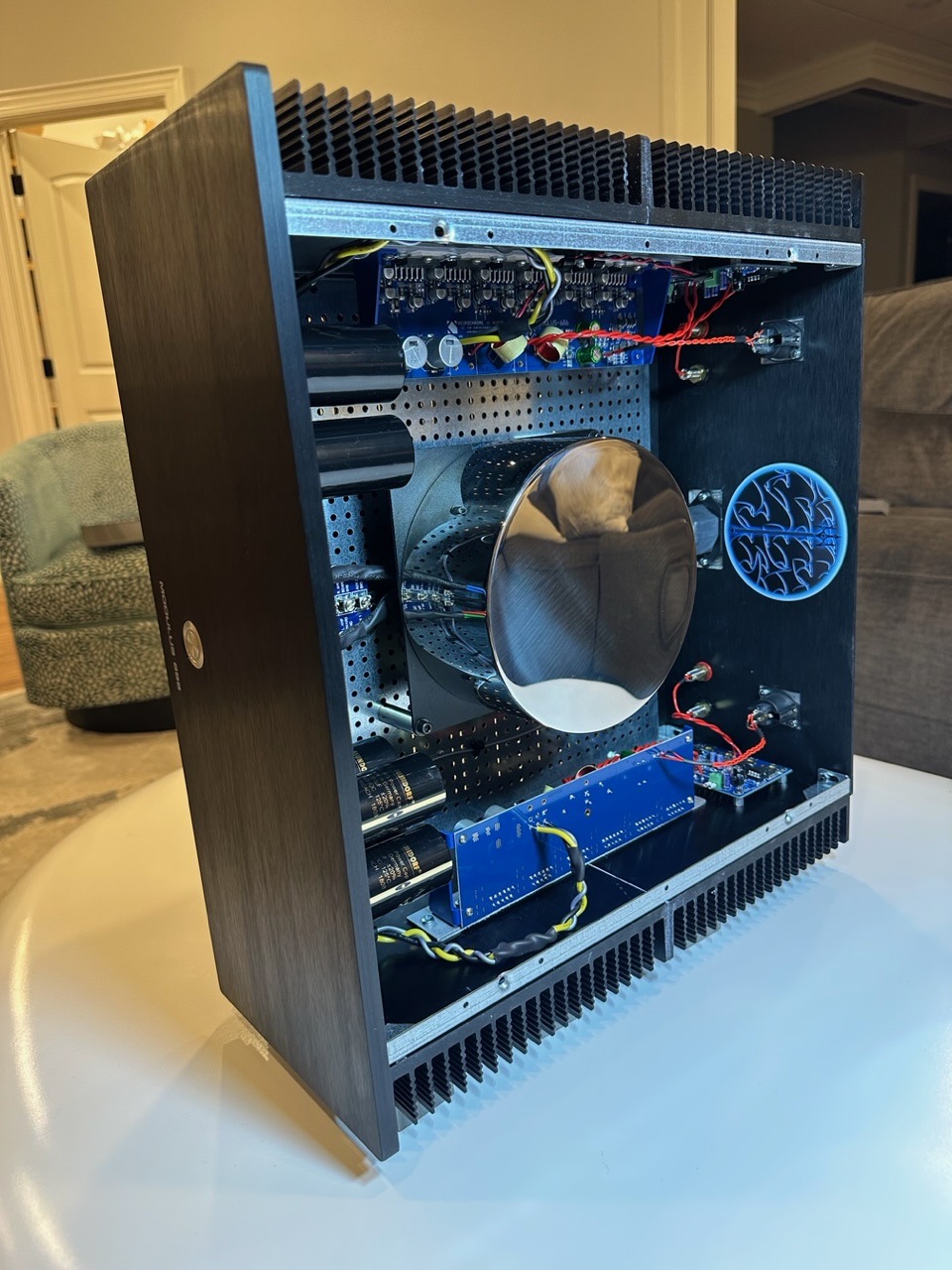

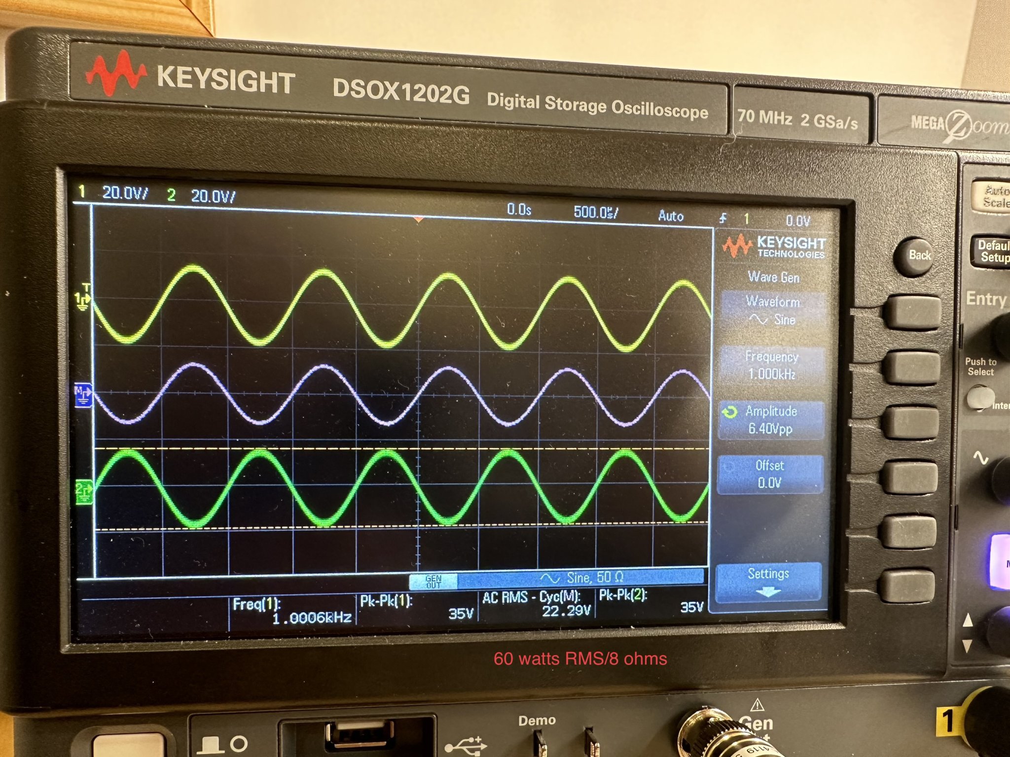

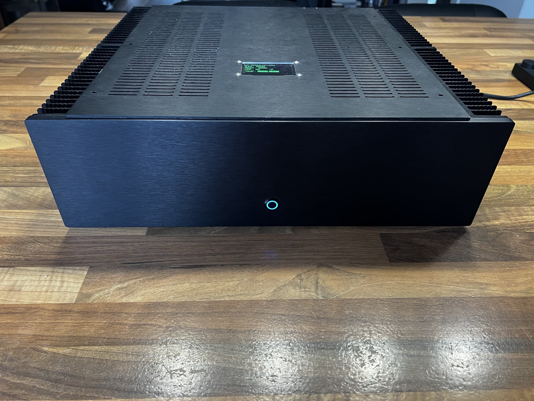

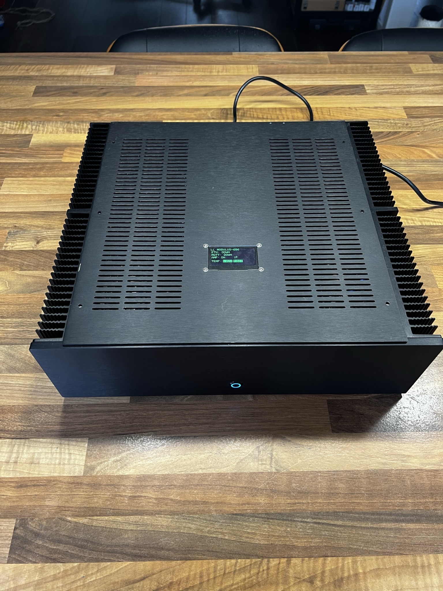

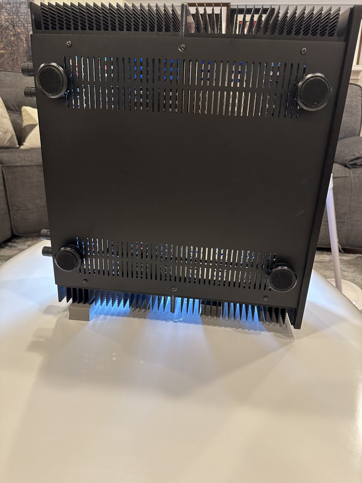

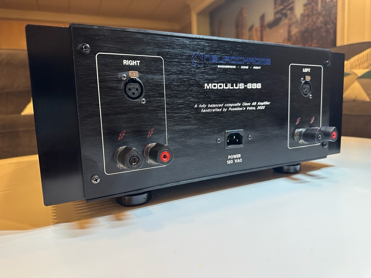

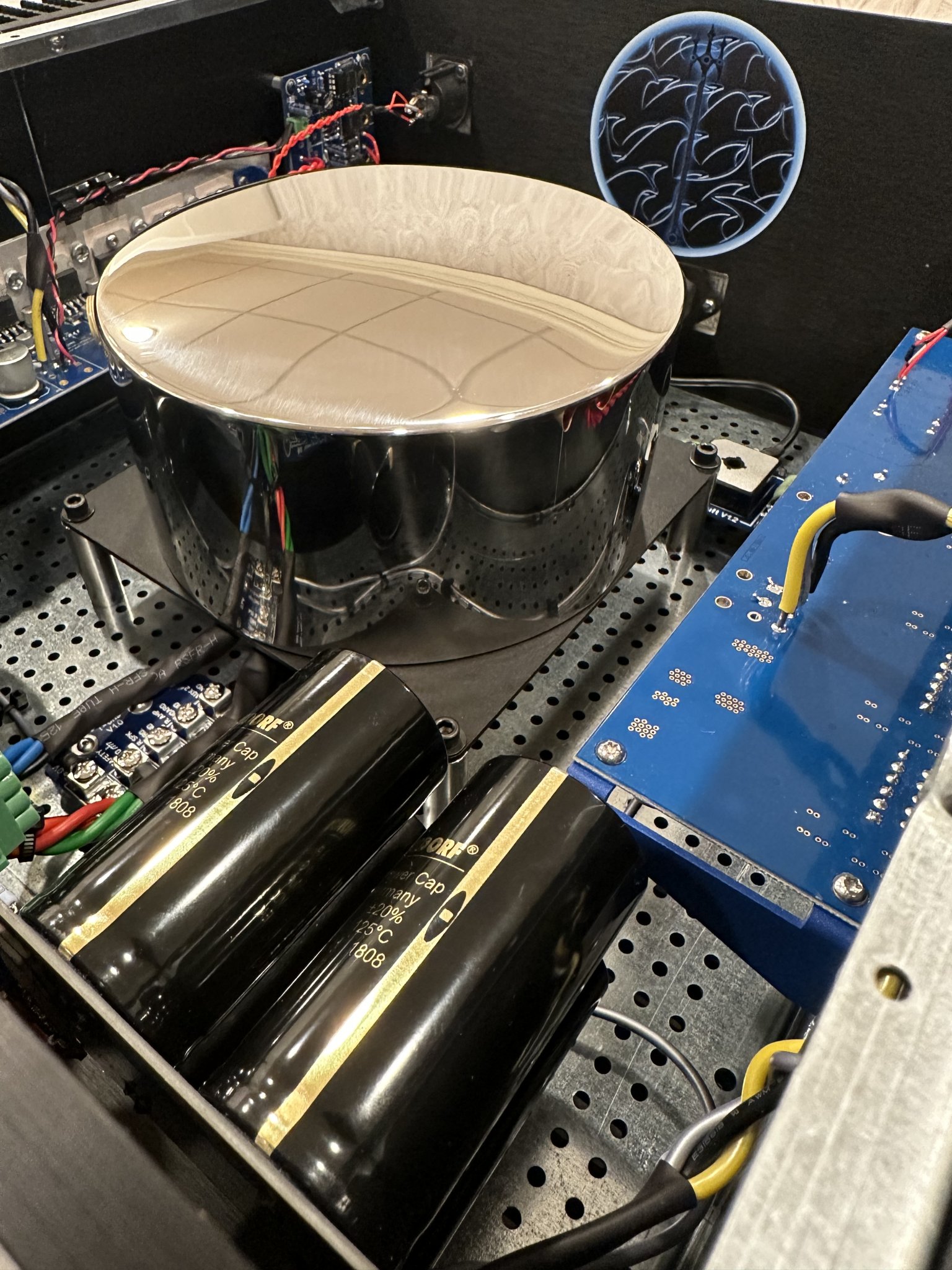

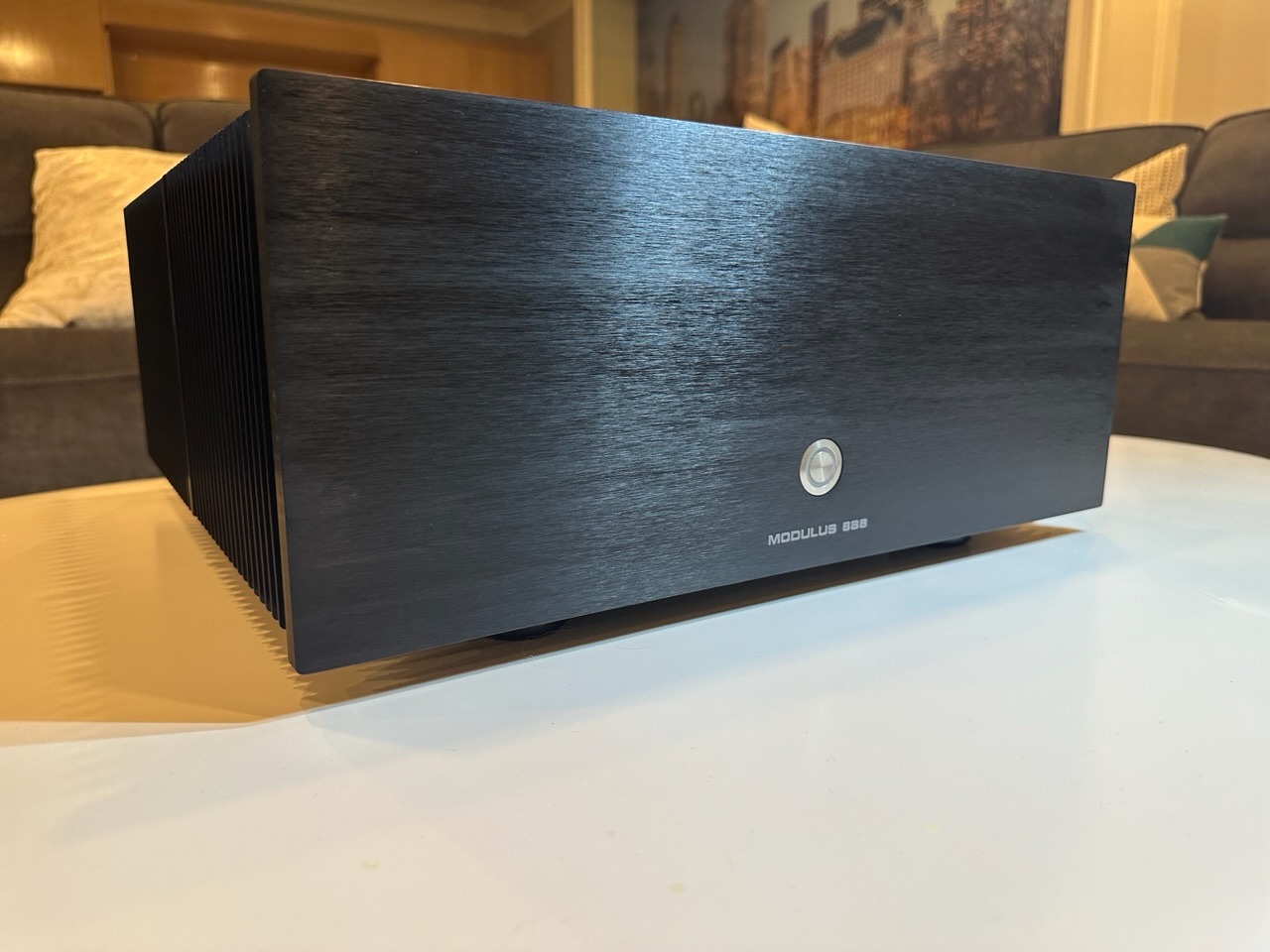

Well I guess it’s high time I join the Modulus 686 club as well. In all honesty, I’ve had these boards for roughly three years and had it all hooked up to a pair of spare heatsinks with test leads and a generic PS. Listened to it for a few days…and to my surprise I had a hard time pulling away, it literally sucked the mojo out of my amp building passion hence…I shut it off and postponed the build…until now.
Ingredients
What I’m basically saying (to the newbies reading this thread) is that my method of building is somewhat overdone and downright silly when you look at the prowess of the 686 as a design. It has a PSRR that is beyond reproach and is a balanced composite design with a differential input so all these ‘extras’ are really just that…gilding the lilly.
One can pretty much get superlative performance with Tom’s recommendation of using a well designed MeanWell switcher supply and not worry about power supply boards, ISS, etc…because the Modulus 686 as a design doesn’t care. It’s power supply agnostic. If you feel threatened by the switcher supply, then do this. Load the top with pretty looking granite (away from the vent holes) and voila, your switcher amp is ‘heavy’ and therefore…’mo betta 😉 .
Perusing this thread, I am humbled by the builds of @pinnocchio, @sledwards12375, and @stretchneck. My build is very much average with little innovation to be honest. The only part that really tickled my fancy was the implementation of the capacitive touch switch!
On it’s maiden voyage the amp fired up to +/- 35V and dc offset on the binding posts was <1mV all within a few seconds. This is a no brainer design.
Alright, y’all have read enough, it’s time to throw in some pics. As always, I‘ll rotate back with some initial sonic observations and comparisons in the near future. Kudos and thanks to @tomchr for all he has taught and all he will teach me. And yeah, a reference in Class AB designs.
Pics

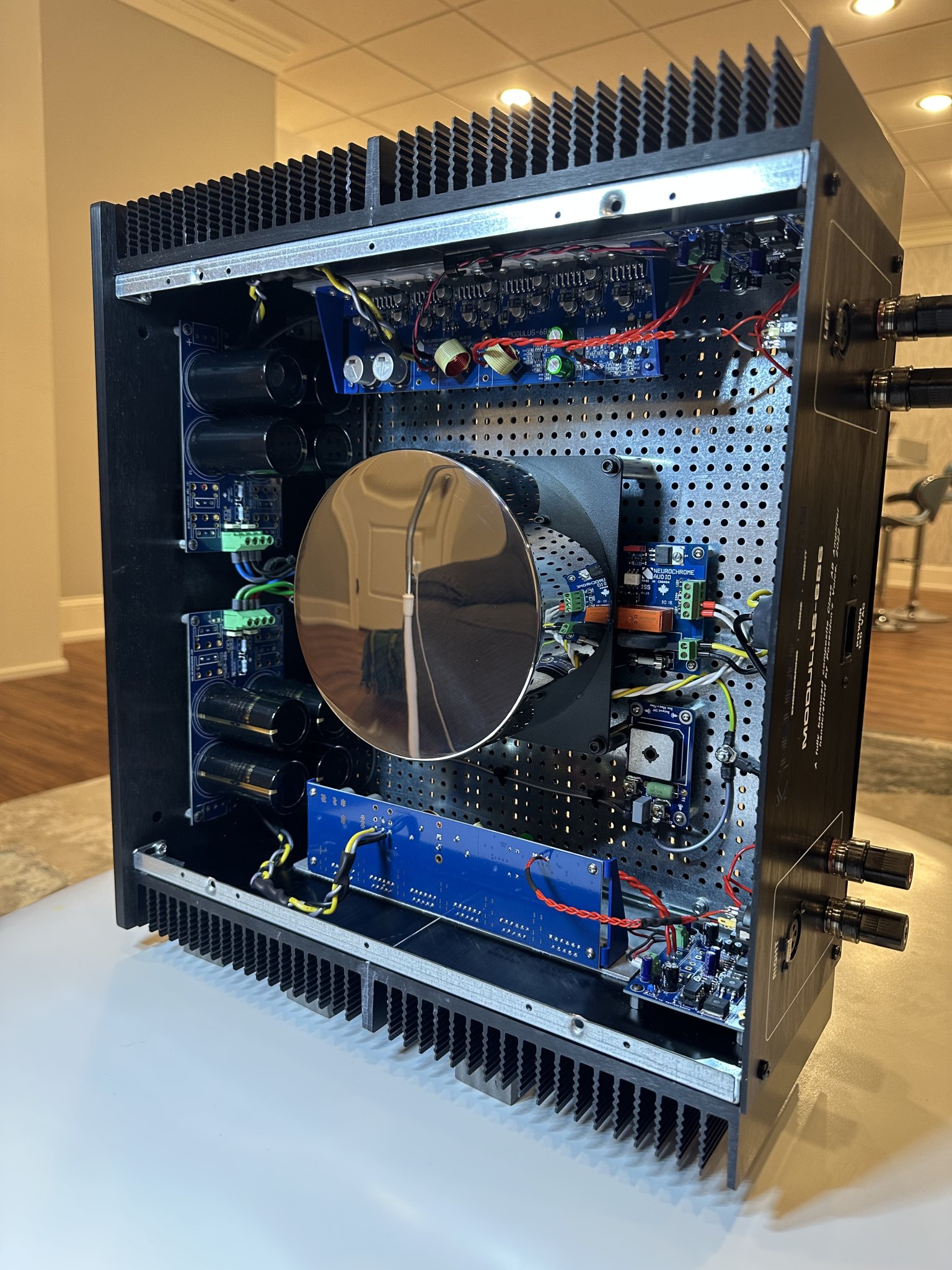

Ingredients
- Customized Modushop 4U/400 Dissipante Chassis
- Customized Toroidy Audio Supreme v2 800VA transformer with quad 25VAC secondaries and a single 120V primary
- Neurochrome ISS v1.1 board (customized for the capacitive switch)
- Schurter capacitive multicolor touch switch
- Pair of Neurochrome Power 686 boards each with (4) 22mF Mundorf 63VDC capacitors
- Pair of Neurochrome Modulus 686 boards
- Pair of Neurochrome Guardian 686 boards
- Ground Lift & T-GND boards
- Furutech XLR, Furutech binding posts, and Furutech IEC
- Wires of various gauges from Neotech and generic mil-spec wire
Pics

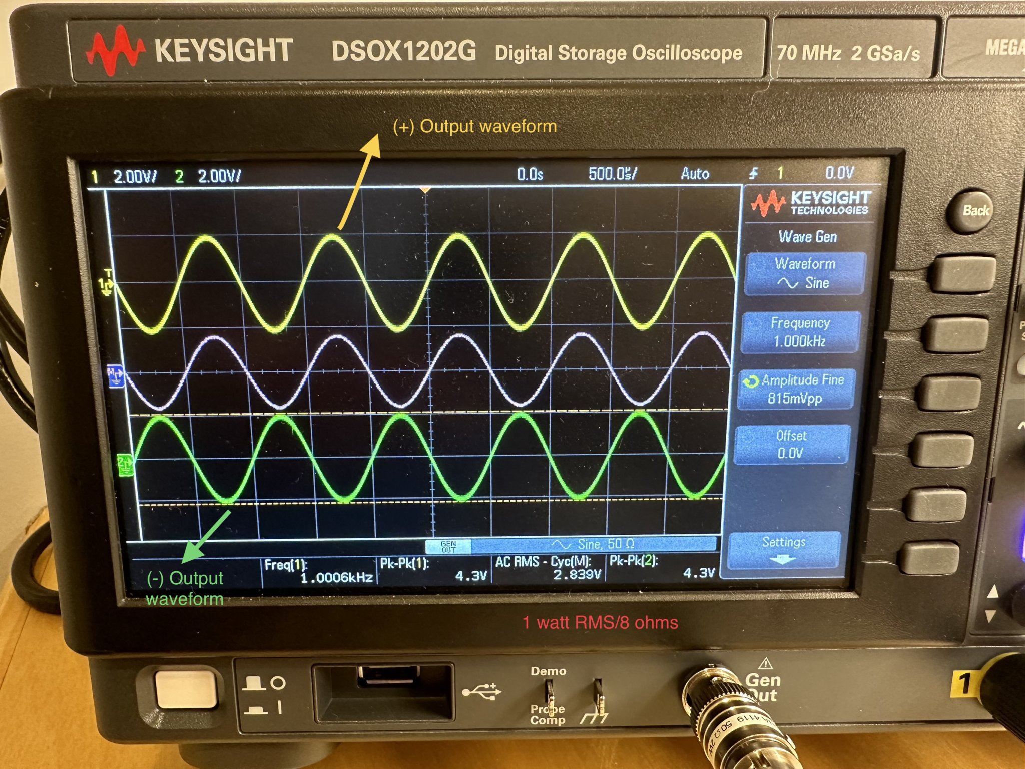

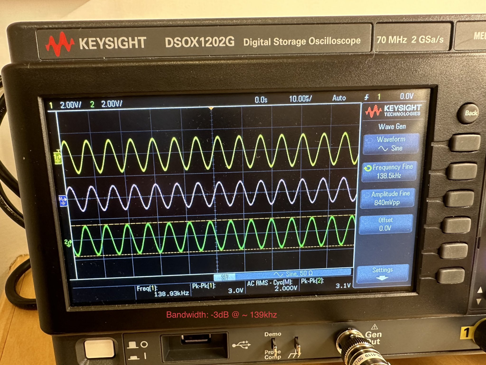

Some more pics and measurements attached. Don’t worry, me and my alter ego are arguing about the pin 1 issue. It will be resolved 😉
Best,
Anand.
