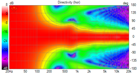

How much is enough? I've been doing a lot of active cardioid sims in Vituix and I find its very hard to get much rejection to the side. Rejection to the rear of the box can be quite goo, however. This is the best I've been able to do with side drivers on a 320mm wide box. The side drivers are high passed at 100 Hz to minimize excursion requirements.
Nice plot. Is that a single driver in the front and one driver each side? I bandpass and time delay the control drivers as well.
Good enough would be -6dB of the sides and -9dB on the back.
I wish it were just a couple of drivers.. I've got an 200 cm dia. waveguide/CD playing 1200 Hz up. spaced evenly around its rim and playing through slots are 4 small drivers that are good down to 100 Hz and extend the directivity down to perhaps 600 Hz. On each side I have two 6.5" woofers. I can use them as subs or play them inverted and delayed to get the cardioid like response shown. The sim is showing 6-8 db to the sides and 15-20 db to the rear so I would say your goals are achievable.
A more interesting question to me is why 6-8 db to the sides and -9db to the rear are enough. I was surprised at first that even with the directivity I had, I still got boundary nulls. All the added directivity did was reduce the depth of the side nulls by a couple of db. Looking at the angle to the first reflection points, I see it would have to be a very tight beam indeed to eliminate the nulls completely. I have tuned for a gradual transition of directivity from omni bass to cardioid low mid. If I tuned for a sharp transition I would get higher directivity in the region but the power response wouldn't be as nice. I concluded that the right thing to do was tune for a "nice" power response and PIR. I changed the vertical stripes of 3" drivers I originally had on the sides to pairs of 6.5" woofers that turned out to work equally well as subs or for cardioid response but only down to 100 Hz limited by the excursion of my "horn mouth edge port" drivers.

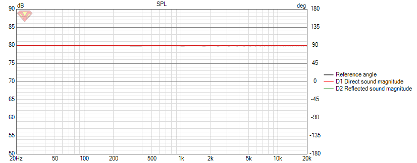

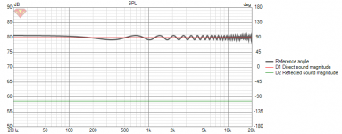

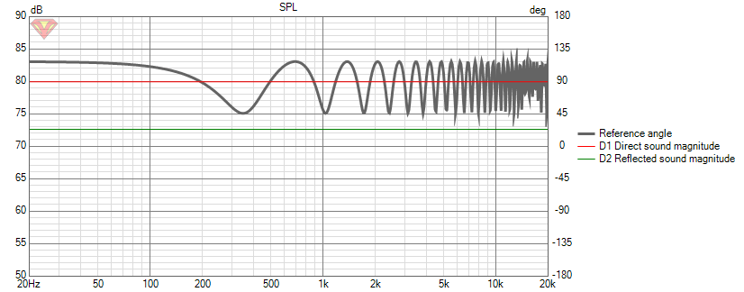

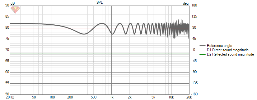

Yeah if inspecting single reflection only it is quite easy to check out what is needed to get the resulting interference less. About 10db attenuation towards the reflection is needed (well, the reflected signal needs to be attenuated, could be room treatment as well) to get nulls "only ~6db". 20db attenuation makes the interference to ~+/-1db which I think starts to be inaudible. This is the goal I think, but very hard to achieve unless very narrow pattern.

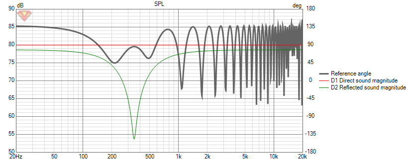

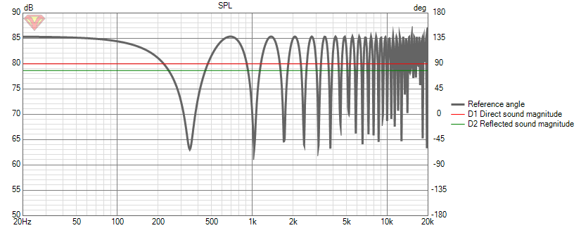

The response can be optimized (like supercardioid) so we can have -20db or more attenuation towards some angles, towards the reflection point, but it is hard to get wide bandwidth, notch is easy. IF we only have a notch like attenuation it doesn't do much, or perhaps even makes the situation worse (speculating that hearing system can mostly ignore the interference if it resembles the direct sound).

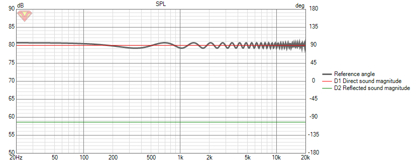

Here is reflected signal with EQ dip strategically positioned to a null. It kills tip of the null but right next to it the interference stays as the attenuation wears off. We gotta remember that next to a null is constructive interference as well!
I wanted something monopole with pronounced forward lobe even at low freq. I'd be happy with DI >4 so the power response (100-300Hz) is closer to the rest of the horn system. Added feature of less reflections. It's been like pushing on a cloud, but I think I have something close now (pics in a few posts). I could not get what I wanted from drivers near the horn mouth. Its tricky to get the mag and phase tuned, especially with 4 sides active otherwise something is always flawed.

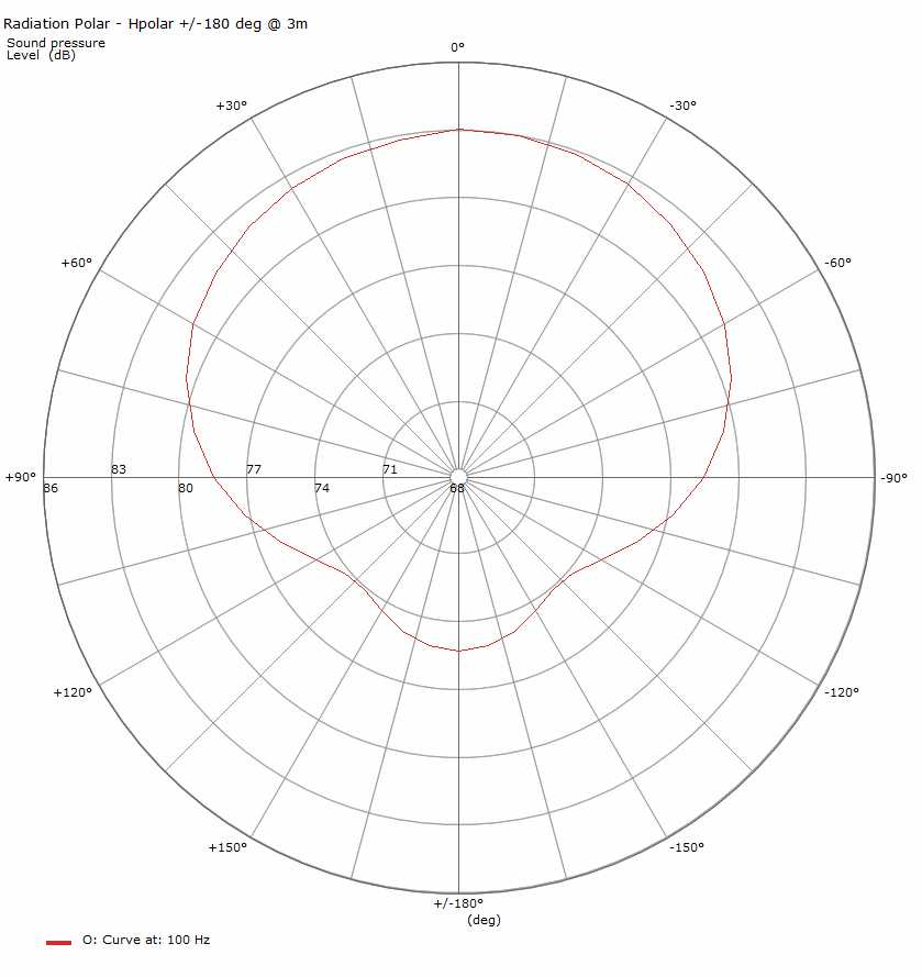

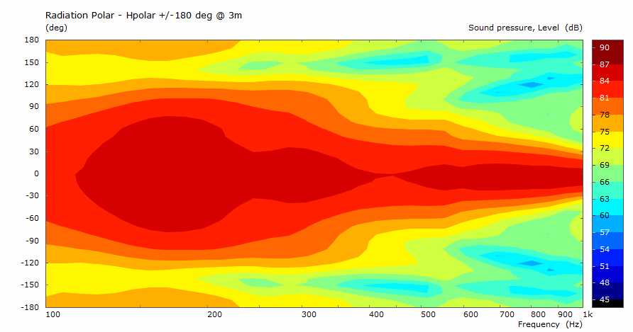

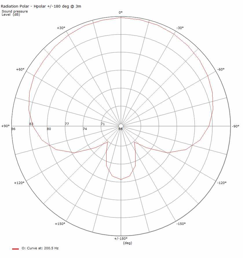

V14-5 with control drivers on the rear and sides. Could use some on axis EQ, but it's getting closer.
[edit] - I think the attn on the sides could be further improved though tuning. The polar @300Hz is the goal.
It is simulation of two sources, the other moved a bit further back to make interference pattern at inspection point as they two combine making constructive and destructive interference depending on wavelenght and phase relationship. It is ideal situation trying to mimic perfect source and one reflection. It then illustrates narrowing output pattern by attenuating "the reflection". It is easy to inspect the result by looking at the interference pattern and ***** how much the reflection affects to the direct signal. This doesn't tell how we would perceive the sound, it is just phenomenon that happens when two signals interact.Thorough post, they look like dipole nulls.
I'm not sure I understand the simulation you ran (drivers, room, etc). How can a -10dB reduction only have a 1dB net effect ?
As the illustration shows attenuating signal -6db towards reflection point we still get almost as much interference at inspection point and could interpret that it is about as audible as without attenuation.
OK thanks, that's perfectly clear, Two sources creating interference patterns (dipole) to emulate a reflection. You had me wondering about distances and wall models used.

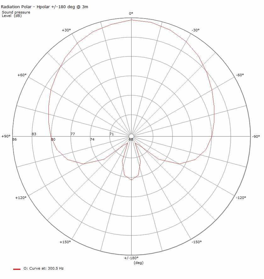

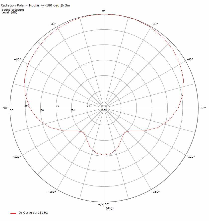

Thinking. You might be able to fine tune pattern at 300Hz by manipulating width of the back, perhaps losing the back driver or just by using the back driver alone, to reduce pathlenght between them. You are probably not going to be able to remove (the widening, now at 300Hz) it but can slide it up or down in frequency.
I suspect the back would be needed to made much smaller than the horn mouth, perhaps pointy, to move the widening to the horn mouth wavelenght so the horn makes it disappear. Or make the back(enclosure) wider (mouth width) and shallower perhaps, if you want to retain the volume. One driver on the back perhaps to tune the pattern.
Both smooth cardioidish pattern speakers I know have narrow baffle and quite deep enclosure though, Kii three and D&D 8c. Hence not sure what works in your case, until experimenting.
At 300Hz it's mostly just the horn radiating, the side and rear control drivers are nearly off, and I'm happy with that. There is a tricky balance trying to squeeze the region 100-299 Hz to look more like the 300Hz polar. After many iterations I've concluded that I need both side and rear drivers if a square box is used.

Sorry about this 😀 in this case it was pathlenghts 3m and 3.5m to inspection point, so 50cm path length difference. Something like first side or floor reflection could be. But this is not relevant, it just shifts the interference pattern in frequency. Main purpose of this experiment is to find out how much a reflection affects to direct signal, or how much attenuation, narrowing pattern, we would need to lessen the effect....
I think this is very nice experiment showing all kinds of stuff we encounter in speaker projects. Shows 1/4wl rule of thumb below where only constructive interference happens. Reminds us there is both constructive and destructive interference. Changing the path lenght difference (realtime in simulator) shows all the big nulls are below 1khz in a typical room first reflections (path length differences) and like to combine megawide nulls. 40db attenuation on the reflection seems to make the combined sound roughly equal to direct signal, -40db is 1% like typical distortion figure of drivers. All kinds of fun stuff, how signals combine and how to manipulate 😀
In line with your "pointy" back idea, it would be interesting to use just 2 drivers mounted on either side of the point (45deg, 60deg? point). It would be like combining the rear and sides. It could make the implementation alot easier. I have done simulations on models like the 8c but it's passive side ports don't provide enough control. I also want to keep the sealed woofers.
