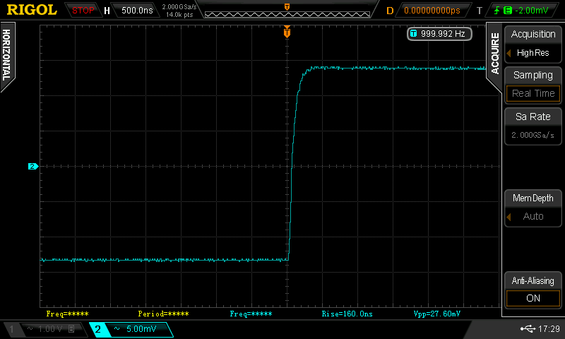

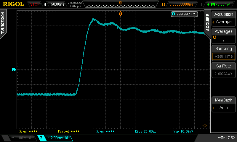

I did not have a ceramic cap in parallel at all though, just a small SMD film cap but a few cm away so I was not counting it.
SMD ceramic and film have about same ESL/ESR for the same package size.
If it is a bit far like you say, this means more inductance. Remember damping factor is R/2 sqrt(C/L) ; more L means more trouble, less C also means more trouble. 100nF capacitors pretty much guarantee failure (unless you got 100 of them).
I am just surprised that any of this would make that much difference at only a few MHz.

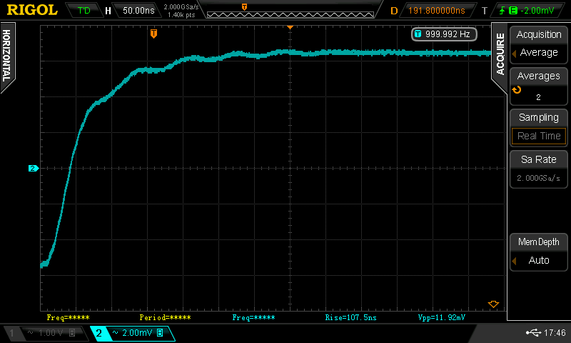

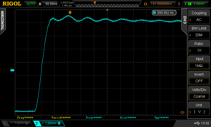

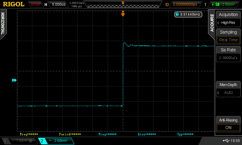

After hacking a 10uF 1206 ceramic, I see you are right that the slightly remote film cap is a problem. It is only a 10nF cap but if it remains in parallel with a ceramic, the results are still bad. Significantly better than with polymer but I needed to remove the film cap to get another dramatic improvement. I am judging just on harmonics showing up on DAC output, and I see 10dB improvement with each of those steps which is huge. Interestingly, just an older small Os-Con in a can, in parallel with that film cap, gives about the same results as just a ceramic by itself. Looks like I have a lot of work to do with the layout and cap selection. Thanks for tips.

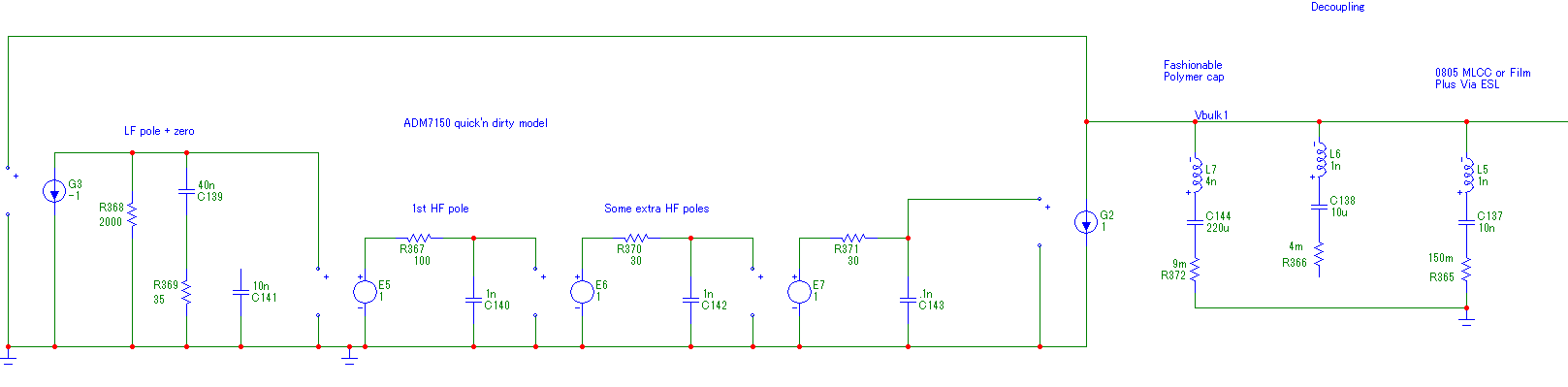

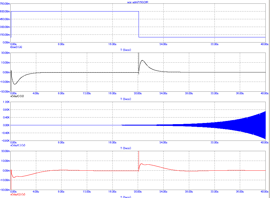

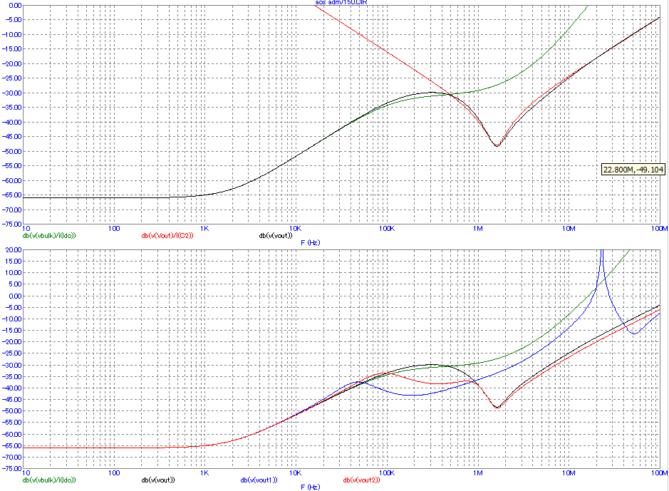

I mean damping factor of series RLC circuit is zeta = R/2 sqrt(C/L)
When you parallel two caps, you get a series RLC with R and L as the sum of both caps and traces ESRs and ESLs, and C is the two caps in series.
If zeta is too low you get ringing, ugly transient response, and an impedance peak.
Since your caps are part of the LDO feedback loop, the impedance peak gives extra gain in the open loop response, at a frequency where the LDO perhaps does not have that much phase margin. The peak also produces a 180° phase rotation. This can have lots of funky effects on the transient response.

What I meant is that I did not expect that ESL of the polymer or the interaction with the PCB to affect that well know diagram with two dips

You were right, it looks like the added R was too little to make a big dent in damping factor.

It was just a 200uF 6.3V 9mOhm polymer cap (SMD but these are large) right at the chip but on the opposite side (so vias are used) - don't ask me why I didn't put at least a small ceramic right on top, it was stupid of me - and a 0805 10nF PPS film cap. about 1-2cm away, also on the opposite side, right under the dac chip (with all 3 of its power supply pins converging at that point). Yesterday, I put the 10uF 25V X7R 1210 cap on top very close to chip (between via point and the scrached off ground plane/copper pour) which improved situation (2nd harmonic of DAC was 10dB better) but still well below what it should be. Then I removed the 10nF film cap and it improved another 10dB. I then added another 10uF X7R 0805 where the film cap used to be and later also an older 47uF 6.3V OS-CON canned cap (+10 years old so not the lowest of ESR though probably still quite low) where the big SMD polymer used to be and each of those gave me a few more dB improvements. Results are now within what I would expect but obviously I have no idea if everything is at 100% or 90%, as DAC produces 0.0025% distortion and harmonics are still a bit higher than what they should be. I am OK with using just one or two 10uF ceramics but it doesn't seem to be quite enough. I am not sure what equipment I need to in order to investigate this.

Normally the formula for two parallel impedances that have both C and L components gets really ugly, but since the parasitic impedance (L) is small compared to what the component is (C), does it end up approximated by the one you wrote? C being two caps in series is counter intuitive.
Yes it is a series RLC.
A simple model of a capacitor is R, L, C in series.
C is the capacitor.
L is the capacitor ESL, plus the mounting ESL. For example a 6.3mm diameter capacitor with 2.5mm pin spacing will have about 3.5 to 4 nH. Mounting inductance is the inductance of a square loop of (pin spacing x pcb height), in your case about 1 nH. It will be reduced for mutilayer PCBs if the GND/power planes are the side close to the cap. If the cap is mounted crooked and/or not touching the PCB then ESL also increases, of course.
R is the capacitor ESR plus the mounting ESR which is usually negligible.
So you got your capacitor. It's a simple model without dielectric absorption, skin effect or RF effects but it's pretty good for our purposes.
Now if you put two capacitors in parallel (draw the two RLC models on a paper and connect them together), you'll notice you get a RLCRLC series circuit, that you can simplify by grouping together the elements of each kind.
So, you get a series RLC with :
R = both ESR in series
L = both ESL and mounting L in series
C = both caps in series (this is what got you, since 200 µF in series with 10nF is still about 10nF)
So to study the resonance of two caps in parallel, you need to apply the series RLC formula 😀

> I just didn't expect PCB to play a major factor at only a few MHz.
When you got a cap with too low ESR, then you need low inductance, and the moment you start counting nH and measuring loop areas, you're kinda doing HF design, even if it's at low frequencies. Same for switching converters...
Ah, ok. If you put a 10nF decoupling cap then failure is not just an option, it is pretty much inevitable 😀
If you calculate the damping factor of a 10nF cap in parallel with your low ESR cap you will notice it is something like 0.01 ; in other words a nice tuned resonator with a huge peak and pretty high Q.
Yeah 😀

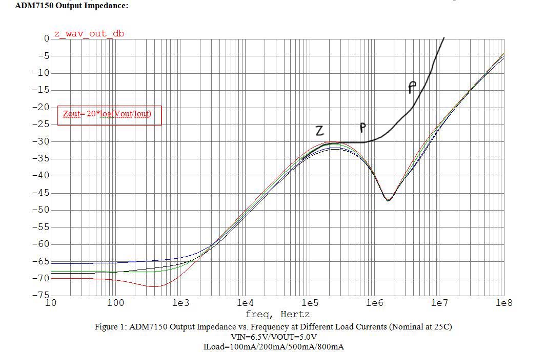

Looking at the output impedance of the reg posted earlier, 1 or 2 10µF caps seem ideal 😉
That's what the designer of the regulator intended, he put his poles at the right spot for this scenario.

Actually if you look at the output impedance curve of this regulator, you'll probably notice the thing is pretty clever.
It has very low DC impedance, but the transition to 10uF MLCC is smooth and the transient response is near perfect. In fact it has the optimum impedance curve for a regulator using only a 10u MLCC on the output. It is impossible to do better unless you add a real crapload of capacitors, or you replace the MLCC with something else.
This is also impossible to do with a simple open loop function having a single pole, like an Opamp Superreg. These can never be rock-solid with a MLCC on the output unless the compensation is tweaked.
I'd bet that the ADM7150 output Z (without the capacitor) looks like this crappily hand-drawn curve.
Pole @ 2kHz
Zero @ 110 kHz
Pole @ 1.6Meg
Extra poles above
Now, for you aos, I've run a sim using the ADM7150 model I eyeballed from the impedance curve.
First graph, top :
Red : Z of 10u MLCC
Green : Z of regulator alone
Black : Z combined (pretty much identical to the simulation posted by the ADI guys)
Bottom :
Black : Zout with 10u MLCC
Blue : 220u Polymer + 10nF (using realistic ESL)
Red : 47u polumer + 10u MLCC
You can see it matches your circuit behaviour : 10nF creates huge peak, 10u alone is perfect, 47u polymer is mostly useless but doesn't hurt that much
Second plot is transient response, same colors, you can see the 10nF cap turns the simulated reg into a nice oscillator, and the big polymer makes the transient peak smaller, but much longer, with a little bit of wobbling at the tail, which doesn't look so good.
So this reg is simple to use because it has a smart compensation, but how it works out depends on the output caps. The ADI guys know their stuff, if they optimized it for 10u MLCC, and they recommend a 10u MLCC, just stick a 10u MLCC and don't lose sleep over it.

Wow, that is amazing amount of info, thank you. Can you tell me how do you simulate a regulator with given poles and zeroes? Using (demo) microsim or ltspice, is there a way to specify response like that? Obviously you can create a full transfer function as a ratio of two polynomials if you know where poles and zeroes are - is there a way to specify a "black box" with such transfer function to serve as regulator?
You can use a laplace transform dependent source and enter your expression, works fine in AC analysis on my simulator but not so much in transient.
So I use the idiot mode : dependent sources (current/voltage) and RC between them to make the poles... works fine in transient and AC...

Here are a few measurements just to accompany the theoretical ones. Output of 5V ADP7150 was fed 1.5V square wave at 1kHz through a 100Ohm resistor. When a smd polymer is added, we can see peaking and the oscillation is not well damped. The normal (2 x 10uF ceramic) response is slower but no peaking and no long term oscillation. Keep in mind the function generator while capable of up to 40MHz square and 100MHz sine doesn't have the sharpest rise to begin with and I'm not happy with probe connection (I did solder a spiral piece of wire to get the shortest possible probe ground right across the ceramic but it was too thin and seemingly intermittent). Interestingly enough when a 120uF low esr cap (not polymer) is added, the response seems to be best to my eyes. Still in all these cases the effect seems fairly subtle on oscilloscope.
Best way to observe those is to solder coax directly to board. Solder coax GND braid to GND plane, add 50R (or 47R) in series with coax center conductor, use 1X setting on scope.
Your ripple at about 13 Mhz (75 ns period) looks funny, I wonder where it comes from...
