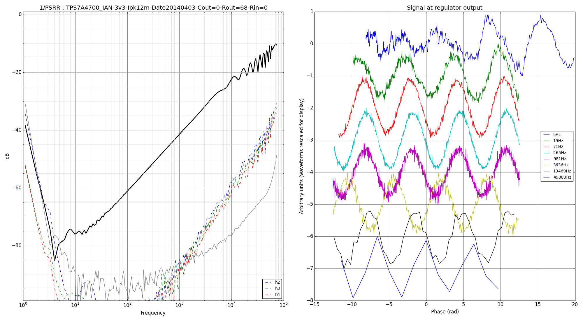

See attached PSRR measurement of TPS7A4700, it is similar to ADM7150... Note the measurement is inverted (it is a transmission measurement, Vout/Vin, so negative values in dB indicate high PSRR).
So, PSRR is crap and reaches zero above 100 kHz. Please don't show that to the designer of this otherwise excellent regulator, he may get a bit sad.
Why ???? Simple... Any regulator has got to have a voltage reference, which is somehow referenced to GND, so if there is noise on GND, it will appear on top of the reference also, and the regulator will happily add this noise to the output.
There are input capacitors on the 3-pin module... They're required for stability... Any noise on the input goes straight through the capacitors, and creates a current in the module GND pin, which lifts the regulator reference voltage, so the regulator's output will nicely track the input. Noise also couples from module GND into the output via the output capacitors.
This module is mostly a capacitor from input to output, with some DC regulation function at LF.
The output impedance is dominated by the pin Z.
I won't show the HF curves from the network analyzer, cause some of you may vomit. Just think what happens when you put some ceramic caps on a module, add > 10 nH pin inductance, and put more ceramic caps on the board. It's a complete mess of resonance & antiresonance spikes everywhere.

Somehow the TPS7A4700 EVM shows datasheet performance, ie excellent. This could have a relation to the fact the guys who did the layout know their stuff, the caps are placed with care in the right spot, the sense pins of the regulator are used for their purpose, and it is not a 3-pin module...
If you want 3 pins, just stick a damn LM317 !!!!!!! It will have higher performance than the fashionable superreg of the day with a crap implementation. If you want to use high performance, expensive chip like ADM7150, the implementation must be on par.
Or make a shunt reg... or any reg that doesn't have input caps ! Its output Z will still be dominated by the pins, but at least, if designed correctly, it will have PSRR.
Or do it the right way with a pinout like so : GND IN GND GND_SENSE GND OUT_SENSE GND OUT GND, plus another row of GND 'cause it's cheap.
