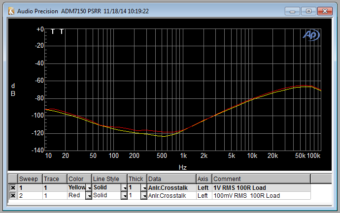

One could always use a depletion mosfet as current limiter -- the ADM7150 doesn't need any help in the PSRR department, however. The results I get with a 100 ohm load are a hair better than the datasheet:

Does anyone know the max surge current for a given zener?
Have a look at the manufacturer's datasheet, some include a max surge power curve. I try to design for less than 0.01% duty cycle when operating anywhere near the max limit, to let everything cool off and relax after taking such an enormous body-blow. It's merely my opinion of a reasonable way to extend the life of the diode; others have different opinions.

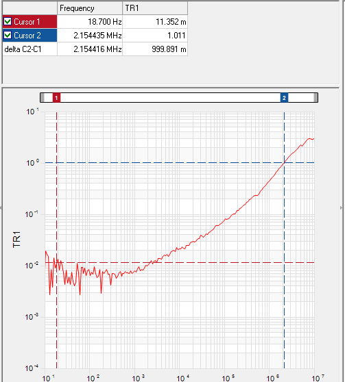

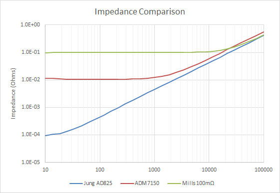

I am not seeing the low-Z at LF which the ADI engineers simulated -- for comparison/reality checked I included a Mills 100mΩ, and a Jung regulator with AD825 error amplifier. (This setup will measure down to ~1 or 2 μΩ):

... for comparison/reality checked I included a Mills 100mΩ ...
Jack, I looked at the datasheet for "MRA" noninductive wirewound resistors from Vishay Mills, and didn't see an inductance specification.
Your plot seems to show that the 0.1 ohm resistor becomes inductive at ~ 22 kHz, which corresponds to an inductance of 700 nanohenrys. Do you think that's the actual inductance of the resistor, or an artifact of the test fixture & software?
Which DC load on the reg ? More current should give more Gm and lower Zout...
Most LDOs perform rather poorly at low load currents, because the PMOS lacks Gm...

Jack, you're getting something like 5 mOhm at low freq in your last graph, I don't see reason to complain about that...
If the opamp's open loop DC gain is 110 dB, and if the feedback network's voltage division ratio is 1/3rd (gain of -10dB), and if the pass transistor's gain is 0.9X (-1 dB) then the total loop gain is 99dB or so.
If the regulator's open loop output impedance is ~ 1 ohm (opamp open loop output impedance divided by pass transistor beta, plus emitter follower output impedance (1/gm)), then we expect the closed loop output impedance to be 99dB below 1 ohm. Namely, eleven micro-ohms.
The surprise is that Jack's instrumentation jig CAN measure impedances this low, but he ain't seeing what he expects to see.
It's Walt's setup, not mine! He probed the circuits for the lowest impedance output nodes. He was able to measure to 1μΩ.
http://waltjung.org/PDFs/Regs_for_High_Perf_Audio_1.pdf
To measure 1μΩ @50mA = 50nV So you need short twisted pair.
5mΩ aint shabby by any means!, and the PSRR and noise readings are just great. I have to configure to take a serious listen with my Borbely all JFET preamp.

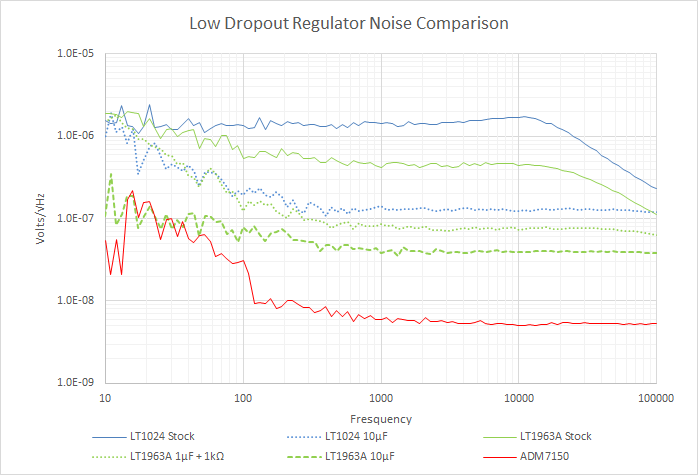

Comparison with LT1084, LT1963A -- the LT1084 is also shown with the adjust leg bypassed with 10uF, the LT1963A with Cff of 1uF+1K and 10uF, the ADM7150 per the application notes.
Of course, the ADM7150 isn't gained up like the two LTC regulators so the noise of its error amplifier and reference is going to be lower -- it's output is 5V, vs 13.4V.
