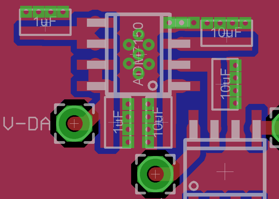

Here is what I have as a first draft.
attachment.php
What I am worrying about is that it is going to be HARD to hand solder those vias without thermals (which would negate the whole point if added to the vias)
I would just use 2 10uF ceramics, one right at the regulator as required and the other right at the DAC. That is what I eventually settled on, though the experiments show a normal (non ultra low) esr electrolytic might help as well to keep the transient response nicer. I am thinking of buying an active probe to help me see what's going on.
Since we are told the regulator was tested with up to 30uF ceramics (3x10 on the demo board?), keeping one at the regulator and the other (or two) at the DAC seems reasonable. If you put that 100nF instead, you will get instability just like I did.
