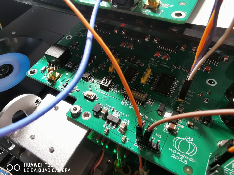

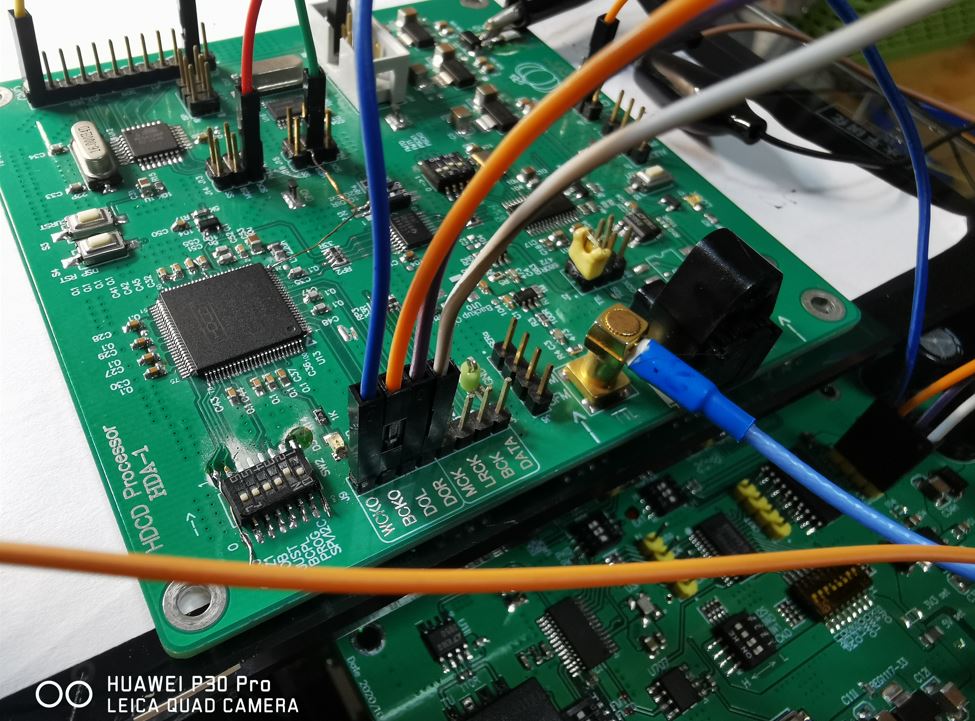

DOL, DOR and WCKO go straight through to the multiplexers. Looking at CLK there seems to be some sort gating logic possibly for stopped clock mode. There is also an option to ground the DOL, DOR and WCKO inputs via the multiplexers. Doesn't U33 just configure the PMD200 and then go to sleep ?
Oh BTW, I remembered that I checked the data sheet of SAA7324, and its IIS interface output format is the same as DIR9001 or AK4118. At the same time I tried all their formats. .
The only thing that is not sure is that SAA7324's main clock (MCLK) frequency in naim application is 16.9344MHZ or 11.2896MHZ?

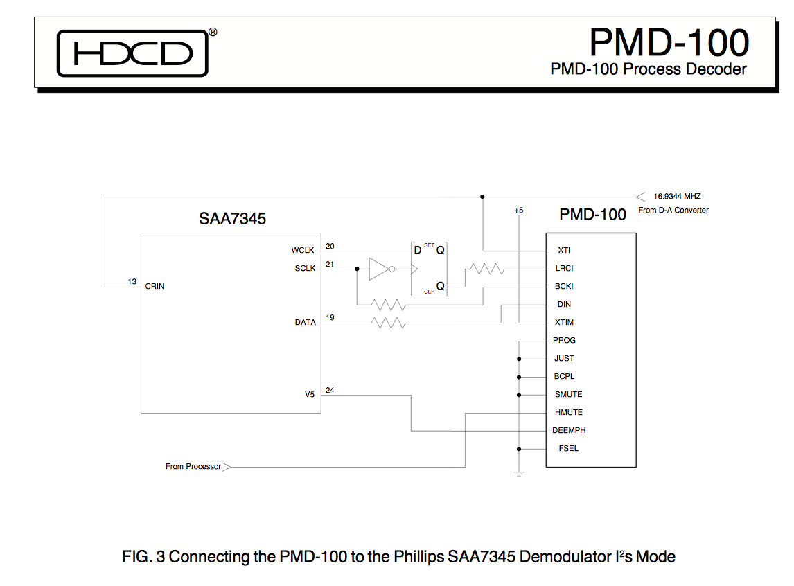

Most lightly PMD200 could not accept I2S input format directly, without simple hardware interface. Like PMD100.
From PMD100 datas, example with SAA7345 I2S output format... The circuit adding "delay" for ONE bitclock to the LR latch line, maling MSBit with Latch.

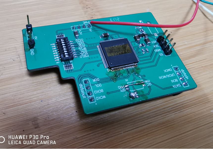

Thank you, I checked the PMD200 (primary version Ver0.6) data sheet to show that it supports the IIS format. I once guessed that it does not support IIS, so I tried RJ, LJ, 16BIT, 24BIT and so on. The result tells me that there is no format that can correspond to it. Therefore, I focused on the input and output clock polarity to compare. Unfortunately, the timing diagram of the PMD200 data sheet is not clear, and I am not sure which mode is correct.
1. I used DIR9001+PMD200+AK4497 (single channel external filter mode) and it worked. The sound is very normal. But a strange phenomenon is that there is a certain chance that the MCU responsible for SPI will need to manually RESET and send data to PMD200 again to work normally, otherwise it will have problems with sound (improper register configuration). So I thought that I could solve the problem by sending data to PMD200 twice, so I used it to make the engineering version of PCM1702, the sound was normal, but it would still work if I manually reset the MCU or reset it multiple times.
2. Before I go to know JPK73, I cannot see the information that needs to send data multiple times from the data book. It is still a mystery to this day.

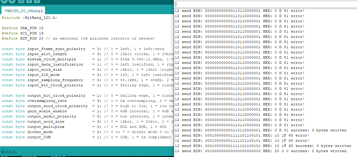

Yes, it's a DS1054Z!
I can make the Arduino code repeat the reset of the PMD200 a couple of times, do you think this will help...?The SAA in the Naim is configured by a PIC, so I don't think we can figure out the output data mode by looking at the schematic... But if PCM1702 works well, PCM1704 should be the same! Maybe try to wire the left PCM1704 to DOR and the right to DOL to see if the chips are OK...?
And may I ask you: which CD-Player with PMD200 do you have? And which logic analyzer do you recommend?

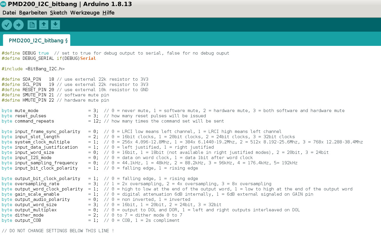

Here as promised the version with flexible settings:
Please check if everything is correct! The reset line is pulsed multiple times. Have a nice trip!

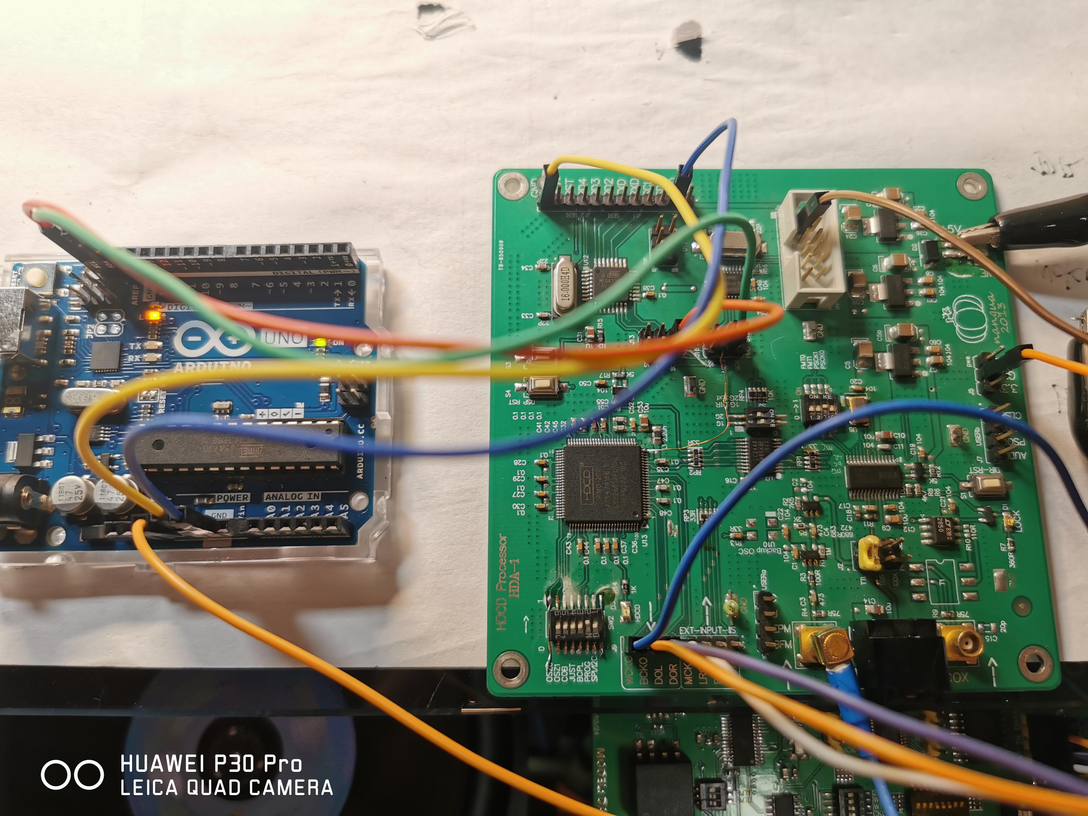

Excuse me,
sorry, please forgive me for answering this way. Because I was so excited, I suspected that life is wonderful because of this chip (PMD200) for more than a year.
I don't have a real thing, and I rely on this unreliable data sheet to stick to it. There are too many details to get along with this chip. I drew the engineering board PCB more than 6 times , Building AVR SPI code more than 20 times. Some were for pin errors, some were for changing the communication method, some were IO settings were wrong, and some were booting up sequence changes. In the end, I really had no choice. I used 2 PMD200s and tried to open the cover under the microscope to verify whether the chip is a real PMD200 (because it has been discontinued, and it has been for many years). I want to know whether the program has entered the PMD200? Why can I work for a while and not work for a while? I am going crazy.

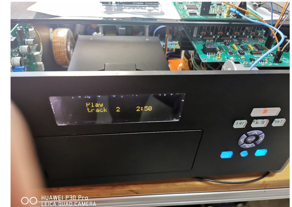

it's good now. I met an amazing person and I called him JPK73 (forgive me for not knowing how to call him). Sorry for being a bit long-winded. Because it contains too many bitter stories. Countless tests. Countless debugging. Of course, I know very well that my cognition is very limited.These will seem very ridiculous in front of professional masters.
Now solemnly announce that the code of JPK73 runs to make PMD200 run perfectly. Let me tell everyone that his code succeeded. He helped me get rid of PMD200 that made me painful.
Thanks again to JPK73, and also to my enthusiastic friend: Zoran.

I am very happy that my code works now!!!
I added mute handling to the code: you can now let the code mute the PMD200 and specify the pins for software mute and hardware mute in the first section of the code:
The PMD200 will be muted during all programming activities such as changes of input rates, but muting can be completely disabled by setting mute_mode to zero.
Other possible settings:

OK, I corrected the code to issue 3 resets with 1ms each and also included some other minor bug fixes, and corrections to the decsriptions of the settings, please see attched code. The data sheet is unclear about the output bit clock polarity: looking at table 5-7 (page 36) and table 7-1 (page 41) I don't know what is correct: 0 = falling edge and 1 = rising edge? Or 0 = rising edge and 1 = falling edge...???reset the PMD200 3 times after power on, the length of each reset time is 300us~500us.
- if you set DEBUG to false in the first line no messages will be written to the serial monitor
- reset_pulses: set how many reset pulses you want after power on
- command_repeats: set how many times you want the commands to be sent to the PMD200
- etc. etc.

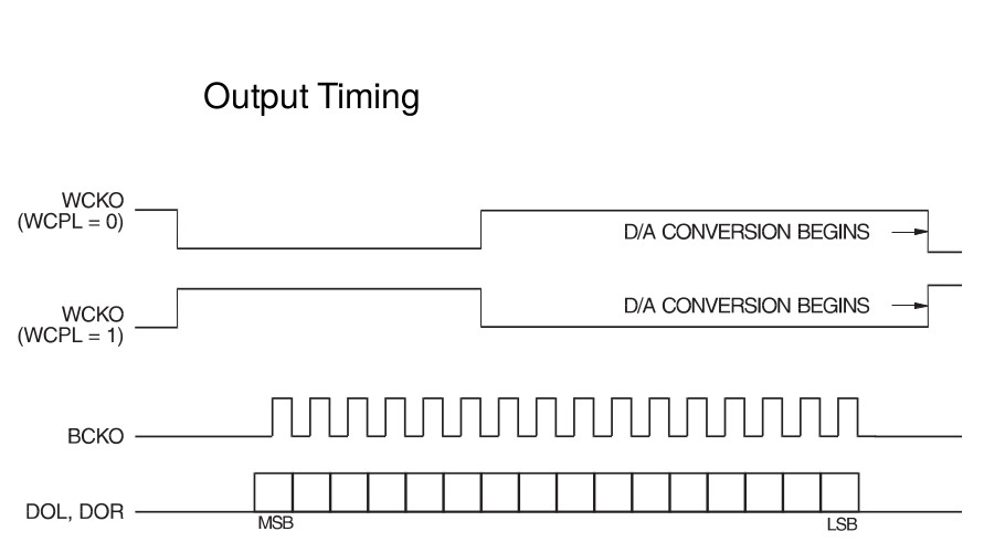

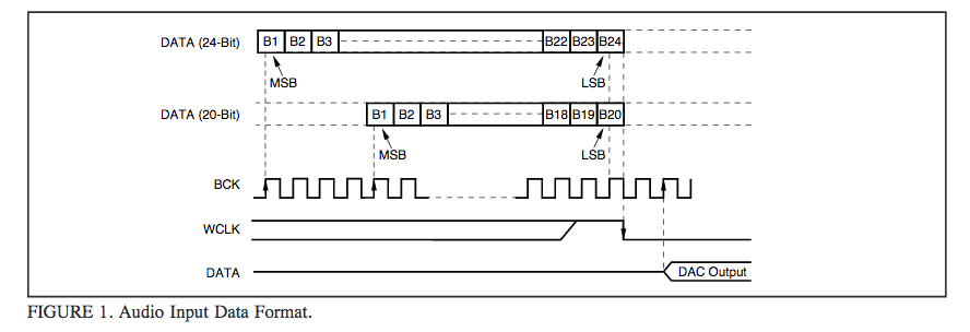

PCM1704 has right justified format. Binary Two’s Complement.
Afer the LSB Word Clock (WCLK) should be falling edge. Also as BCK should be falling edge.
At the MSB BCK should be rising edge. For 20bit and 24bit data words.
(Page 7 audio data interface PDF, read “Stopped Clock” Operation chapter...)
