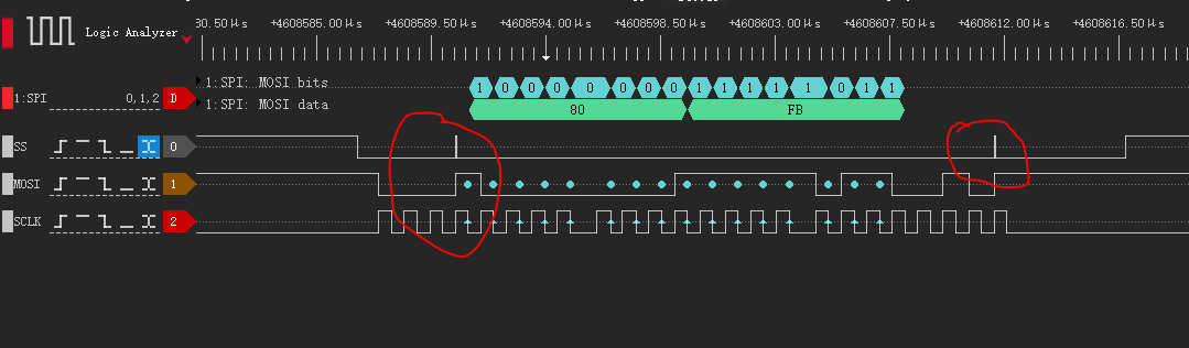

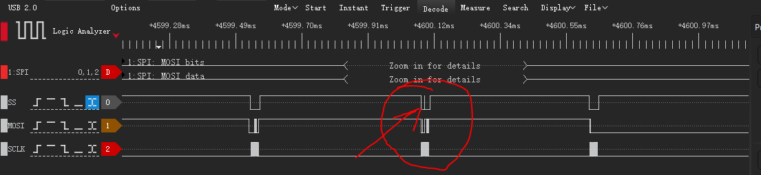

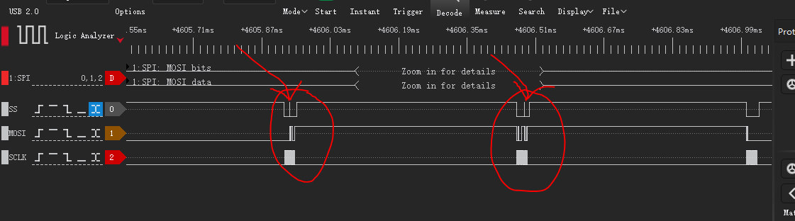

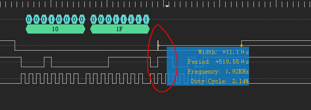

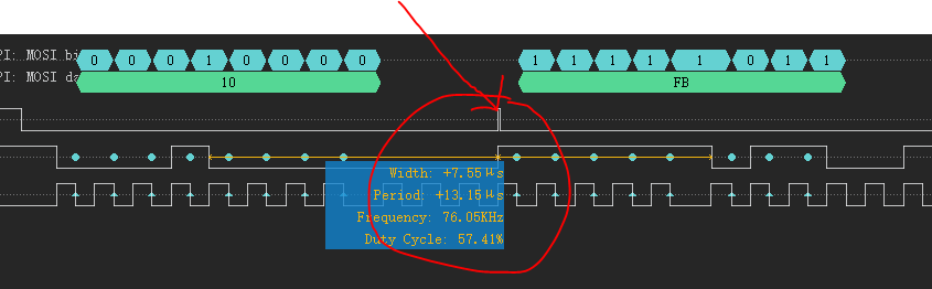

Today I ran this code, and accidentally discovered that a pulse with a width of +50ns appeared randomly in SS. It appears randomly, causing the register to receive incorrect configuration data sometimes, so it does not work. My screenshot is attached, hope to help me analyze it when you are free. thank you very much.
Use the code

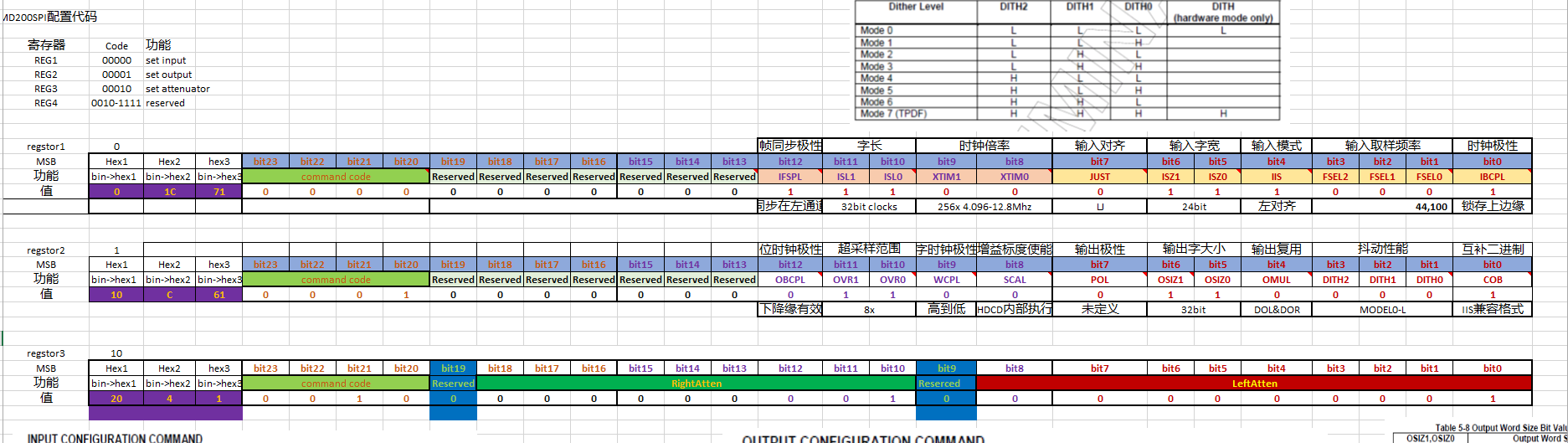

Thanks! I think there is a problem with the third sequence of 0x20, 0x22, 0x23: this writes to a reserved bit, better to try 0x20, 0x00, 0x00! Other than that: great work, many thanks!!!
As for the spikes on the chip select line: most likely an RF issue. Make all wires short (max 5 inches), and make sure ground is well connected. Also make sure the PMD200 is 5V tolerant as the UNO outputs HIGH as 5V - in the Naim it was 3.3V...
Thank you, the third register is as you said, the actual written value is 0x20,0x00,0x00.
Spike problem: The SPI signal line is about 10CM long for the temporary Dupont line. What's interesting is that I accidentally removed the USB line and disconnected the PC from the UNO. The spikes were a lot less, but it still exists. So I am planning to modify the cable to increase the shielding performance.

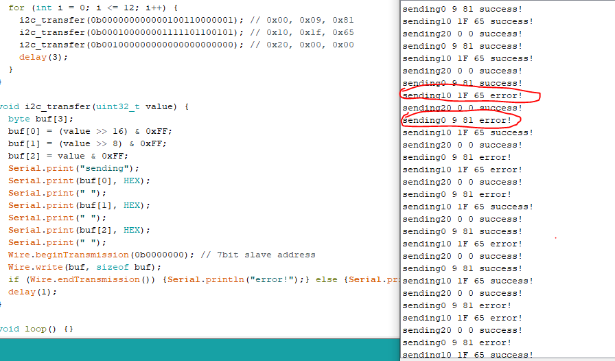

If the PMD200 outputs a signal with distortion I would not start to redesign the PCB: I think the programming still is not right. Also I would recommend to go with I2C as we know that it can work. Here is an I2C code with a speed of 12.5kHz and additional output to the serial monitor, please check:

I really admire your pragmatic spirit in the face of problems, and your suggestions are very good. When I reviewed the entire design process today, I also found that the I2C problem was not solved, and I still need to study it. Therefore, I will test the I2C control over a period of time.
Thanks again

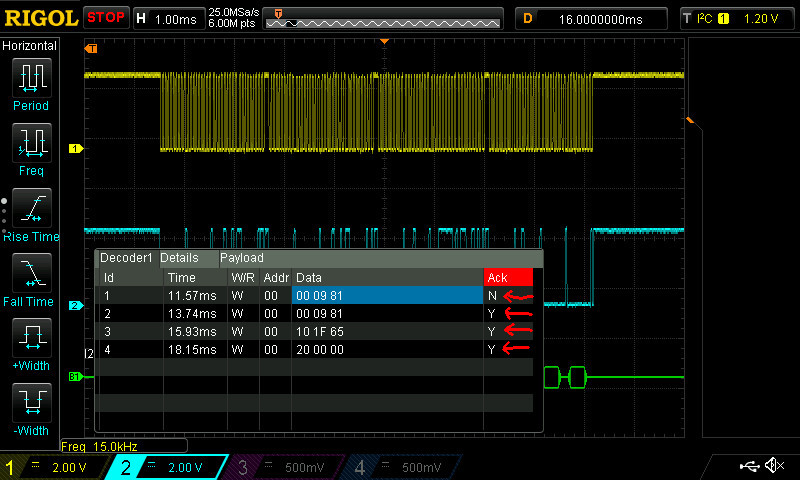

Welcome! Just to make sure: the above example will (only) work on the Arduino UNO: if you use an attiny, teensy, or ARM, the speed setting will not work. The slave address needs to be set as binary 7bit (as shown in above example), GND needs to be connected between the UNO and the PMD, and the i2c speed is set to the registers of the UNO and will generate other speeds on other MCUs. I will make a bitbang version as well so that we can see if that works better. Please post analyer screen shots of the i2c code shown above so that I can trouble shoot it!
Very strange, I thought I had ignored pmd200, pin24=MOSI/HA0 and pin23 HA2 needs to be low, but I didn’t do it, so I2C can’t be searched. So now I have set them to low level, but still can’t search. I2C slave address, so I uploaded the I2C you wrote to try to communicate with PMD200, and I saw the attachment information in the serial monitor. Could you please help me analyze what else is there?
