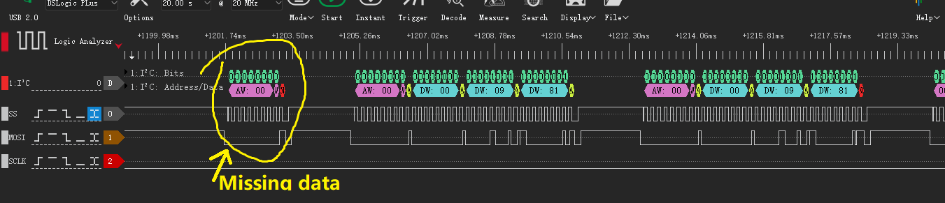

I suspect that the PC interference caused data loss, so I uploaded the CODE to UNO and removed the USB cable, and used a lithium battery to power UNO and PMD200, and the ground level and DAC were at a common ground of 0V.

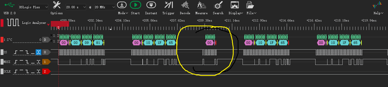

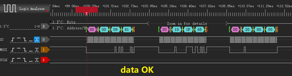

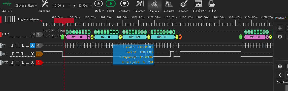

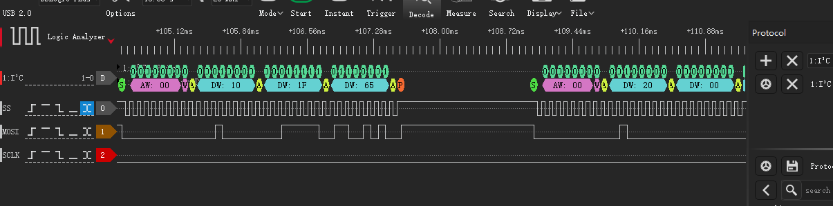

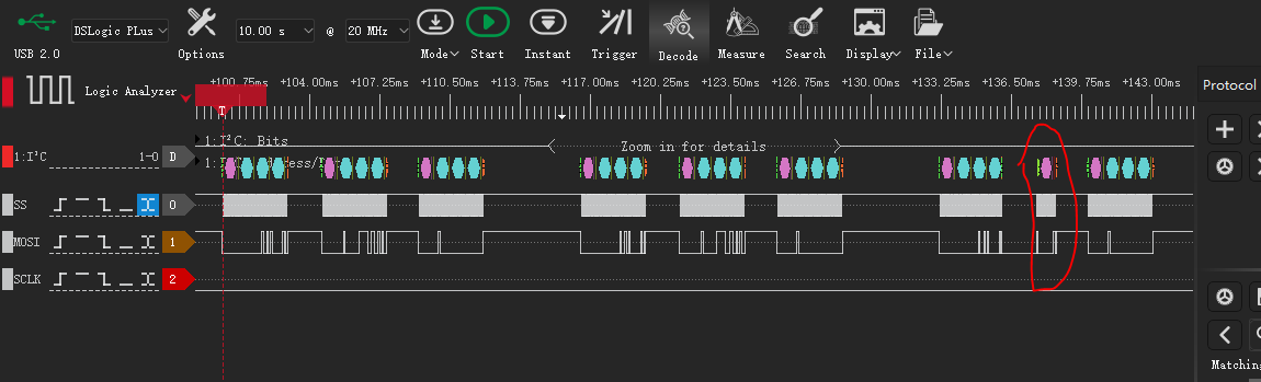

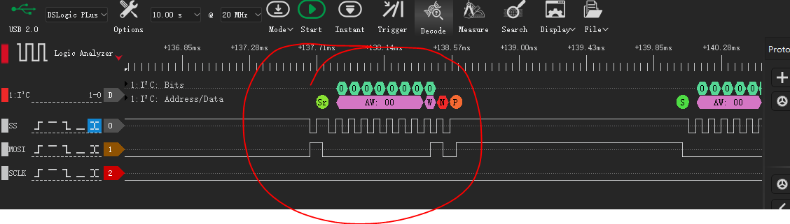

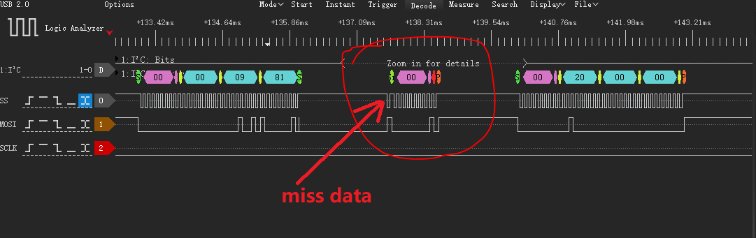

Then I check the data detected by the logic analyzer one by one. The three registers of 0X00, 0X10, and 0X20 have the highest probability of losing data in 0X10, followed by 0X00. They are all cases of missing or incorrect data randomly. I upload the attachment for your analysis.

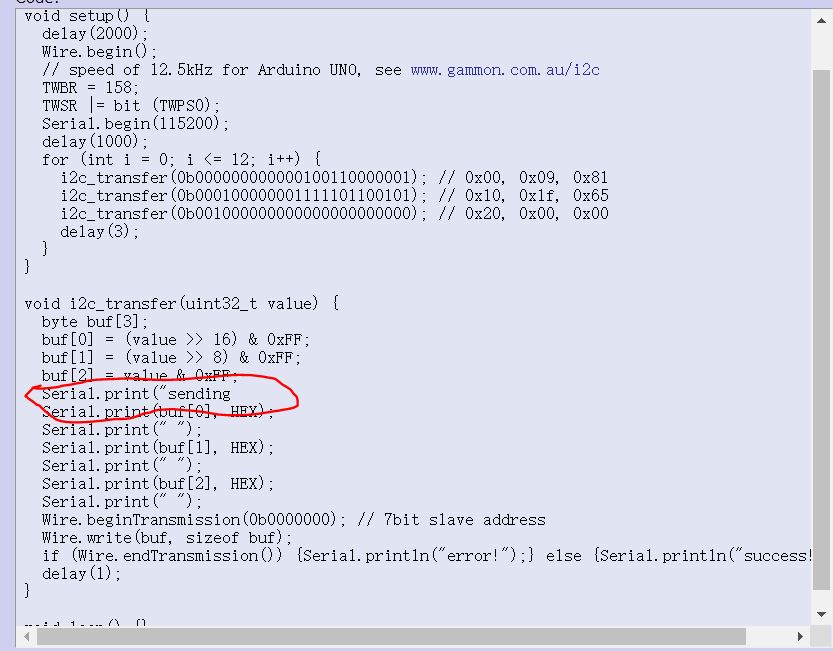

Sorry, I reported an error when compiling, and found that these two symbols (")) are missing here, and I have already added them.

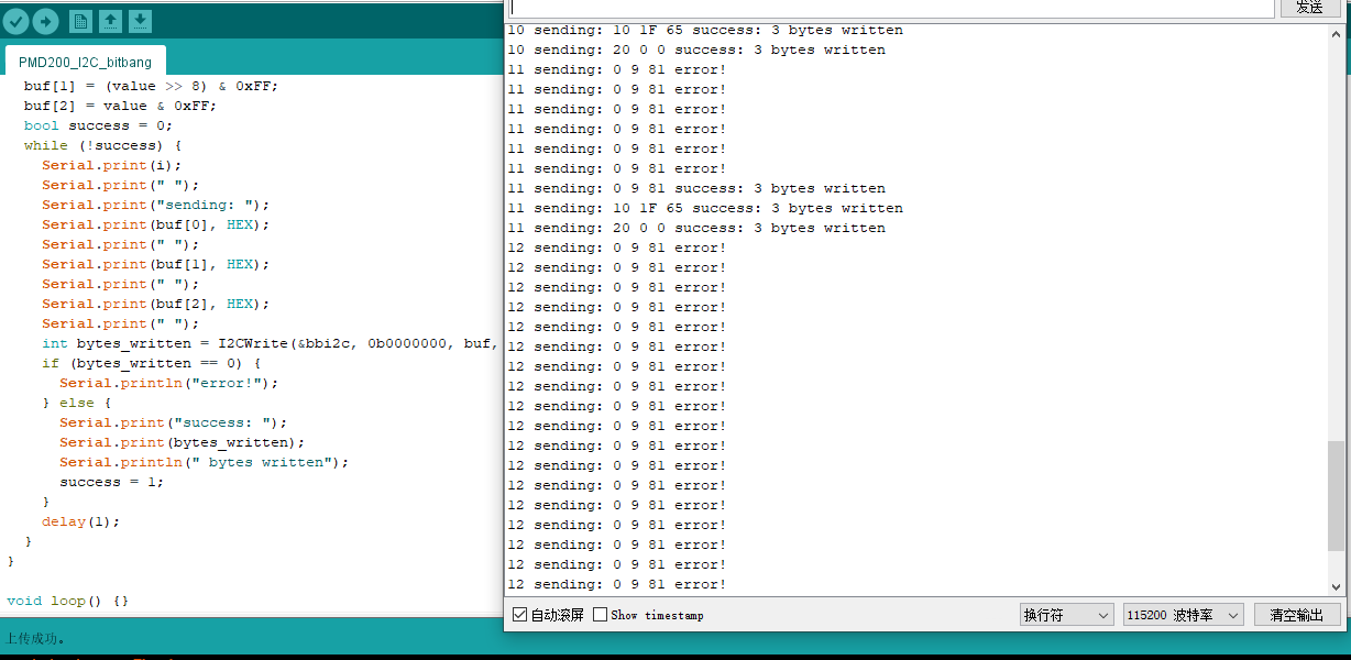

This is a web browser decoding issue, I will include the code from now as attachement. I modified the code to make it repeat sending in case of data loss. Also I made a bit bang version with the library you already tested. Please try both versions and report back.
From the data seen by the logic analyzer, the accuracy of Bitbang's CODE data is much higher.

Oh, what a mess... Hope you can sort that quickly! Maybe you can use your scope instead of the logic analyzer? My Rigol scope can decode SPI, I2C etc.
