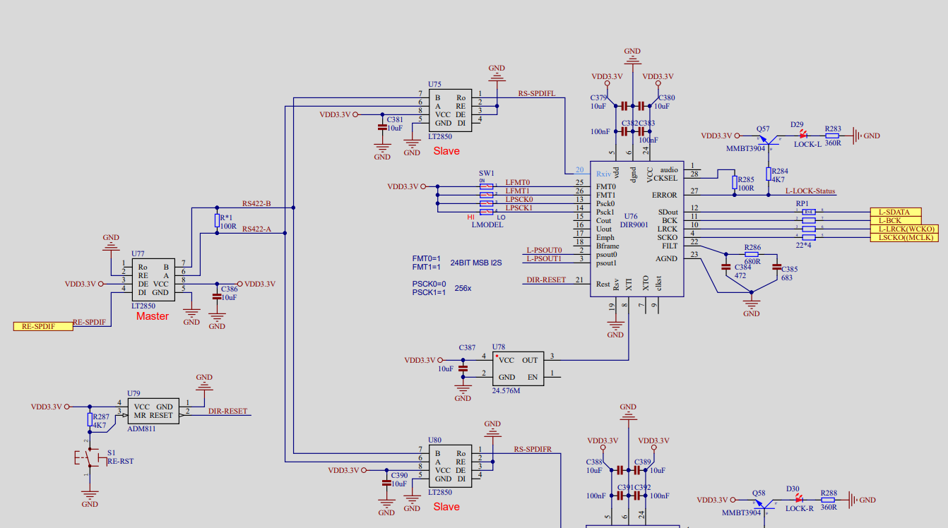

Thank you very much for your reply. I am so touched by your dedication. I will attach the code and schematic diagram, I take up your precious time, so I apologize.

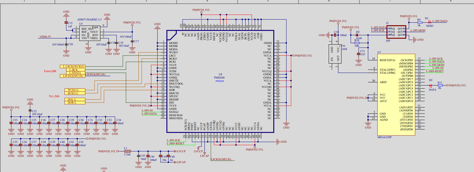

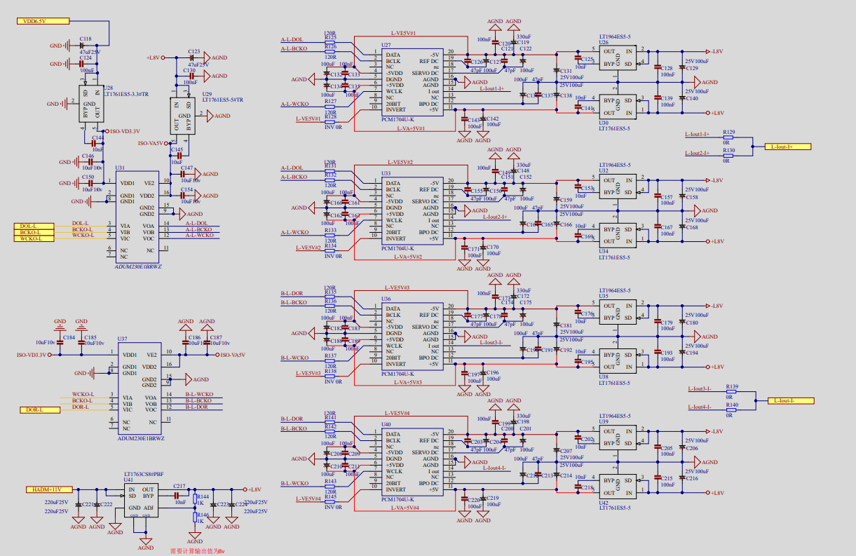

The application framework is: DIR9001-->PMD200-->PCM1704. (PMD200 works in SPI mode).
1, DIR9001 as S/PDIF decoding setting serial output IIS, 16bit, 44.1Khz 256X rate---->PMD200 input port configuration 16bit, 44.1Khz, 256X; export configuration 24bit, two's complement, 8x, 352.8K (LRCK ).
2. The manual does not introduce the details of register I2C, so I have not tried I2C.
other:

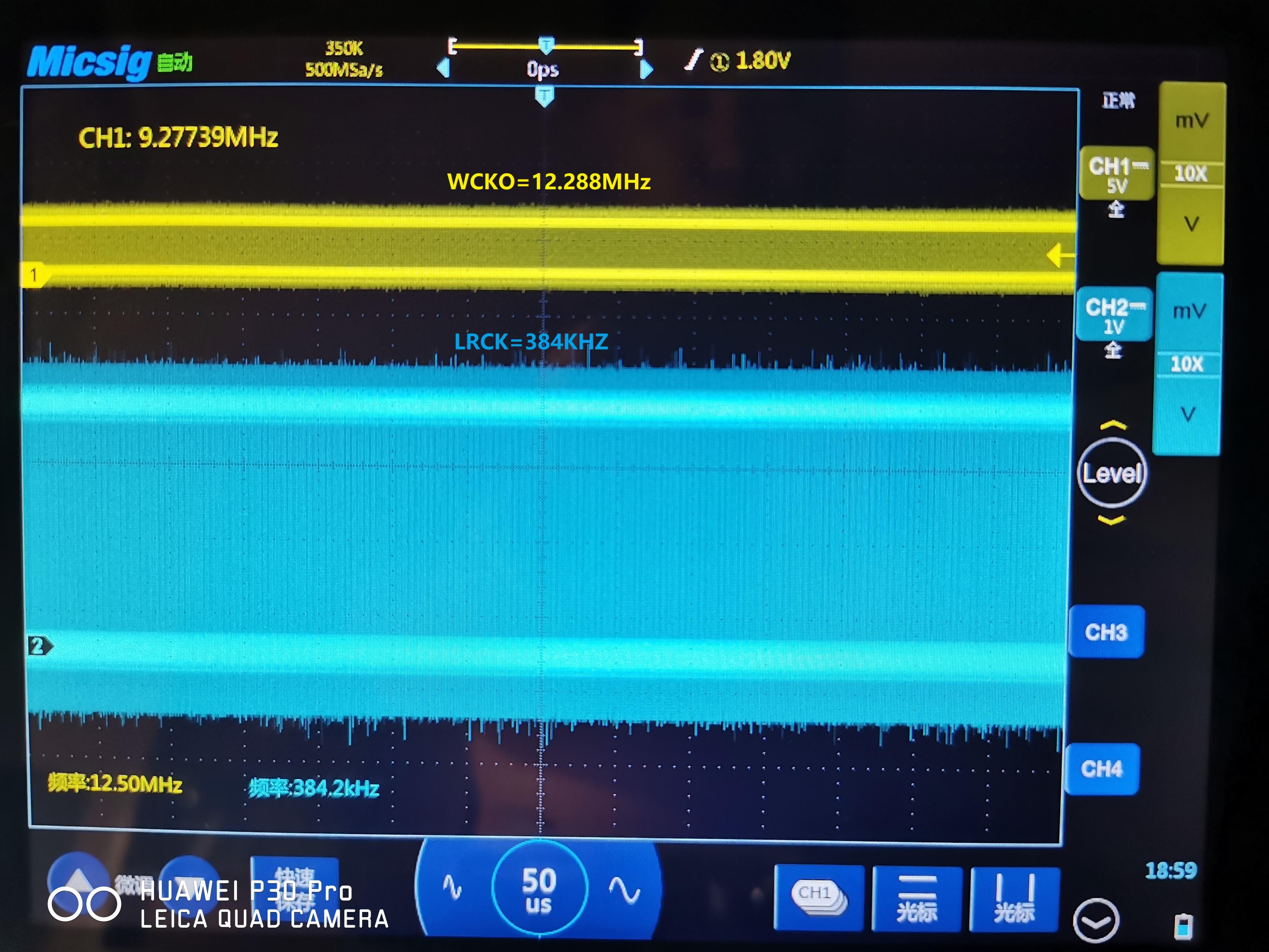

a, PMD200 requires XTAL to have a clock signal before system Reset. The SPI pulse period is greater than 127ns.
b, I have detected the signal frequency at the input of PMD200 LRCK=44.1KHZ; BCK=2.8224M hz SCK=11.2896MHZ.
c. I used the same configuration (PMD200) to replace PCM1704 with PCM1702. I can hear the sound several times, but it occasionally makes a "ch...ch" sound. After switching back to PCM1704, there is always a "huh...sand" sound like the format configuration is incorrect.
therefore:

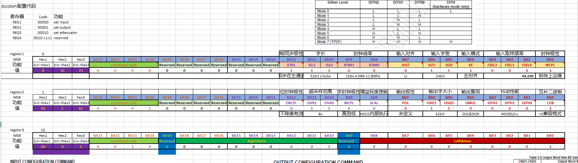

I guess: Is the PMD200 register information correct? (According to the SPI mode of the data sheet I read, the pulse period of 0x57 is set to be about 500ns, PMD200 only has 3 registers 0x00, 0x10, 0x20)

I took the binary values from your screen shot of the configuration bits. I am not sure though if handling of the HREQ and UD pins is needed. With I2C the code would be even easier, and handling of the HREQ pin is not required:

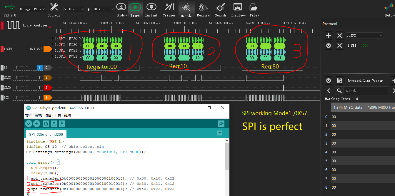

#include <SPI.h>
#define CS 10 // chip select pin
SPISettings settings(2000000, MSBFIRST, SPI_MODE1);
void setup() {
SPI.begin();
delay(3000);
spi_transfer(0b000000000001000000100010); // 0x00, 0x10, 0x22
spi_transfer(0b000100000001000100010010); // 0x10, 0x11, 0x12
spi_transfer(0b001000000010001000100011); // 0x20, 0x22, 0x23
void spi_transfer(uint32_t i) {
byte value[3];
value[0] = (i >> 16) & 0xFF;
value[1] = (i >> 8) & 0xFF;
value[2] = i & 0xFF;
digitalWrite(CS, LOW);
SPI.beginTransaction(settings);
SPI.transfer(value, 3);
SPI.endTransaction();
digitalWrite(CS, HIGH);
void loop() {}

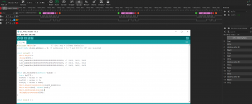

Today I uploaded the SPI code to the Arduino UNO and observed the data sent by the SPI host with a logic analyzer. It worked perfectly. Soon I used it to test the verification registers on the PMD200 engineering board. If it succeeds, I believe this project is your credit, thank you again, and please wait for my test message..........

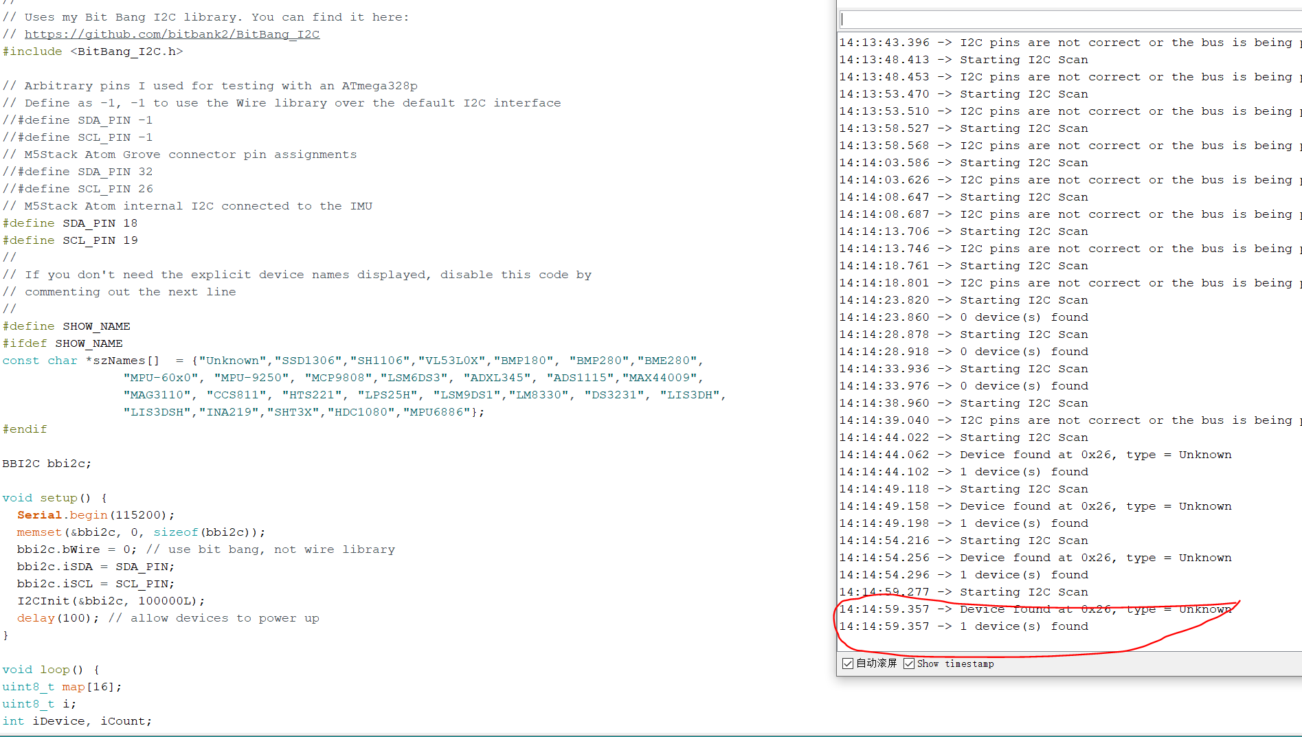

In addition, I also tested the work of IIC. I’m sorry, maybe I haven’t understood it yet. The result I detected with the logic analyzer is not what I want. I still need to modify it. Please help, because in the whole During the project implementation, I saw that IIC may be easier to use than SPI in some occasions.

Seems the device address is reserved... I made a new version with a couple of changes:
If that doesn't work, try the simplified version with serial monitor turned on:

Yes, you need a slave connected. Looking at the NACK/ACK bit (the 9th bit) SDA was high during the 9th SCL pulse which means there was no answer from the slave. Wire.endTransmission() returns that bit. Maybe you can hook up the PMD or another MCU or configure the logic analyzer as the slave?
Another possibility to test i2c would be to simulate a second device on the same Arduino with one of the bitbang i2c libraries: just wire them as loopback and let the bitbanged device answer the device handled by wire.h (or vice versa)...
Any news? With your existing setup you could try the following to make i2c ignore that no slave is connected:
In the file twi.cpp (in folder arduino_avr/libraries/Wire/utility on your hard disk) search this code:
And change all of the return lines to "return 0" and compile/upload. This should bypass the NACK handling of the master-sender so you can see the outgoing communication with your logic analyzer.

I have done a lot of this test in 2 days, but still can't communicate with PMD200.
1. First is the IIC scheme. I set D0~D7 of PMD200 to LOW level. I understand it as the default address 0X00, and the register is not configured. So I used the Bitbang library function to search for I2C slave devices, but it was not found.
2. I tested the SPI communication. I used 0X00, 0XAA, 0X37 to send 3 8-bit data to the PMD200 register, but I used the LOGIC analyzer to check that only 0X00, 0XAA was monitored, and 0X37 was lost. I can't find the reason.
I think:
Is the register address information inaccurate? I don’t know if that friend has the official data sheet instead of the first version.
I think:
I am home for a couple of hours and will be on tour again for the next few weeks, so in an extreme hurry I opened the Naim, hooked up the scope and looked at the communication:
The PMD200 has address 0x00 and the PIC writes to it with 8bit length and MSB-first at a clock speed of only 15kHz:
The commands sent to the PMD200:
This code block is sent 7~11 times, I don't know why, but as soon as one byte fails it is re-sent:
I think we now have all information to make the PMD200 work 😎
Code:
0x00 0x09 0x81
0x10 0x1F 0x65
0x20 0x00 0x00
hi my friend
I'm really sorry to take your precious time to help me find the problem.
Now:
The reverse decoding provided by you is very important, yes, PMD200 is already working. It is now in SPI mode, and I used the code you wrote. Thanks again.
Although let it run this time, there are still some problems.
1. As you said, why do you send it 7~11 times? I did an experiment when the SPI host sent the chip (PMD200) once and it didn't work until I put the sent data into the main loop. At this time, the configuration register became effective. I don't understand why this phenomenon?
2. I reduced the sending speed of the host because I tested that PMD200 will not receive data if it sends data at a high speed. 、According to my guess, why is the SPI communication interface so slow for a chip with DSP as the core?
3. From your reverse register value, let me compare, the PMD200 entry parameter is set to 24bit, IIS, 384xfs, 44.1K, right-justified format. Output: 32Bit, 8X, IIS format.
Among them: the filter works at LRCK=352Khz sampling, WCKO=1.44Mhz
#include <SPI.h>
SPISettings settings(1000000, MSBFIRST, SPI_MODE1);
void setup() {
SPI.begin();
delay(3000);
spi_transfer(0b000000000000100110000001 ); // 0x00, 0x09, 0x81
spi_transfer(0b000100000001111101100101 ); // 0x10, 0x1f, 0x65
spi_transfer(0b001000000000000000000000); // 0x20, 0x22, 0x23
byte value[3];
void loop() {

hi my friend
I did a test just now. First of all, I kept pressing UNO's RESET after adding the written value to the loop. After repeating it several times, I could observe that the PMD200 output waveform became more and more accurate.
The PMD200 test control code needs to be adjusted as follows:
1. The writing speed must be slow enough, SPI is about 1Mhz (the data sheet indicates that the pulse width is greater than 127us).
2. Whether the transmission is successful or not requires confirmation and repeated transmission, and multiple transmissions are required. (There is no information to confirm why this is done)
3. After the data transmission is completed and successful, the MCU enters the sleep state.
