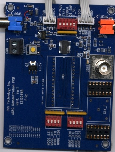

rossi: I have in my possession an ASRC demonstration board from ESS Technology. It has coaxial SPDIF I/O ports, data lines I/O, BNC connector for analysis and other support for I2S 24 bit work ...
With the permission of ESS Tech, I have the authorization to find this a good home and this seems to be right "up your country". ESS is interested in seeing this circuit evaluated as a part of DIY kits or commercial endeavors ... Please email me and I'll send it along ...
