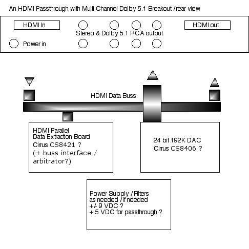

While driving home (between previous post and this one) the thought occurred that what Rossi is really building is a "breakout box" device for extracting the audio component from the HDMI circuit of just about any DVD player that has HDMI output. Granted that some players may have better features than others, but the HDMI data format is supposed to contain all of the digital audio elements of DVD-A, SACD, et al ... See http://en.wikipedia.org/wiki/HDMI ... and ... http://upload.wikimedia.org/wikiped...inout.svg/310px-HDMI_Connector_Pinout.svg.png . Of particular interest here: " ... HDMI also includes support for 8-channel uncompressed digital audio at 192K Htz sample rate with 24 bits/sample as well as any compressed stream such as Dolby Digital, or DTS. ..."
So, Rossi's efforts could (or at least might) be adaptable, generically, to just about any DVD-A / SACD / DVD-Video player with a "standard" HDMI connector that provided sufficient 5 VDC power as per the cabling "standard" and the digital audio "standard".
(HDMI standards are still in flux, some specs have changed since original introduction. "... HDMI Specification 1.0, updated in HDMI 1.2a, and again in 1.3a (Added timer and audio commands). ... With version 1.3, HDMI now also supports very high bit rate lossless compressed streams such as Dolby TrueHD and DTS-HD Master Audio. ..." ? Version 1.4 announced tentatively, at Jan. 2007 CES trade show, apparently upgrades the video [and other?] and there are rumors of version 1.5, changes are TBD = ?)
Thus, maybe this should be a relatively inexpensive, external device rather than building it into a player or a pre-amp ... at least until the "standard" becomes more stable ... 2.0?
Anyway, I would hope that anyone considering something along these lines keep in mind that a) an external device might be more desirable and b) an external power source may be called for as, if HDMI lines are long (1080p cable can be up to 10 meters long) the 5 VDC source & ground on HDMI pin 18 may be quite anemic and c) the actual DAC circuit board might be built on an upgradable sister or daughter board, separate from the HDMI interface board ... No ?? Yes ?? Like this? :

" ... Are you volunteering to demultiplex and decrypt the HDMI datastream ? ..."
Point me to the right chip set and I'll see what can be done. Picking the right combination is the most significant task may be completed ... after that the use of reference designs (board level subassemblies) from the manufacturers may be in order. Then ... we will see ...

That would work as long as the the Gefen box has a HDMI receiver chip with a revision level of 1.1 or greater. The Oppo will not send hi-rez digital audio if the receiver is only HDMI 1.0

... and thus the real reason for this madness ... this effort to discover a good DIY device that will "capture" that digital audio signal and convert it to the best quality analog audio, possible.
Yes the Gefen device may be pricey, and it still isn't good enough ...

Gennum GS8100/8101. See if you can persuade Gennum to sell you the GS8100 and not the GS8101.

The Gemmun chip set you indicate is also a digital breakout to digital audio, which still leaves the question of a proper DAC. (This Gemmun series is quite interesting. They have the impedence matching questions figured out for use on the end of a longer cable, which is good. Meaning that they are directly addressing the Gefen device and could be the Gefen chip supplier for all I know. They also seem to be a supplier to several other companies making better quality 24 bit DACs, so maybe ... )

I would be interested in seeing a good digital picture of the inside. (good enough to read chip labels) also data sheets and schematics if you have them.
The data sheet for the Gefen box says HDCP pass-through, which means you will need a HDCP compliant TV connected to the DVI port before it will allow data to pass. This is a big drawback of this plan.
Found the product brief forms on those chips at Gennum.com. The GS8101 is necessary because the Oppo and other HDCP-compliant DVD players require the HDCP handshake.
This is one of the reasons I snooped on the DVD player internal signals in my design.

There has to be a way to get the full bloom offa this punkin = get the full 1.3 load outta the Oppo and pass it along as 8-channel/192kHz/24-bit analog audio to a quality playback system.
I guess I'm still wondering how I can get one of your (Rossi's) DAC boards. Internal may be the only way ... but then what about those two other DVD players (a modern Samsung HDMI v. 1.? and an old Marantz) I have and all the other players out there?
