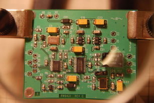

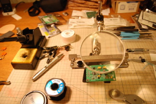

IT WORKS, AND IT WORKS WELL INDEED!!!
Saturday August 4 was a great day in Tokyo, because this became the day when our first OPPO 981HD was started up upon assembling and installing Russl's PCB. We connected it to an ASSEMBLAGE 2.7 DAC via a BNC cable (optical out connector location of OPPO was switched for a BNC connector) and it worked perfectly at first try. The jumper switch was set to the 96K up-sampling position to match the DAC used.
The person who did the assembly (an experienced engineer and avid DIY enthusiast) asked me to comment on this thread that Russl's design and documentation is very close to perfect. However, he also told me that the job soldering the chips and many SMD parts was the most challenging of any DIY project he has experienced to date.
The sound as heard via an audio chain consisting of the Oppo 981HD, Assemblage 2.7 DAC, Marantz passive attenuators, modified Marantz 8B power amplifier, and Sonics by Joachim Gerhard "Allegretto" loudspeakers. We also had a latest model Panasonic 52 inch plasma flat panel display.
We played various discs including pure SACD, DVD audio, and everything worked perfectly. The sound was extremely direct, dynamic, and powerful at a level you would expect from the very highest specification (read: very expensive) disc playback system. It was a very clear, and very big improvement from playing through the normal (analog) outputs of the Oppo 981HD itself.
The big relief that all of our group's 5 members felt when hearing the positive result was tremendous, and we did have a bottle of champagne for the occasion. We would like to share that big "CHEERS" with Rossl.
I will attempt to attach a couple of (small) photos of the assembled board and a view over the "landscape" surrounding the board during assembly. Enjoy!

Seems like you can only attach one image per post herein, so this post carries the second image (a close up of the board itself).
By the way, one of our members also purchased one of the (very) new Oppo 980H players just for checking out the differences. (It arrived on the very same day we were about to test the 981HD with Russl board.) As another poster pointed out; it lacks the connector for tapping out the signals needed for Russl's boards, so it would make the task of modifying even more difficult (if not impossible).
Later we will run a test of the unmodified 980H against another (unmodified) 981HD just to experience the differences. The 980H seems to be very much simplified as compared to the 981HD, but it is still interesting to see how much "performance power" the Oppo engineers have packed into the new product, especially when used as an audio disc player.
For now 981HD with Russl's board is "THE KING". For whoever is willing and able to do this modification, it really becomes the ultimate bang for your money. Top notch performance and specs for peanuts outlay. But do not forget that it requires ultimate assembly skills and a lot of courage!
