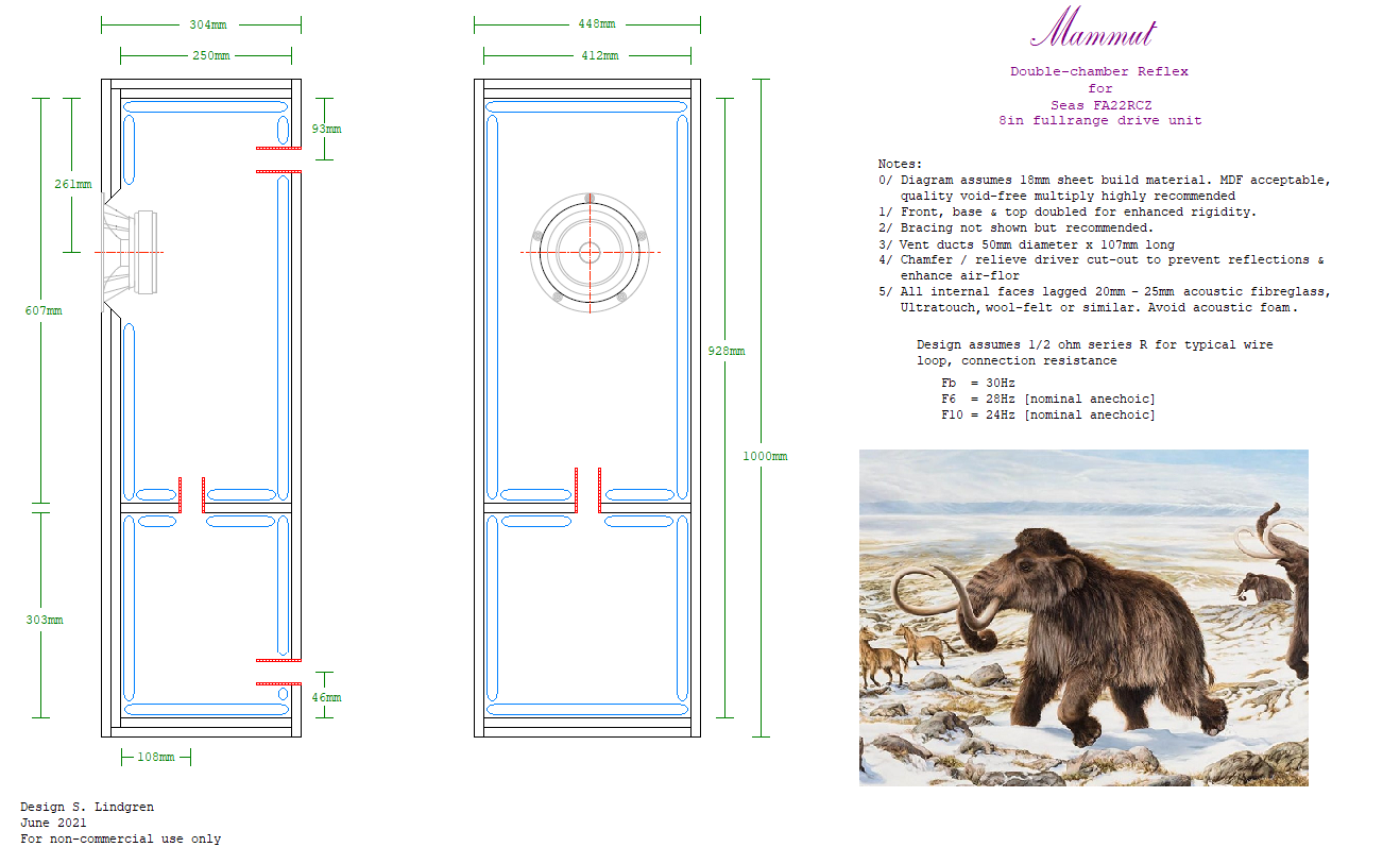

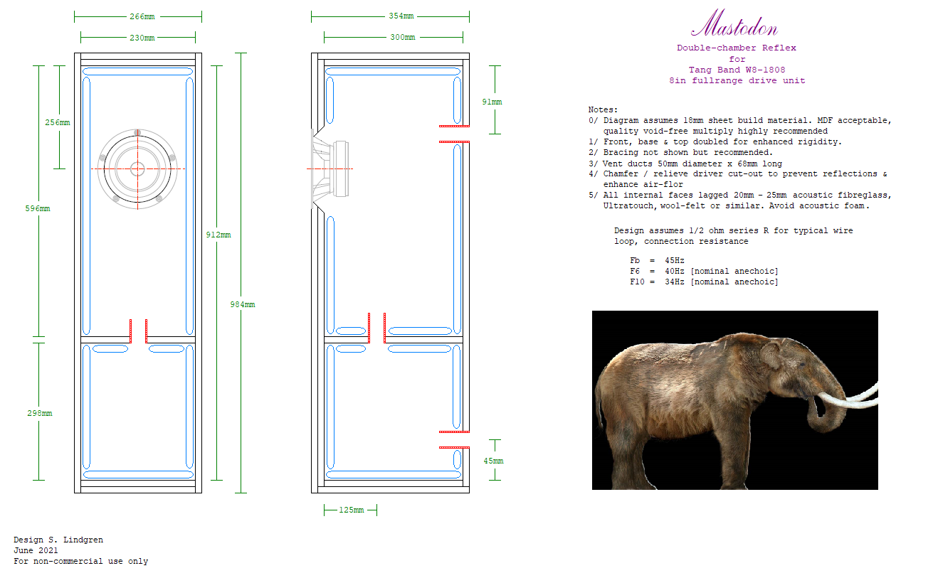

Hi Scott,

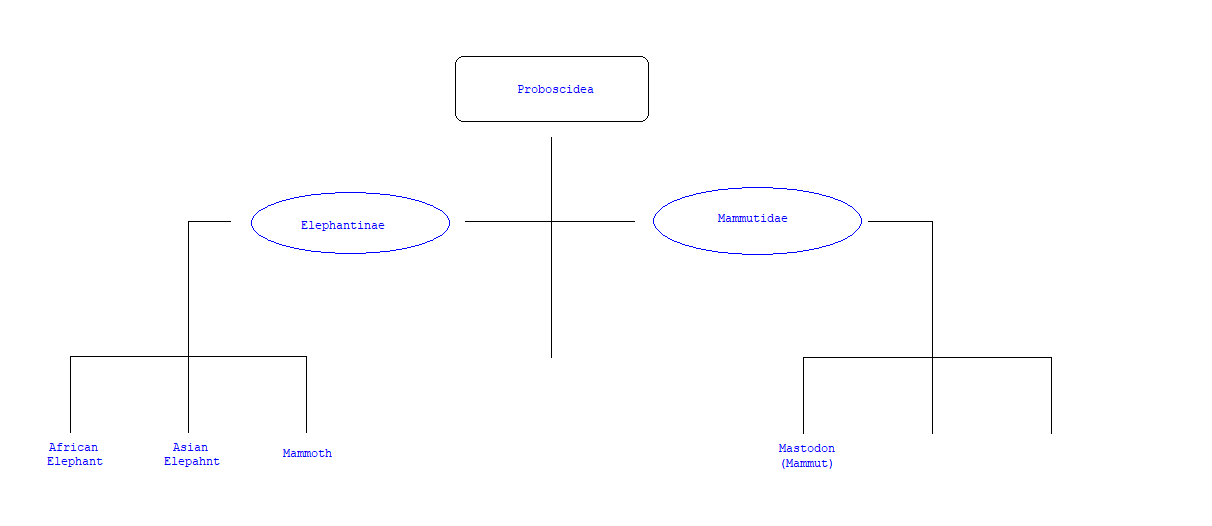

Interesting. I am curious to know what is the advantage of a double chamber reflex vs std bass reflex?
And what is the difference between a mammoth and a mastodon.... the real one, not the speaker cabinet.
Oon
Oon
DCRs have a double tuning, so depending on the lower Fb you can have slightly better power-handling through the midbass region where a lot of the energy in rock music etc. tends to reside.
If you start with the overall taxonomic order of Proboscidea, the Mammut / Mastodon were a genus of the now extinct Mammutidae family within that. Woolly mammoths were part of the related Elephantidae family, so were technically closer to the modern African and Asian elephants than the Mastodon. Something roughly like this (there were lots of different families I haven't added for the sake of brevity):
