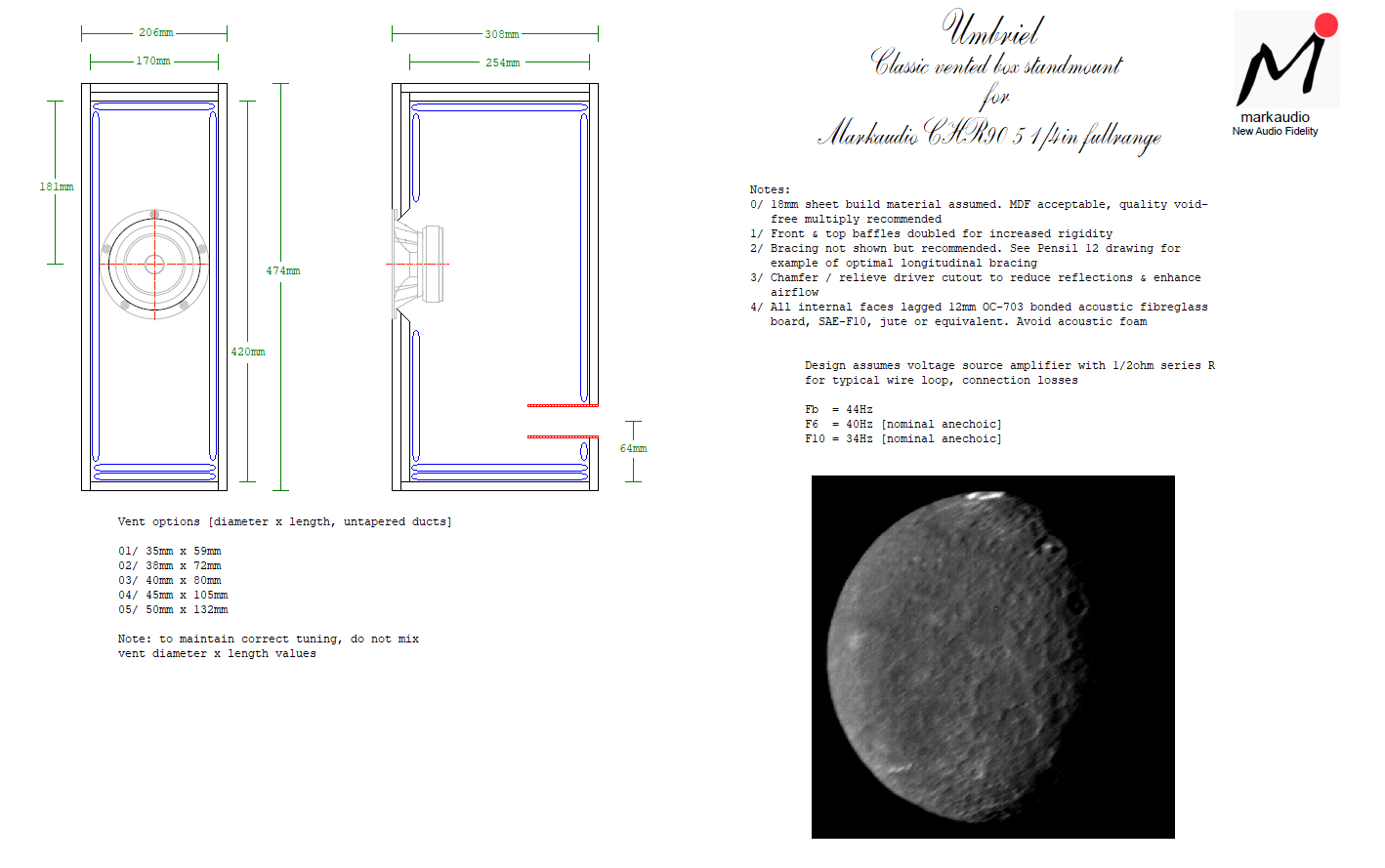

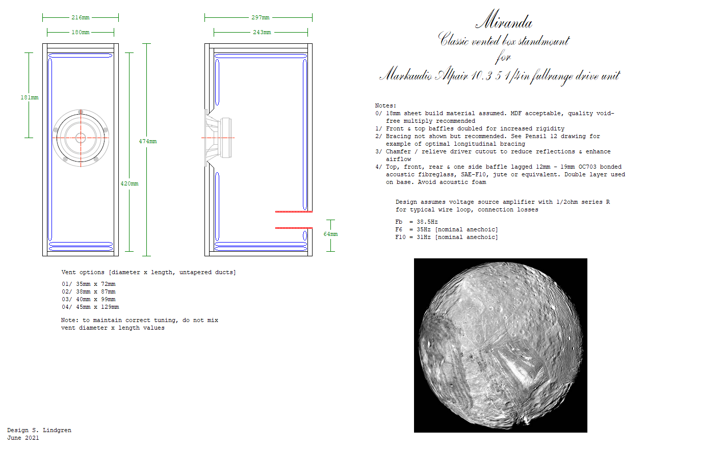

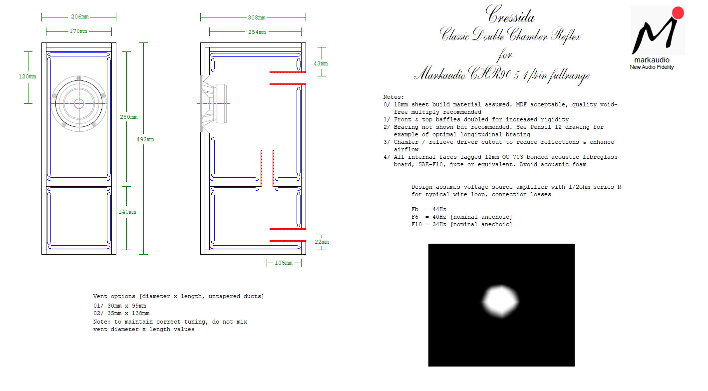

I couldn't think of anywhere else to put these, so here it will be: Umbriel and Cressida -two traditionally aligned vented boxes for the Markaudio CHR90 to go alongside the others I've worked up.
The CHR90 doesn't seem to be well-known, but it's based around a slightly trimmed-down Alpair 10.3 cone with new cap, basket, motor etc. so it has many of the latter's characteristics. Goes in slightly narrower boxes too. And yes, in case anybody's wondering, they are indeed named after two of the moons of Uranus, purely because I have a long-standing interest in the Voyager flights, and I felt like calling them something. 😉

And another dual chamber reflex design too - those are a bit rare. 🙂

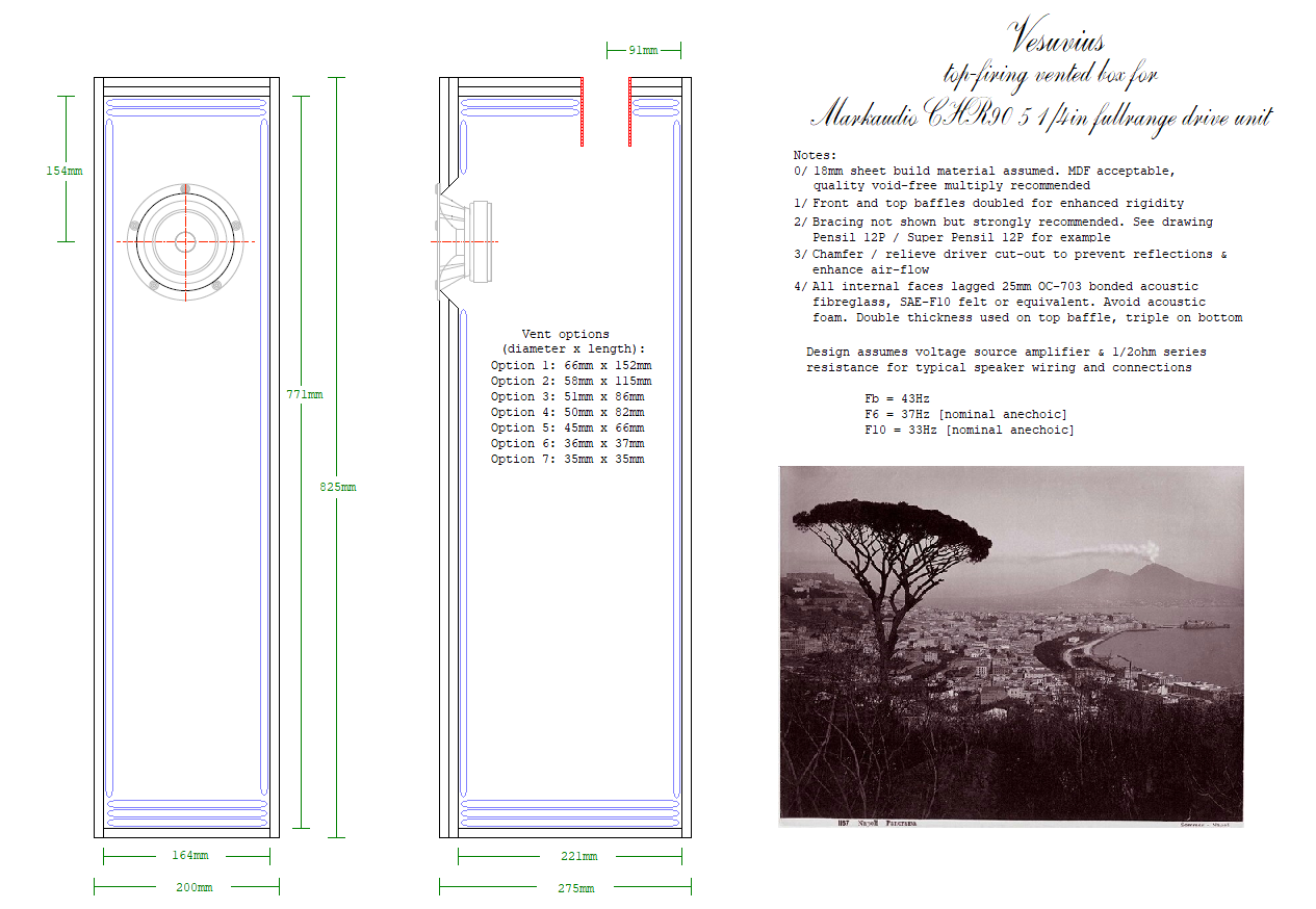

Vesuvius <<=== Put a TIPS sign next to that top firing vent, and you will have your next project paid for!!

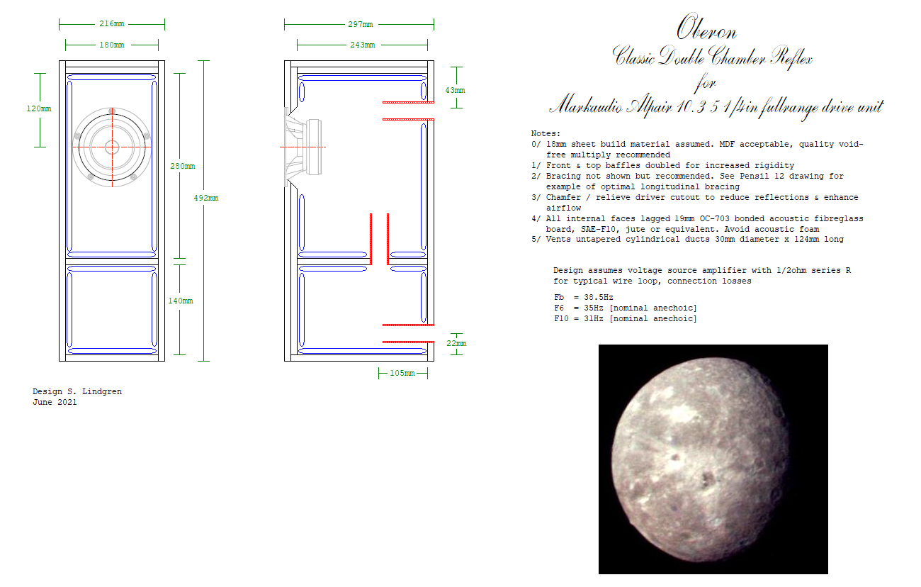

Is theredouble chamber box plan for A10.3?
There used to be. I remember it well, because 'I' (well, my cabinet-building partner in crime) built one a few years ago. I can't find the sketch now unfortunately, but when time permits, I'll work something up.
Thank you, it would be nice to try, have some spare 10.3, but math is not friendly to me 🙂

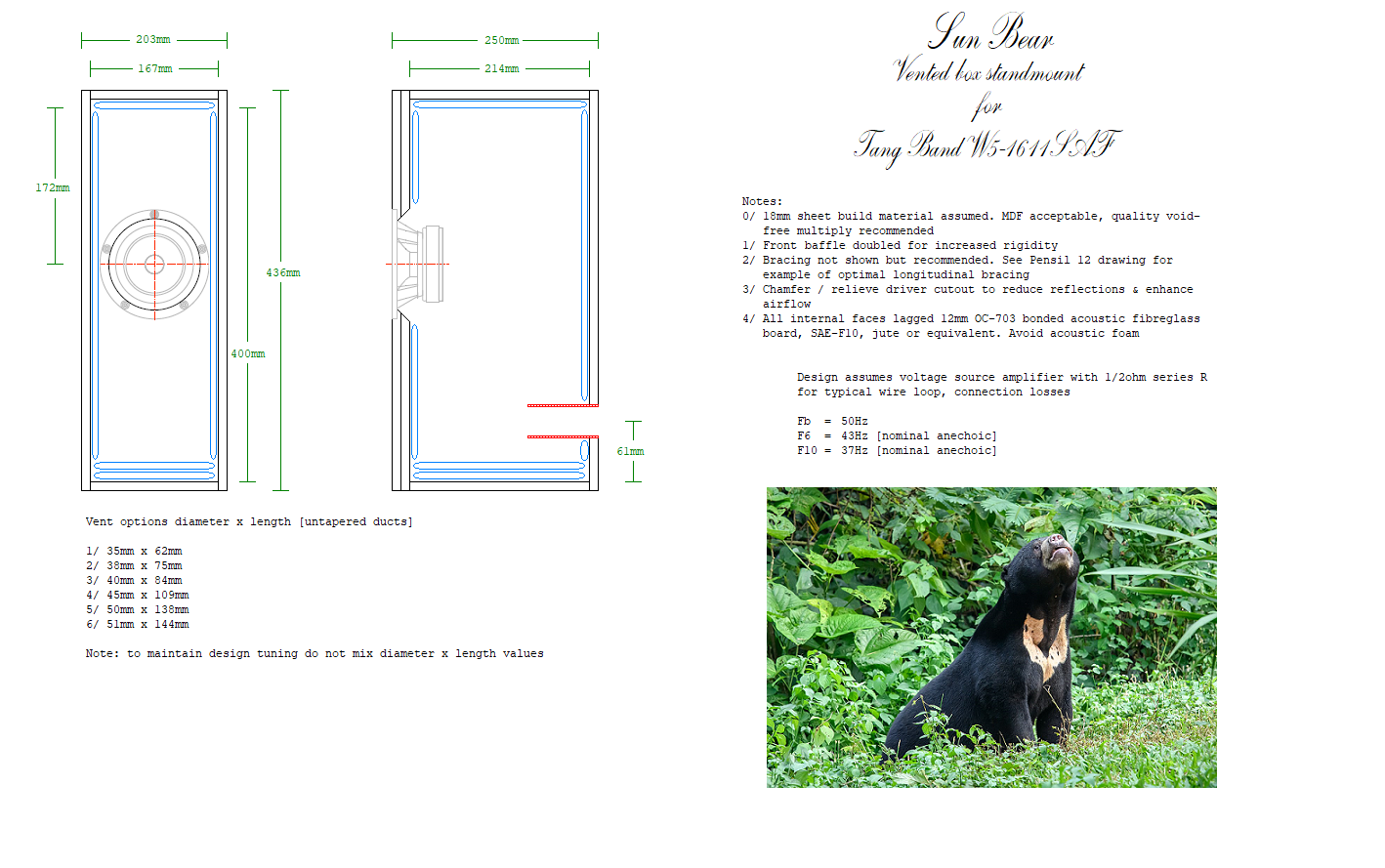

I will be building the Sun Bear cabinet for the Tang Band W5 1611 SAF in the next few days. The design calls for a double layer of the 1/2" jute on the bottom panel.
I have a couple of questions. I use 3M medium strength spray adhesive to adhere the jute to the walls in all of my speaker builds and wonder if using it to glue together two layers to get the required thickness for the bottom panel will block the necessary porosity of the double layer. Should I instead use tacks? Also, out ot curiosity, what is the design reason for the double layer on the bottom?

Since it's at the bottom, frankly I would rely on ye olde faithful standby called 'gravity' and not worry about it. 😉 If you want to put a light spray of the adhesive between the two layers, it won't do any harm. You can increase the thickness of the damping out to 20mm or even 25mm providing you keep it away from the cone (clearance is the issue here), but it may end up being a little over-damped.
Pedantry on my part to a point. It's the largest dimension, so I tend to put a little extra on one to help kill it off. It's at a relatively high frequency, so not too difficult to damp down.

I couldn't find the original, so I re-did it, with a single-chamber design with the same nominal combined Vb tuning. This will actually be tuned a touch lower than the original, with slightly more alignment damping < 100Hz. Apologies for the lack of variety in the sketches which is a matter of convenience (read 'bone-idleness') on my part, as my drawing skills are somewhere south of nill and I have to use an old version of Windows Paint.
