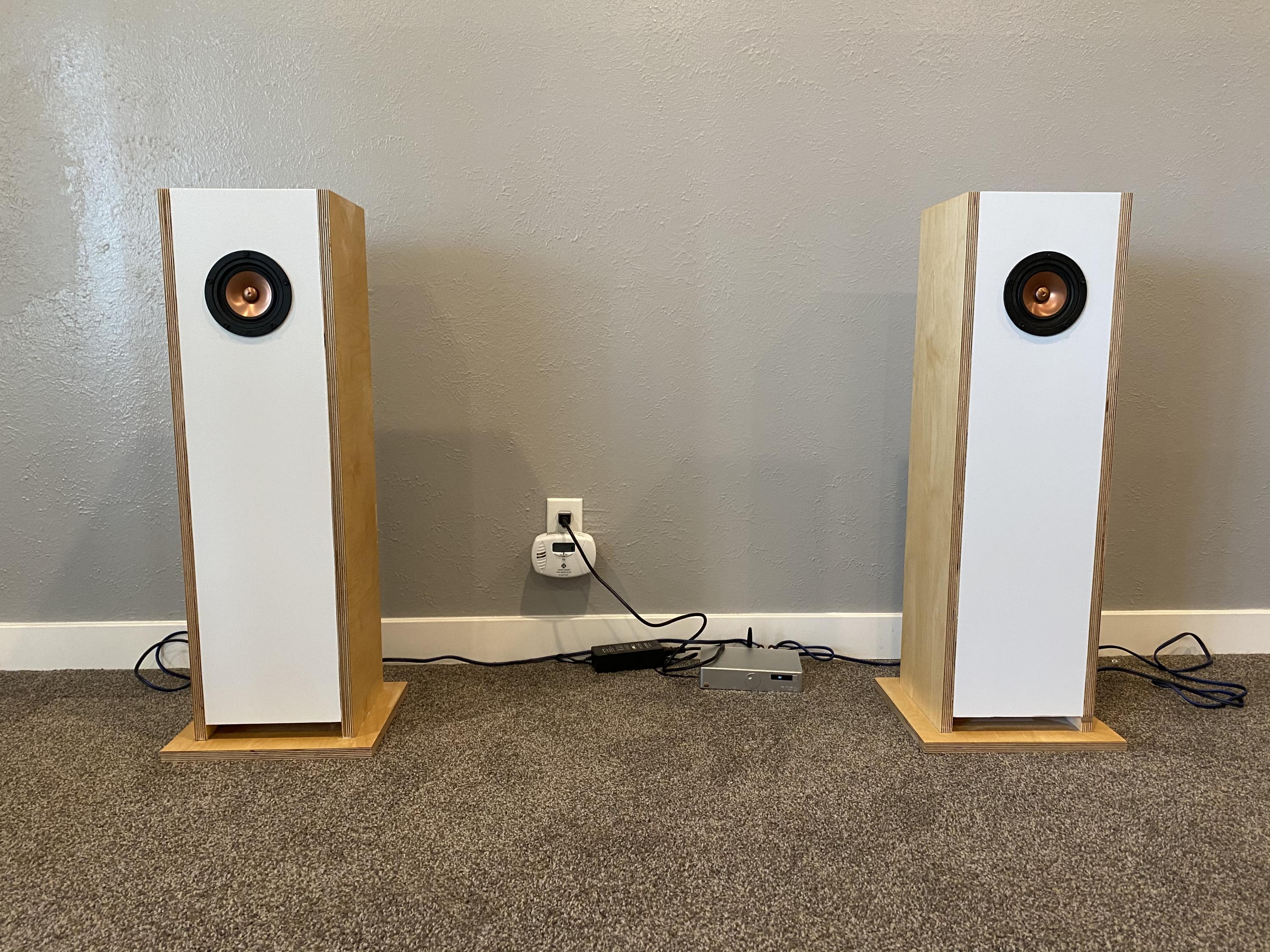

I just finished the compact series chamber tuned floorstander that Scott posted- I thought the design looked cool and went for it. These are my first full range build and I’m very impressed with the sound given the size of the driver. They have a really nice relaxing sound to them and, to my surprise, they did remarkably well with pop and hip hop at lower to moderate volumes. Awesome!
I have one question though - how exactly does this design work? Ive heard of dual chamber reflex but this seems to be three chambers? I’m pretty sure I’m hearing frequencies as high as 250hz coming out of the port.
I really want to try making something with the 11ms drivers now. I am thinking about the nostromo, water Buffalo, or pensil, but can’t decide whether the extra construction efforts for the water Buffalo or pensil would be worth it.
