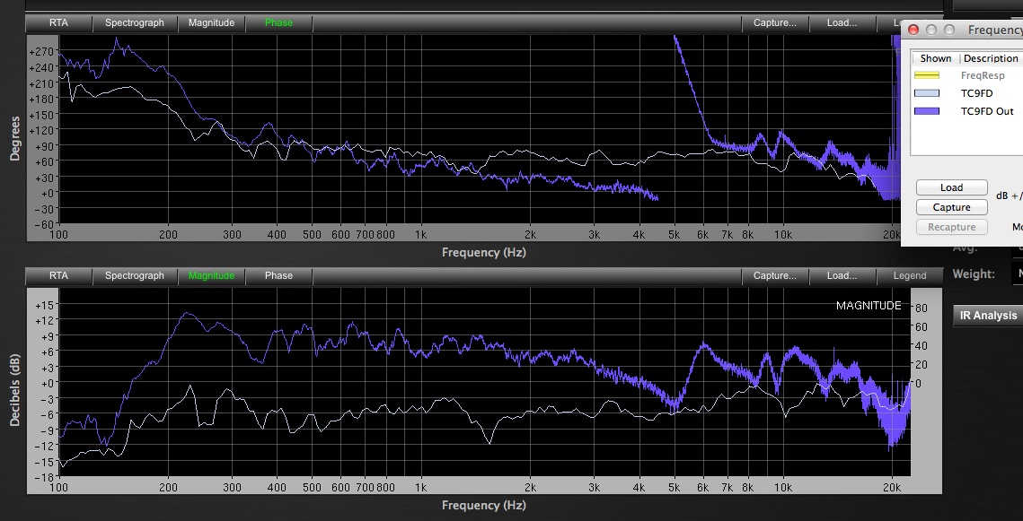

Yesterday I did an A/B listening test between a 3.5" Tymphony TC9FD-18-08 "full range" driver (about $12) and the (relatively) new Eminence N314T-8 (3" diaphragm 1.4" exit), both on my Maltese 13 x 13 degree conical horns. Although the N314T-8 had less HF distortion than any of the HF drivers I have tested (BMS 4550, 4552, B&C DE82, EVDH1A, JBL 2445, JBL 2425) the TC9FD was cleaner sounding. The TC9FD has far more clean output capability in the 500 Hz range than any HF driver I've tested, though my listening test was using a steep crossover at
The TC9FD required more power than the compression driver, but I was amazed at the clarity at the high SPL levels I worked up to. I'm fairly used to the distortion level in speakers telling when to back off, but the TC9FD gave almost no indication of distress until the voice coil melted the glue off the former and it "gaacked" out over about a 1 second period.
Prior to the TC9FD letting out the magic smoke, it had survived several songs averaging 120 dBA slow at one meter, with peaks of up to 126 dB. The driver is only rated for 30 watts (IEC 2685, whatever that is) so considering the SPL, amazing that it lasted as long as it did, peak power was in the 200 watt range.
The results were impressive enough that I will be doing further experiments with wider dispersion horns with dual TC9FD and throat vanes to determine if uniform dispersion can be achieved.
The chart below shows the response of the TC9FD in a sealed (approximately) one liter chamber and on the Maltese horn with the same chamber. My measurements confirm the specified 1w1m sensitivity rating of 83.5 is correct, the horn raises sensitivity around 96.5 dB midband.
Art
