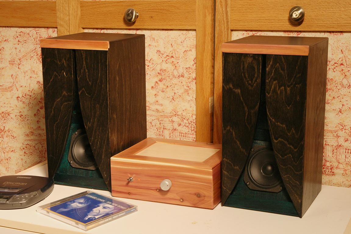

Well my mini's are almost finished and I am thrilled 😀
Thanks X and everyone else for all your help.
Prezden,
Those look fantastic! (They look done - what is left to do?)
