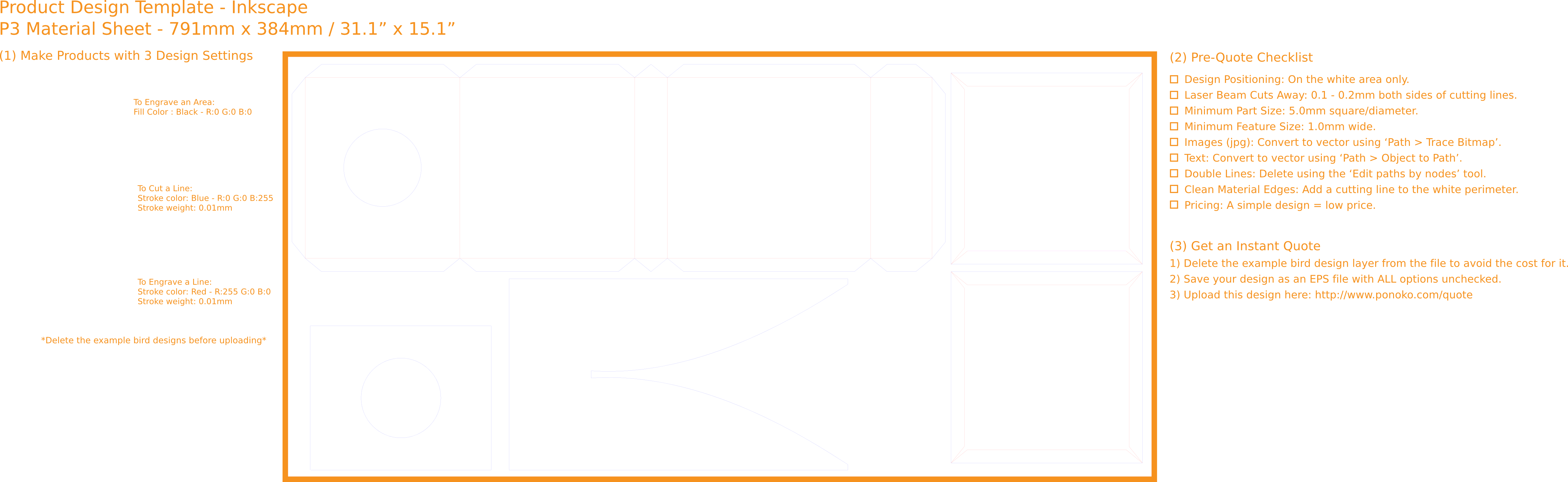

Cut sheet for A1 (can also be used for laser cutting)
Have trawled through the thread and everyone's super useful comments / tips, thanks!!
These are based on BL21DE3 0.4x and build on the one piece internal method from grandcalmar, making the whole wing/case from one piece too
The wing / baffle supports are rotated by 90 deg for materials like cardboard that are strong in only one direction
They're sized for a Visatron FRS8 and P3 material size (slightly smaller than A1) and can be used with Ponoko / Razorlab. If you need the SVG / EPS files PM me.

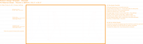

Am hoping the fold and flaps approach will..
Even with the 0.4x you hit the maximum printing size, but with a slightly bigger material size you'd be able to make the whole case from a single piece
I've submitted the file to razorlab and waiting on them to process and print, will give an update soon
- replace the need for bracing
- result in an airtight enclosure with less effort
- compensate for possible tolerance errors in the laser cut

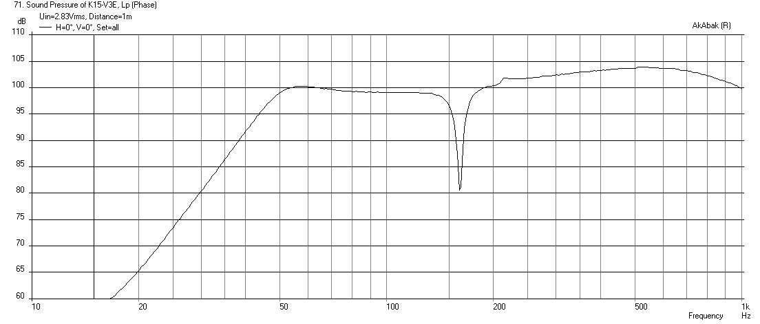

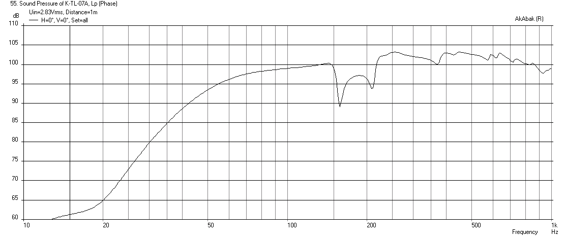

Freddi,
Here are the sims for the P-audio driver with a K15 and 1.10x scale Karlsonator.
K15:
1.1x Karlsonator:
I think the K15 looks better in terms of bass punch, but the Karlsonator has a smoother roll-off that might sound more hi-fi.

The Karlsonator likes a moderate Qts driver for good bass extension. The low Qts has a slow roll off. In a K15 however, low Qts is king. I can get you predicted impedance plots non problem. The P-audio may also like to have more volume - is your 1.1x scale accurate?
Your measurements show a bass roll off starting at 100Hz. Is that comparable to other drivers you have? I seem to recall a K15 having no problem hitting 60Hz.
