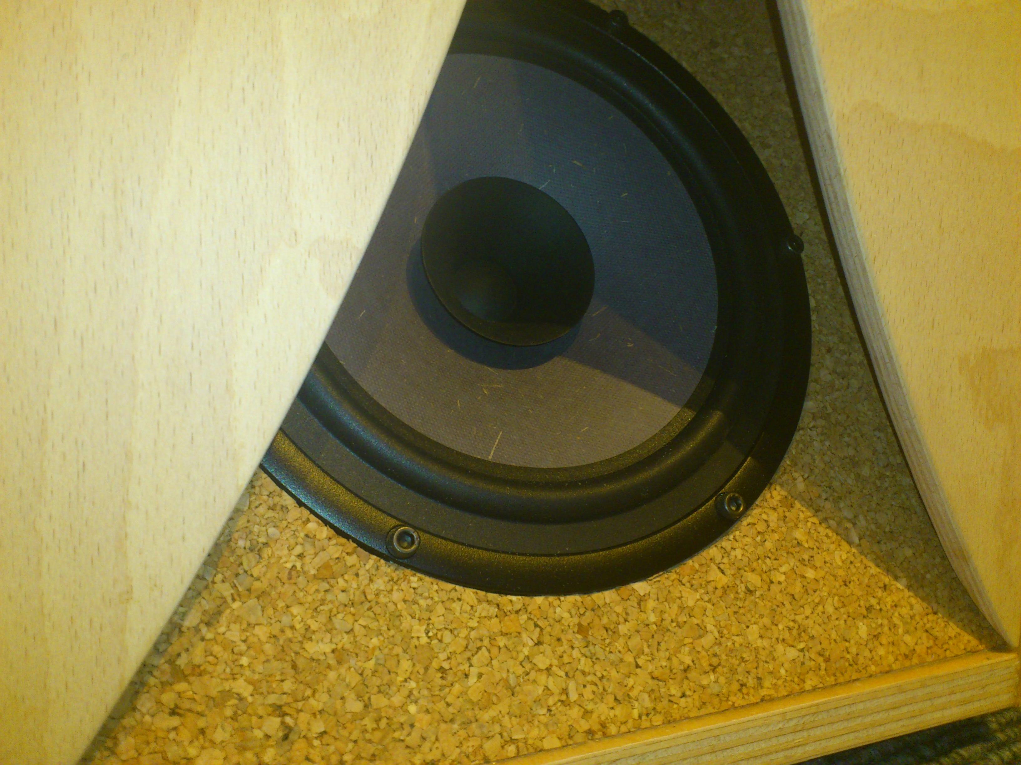

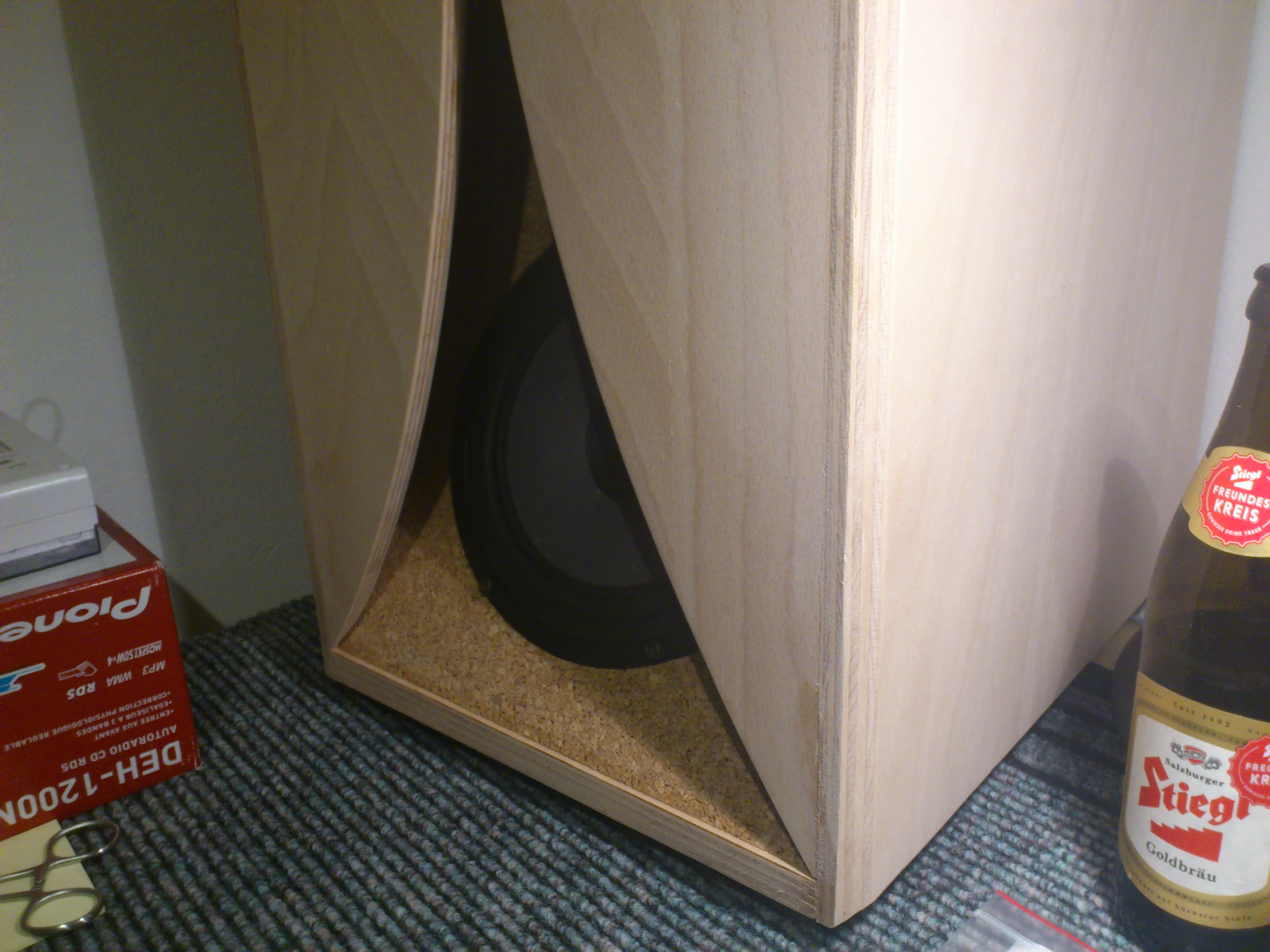

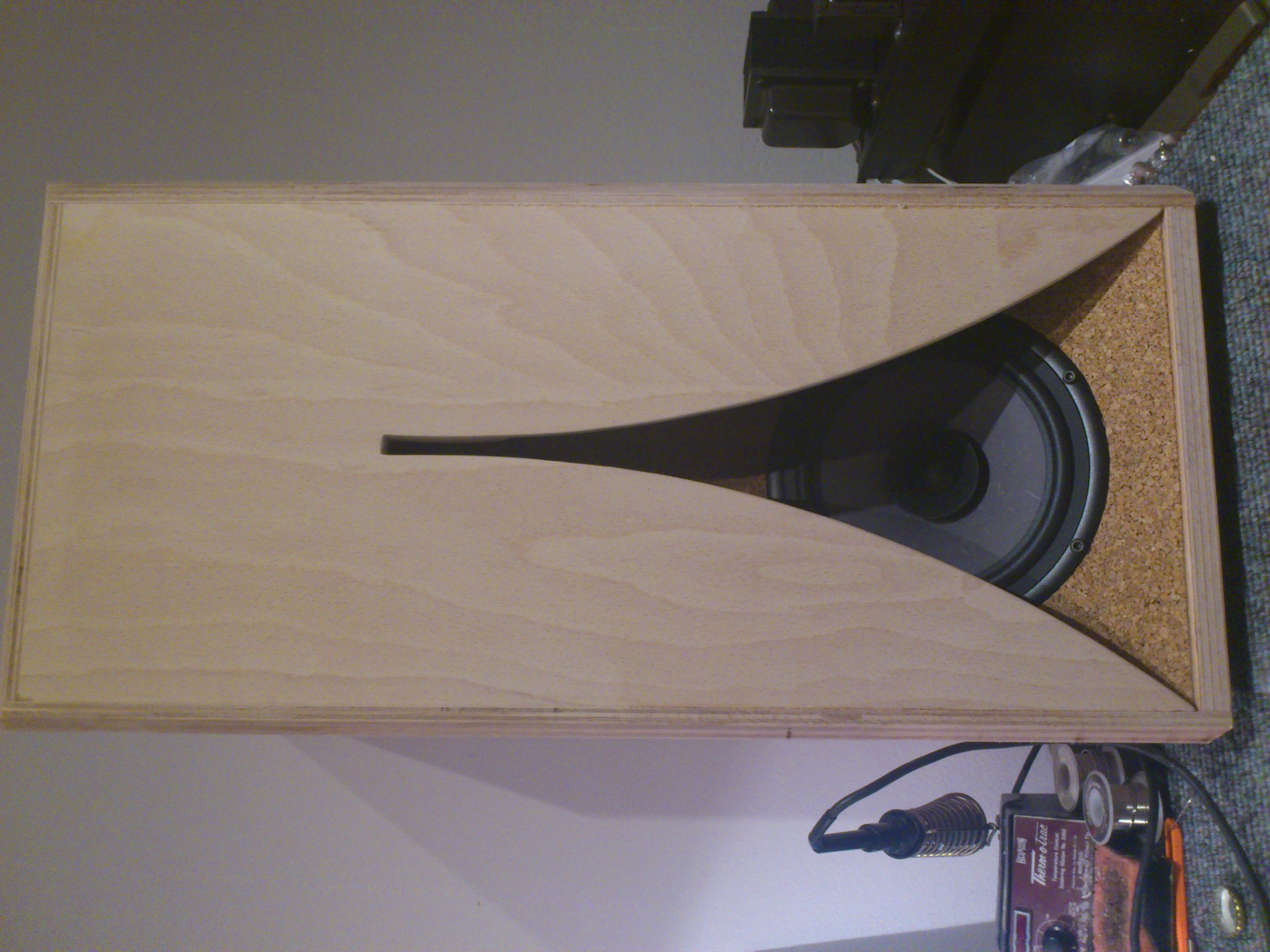

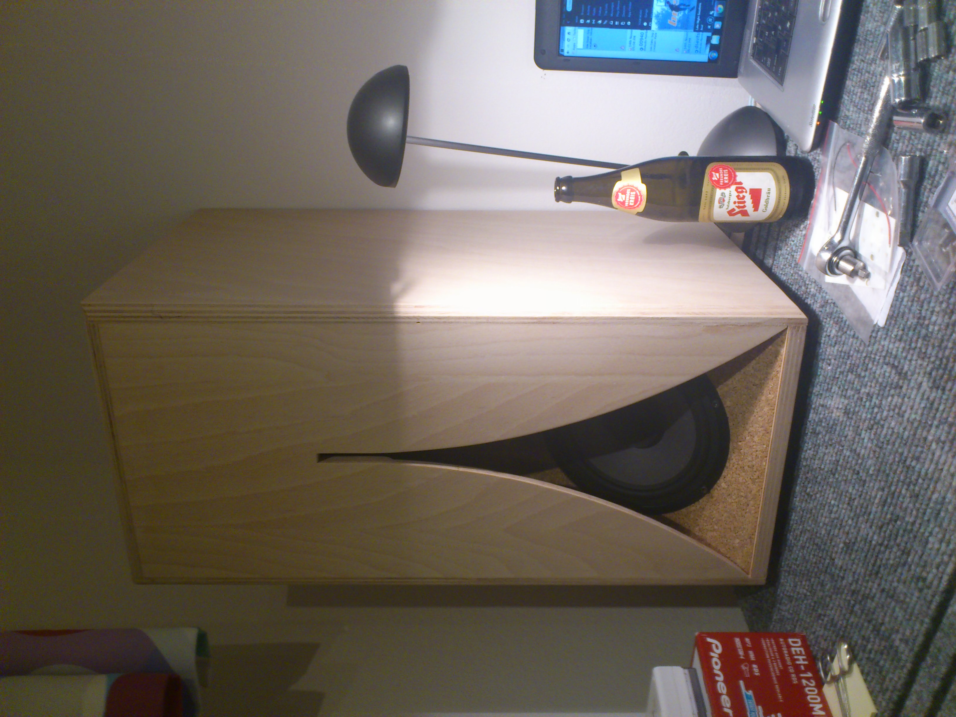

The FC construction is super easy. Cut one long strip the width of the speaker, then crease and fold it to match the design drawn on the side panel. Glue one section at a time starting with the back, then bottom, then driver baffle, then part above driver and then the duct and internal divider. It is one long piece with no cuts. Use hot melt glue so your hands can be the clamps (for 40 seconds). Then glue on the opposite side panel. Then the top. Make sure you add bracing along the way. Then add the K aperture. A FC K aperture sounds better than a stiff wooden one.

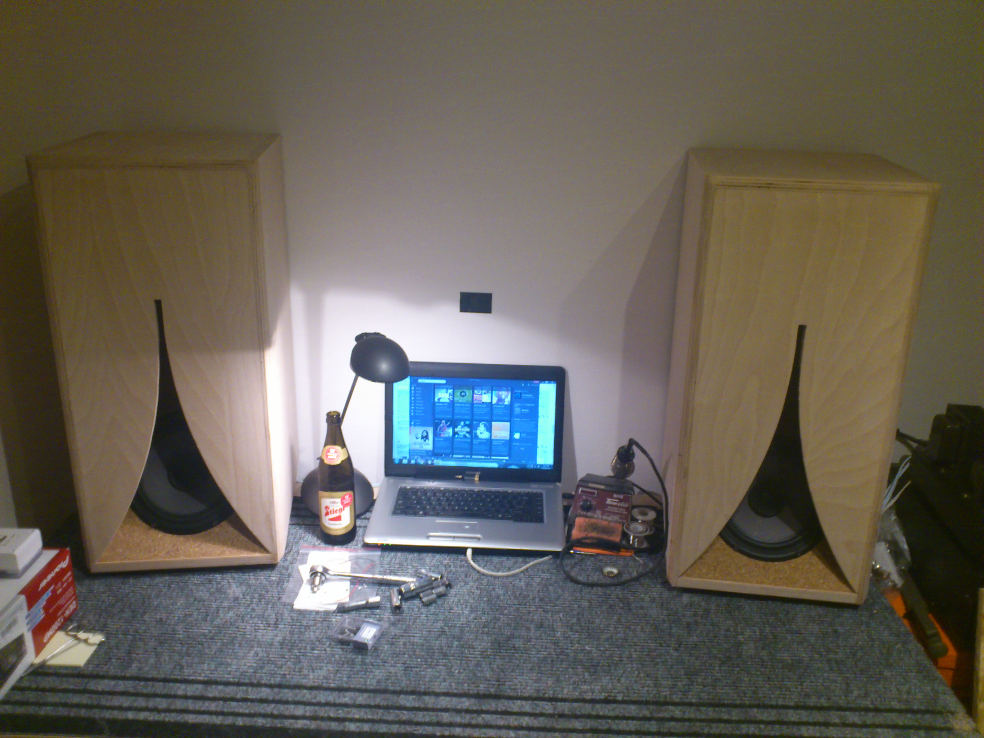

So... 90% there! Just a bit of finish sanding and lacquer and done!

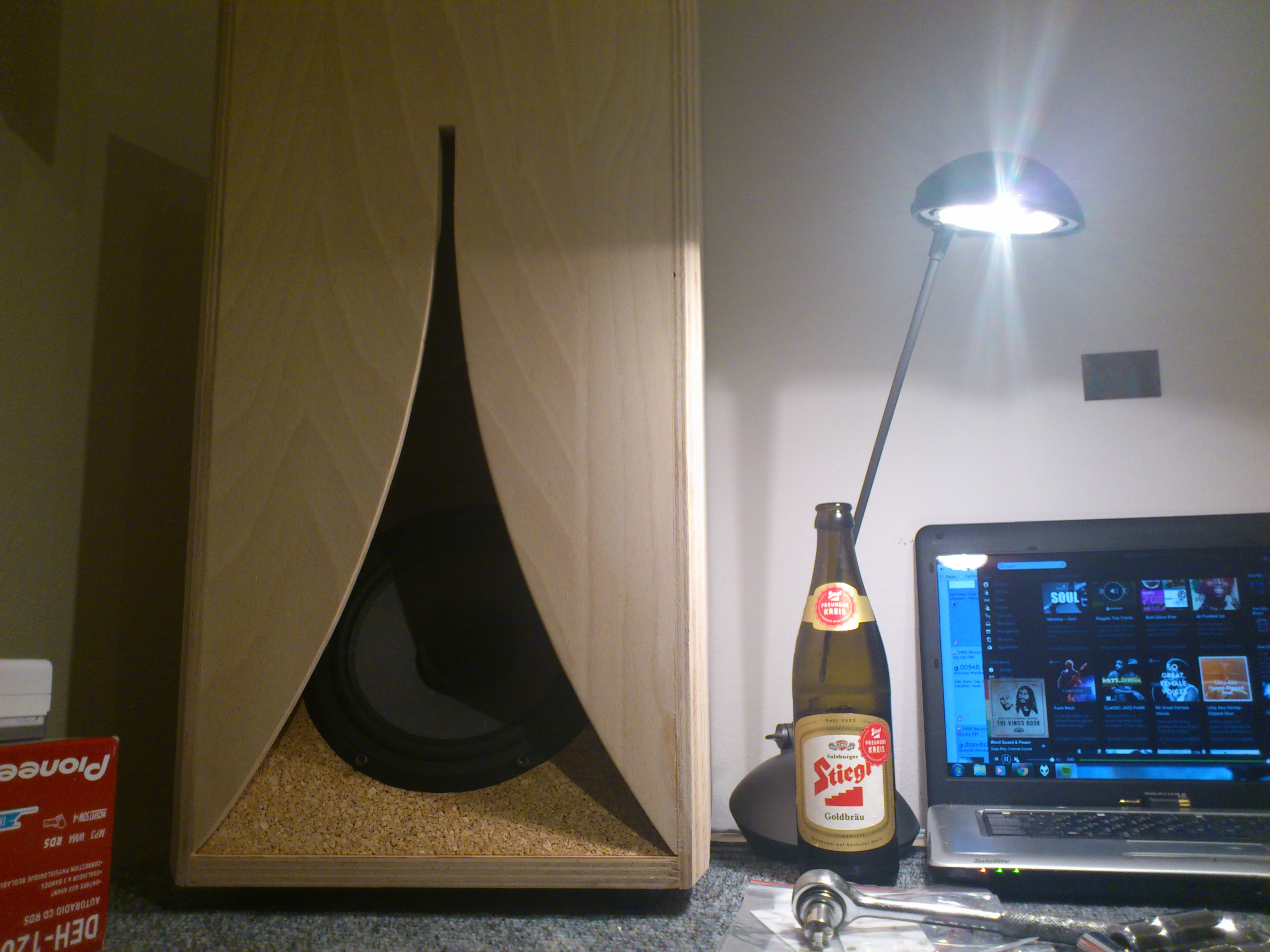

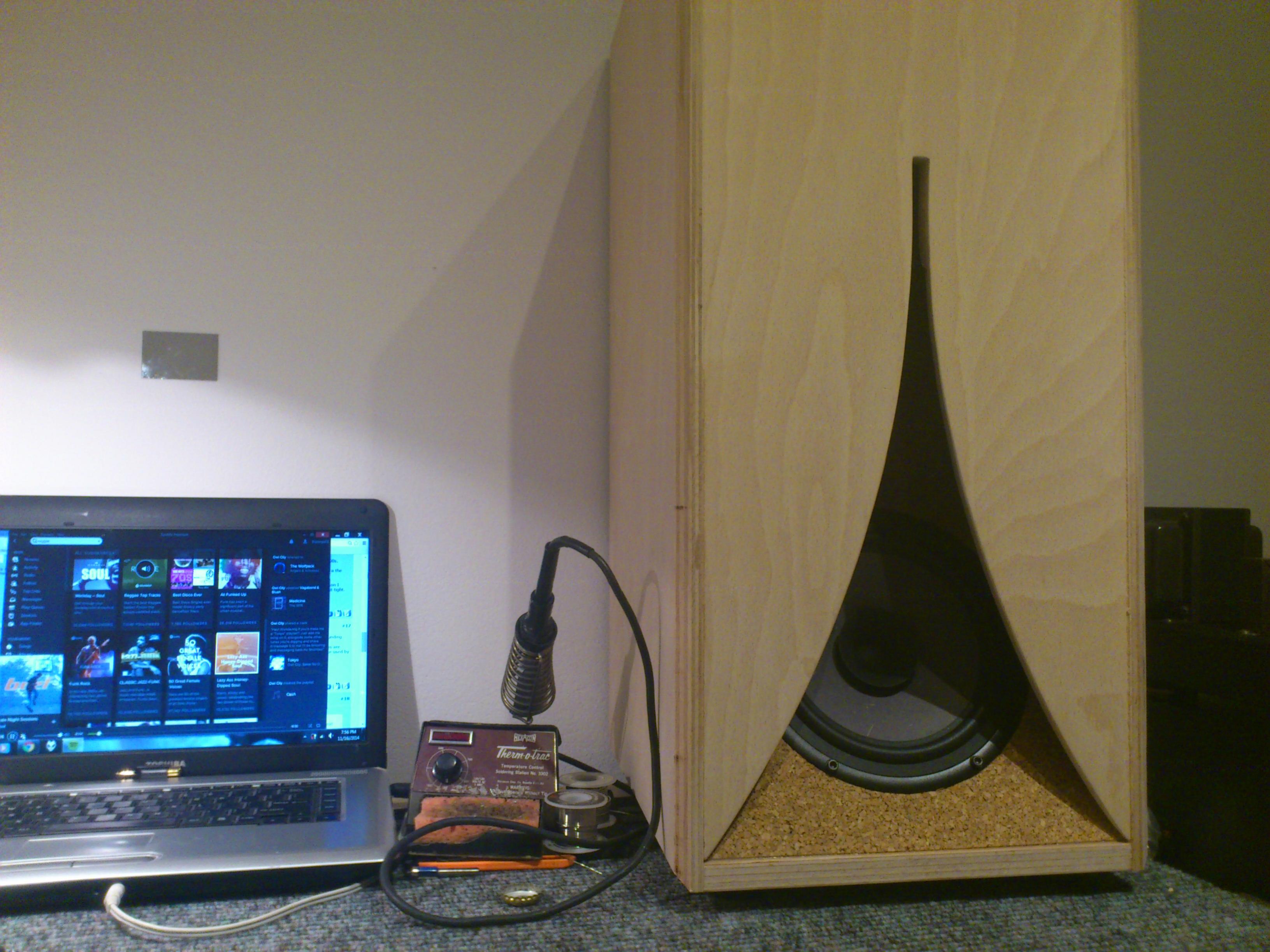

I could not help but hook them up for a test run. "desktop speakers they are NOT".

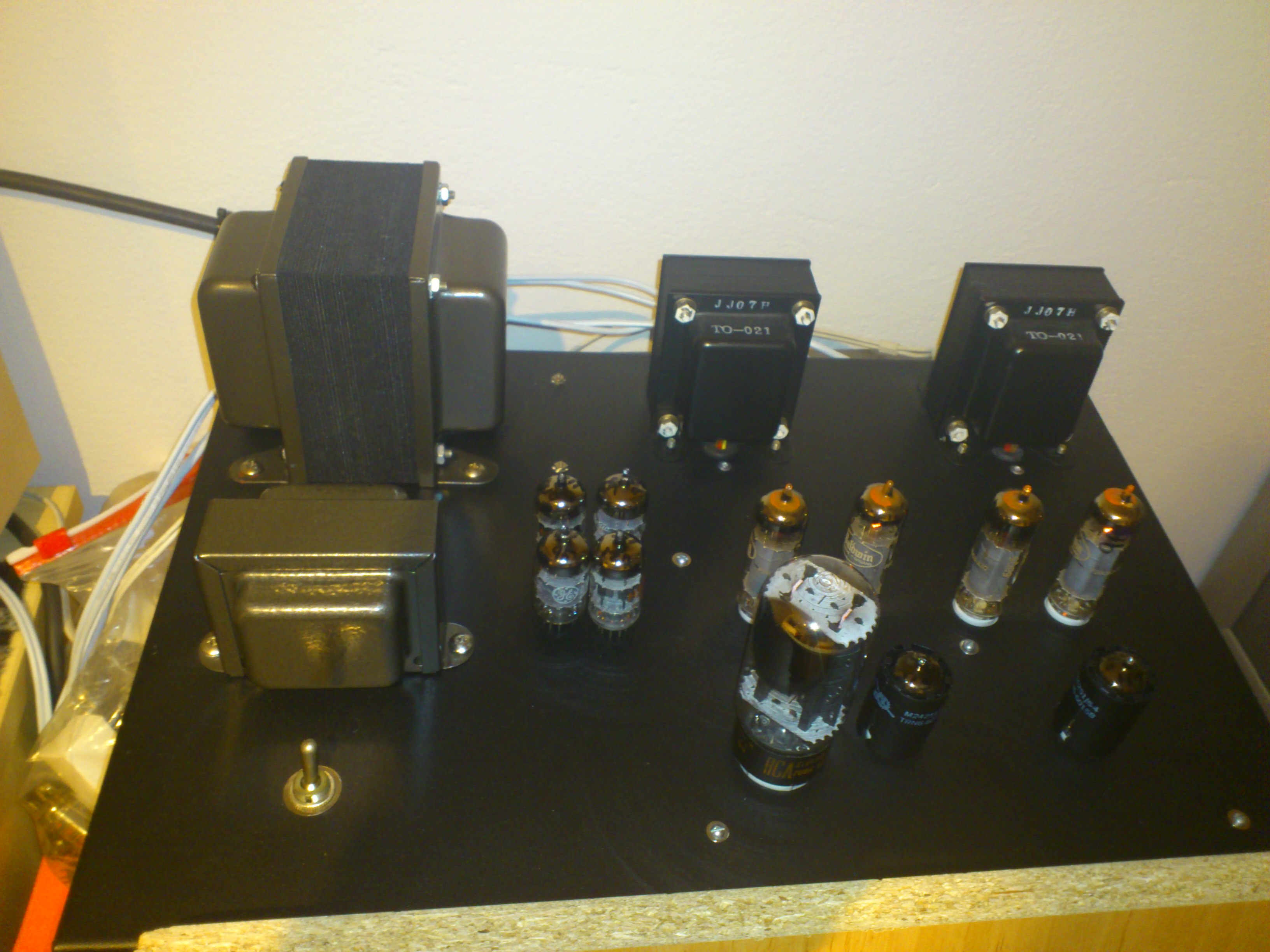

First impression is BASS! In spades. Using a tubelab simple pp at the moment.
Thanks for all of the guidance guys, these are great.
Xrk971, you were right, I am pretty sure they get down into the 40's with the SEAS FA22RCZ..

WoW! - they look fabulous - hows the highs and mids on your SEAS? how does it sound on percussion ? - the aperture on these things can sometimes be extended to full height when it comes to a tapered point. here's a regular Karlson type 2-way K18 of mine to illustrate

Beautiful job on the speakers! Glad they turned out to sound nice beyond your expectations. 40Hz is not too shabby 🙂 can you refresh out memory - is this 0.53x scale?

the beverage bottle is probably around 9" tall so they might be made from Greg B's original Karlsonator8 plans https://lh6.googleusercontent.com/-...0g/hi5Qd7SIw6Q/w878-h690-no/Karlsonator-8.png

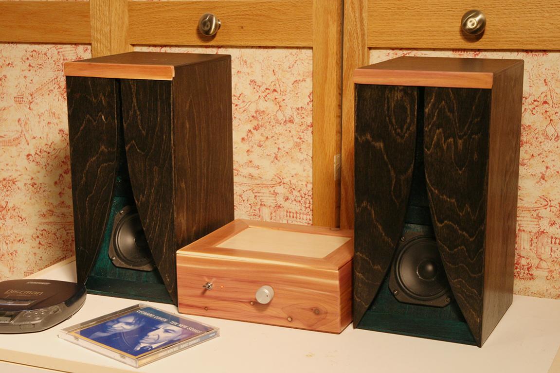

Well I have had more time to listen to a wide variety of music on this system.
So far the only sources I've tried are a portable Sony CD and an iPod Classic 5.5. I and some friends have been very impressed with the sound 😀
I never thought I would hear mp3's sound this good. There seems to be something about these 3116 that improve the sound of the mp3 files.
Thanks to all for making it possible for me to build such a great sounding stereo 🙂🙂
IIRC, mctavish made the official (LOL) Karlsonator 8, which is approximately 85% scale overall, but stretched around a bit to make it play nice with an FE206EN in sims. (90%H x 79%W x 86%D)

Very nice looking little desktop system you've made there prezden. I am very glad you are enjoying it. 😀
Those look fantastic! Glad you like how they sound and how the amp works with them. Unbelievable value for $24 in drivers and $20 in amp.
that's incredible value and a beautiful little set of speakers.
