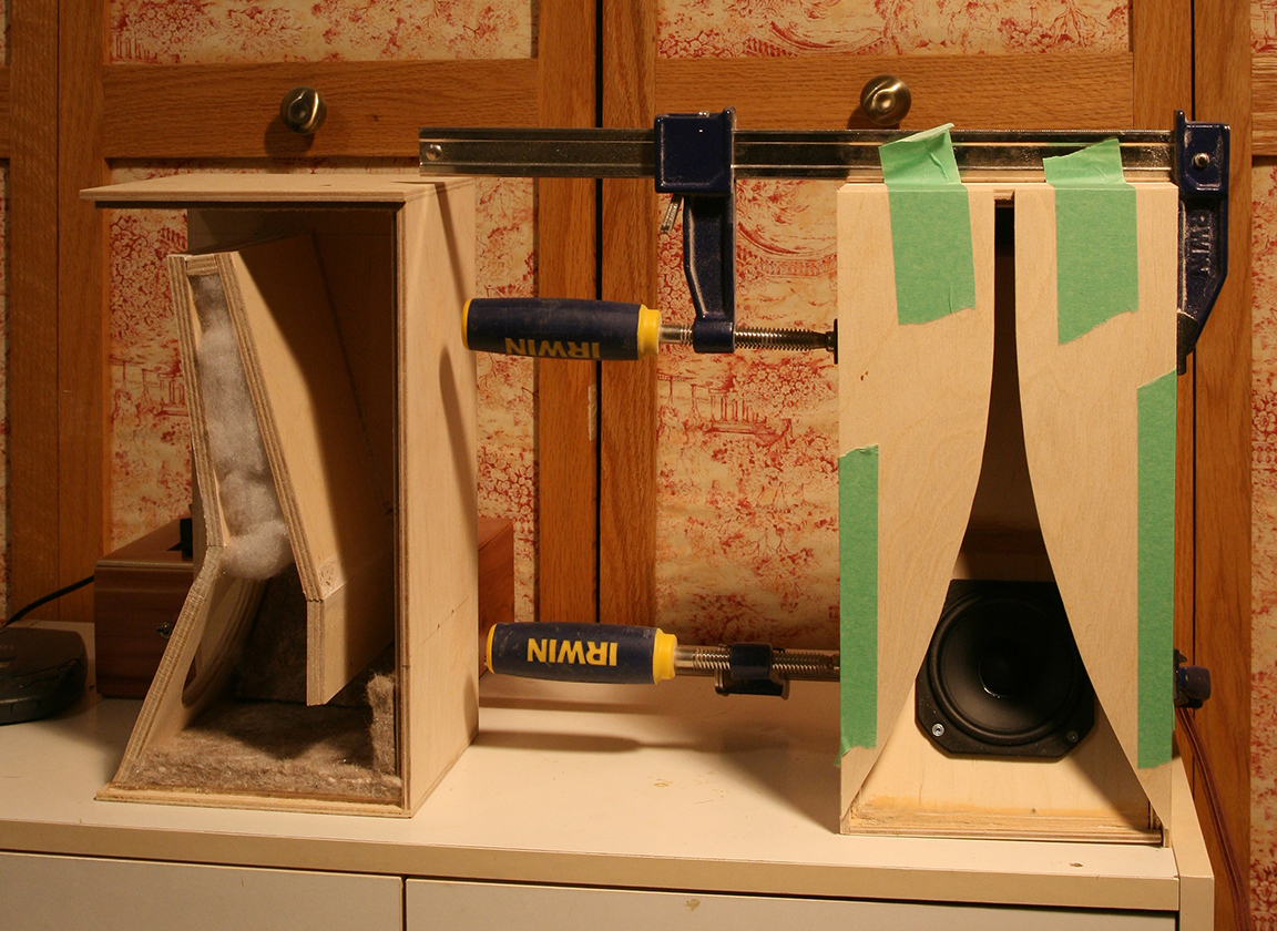

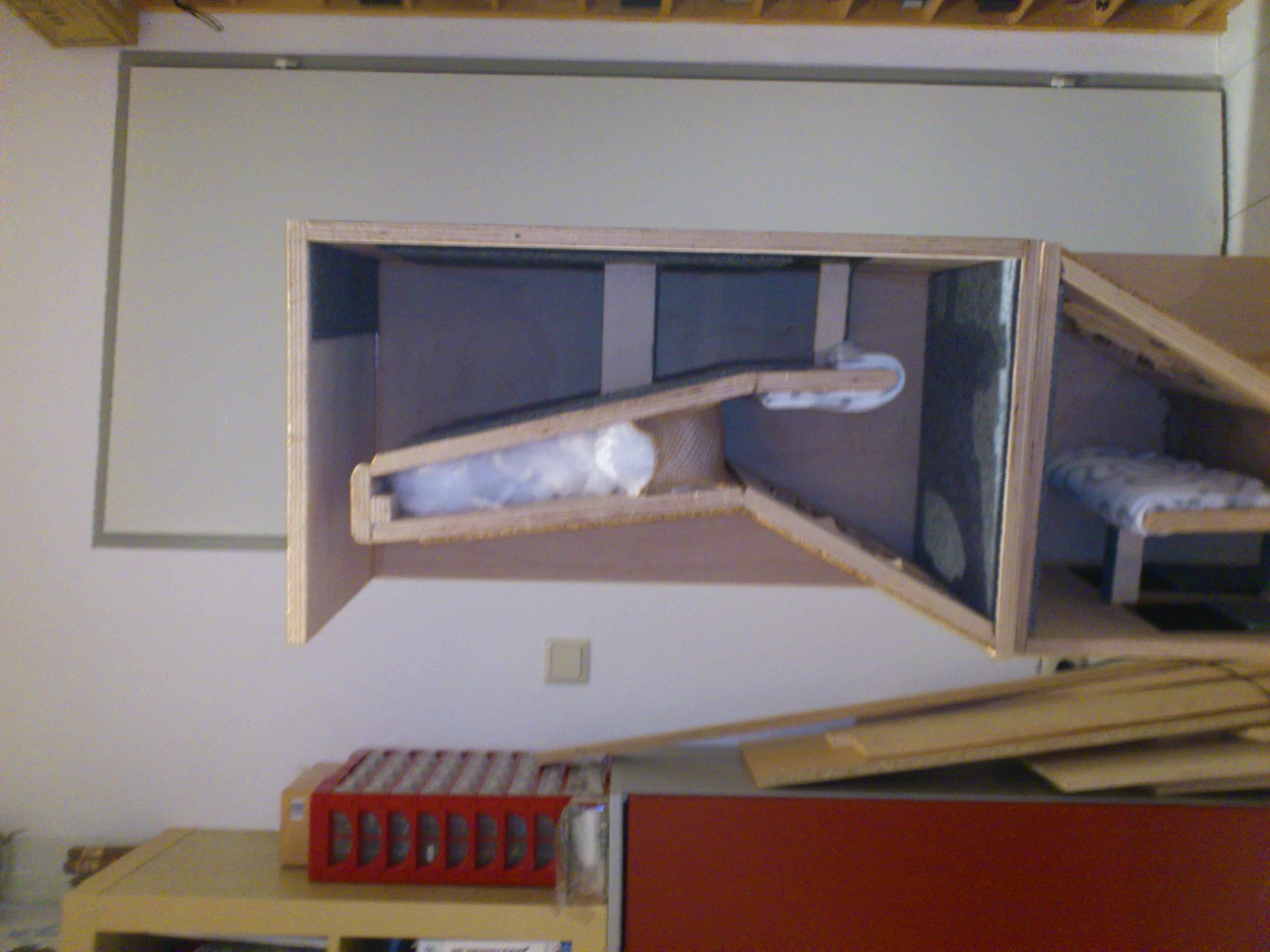

Thanks guys- they are coming along well. Here is the final stuffing and one clamped and taped together. Sounds very good with some Lisa Gerrard. Amp is a slightly modified "weiner"
Any advice before I close them up please.
Looks great. One more piece of felt on divider wall right behind drivers. That one is key to reducing reflections back onto cone. Optional is a piece of felt at top panel but not to obstruct vent.

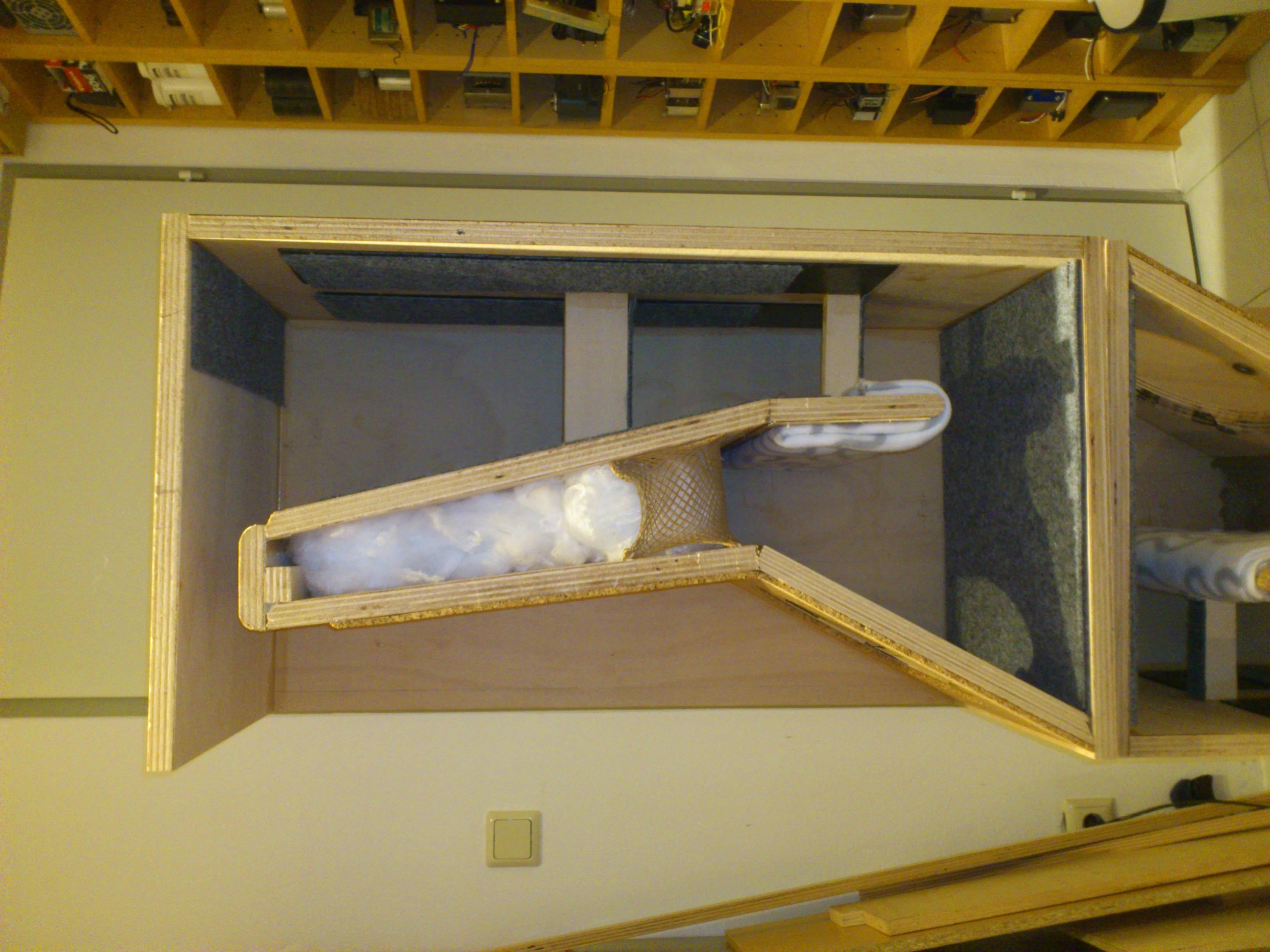

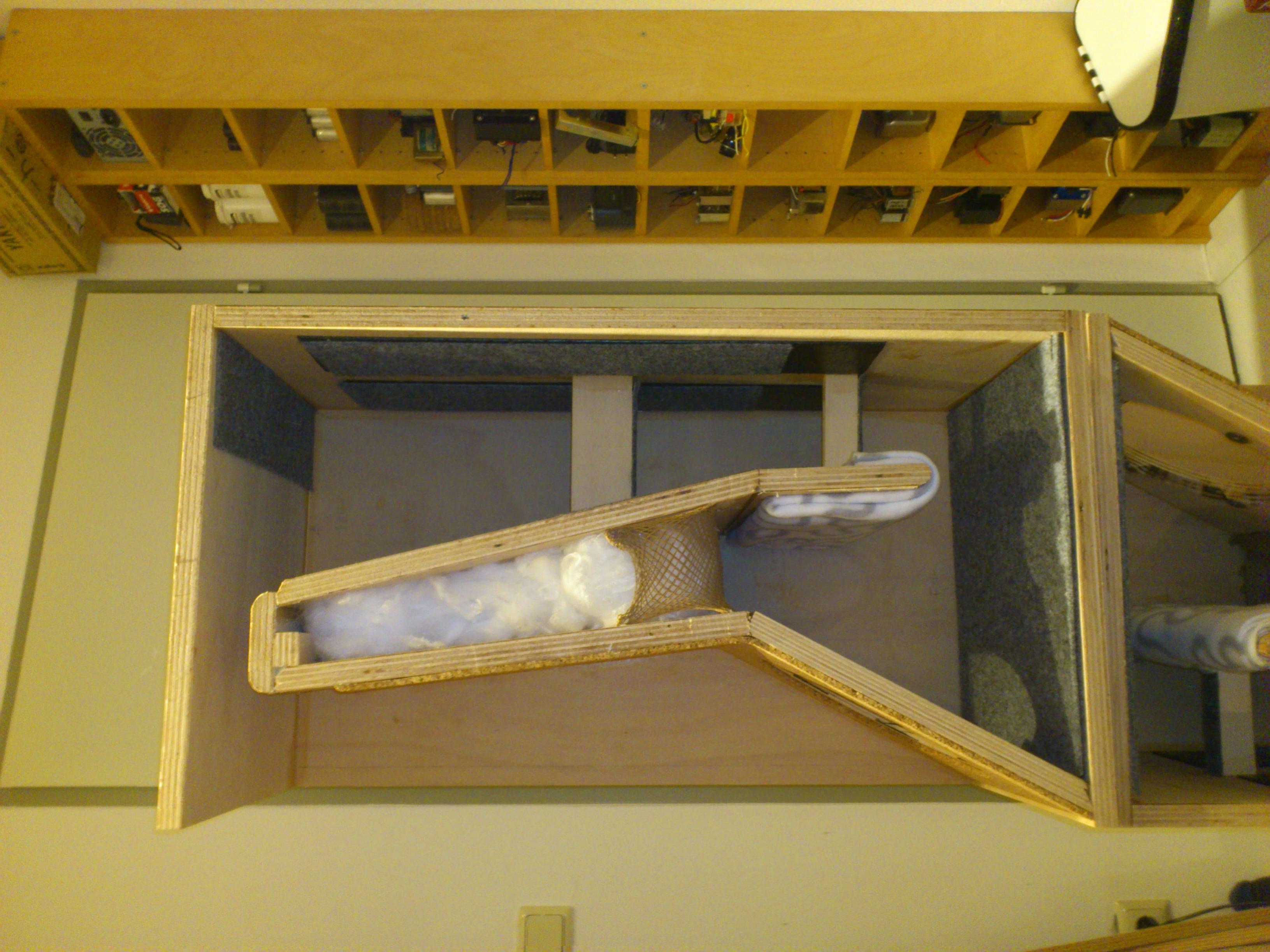

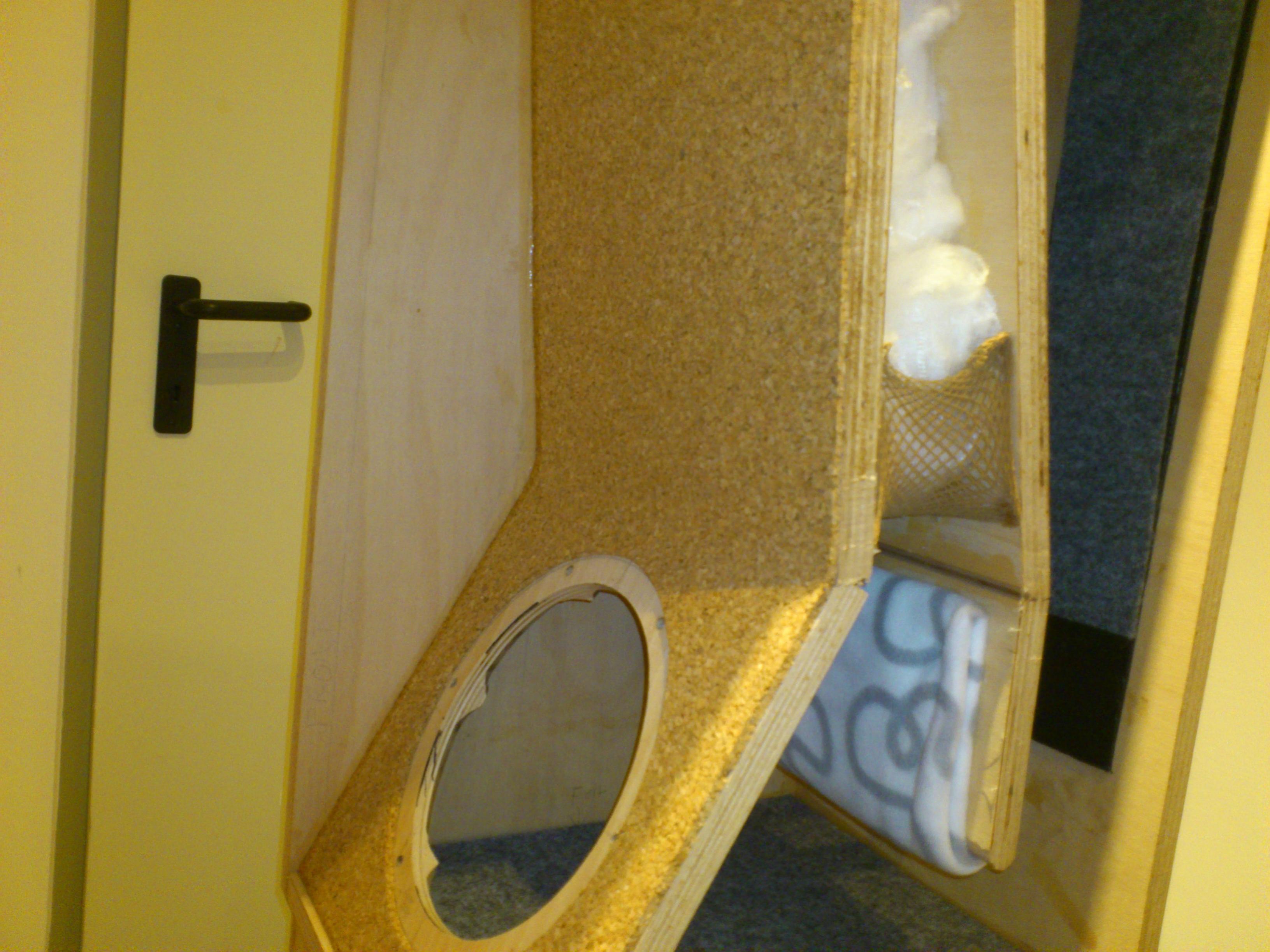

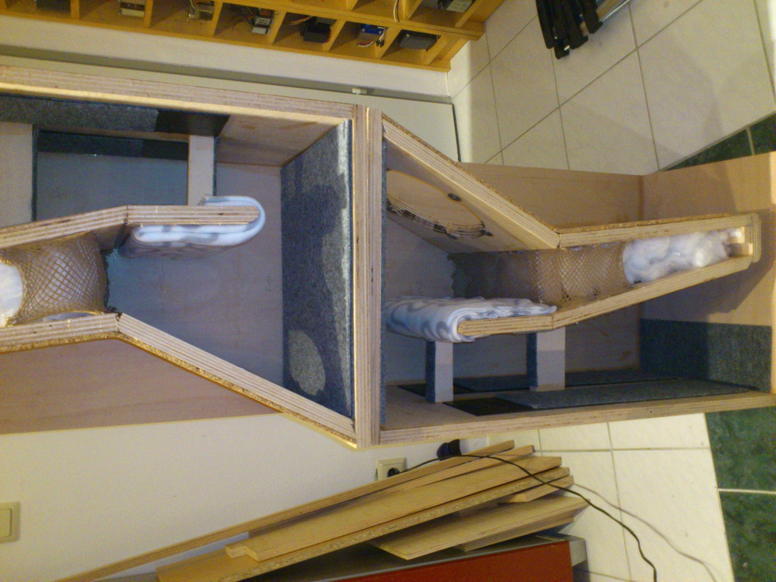

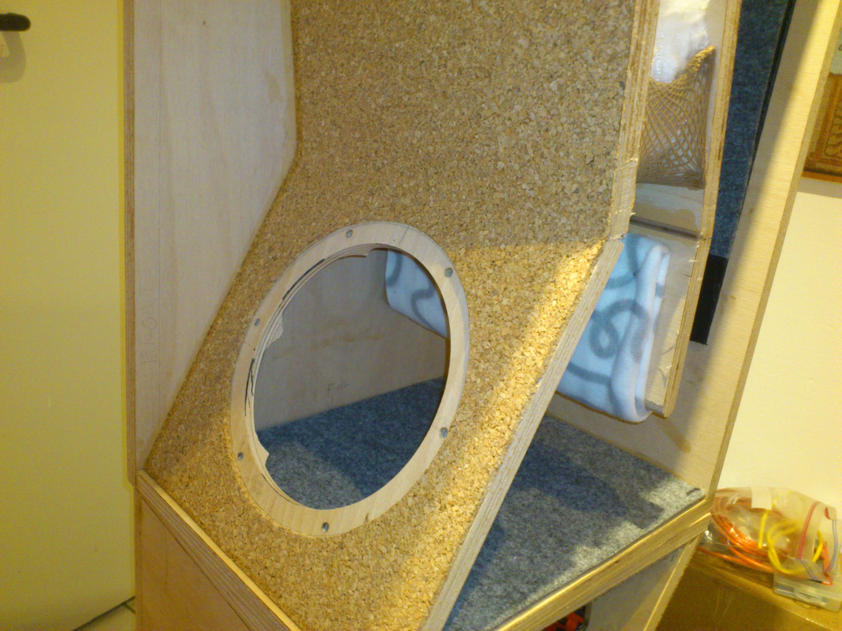

Almost there!!! Some more dampening on the sides and bottom and it's time to close em' up!
A big thanks to Freddi for the inspiration and to Xrk971 for the sims, soon there will be music
