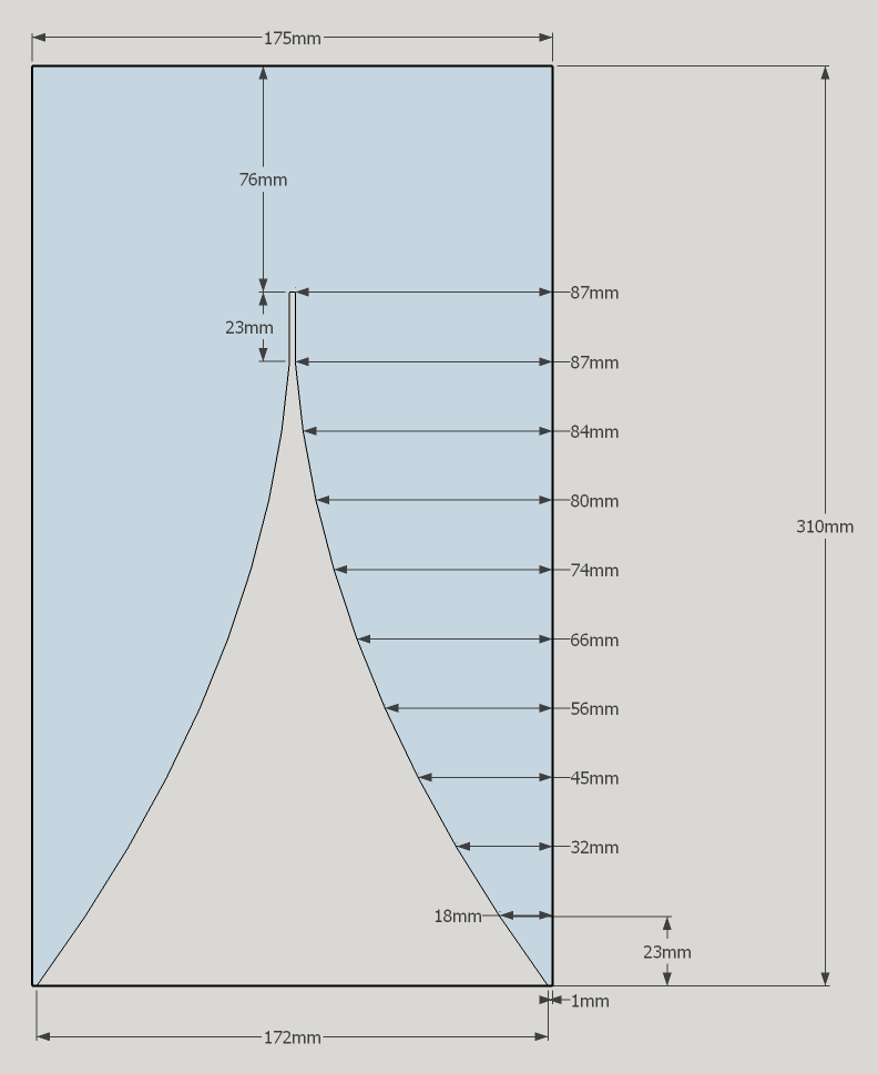

I'm having an issue finding the dimensions for the single driver Karlsonator 😱. I probably went past it a couple of times, but I can only find the dual driver drawing (6.5 inches wide X 12.2 inches high X 6.9 iches deep). Will someone steer me to the single driver box?
Also, is the driver(s) centered on the baffle?

Thanks to BL21DE3 (Blaides) for the drawings...
http://www.diyaudio.com/forums/full-range/239338-mini-karlsonator-0-53x-dual-tc9fds-56.html#post3880182
EDIT: Nevermind. What I'm seeing is the single driver config is 6 inches wide by 12 inches high.
