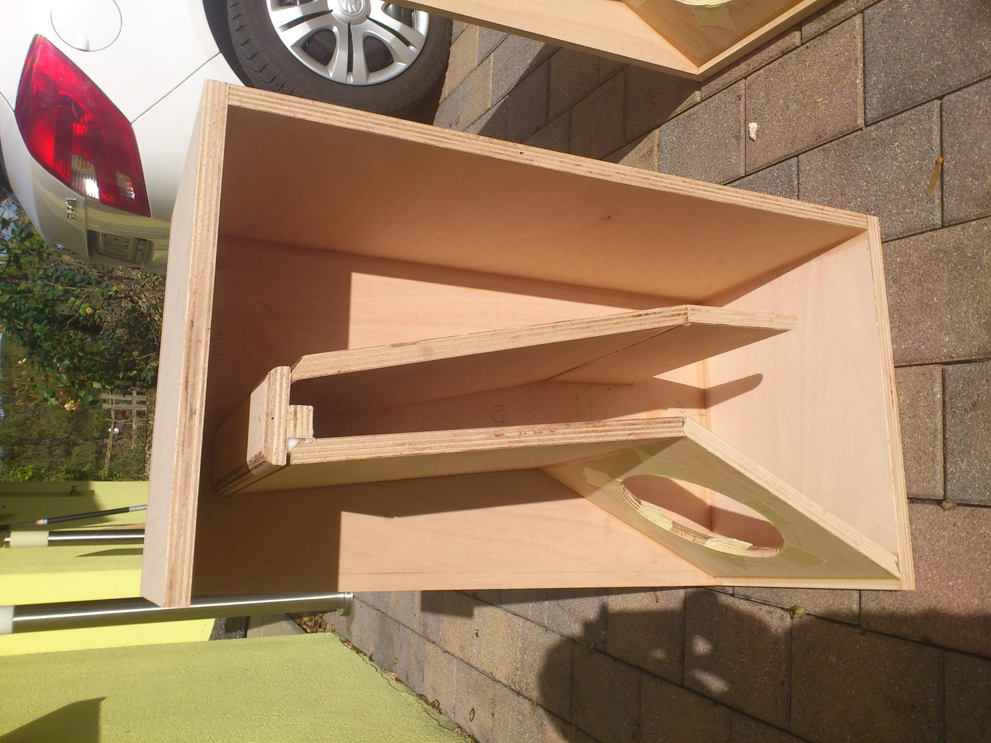

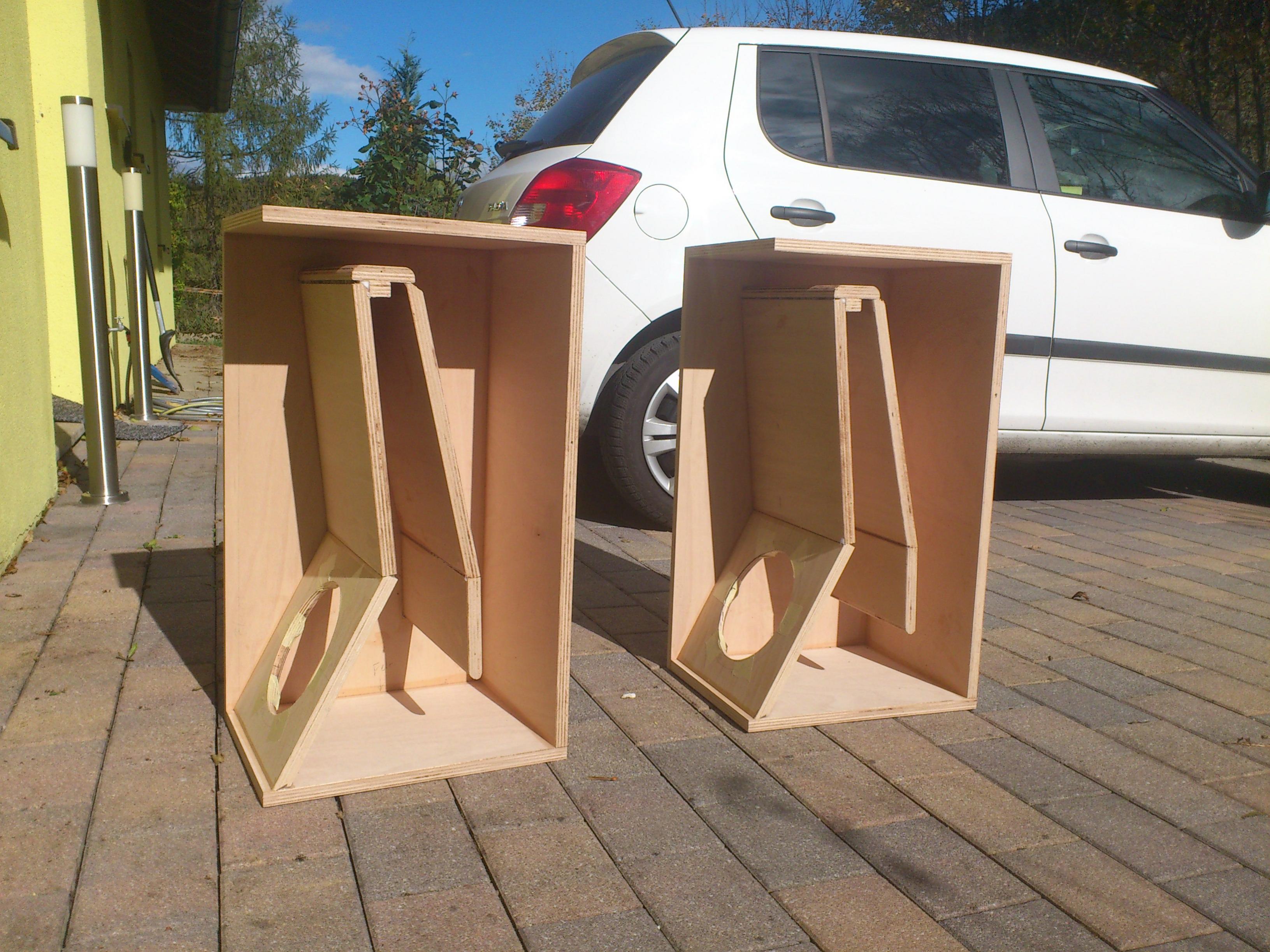

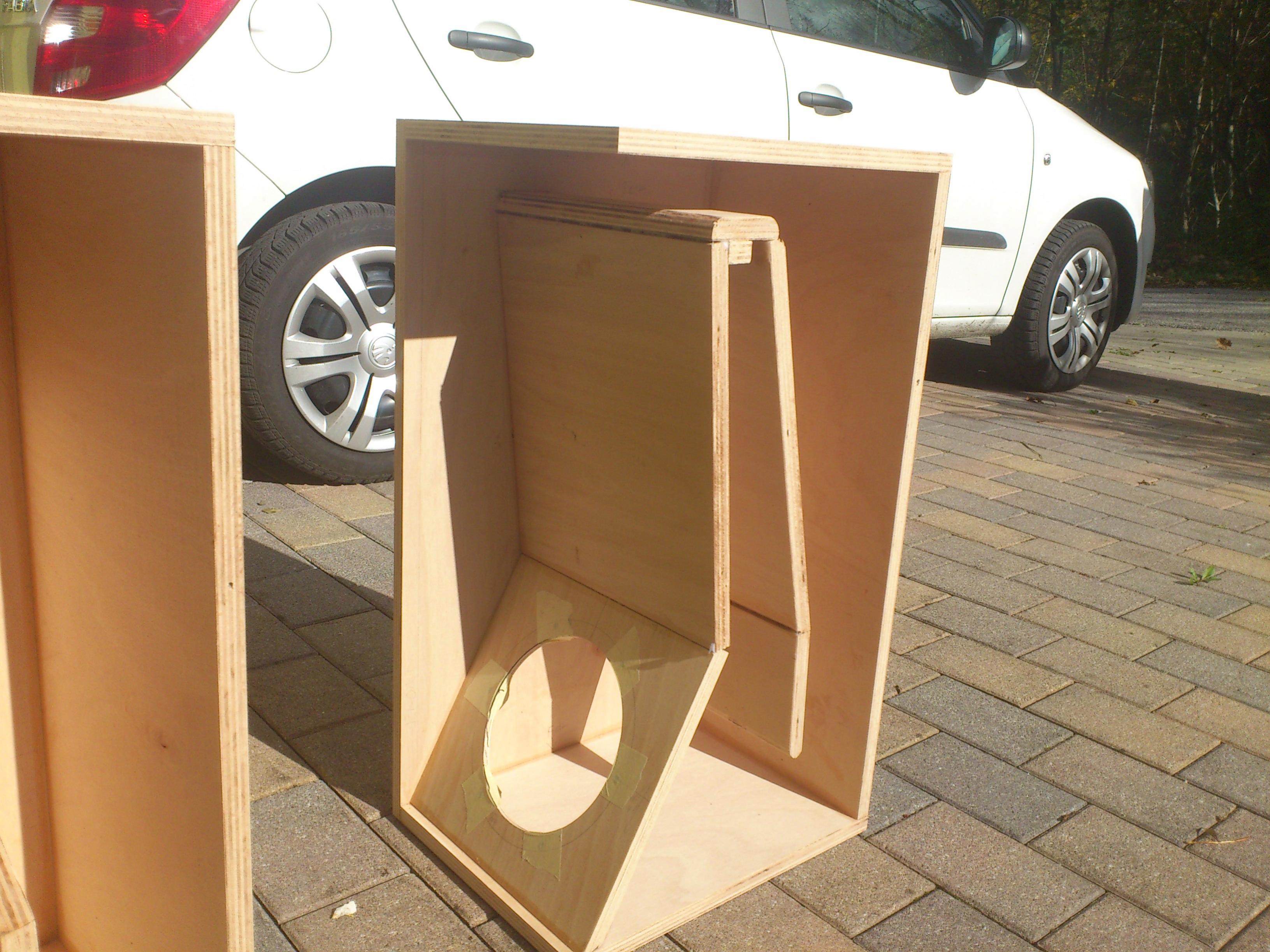

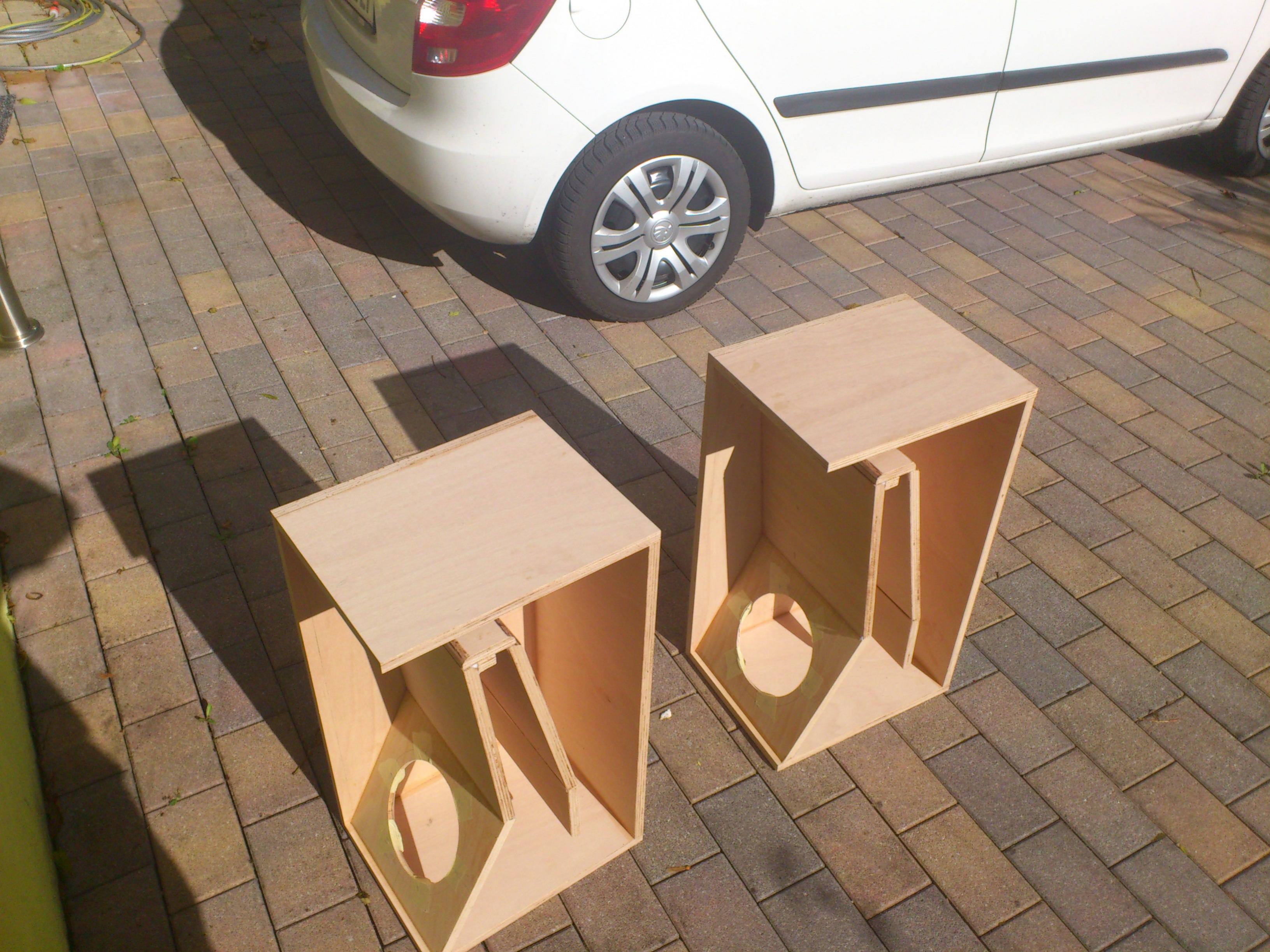

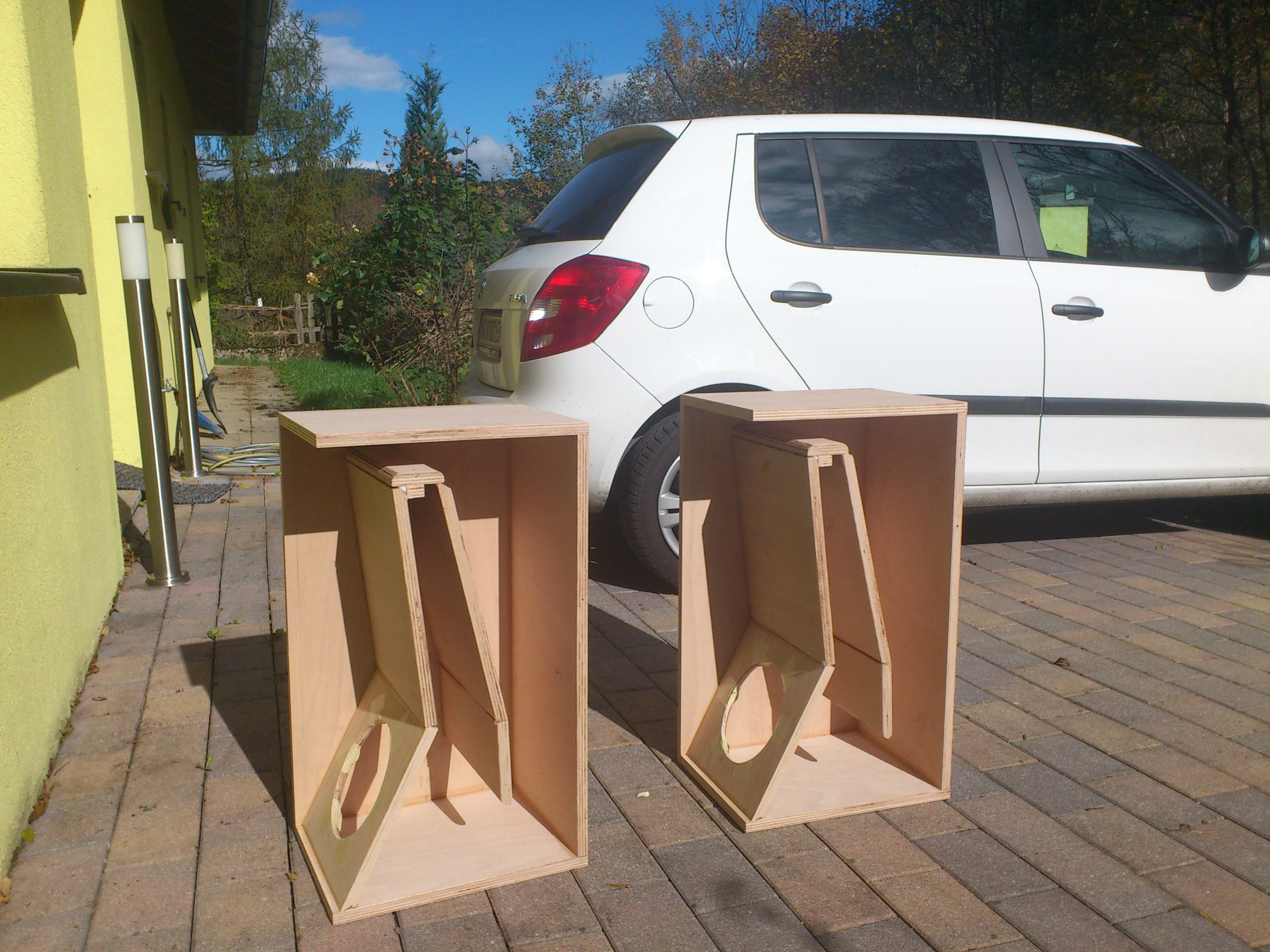

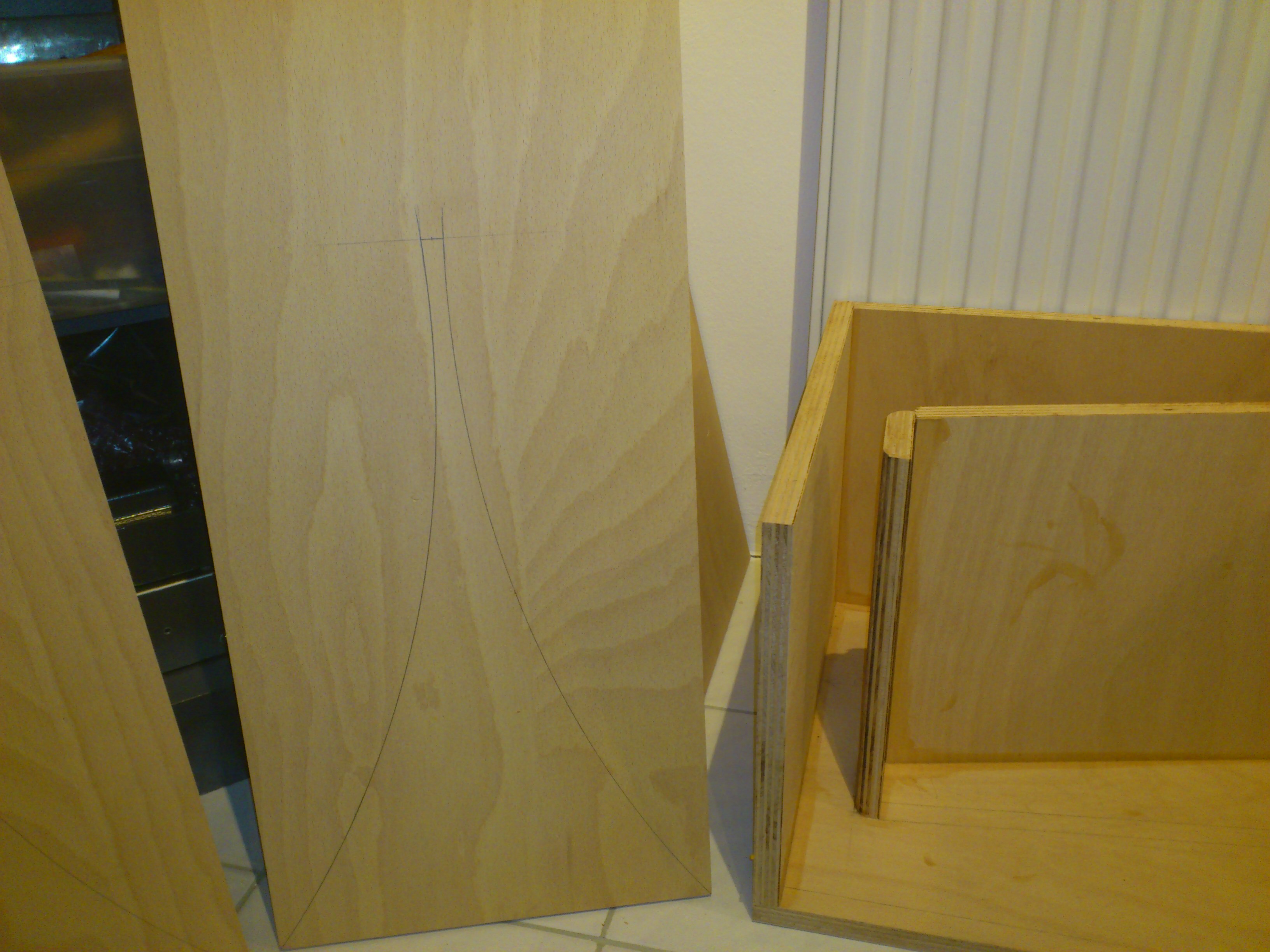

Karlsonator "8" progress, slow but steady!! I can not wait to hear these😀
Looks great! Keep plugging away you are close.

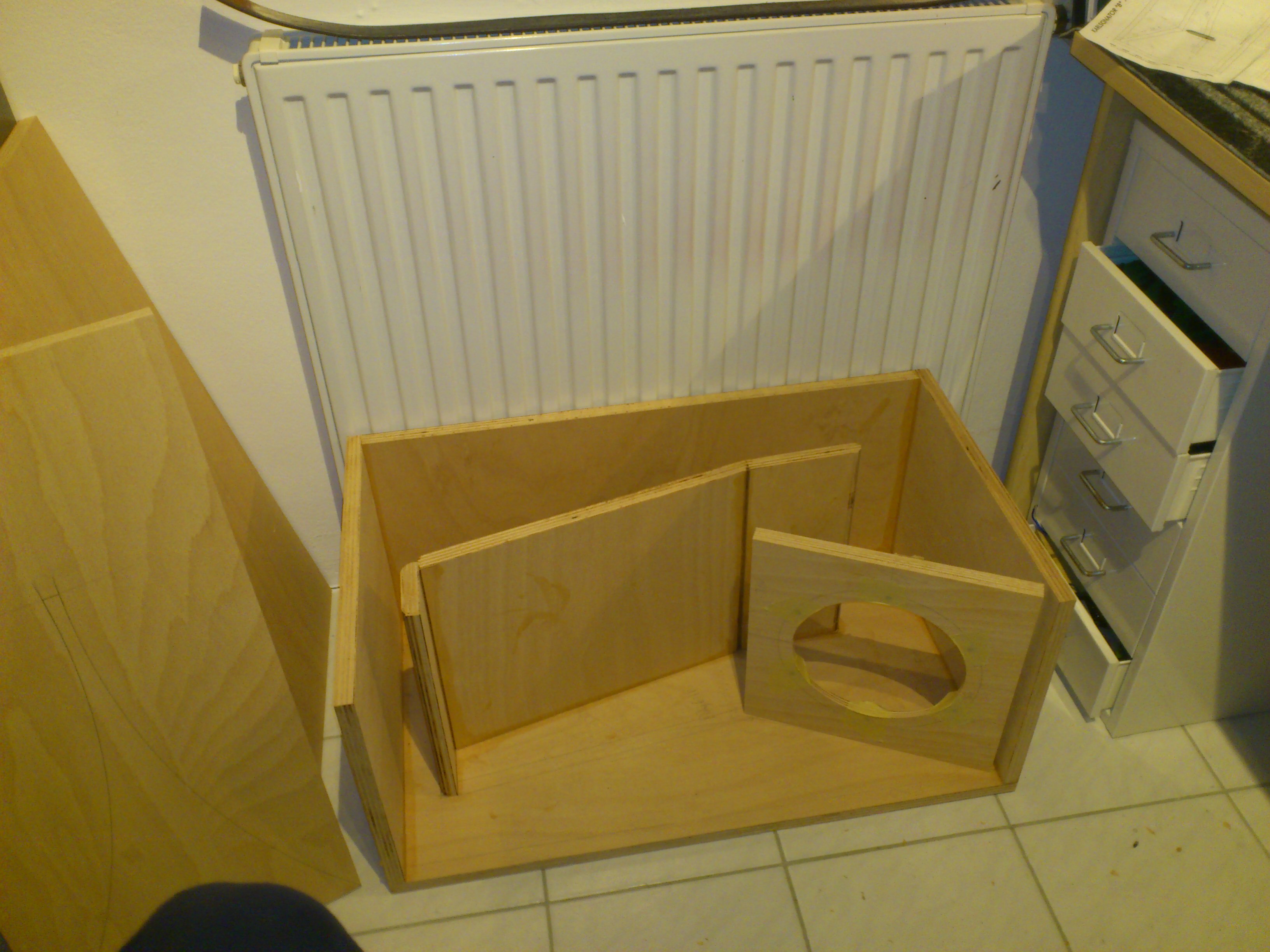

Got a few pounds of acousti-stuff for the spaces behind the drivers in the "wedge", and some 8mm felt for the inside as well as the front wings...
I also have some 6mm cork sheets for flush-ing the driver. I decided to do it this way in case I wanna switch out the Seas for the FE203En-S...
More pics tomorrow!😀
A few pounds!! 😕 You may find that is just a bit more than you need... 😉 I'd guesstimate you'll need only around a couple ounces (50-60g) per box, so I guess you'll have plenty leftover for that giant TL sub you always wanted... 😀😉

I only meant I have a few pounds on hand, never hurts to have a bit extra🙂

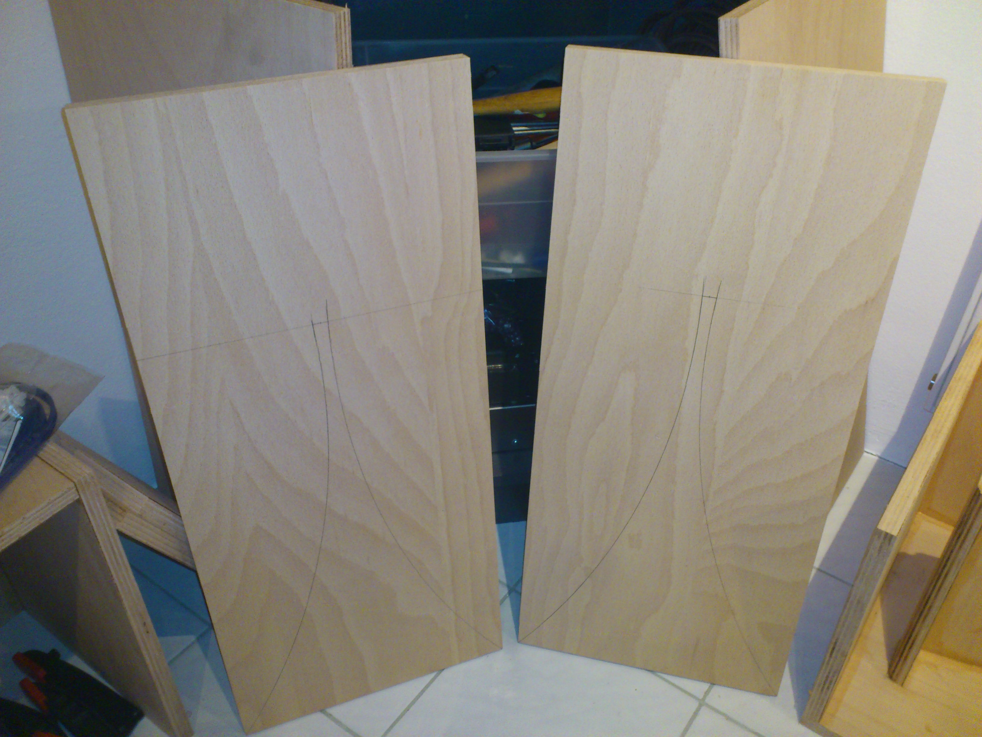

More pics; next comes the felt dampening, some more bracing, and the 6mm cork sheets to flush-mount the drivers...
oh yeah, and sanding, sanding, some more sanding, the front wings, lacquer of about ten coats, ect. ........😀
Lot's of builds going on - hope to hear first sound from you guys soon. Nice work there Mctavish.
