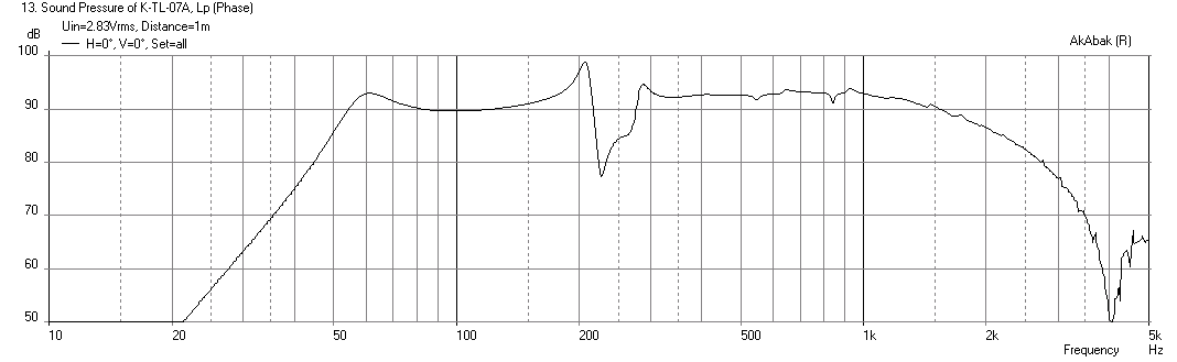

No problem - need Sd.

Hi X,
Got the Sd = 54.2 in-squared.
They are a 10.5 (say ten) inch driver.
Another bass mid. A bit more heavy too
at 20 lbs. Thinking this kind of elimates using
the white board. Might have to find a good table
saw.

It looks like it can work in a Karlosnator scaled 0.75x in length and depth and 0.67x in width.
Here is SPL vs Freq:
