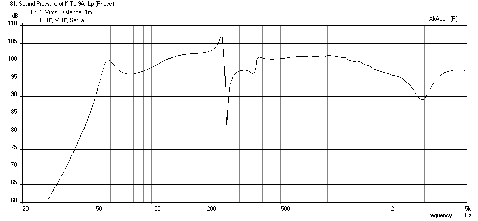

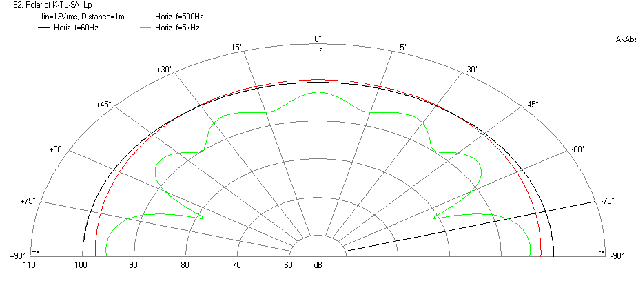

A quick simulation with qnty 4 TC9FD's indicates that staying with the 0.53x height and depth but increasing width to 0.78x will produce pretty good results. Here is the performance at xmax with 2 front facing drivers and 2 side facing drivers:
Here is the polar plot with back wall 60 in away and speaker 36 in above floor (this is for all drivers connected in regular series/parallel):

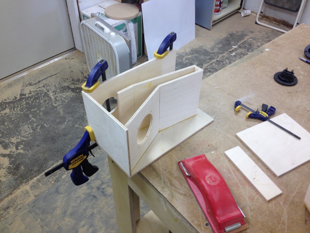

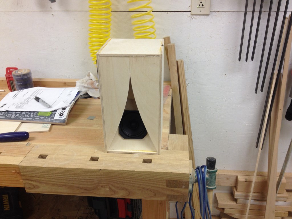

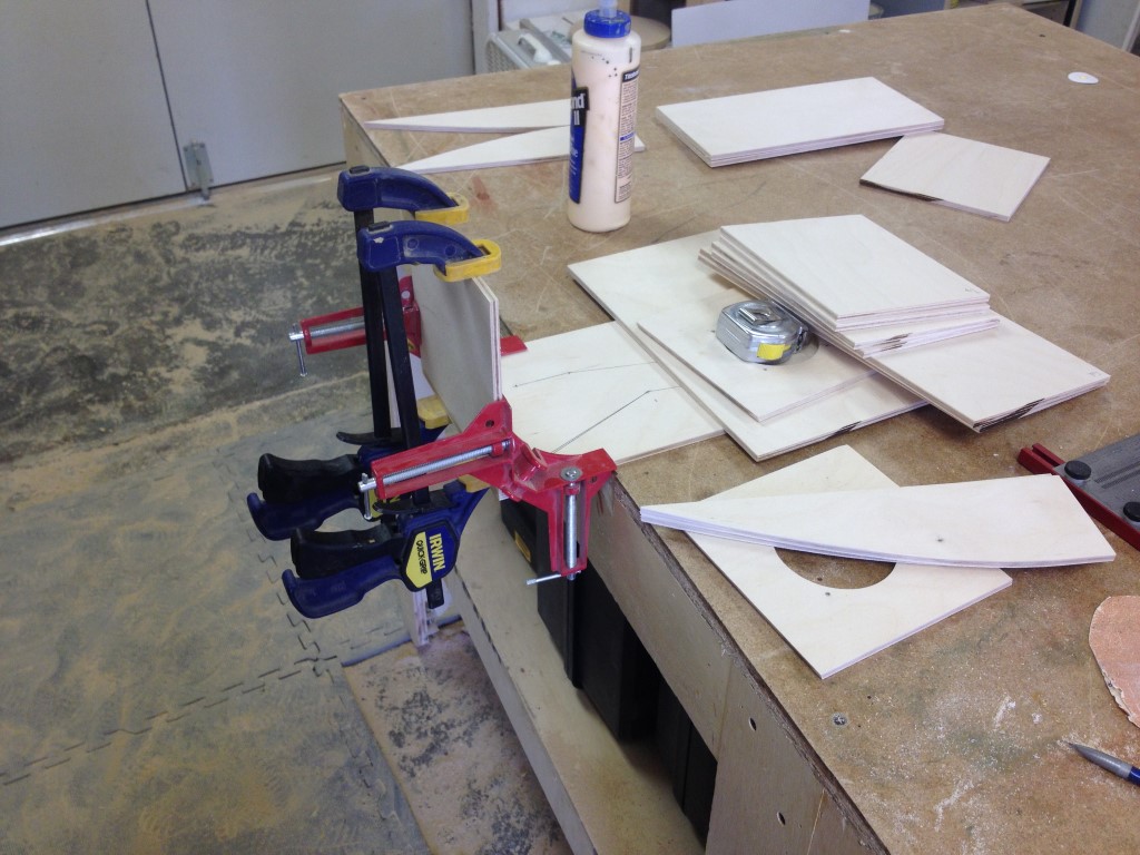

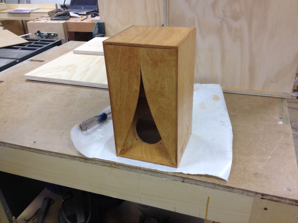

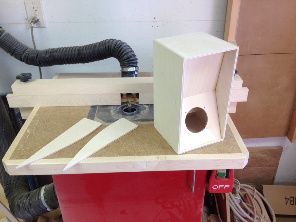

I'm just getting started on a pair of .40x Karlsonators. I'm making them out of 1/4" baltic birch ply. Hopefully they will live up to the high expectations I have for them!
Here is a work-in-progress shot:
Are you getting first sound yet?

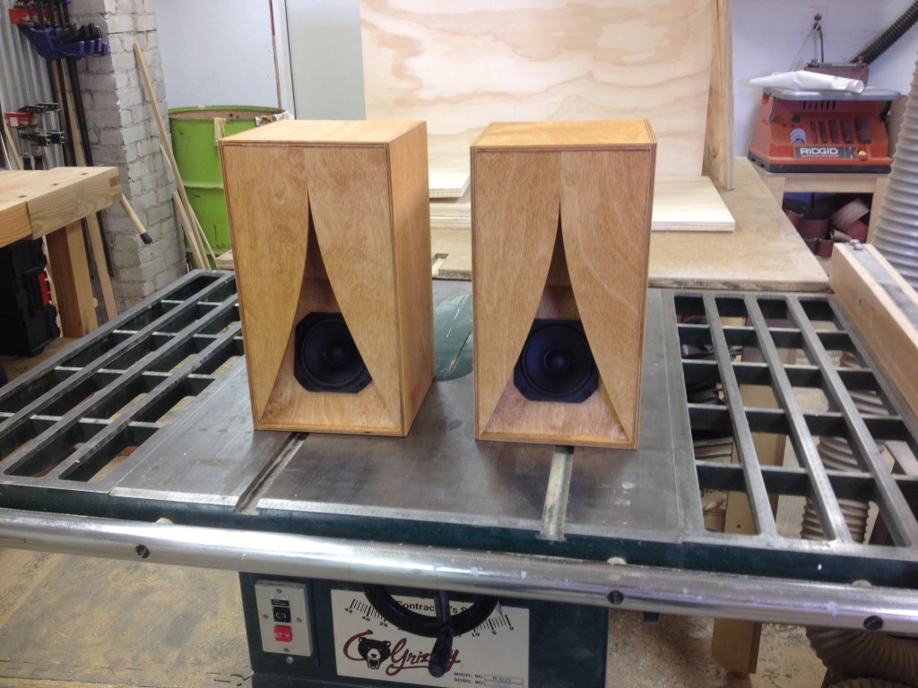

Yup, I just gave one a listen last night. It was very interesting to compare their sound to the AIR320 drivers I have in a TABAQ enclosures. They definitely sounded a lot different. The Air320 has more low end output but the Vifa Karlsonator had a lot clearer mids and highs. So far I like them.
I'm working on staining and finishing them right now.
Jessman,
Nice job - they look great! Glad you like them. If you want more bass, try the 0.53x dual Vifa.

Another nice build thejessman! Will you be taking impedance and SPL measurements? Always good to have some more data! 😉
Yup, I can probably get impedance measurements later tonight. SPL data will take me a little longer.
