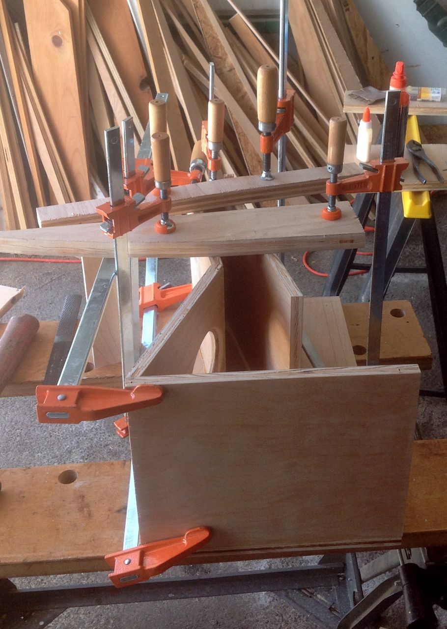

Just so you don't think I have forgotten about the project, here is the current state of my 0.53X Karlsonator (w/ dual TC9FD) build. Things are so busy between home & theater that I only get a few pieces put together each week. Still probably weeks away from first sound, but they need to be up & running in the studio by mid-August.
One quick teaser: this will be my first build where I don't use veneer. Going with Tolex Vinyl from Parts Express (#260-7604 ).
Cheers, Jim

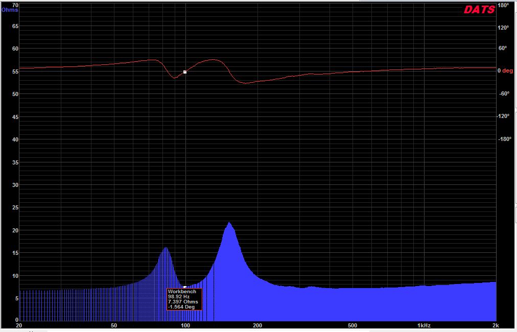

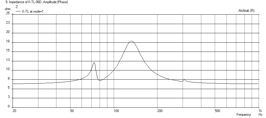

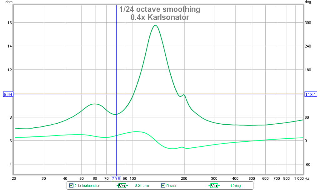

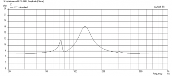

Here is an impedance sweep from my .4x Karlsonators, looks like they are tuned to about 100 Hz.
You might want to play with the K-aperture slot tuning. My 0.4x FC seems to be tuned to 80 Hz, which matches the sims. The lossy FC panels probably absorb some of the energy hence the peaks are not as sharp.

Nice work! You can never have too many clamps. 😀

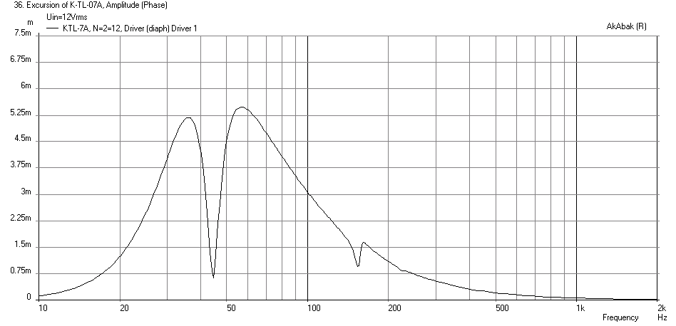

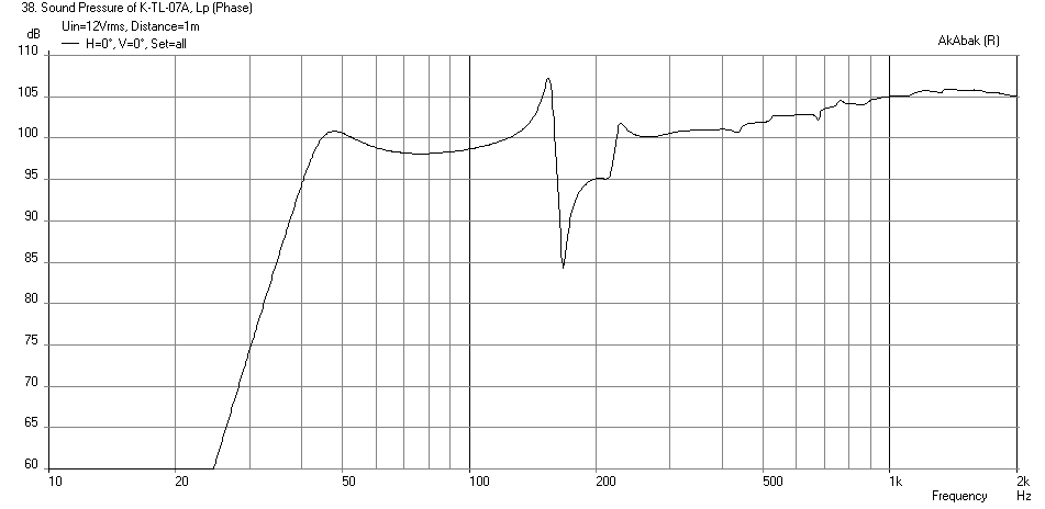

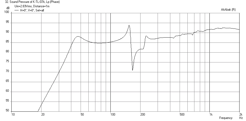

Yes, the K'ntor 8 can work well with the A12.3P. It will be limited in max SPL though as cone motion is not well-controlled.
Here is SPL vs Freq at 2.83v, Cone displacement at 12v (xmax with HPF), and corresponding max SPL (with -24dB/oct BW high pass filter at 38 Hz).
There is pretty good bass extension though. Do you have this driver on hand?
don't yet have that driver - how does it function in the large "Pensil" enclosure with regards to excursion? - I can kinda look with hornresp. Do have 1772, old stamped frame AN8, BetsyK.
My sim of the A12.2P (I meant A12.2P not A12.3p as shown above) in a 35.5 in tall MLTL that is 9 in wide x 10 in deep with a 2.53 in tall x 9 in wide x 0.719 in long vent at the bottom appears to show 60 Hz (-3dB) bass extension and 110 dB max SPL at 18 volts. You need a 24dB/oct HPF at 52 Hz to keep the cone from flying out of the basket though. So it would appear a MLTL provides better acoustic coupling but the bass is not as deep.
