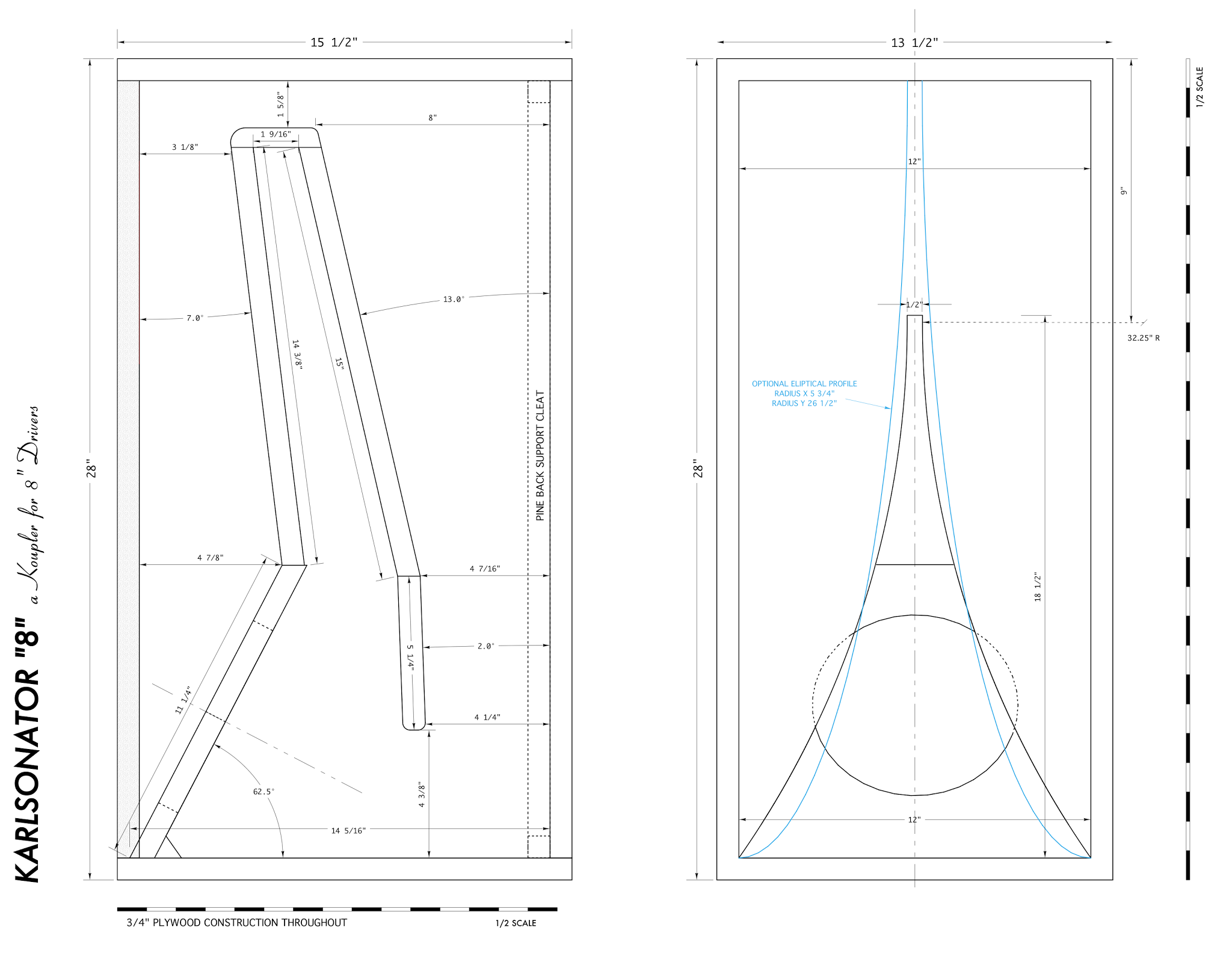

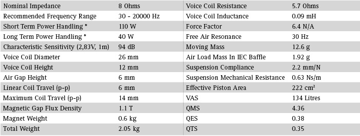

xrk971, do you think you could plug in the following drivers in you Karlsonator model?
Philips AD7060. Roughly a 6" fullrange driver with whizzer. I'm not certain which Karlsonator size it would do better in and which have already been layed out. How easy would it be to adjust your model's various dimensions to find the "optimum" K'ator for this one? This driver tends to want large Vb's for a 6". It has a very "hot" top-end plateau à la AD9710 and is easily bright enough to be behind a K-aperture IMO.
Re: 7.7 ohm
Fs: 44 Hz
Qms: 3.01
Qes: 0.62
Qts: 0.51
Vas: 50 liters (a bit fudgy to measure, should be close enough IMHO)
BL: 4.75 N/A (WinISD extrapolation)
SPL: 90.4dB/W/m (WinISD extrapolation)
Thanks!
Ok, I won't let you do all the guesswork for me. 🙂 As a starting point with this driver, I think the existing 6" Karlsonator is too small. A 0.83 scale-down of K'ator 12" looks better, at least in my crude WinISD analog. This conserves a ~24" internal height and *should hopefully* tune the front chamber around 145Hz. A rear-chamber tuning of 40Hz-45Hz could work. Cabinet width could be reduced a bit further than the 0.83x figure suggests I suppose.
Here's the AD7060/M8:

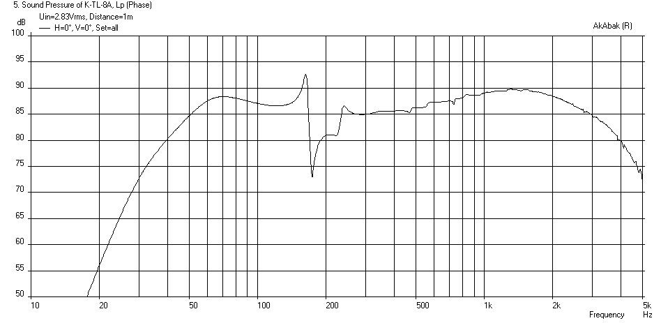

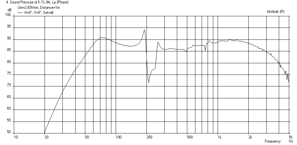

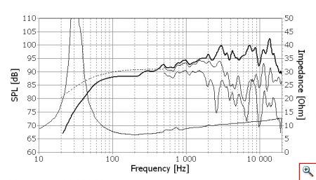

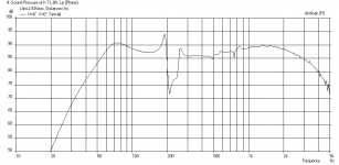

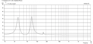

What is the Sd of the Phillips? I am guessing 5.5 in active membrane for Sd of 154 cm2. Assuming the above Sd here are the results - it looks like it could be a fine performer at 0.83x scale - looks ideal size. Making width smaller did not help.
FR with slot top K-aperture:
FR with cusp top K-aperture:

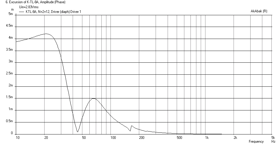

Cone displacement (cusp version):

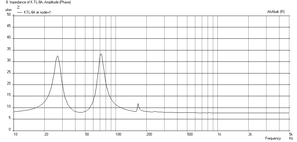

Impedance (cusp version):
Thanks for running the simulations by the way. Not sure I like how the bass part turned out. I would naturally be a safer bet for me to just do a Karlsonator 8" with FF225WK if I go ahead with a speaker project - not that I need one. 🙂

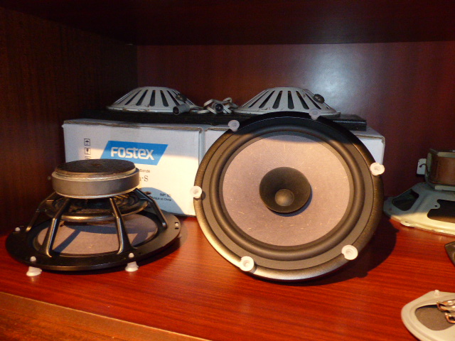

Ok guys, I finally have a bit of time this weekend to make some sawdust!😀
A few question for those more experienced...
1.) Any advice on how to best cut the front wings so they don't look like a visually challenged third grader did them? I have a router and a jigsaw at my disposal.
2.) I know it has been covered in the thread but what would the main differences be between the wings that stop 3/4 the way up and those that go to the top?
3.)Any opinions on using the SEAS FA22RCZ instead of the Fostex FE203En-S?
XRK, maybe you could run it through your sim?
