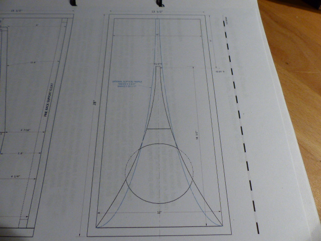

Freddi,
My sims show the second peak at about 67 Hz and the measurement is 62 Hz, but it is very sensitive to the width of the slot at the top of the aperture and how high up that goes. I think the qualitative shape and locations of the peaks are all within 6 Hz though and that is pretty good.
that is really good correlation - the first few inches of that slot can have a lot of subjective influence. I think an upper reflector in some shorter regular K may have effects too. If a coupler is real tall and the fullrange beamy on its high end, then perhaps not a lot of HF reaches the very top of the slot (?)

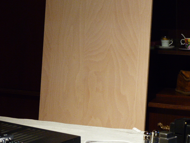

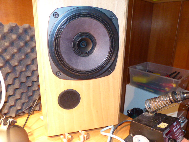

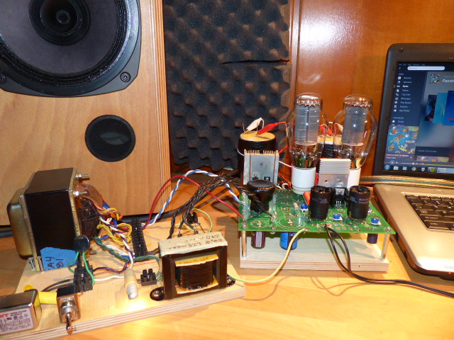

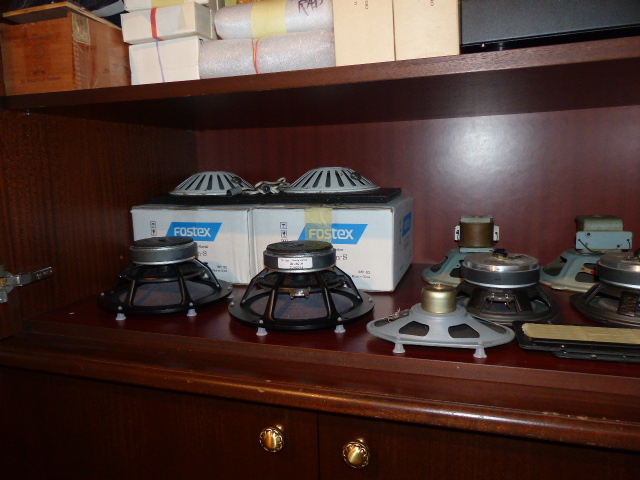

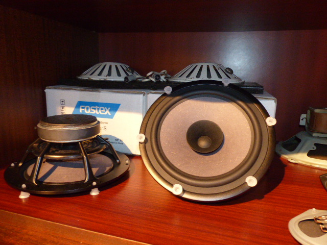

So, here we go...
Got a few sheets of really nice veneered BB, 18mm. The fostex FE203En-S are ready to go.
Seas FA22RCZ as a back up in case the fostex are 😱
If all really goes sideways the I might try my beloved Fostex 8" co-axials...
And the amps; a SE KT88 and the "naked" Tubelab SE with 300B.
Fingers crossed and if all goes to plan then the sawdust will fly next weekend!!

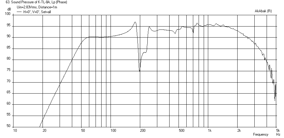

cool - that's good low end in both for a BG20 - interesting to see the midrange differences - it would be cool to test a more extended fullrange and maybe some 6.5 in the Karlsonator8
what was your mic distance? - did the cabinets sit on the ground? - this info will be of interest to XRK971.
here's my rather close graph of a K12 w. BG20 (with an extra vent slit) off the floor and mic pointed at the dustcap axis so it extends to 10KHz before a rolloff.
the little L. Cao F6 fullrange in a Karlsonator 6 is very extended on-axis for a design which uses no whizzer.
you can see that a classic K12 tends to ramp up response around 200Hz

I think that's a good result overall, especially the Karlsonator 8. That mild smiley or BBC curve is to be expected with those driver specs, but actually it is nice for background or shop speakers. The larger enclosure doesn't seem to offer any advantages for that particular driver, unless there's some quality that is audible but not obvious from measurements.
