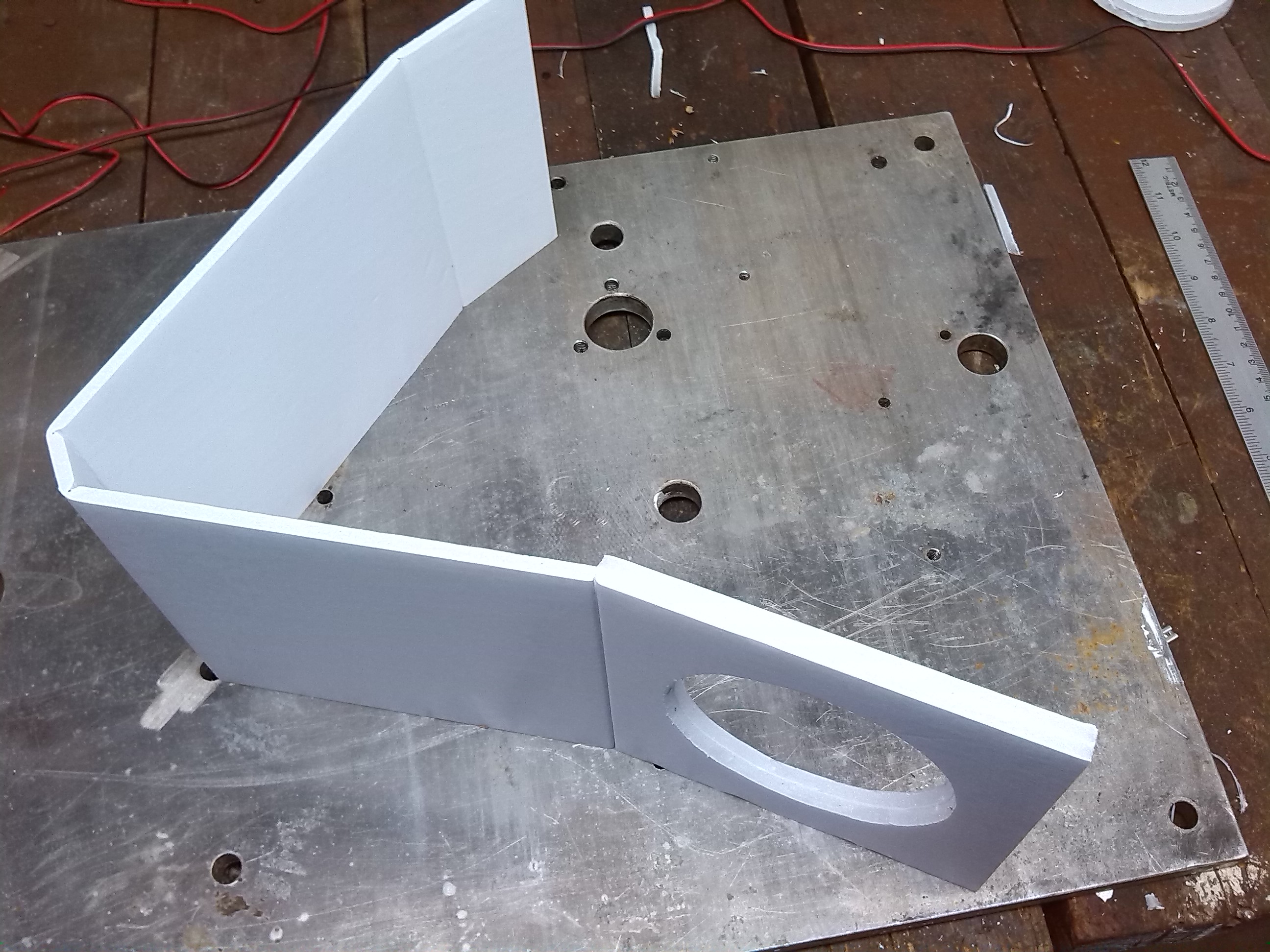

Finally got the pics developed, as promised.
Earlier than 6 O'clock news.
Layout
Layout2
Assistant
Assistant with measuring device, big
Assistant with writing device
Assistant measuring
Assistant marking the measurement
Assistant drawing the measurement
Exacto sharpen, no assistant
Layout before cut
Draw on board before cut
Ensure to scale
Check before cut
Prototype after initial cut and fit
Prototype rear fit
Layout
Layout2
Assistant
Assistant measuring
Layout before cut
Ensure to scale
Check before cut
Prototype rear fit

I have the fit right I think. I have to find a way to cut the little
wood panels to mount the speakers, and panels for the back to
mount the binding posts. I guess I can drill and
hand held saber saw it. I just don't want my little prototype
to shake all apart.
I think I do the same, after I drew it on the sheets, I cut
smaller strips for the mounting points. I used double tape
to hold them, then test fitted and glued in the tabs (for lack
of a better word).
I'm kind of doing what Grandcalmar is doing I think but I
scored the the bends with Xacto, then split the board.
My thought was then I will hot melt glue alaong the
the seam which I scored (or split) so no air leaks
out and provides support. The other side of the
score has the paper intact, it is just bent.
FYI - I could not figure out a way to draw the
speaker cut out w/o a compass. It is actually
a childs compass, but it works what can i say.
The kid was crying because I took it from her.
I'm a mean ol' guy.
AND
If you look at the second pic, I withheld my
assistance baby bottle until she got to work
and drew out to scale on the panels.
I'll be in hot water with the labor relations
board, so please don't tell anyone.
I ended up not using the drafting t-square because
many years ago it lost a screw and it wobbles just
enough to not be square.
I've not been able to find a replacement screw.
it is something like a #2 or #4 beveled philips
about 1/8 inch.
Considering someone who has great distain for
wobbly tools I sure do have a collection of them.
For some reason they seem to migrate to me, go figure?

I have the expo0nential slot running the length of the speaker
but and am now thinking maybe it should be around 2/3s the
length. Some of the hybred speakers seem to have the
slot not even covering the speaker but are only on
the the ported side of the cabinet.
The next pints on me.
to shake all apart.
of a better word).
I'm a mean ol' guy.

Post Script - I didn't know how to get the formula/function
that you has posted X, so I found pic with the nubers on
it and then tried to scale it.
You actually chemically developed the photos? Wow, I haven't touched a film camera in years (and I have some nice ones).
I find convenient round household objects with the same diameter as my driver cutout and use that to draw the circle to cut. For the Vifa it is the inside of a standard 3 in dia roll of packing tape. For the 6.6 inch woofers, it is a Williams Sonoma China soup bowl - which also doubles as the sharpening stone for the xacto on the bottom rim (don't tell my wife). 🙂

That sounds about right, you can make it 5 in wide without too much of a problem if you want it wider.
For bends I cut the top layer of paper and only part way into the foam and then bend the board with the cut on the inside of the bend. I find there is no need to add hot glue - the bend is airtight. To make the double thick baffle I do the opposite and bend away from the cut which completely severs the foam but leaves the inside paper intact, making it easy to line up the two pieces (I then join these with a simple glue stick). Using this technique the innards of a 0.4X mini Karlsonator can be formed from one piece of FC with just bends and no hot glue.
