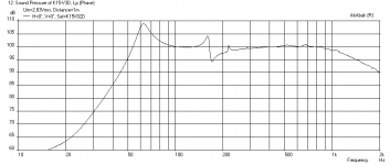

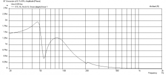

Thanks for looking into the the FF165wk. I am wondering if it might be sufficient for auditorium use.
Cheers, Jim
Jim,

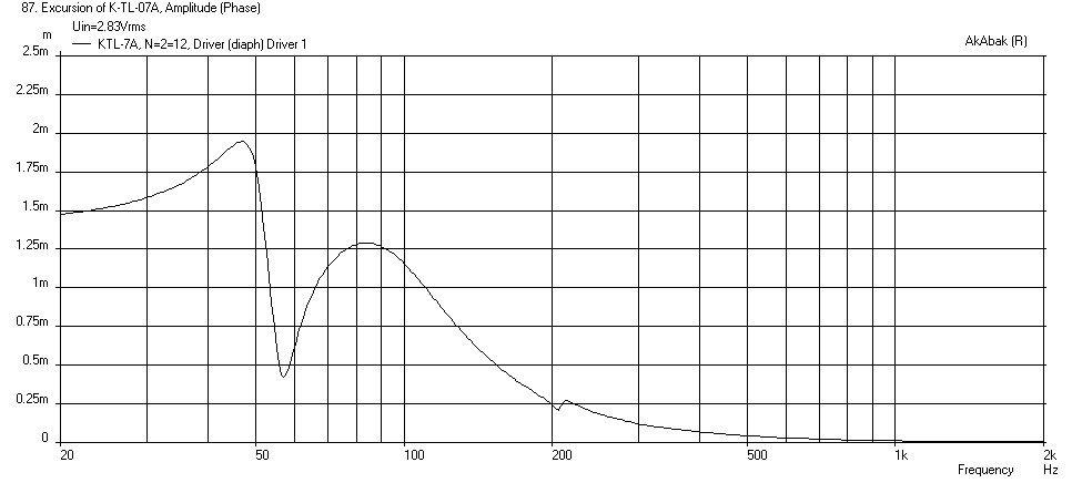

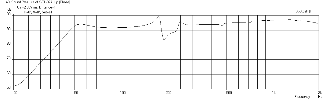

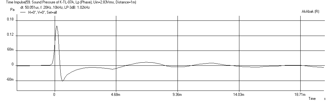

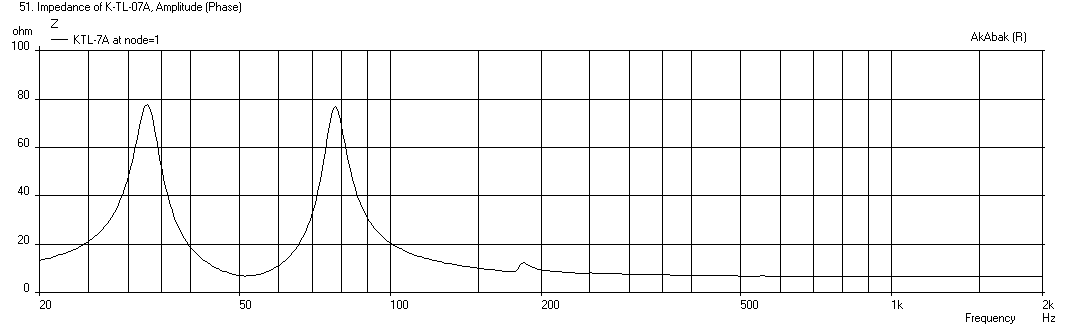

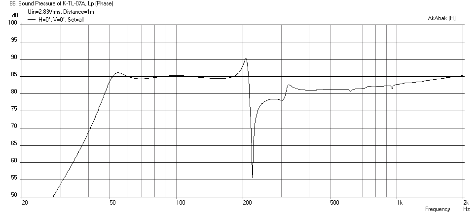

The FF165WK's look like they can work well in a Karlsonator scaled to 0.87x in height and depth, and 0.8x in width. The low Qts motor requires a longer length to achieve bass extension. It is kind of a big speaker but produces quite a high SPL for how small the driver is - between 92 to 95 dB. You may need a BSC to tame the high frequency (maybe 6R+0.8mH can work).
Here are the simulation results for SPL vs Freq, Impedance, Cone Displacement, SPL with 6R+0.8mH BSC, and Impulse Response with BSC.
It looks like it can work for your lightweight PA duties. One way to keep it light as you know is to make it out of FC and face with a layer of 1/8 in thick Luauan plywood.

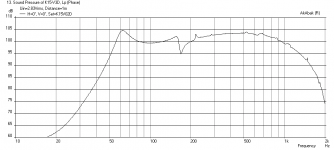

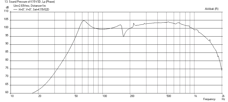

Sync,

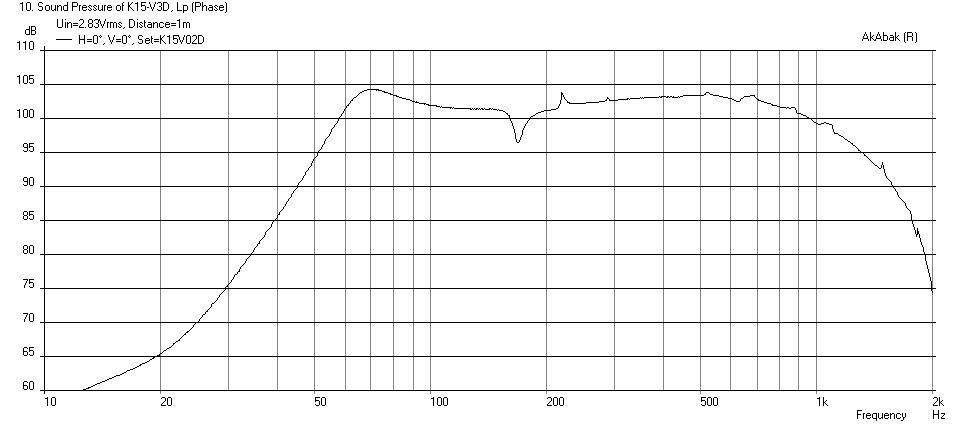

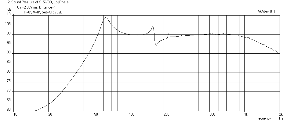

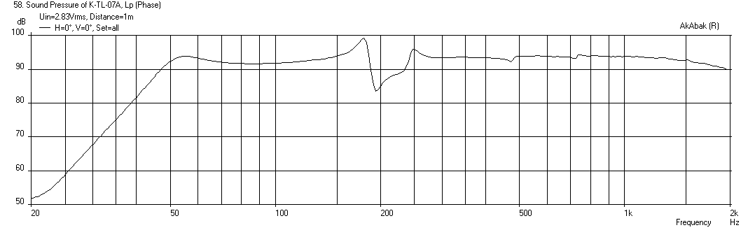

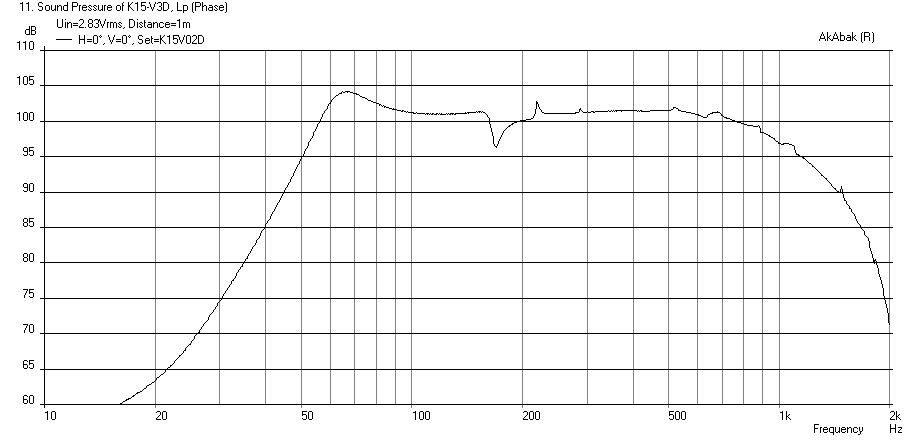

First note that with a proper K15 I am really only an armchair critic here as all I have are sims and have yet to listen to one in real life. However, if my sims are kind of close, which I think they are based on feedback from people who think the predicted impedance plots are on line with measurements, and the famous "W" feature in the frequency response is present where it normally is, I think you are looking for a driver with high efficiency (PA type +95dB) and Qts range between 0.30 and 0.45. You can use low Qts like 0.21 but you are not going to buy anything extra and it actually causes the bass response to dip in the 70 to 90 Hz range. Also, there is no need to have an fs lower than 50 Hz as the natural freq of the K15 is about 60 Hz or so.
For example, here are some sims for various PA drivers: Eminence Kappa 15A (Qts 0.32), Kilomax 15 (Qts 0.39), 10 in bass guitar driver Eminence BP102 (Qts 0.43), and as an example of a very low Qts driver the B&C 15NDL76 (Qts 0.21). You can see that the 10 in bass guitar driver works pretty well but its higher Qts starts to cause a bass peak to form, conversely with the B&C, its low Qts cause a wide depression in the mid bass. I think the Kappa 15Aand Kilomax 15 looks great and it has outstanding efficiency and flatness in the response. I hope this helps.
This probably belongs in the "Speaker than Kicks Butt in Large Spaces" thread. Where are you going to get a speker that throws a bass shelf of 100 dB at 2.83V from 55 Hz to 700 Hz! Great for PA use, superb dynamics and impulse response. Man I got build one one of these days to hear it myself.
So I may need to build a couple pairs in plywood. (Foam core might not last very long in that environment.)
OTOH, I’m wondering if a larger driver might be a better choice for that application? How do you think the Fostex FF165wk would work in a properly scaled Karlsonator?
Well yeah, bigger is better. Comparing a pro 12" + horn to 3" drivers is really not a fair fight!
I'm a big fan of the FF series, but IME using pro drivers with accordion surrounds for PA work is really the way to go. It seems to me an 8" coax would about right for a relatively compact PA, but they tend to be pricey. Perhaps consider an 8" pro bass/mid and a (CTS) piezo.

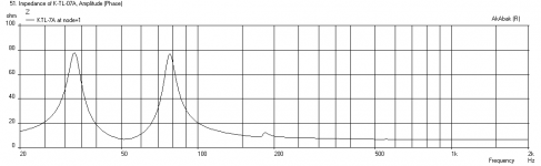

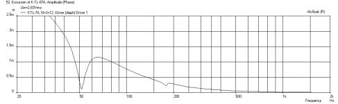

What do you think about a .53x karlsonator unit with 2 of these HiWave 3.5s per enclosure? I have 4 of these drivers.

Bkanabe,

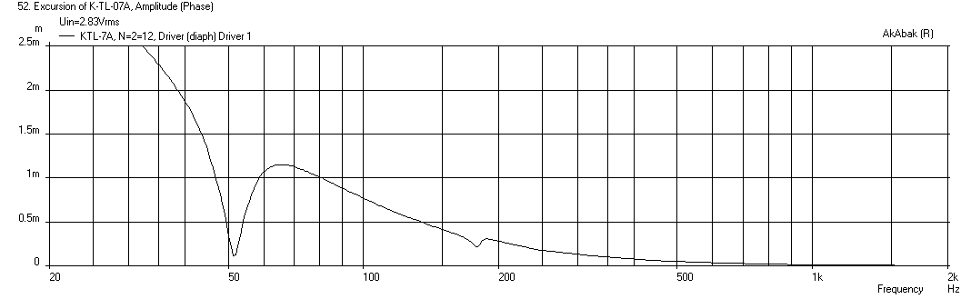

Yes, the HiWave BMR 3.5 in driver can work as a dual parallel driver in a 0.6x scale (height and depth) x 0.33x scale (width) Karlsonator. This one was kind of tricky to get a flat response. It is similar in Qts, Sd, and has more xmax than the TC9FD but lower efficiency. I wonder how the high end sounds? Looks promising - let us know how it works out.
Results: SPL vs Freq, Cone Displacement

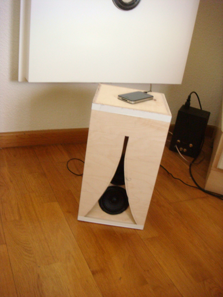

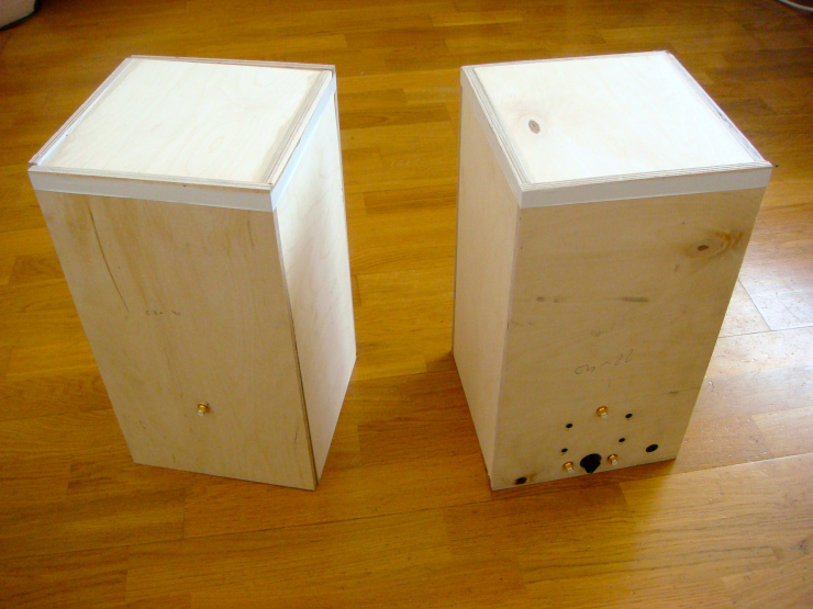

Hi! I finished glueing the speakers, and used some tape to provisionally fix the front and back boards. They sound great!! Unfortunately, couldn't play your suggested youtube video due to copyright issues in Spain. Somehow, I think they sound better standing on the floor. However, they seem to me kinda dull sounding compared with the Cornus I built some time ago. I removed some acoustastuff from the speaker chamber already as per your suggestion, but I'll probably need to remove even some more to achieve the best possible results. I saw a picture of Jim Shearer's karlsonators, and that's giving me a good idea of how to add damping material to mine, it'll be great to hear his advice in case he builds them in plywood too!
I'm currently powering the tpa3110d2 amp with a variable output switched power supply, adjusted at 16v @ 4.5A, and it's more than enough for me, way louder than needed!! The sound fills the room ( 5x6 metres ) without much effort. At max volume my neighbours would be probably knocking at my door pretty soon.
Given my limited experience I'm afraid I don't know how to explain how they sound any further. What I also realised is that they somehow emphasise the small details of the recording, which has its pros and cons. Playing live recordings can be a little annoying because small noises, the audience shouting, clapping etc are quite noticeable.
I made a couple of pictures, hope you like them!! Now it's time to lacquering the cabinets and fixing the front and back boards. Any ideas? I thought it might be a good idea to apply speaker gasket strips on the borders of the speaker to ensure perfect sealing, and use some nails to fix the boards in place.
