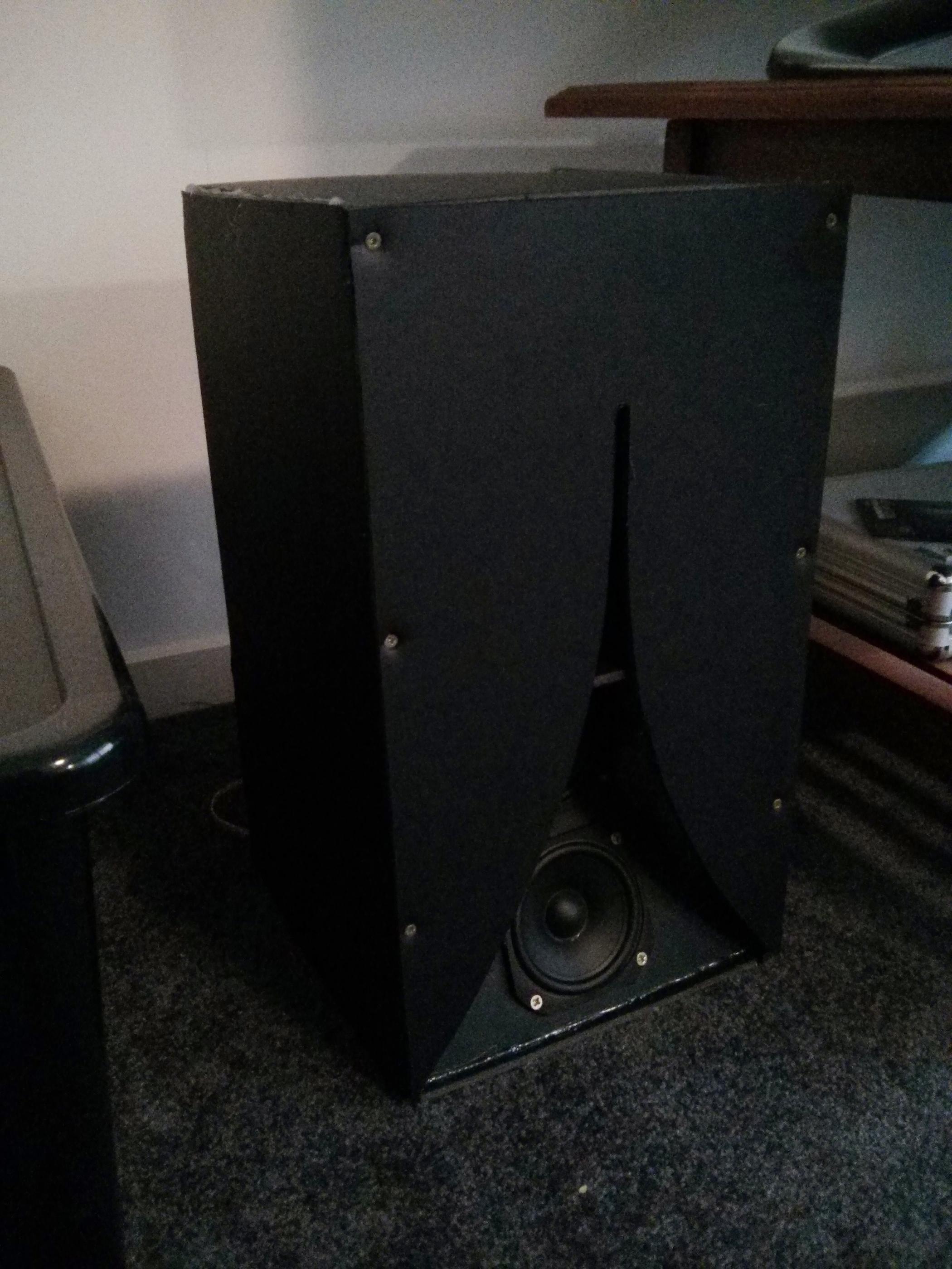

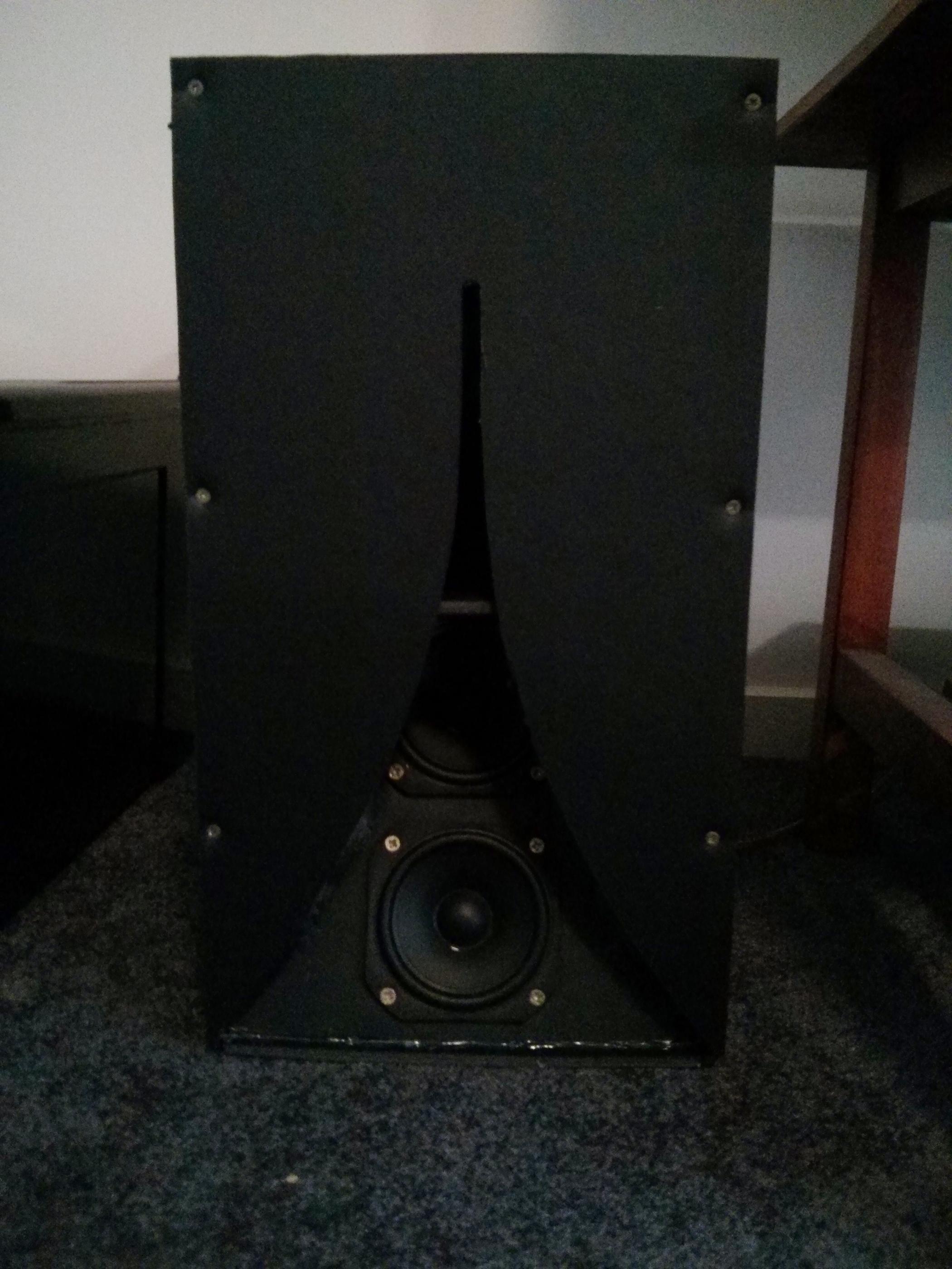

Just finished these speakers last night. Very happy. Some advice for beginners: Draw out X's design to scale on a piece of paper first and measure all the pieces from there to make sure it fits. Helps shake out implicit assumptions 🙂
I'm in Aus, so they were crazy expensive. $11.40 per small sheet of foam core from Officeworks. Took 5 sheets for 2 speakers. The foam core is good quality and it's matte black though so there's that, looks kinda nice. Essential Audio | Australia | Guitar Speakers | Bass Speakers | PA Speakers | Hi Fi SPeakers | Home Theatre | Cabinet Hardware can get the vifa's in and sell them for $25 each, not that cheap but the service was awesome, 2 days shipping.
If I had the space and was doing them again I'd just do them in ply. But I don't have the space, and so am very appreciative of X's design 🙂

Congratulations! Glad you like them - another happy builder. That is too bad FC is so expensive in Australia. We are really lucky here in the States with dollar store FC and $10 Vifa's. Photos please.
For bends I cut the top layer of paper and only part way into the foam and then bend the board with the cut on the inside of the bend. I find there is no need to add hot glue - the bend is airtight. To make the double thick baffle I do the opposite and bend away from the cut which completely severs the foam but leaves the inside paper intact, making it easy to line up the two pieces (I then join these with a simple glue stick). Using this technique the innards of a 0.4X mini Karlsonator can be formed from one piece of FC with just bends and no hot glue.

I understand. Mine is a bit on the tall side.
Then I determinded with X's help not use foam
but board for the bass/mid.
Yeah, I went with 2 driver as that is what I had
bass/mid then tweeter. Boards are drying now.
Put some quick and dirty oil finish on them.
Hopefully in the next week I can finish.

Buy a full range driver (I'd be finished already).
Thinking I'd rather it be in wood. Yet, I feel the
foam is a great rapid prototype method and it preps
you for wood later down the road.
I'm 3/4 there, with the foam.

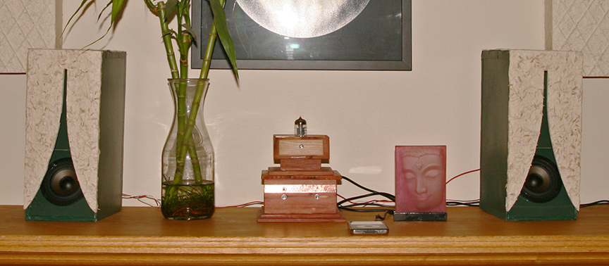

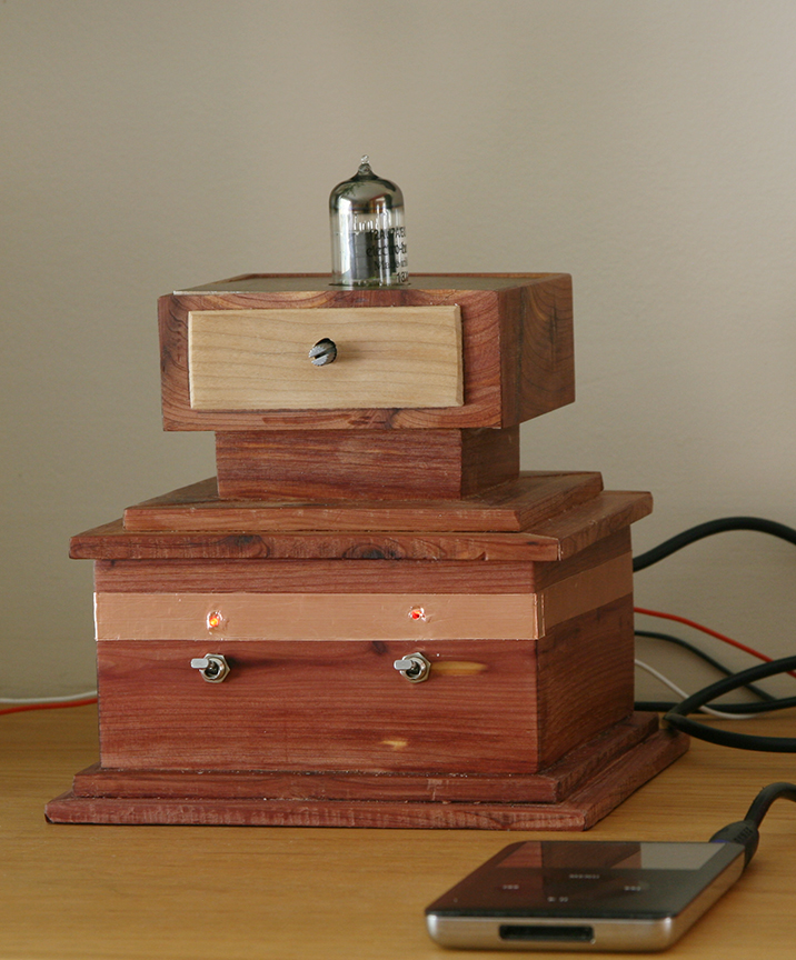

I've built a new stereo comprising a pair of foam board Karlsonators with TB W3-881SJF drivers and a TDA7297 amp and 12AU7 Valve Cmoy Headphone for preamp from Fed's Amps.
It is really quite remarkable how remarkable this little little set-up sounds. Thanks again master X for all you guidance.
It was great fun to build- hope you enjoy it 😀

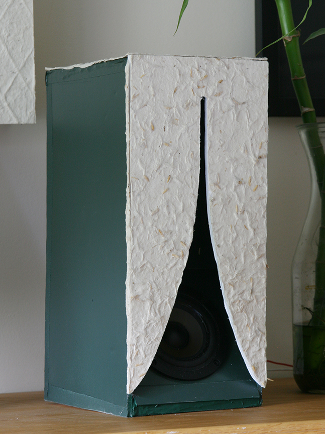

Prezden,
Those look really cool with the custom hand made paper covers over the Karlson apertures. Also like how your tube preamp in a wooden box looks. How do you like the sound of the tube preamp with tda7297? Surprised you are not going with the 3110? I think you got a 3116 - are you still working on getting that set up?

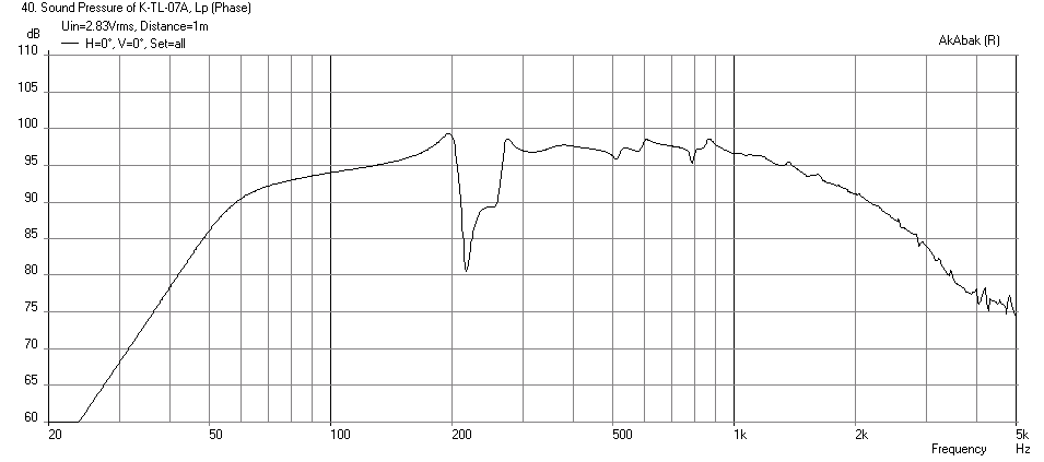

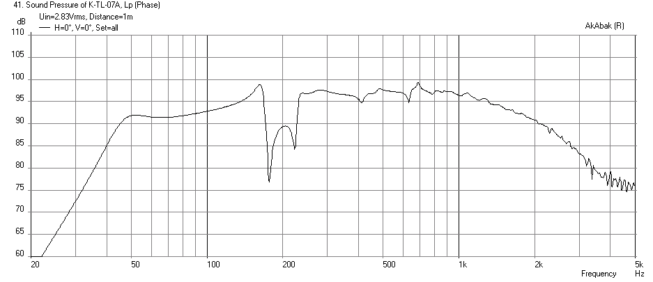

TSG 12-1844 in 12/15 scale Karlsonator
Freddi,
This driver may actually work out alright if you EQ the mids and highs down a bit to flatten the response. Here are the sims for a 12/15x scale and 15/15x scale Karlsonator with the TSG 12-1844 driver. The fullsize gets you solid 90 dB at 45 Hz at 2.83v.
X
12/15x scale:
Fullsize (15/15x scale):

hey X - that's not too bad in the 12/15 - thank you very much for taking time to sim. Some of my tube amps might raise Qes a bit.
hey Sync - you are greatly blessed
Yes, anytime you can get 90+dB efficiency from 1 watt down to 50 Hz that is pretty good in my mind. 🙂
Good luck on getting it built! I am sure it will sound fantastic.
