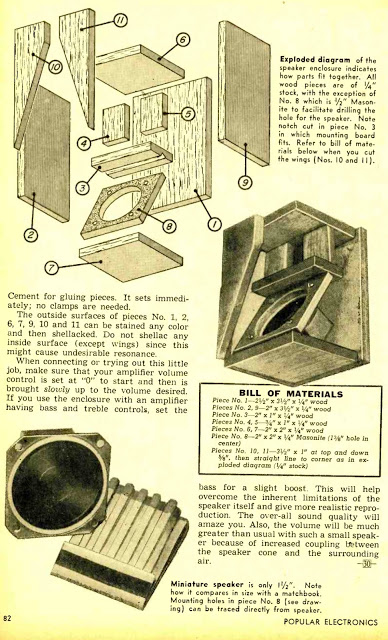

Found these semi plans many years ago Anyone seen/built them?.
Just having finished the woodwork on me 10" Tannoy project i have a bit of 1/4" ply left over so might give these a go but scale em up slightly to fit a 2" driver , this one looks promising Fountek FR59EXE 2" Neodymium Full-Range Driver, lowish Qt and lowish Xm.
Any thoughts, laughs or giggles ?

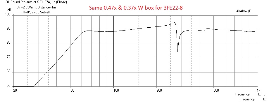

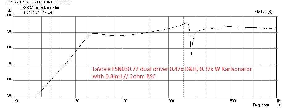

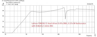

Sorry it took so long, I had problems with my virtual machine on the new laptop and had to reinstall Win XP on it and Akabak.
This is an interesting driver that looks a lot like the Faital Pro 3FE22 Nd magnet driver - but they are not the same. It has a rather low Qts, so required a rather slim cabinet. You may have to adjust the length of the baffle board a bit to allow the drivers to fit.
The size ended up being very non-standard at 0.47x Height and Depth, and 0.37X Width. This is for dual drivers in parallel and to that, add a 0.8mH inductor in parallel with a 2ohm 10W resistor as a BSC.
You will get something like this:
LaVoce SN030.72 specs:
http://www.lavocespeakers.com/lavoc...400817_LAVOCE_FSN030.72_3in_FULLRANGE_A.a.pdf
If we stick the Faital Pro 3FE22-8 in the same box, it is actually smoother:
Faital Pro 3FE22 8ohm:
https://www.parts-express.com/pedocs/specs/294-1101-faitalpro-3fe22-8-specifications.pdf
If you have a choice and can get the 3FEE22, I would go with that as it has a flatter response.

X how would you rate this tall-thin box against the 0.53 for dual 3FEE22s ?
The 0.53x is too big for the 3FE22’s. You will get s deeper but exaggerated one note peak around 60Hz and less bass clarity.
