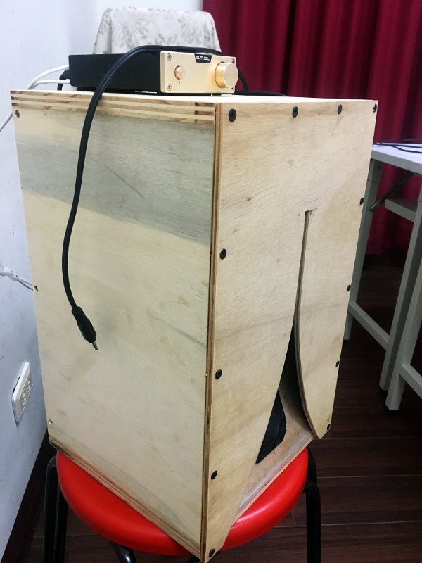

I mounted the drivers, and closed it off.
I didn't have time, nor could play loudly, but had to give it a 30 sec tryout... Happy to report no boxiness to the sound this time.
Might have been because I have been a lot more careful this time assembling the whole thing, which took me a lot more time than I thought it would.

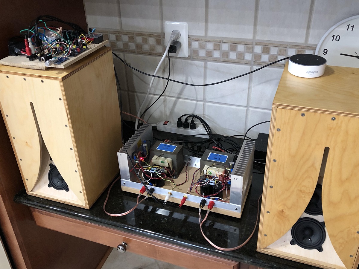

Dual 3FE25-16 Karlsonators powered with 11wrms MoFo single MOSFET amp and Melbourne preamp. Great combo. Really surprised at the synergy of a simple amp and good speakers.

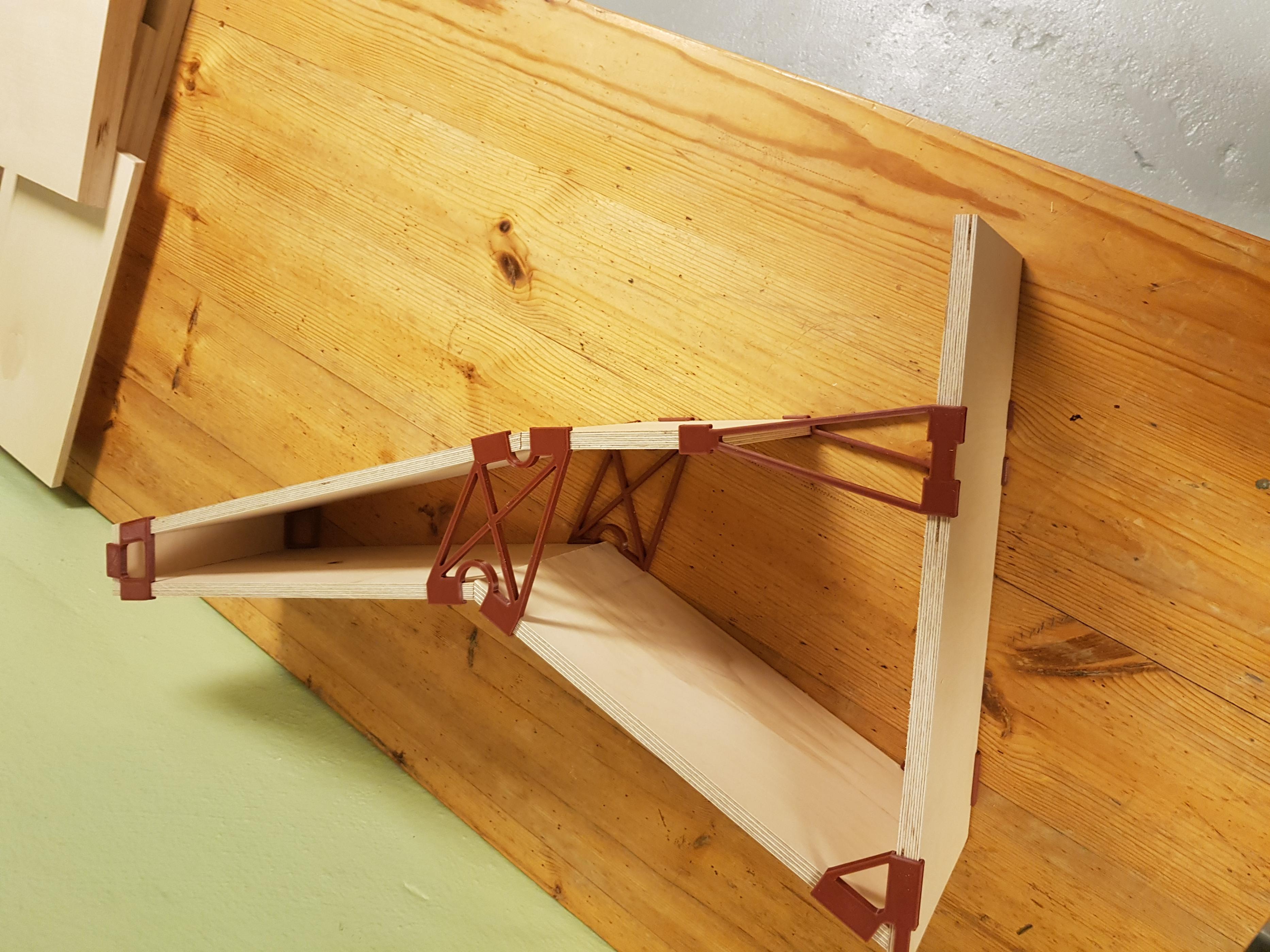

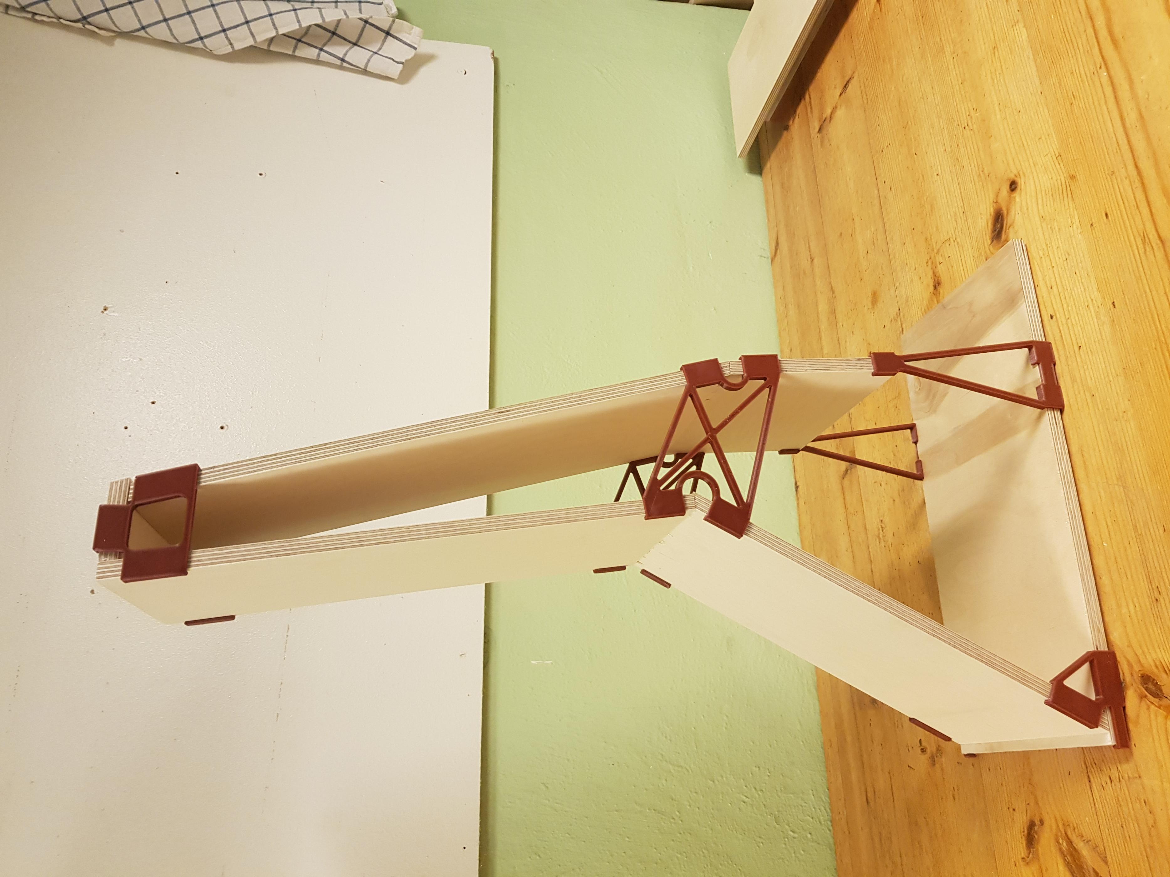

I´m about to build the "tall" ones i sent a render of earlier, and are wondering about the Slot. What is the benefit to not make it all the way to the top like you did here?
I 3d Printed some fixtures to make sure the angles stays correct during Gluing. Worked like a charm!
