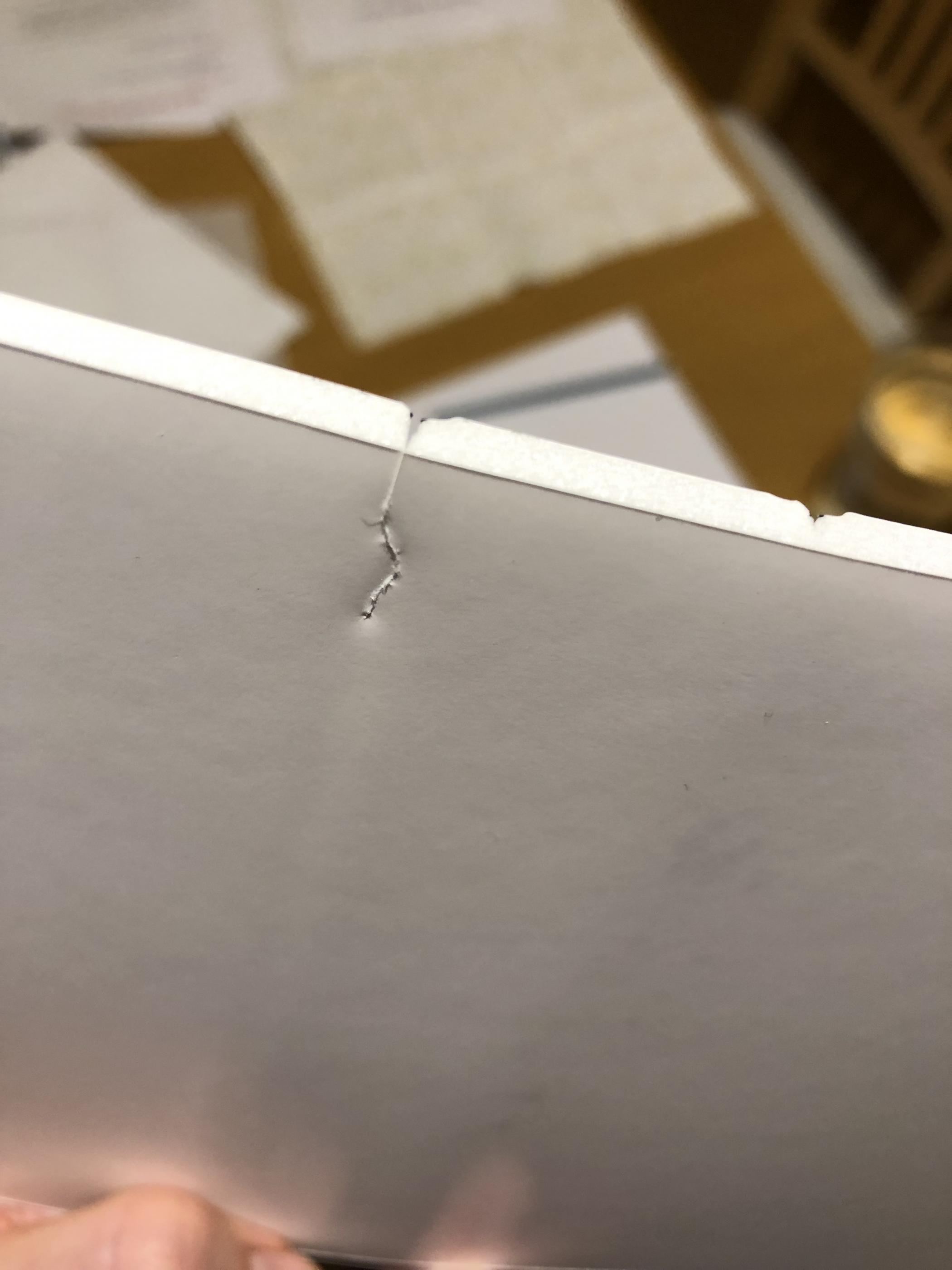

However, when I attempted to make the first bend (folding towards the score) it really wasn't easy to get to 90deg, and eventually it ripped. So, before cutting a new part I experimented with the scoring - I've ended up making v-shaped (or as close to V as I could) scores so the fold puts the outer bend under less tension.
Has anyone else done this?

Hi Tristan
You're probably not using paper clad foam board. If you're using Depron or similar foam board without the paper sides, then V-grooves should work fine, as you've discovered.
The glue should stay sticky long enough to put the long edges in position, unless your ambient temperature is very low. In that case, clear epoxy would work better, I think.
Thanks Skylar, I think I've the normal stuff - attached is a picture of one of the rips. It certainly feels like glossy photo paper, but thinner. I'll pre-fold each joint and if I get another rip I can always re-make the piece, but hopefully no need with v-scores.
And I think I'll test the hot glue inside on a spare piece for timing. I had planned to use white PVA afterwards on the joins to seal, so will continue with that unless the hot glue is so easy that I can just go over each edge.

If you have a thin metal ruler try pressing it down into the bend before you start the bend, it can help pre-crease it to keep it from breaking... try it on some scrap first of course!

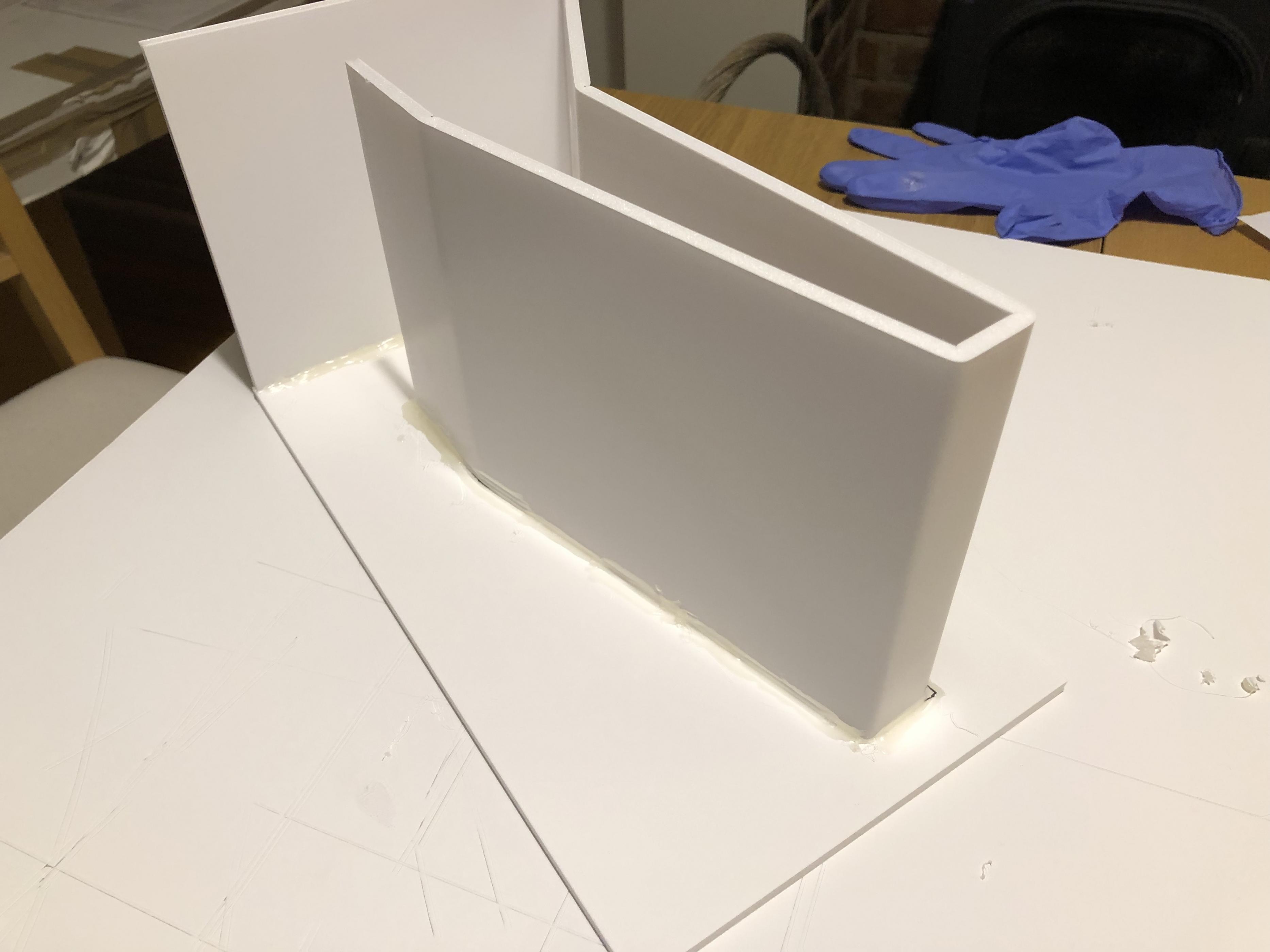

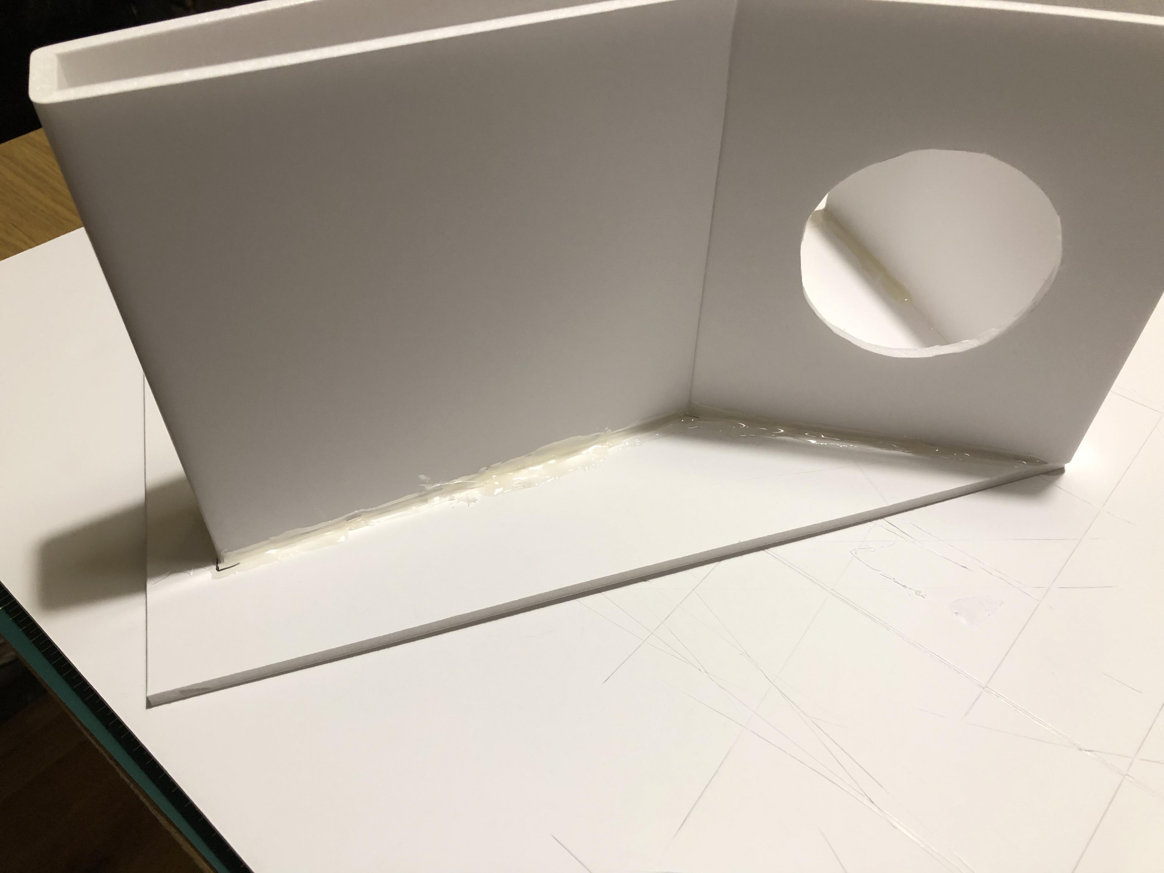

That’s a good idea. Will do for the next attempt. I have a gluey mess - in the time it took for me to apply to the long edge, lift, rotate and place, parts had dried a bit meaning there are tiny gaps. So I plastered the edges with more!
Will need to trim a bit off the lower front edges where there’s a bit of an overhang - to allow the front to mate properly.

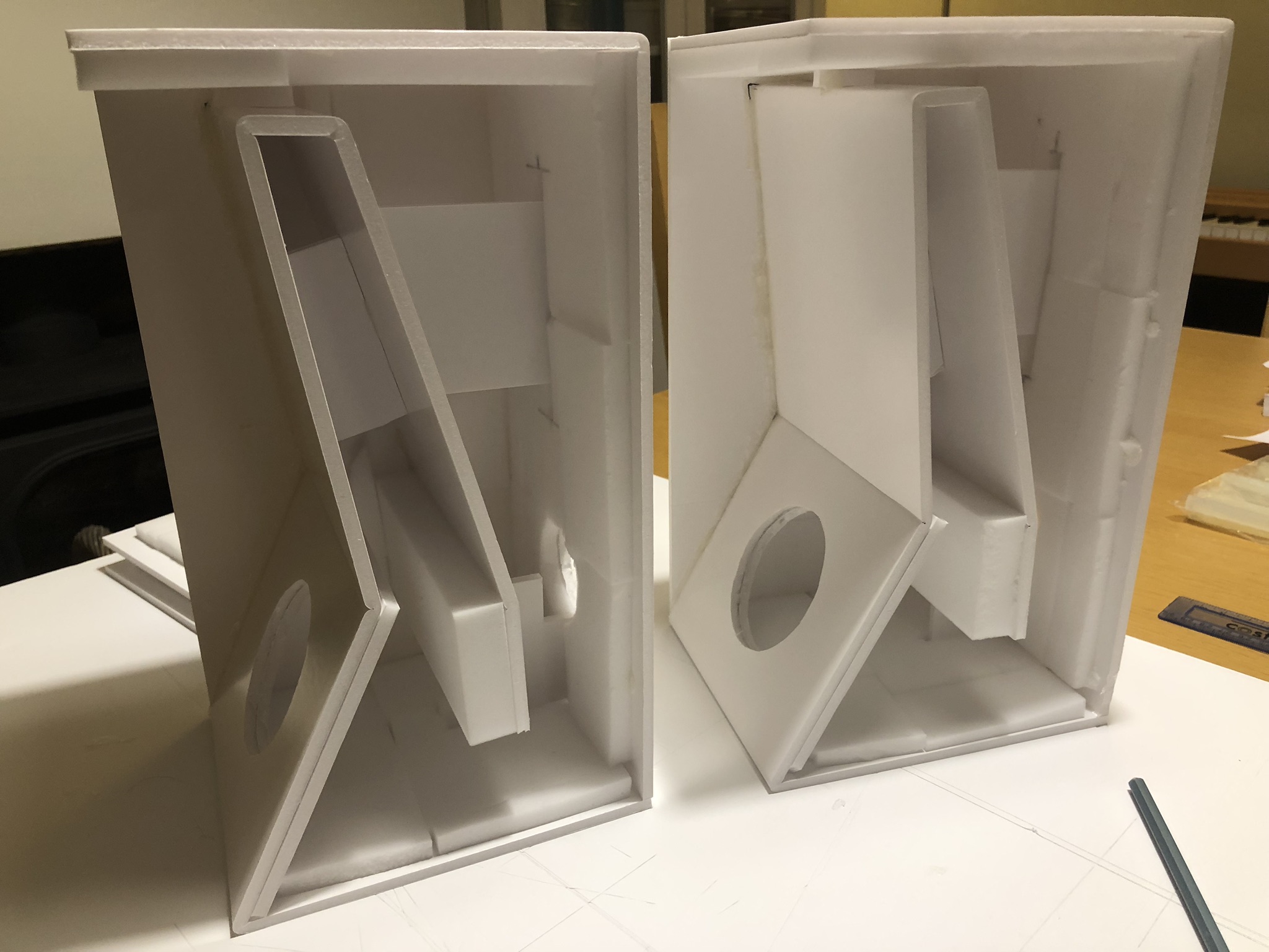

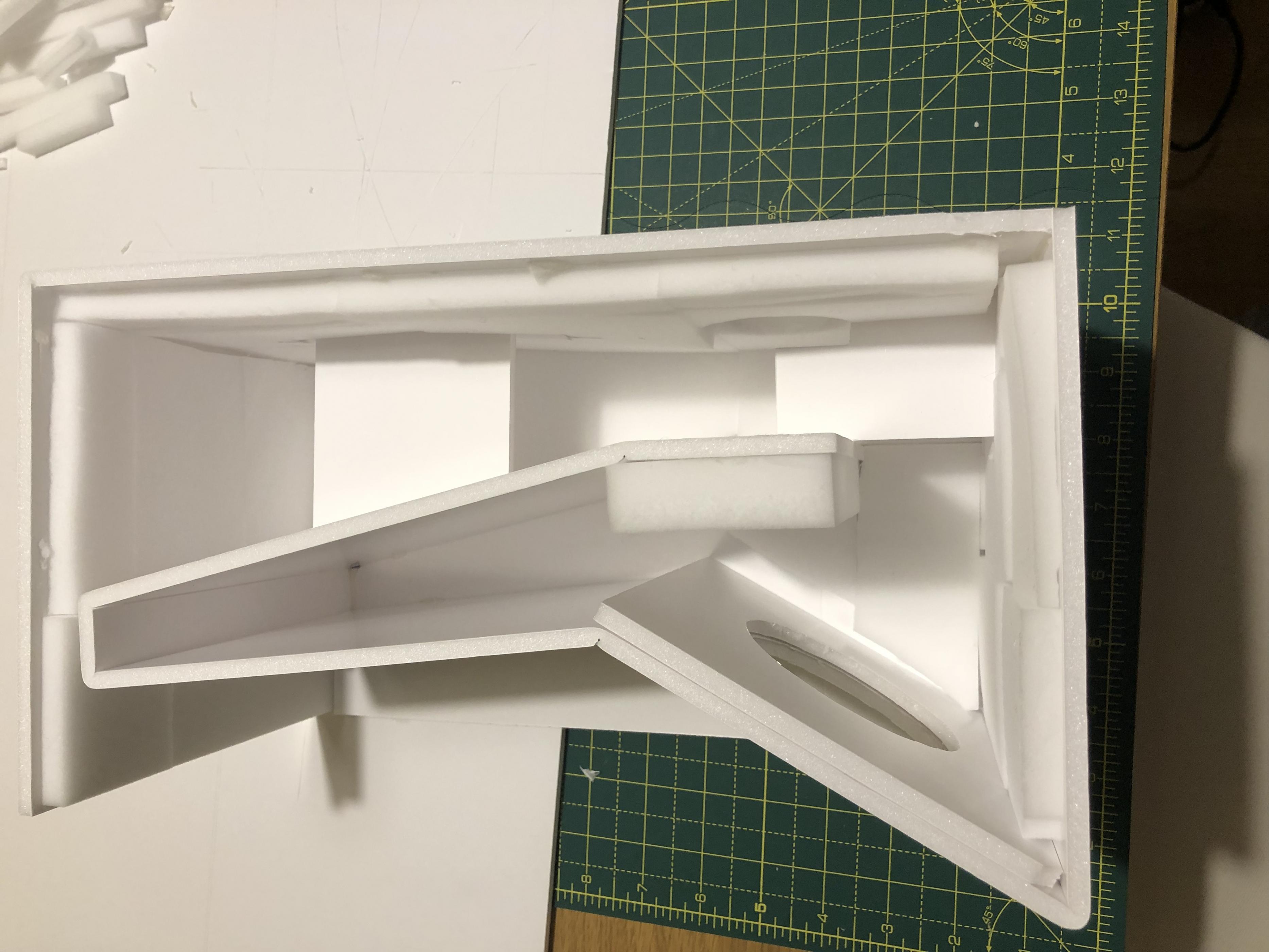

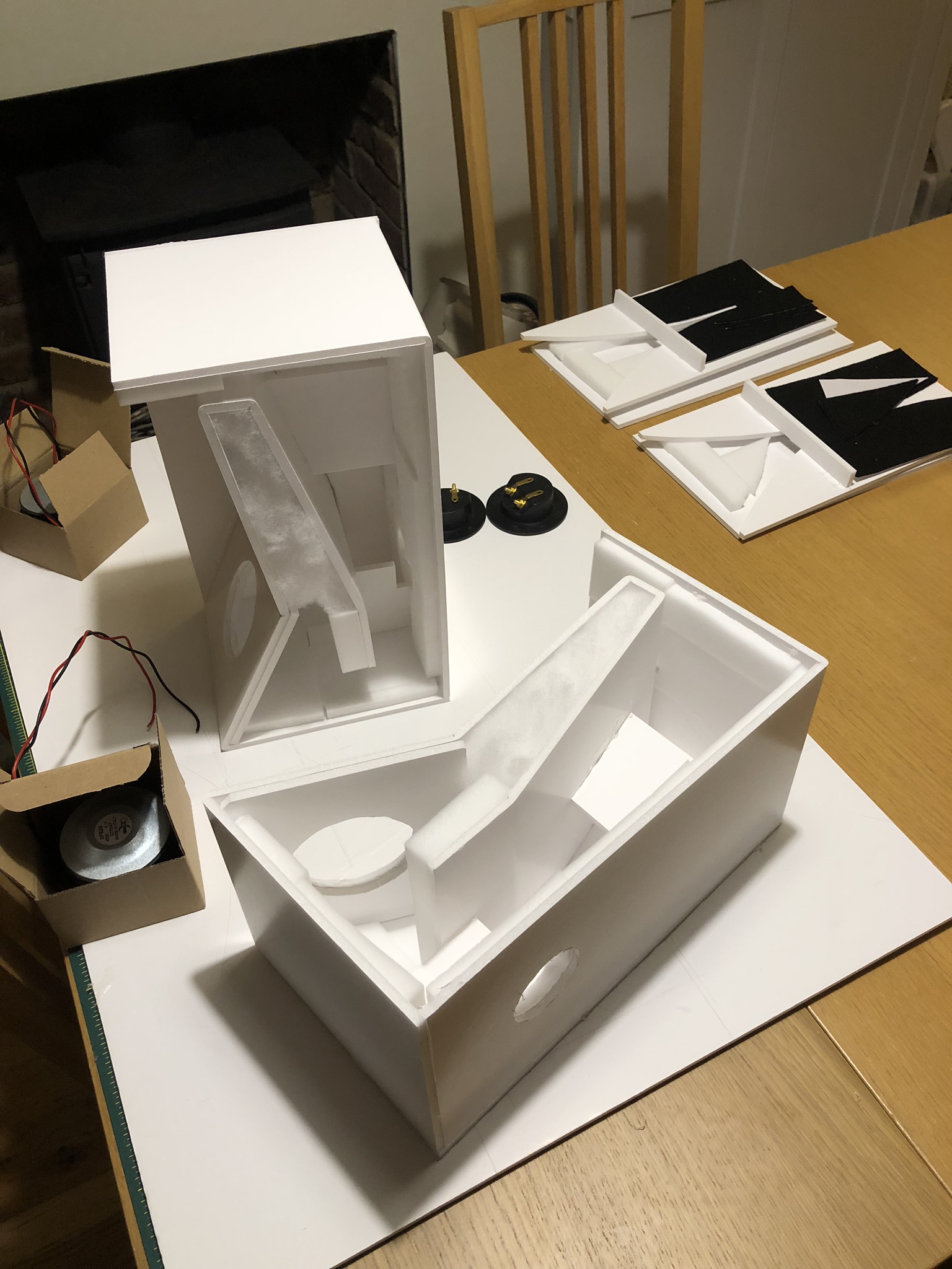

Almost there...
Have had a bit of trouble with glueing the back piece on, so my aesthetics aren’t as living room friendly as I’d hoped. Will also need to go over a few of the outer joins with PVA or UHU glue to ensure there’s a seal.
Not sure how dense the stuffing should be? Difficult one to describe, but I teased it apart a bit before putting it in, so it is less dense than in the packet.
Hoping to finish them off tomorrow and finally hear them along with my new amp!
