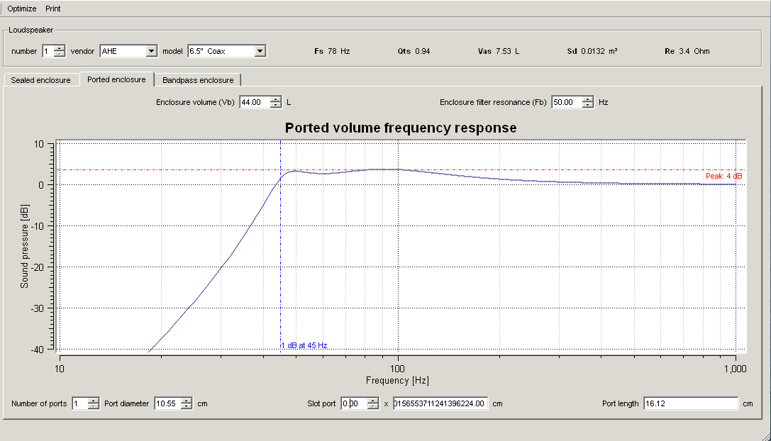

I'm afraid the high Qts might make a K type speaker a little big, wouldn't it?

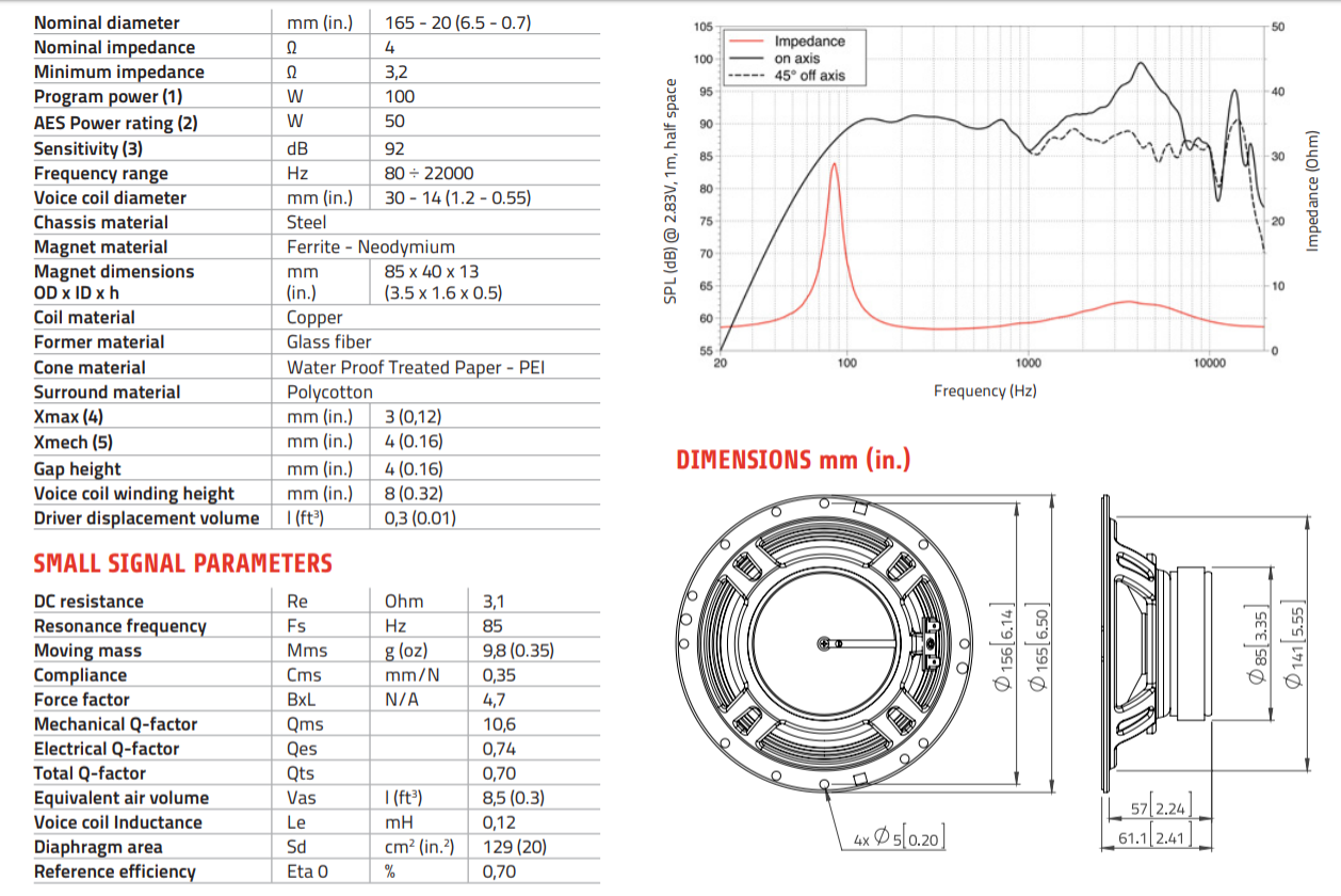

LaVoce has a $21.66 6.5" coax - its qts isn't much higher than what I measured for LCao F6 which in a Karlsonator 6 ( CSF061's fs is somewhat higher)
http://www.lavocespeakers.com/lavoce/assets/datasheets/LAVOCE_CSF061.20_6.5in_COAXIAL_A.a.pdf

On-axis is pretty hot-
Price isn't too bad though. If they had a 4 ohm I would be interested in running a set in my car (73 super beetle, rear shelf and front kick panels, so off-axis they would probably be pretty good) but that's another show 🙂
ah that's that crazy one "optimized" for 45 degrees off axis. Looking at the AHE7166 in a closed box, things aren't helped a lot by going to 3rd order at 16 liters - 20 liters looks ok
with a pretty impulse. Rg has to be low for cap assisted closed boxes to work.
20 liter box - 900uF cap (would be 450uF typical for 8 ohm drivers)

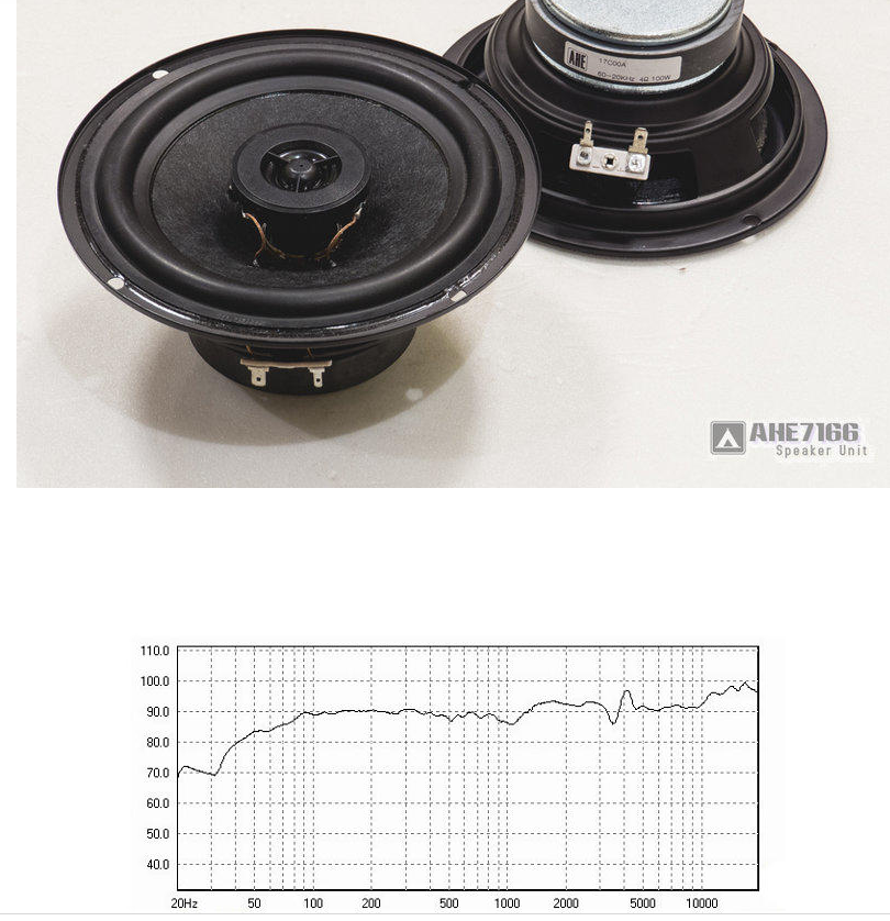

On axis hot may be magically transformed by the K aperture to be acceptably flat. This was the case with CHN-70 which had a large mid range hot “mesa” shaped response that sounds quite nice once inside a K aperture of a 0.47x Karlsonator. I’ll try to look at a sealed K12 sim for you Freddi. Bass is generally lacking with a sealed alignment though.

If you can get me the TS parameters for the AHE7166 in Akabak format that would be helpful.
Perceval,
No problem, X... don't want to give you trouble. Whenever you can... or maybe you can't because I don't have Bl nor Mms, is that a deal breaker? We could try to guess those... otherwise, I'll have to buy a pair and use DATS on them.
Def_Driver 'AHE7166' | AHE 7166 Qts 0.94, 3.0mm xmax, 100w 90.3dB
