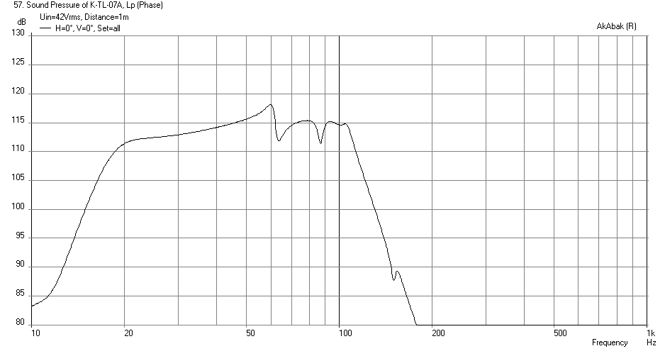

There was also the MOAK thread where I was designing very large Karlsonator sub for DeonC:
MOAK: The Mother of All Karlsonators (aka The Magnificent Monster)
It was a 2.5x scale Karlsonator with dual AE TDM15H's, it goes to 20Hz:

I did a simulation using a W8-1722 woofer and it has been the best sim I have done yet, one that reaches low and with nice output. It could be mated to a small mini-k sitting on top of the folded line.
Never had the chance to build it yet...
