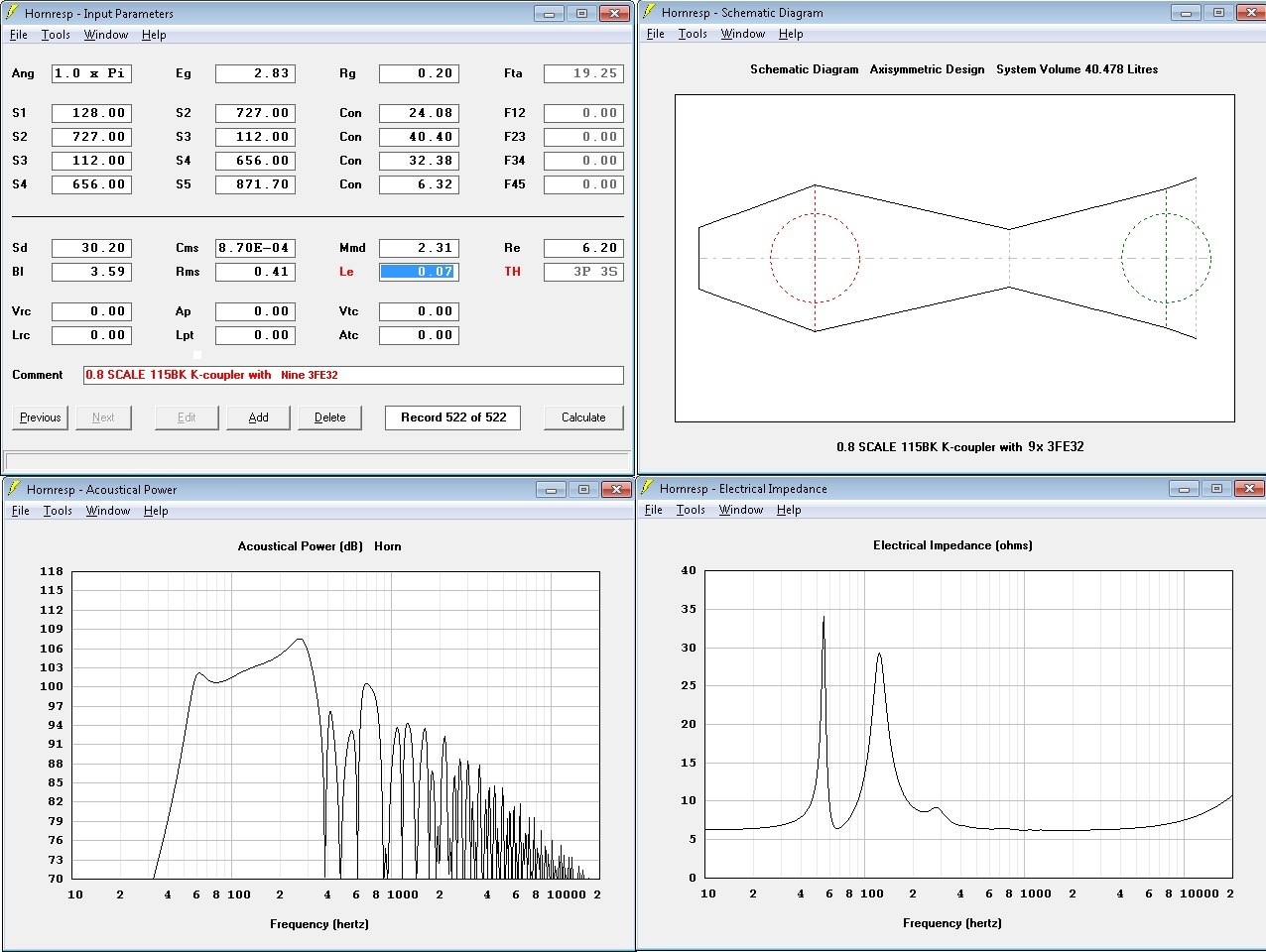

A while ago, X commented the following when I asked about speakers for a First Watt M2: “You need more air displacement. As they say, there’s no replacement for displacement.”
Since then I've been toying with the idea to build a bigger speaker based on the Karsonator with dual FaitalPro 3FE25-16, because it has such a good sound. Then I thought, why not have four 0.53 K’s stacked on top of each other per side. That means 2 duals in series and 2 duals in parallel (still 8 Ohms). 8 drivers per channel.
Is there anything wrong with my logic? And if there is a better idea for budget M2 speakers, I’d like to hear about it.

You could make a larger karlsonator with 2x2 or 3x3 array of smaller drivers and then be able to wire them series-parallel for increased sensitivity. I think buried in this thread, I have a sim of a 3x3 Karlsonator using the Bose 901 drivers (1 Ohm ea and all in series) for quite an impressive speakers.
If you are interested in qnty 8 x 3FE25-16's at 8ohms, that works too. The cost of 8x$19 is getting up there with a more expensive larger driver, but the larger driver won't give you the highs of a small full range.
You could array multiple K boxes as you say, but that destroys the point source nature of the sound - and you may get phase anomalies and what is called "comb interference".
Better to stuff all 8 or 9 inside one larger cabinet with a single K aperture. Note that this has only been tried up to 2x2=4 drivers by a member (somewhere in this thread - from Korea). I have not done it myself so it may or may not work.
I can simulate for you a 3x3 3FE25-8 (good as it places 3 drives along centerline axis) for better physical alignment with aperture middle. This will give you a pretty sensitive 97dB speaker with 36% the cone area of a 15in woofer or equivalent bass of a 9in woofer, but with mids and highs of a 3.5in driver.

If you have the time to do that, I'd be very grateful, X.Better to stuff all 8 or 9 inside one larger cabinet with a single K aperture. Note that this has only been tried up to 2x2=4 drivers by a member (somewhere in this thread - from Korea). I have not done it myself so it may or may not work.
