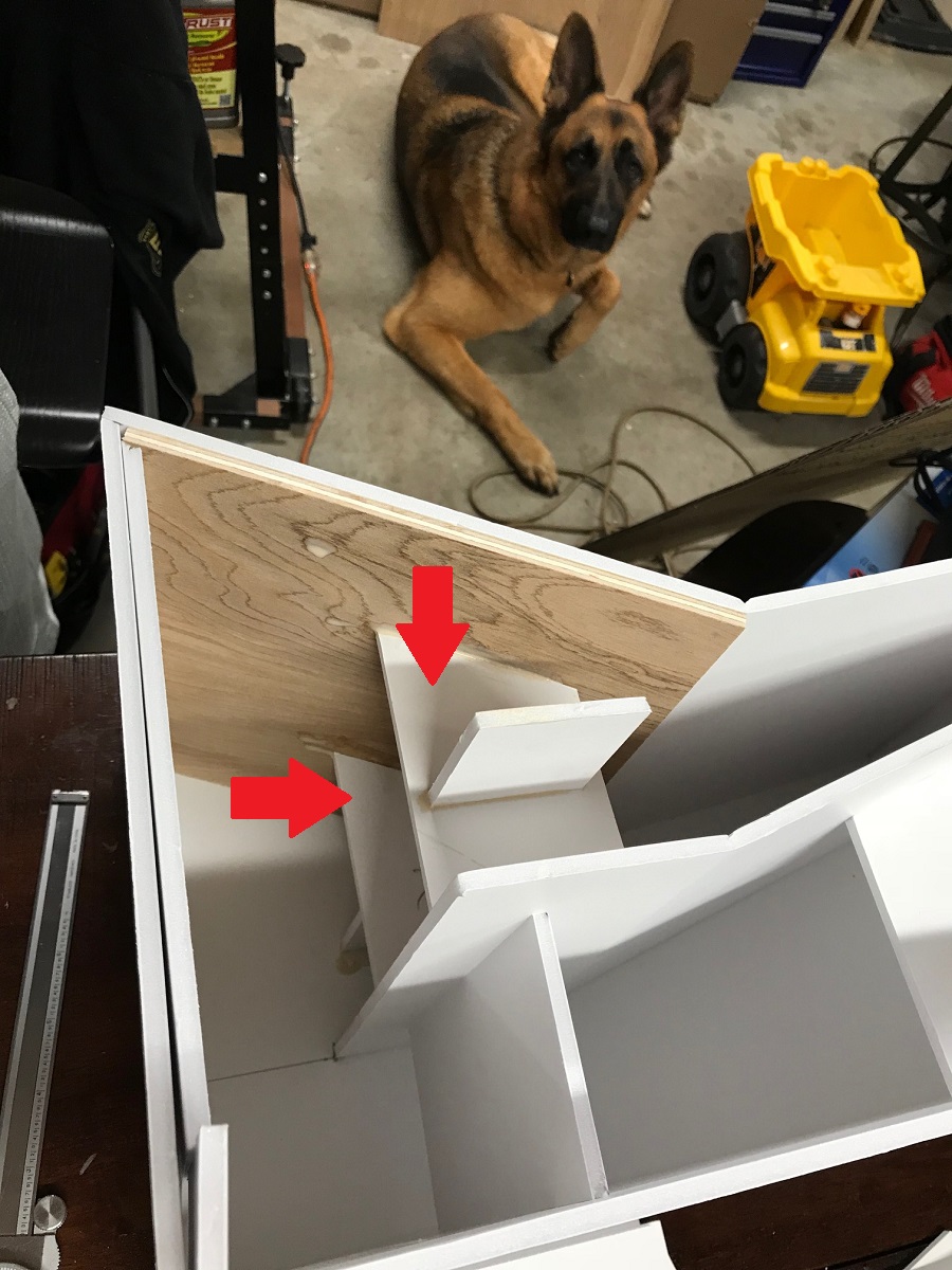

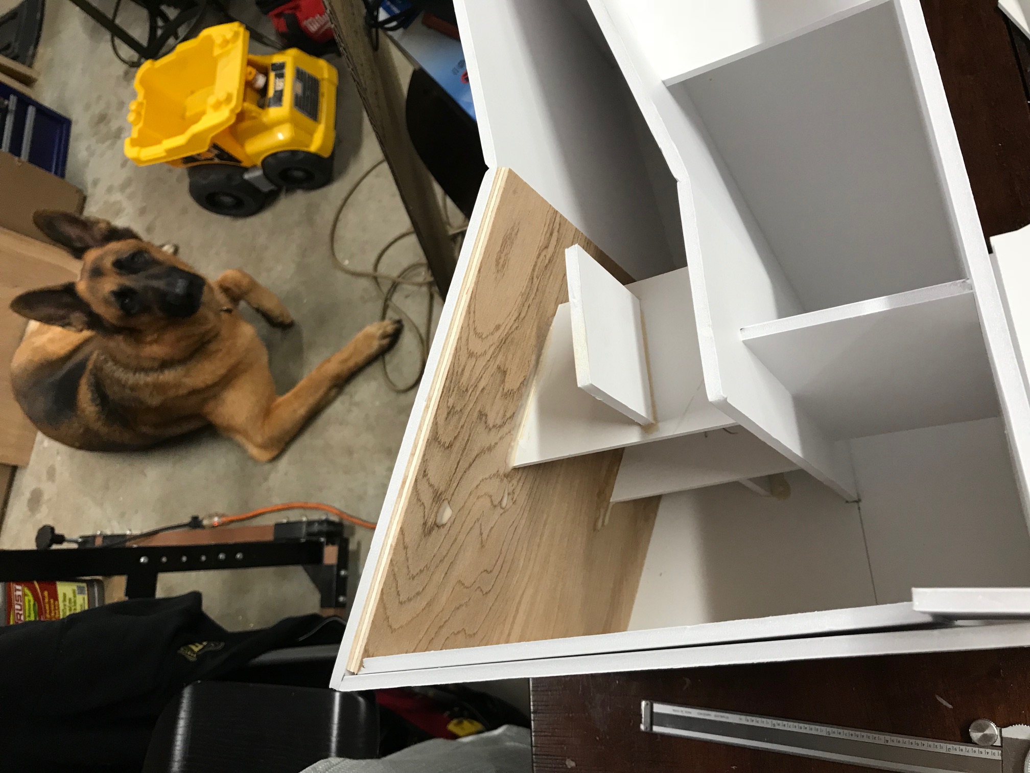

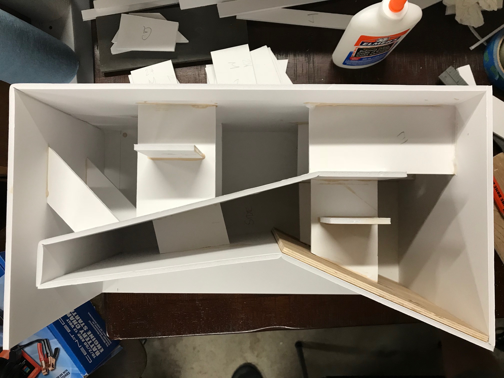

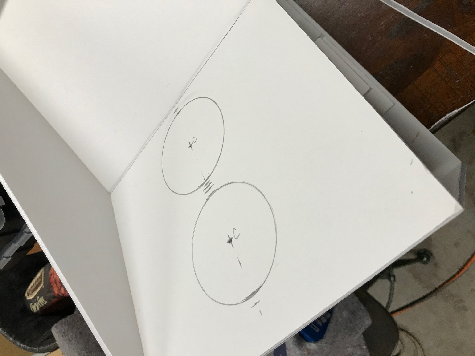

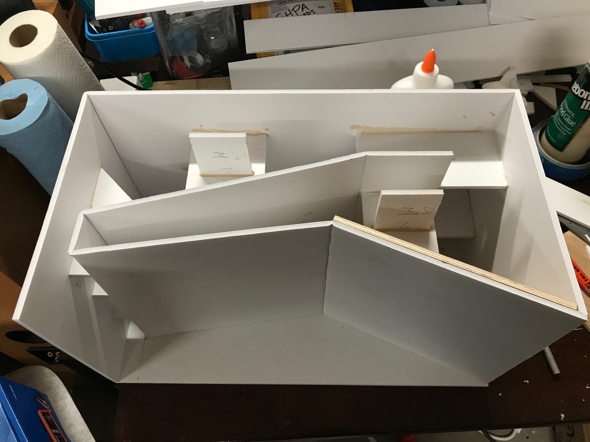

Making slow but steady progress on my 0.53x Dual 3FE25-16 mini-k's. I went with a layer of 3/16" plywood under the top layer of foamcore to support the drivers and provide a solid material for the screws to bite into. With all the bracing glued up these things are tanks. So sturdy! I used MuddJester's score and fold plans but I added 3/8" to the height of the driver board so the lower driver doesn't hit the bottom of the enclosure before it's fully seated. 1/4" probably would have been sufficient. I started cutting the driver holes out with my Dremel and a 1/8" spiral upcut bit last night (with some help from my pup 😀 ). Maybe not the best method but I don't have a 2-7/8" hole saw to make the cutouts. We'll see how it turns out. Getting close!!!
Great looking build there, Jwjarch! You can also put the wood on the top (front). A 3/16in layer of wood on the front face of the aperture wouldn’t be a bad idea either.
I think this one is going to sound pretty fantastic. I think JPS64 is also contemplating the same build. Thanks for the photos - lots of great detail on the bracing.
Looking good! Certainly enough bracing there! 😉
Can't wait to hear what you think of them.
Thanks guys! The bracing is per MuddJester's plans with the exception of the 'E' brace. I added another one of those to stiffen up the bottom rear corner section of the speaker. Should make it fun to cut and fit all the felt too. 😀 I really can't wait to hear these! I think they will be a great test speaker to see what the differences are between all of my future amp builds.
@jwjarch
Are these two braces permanent? I'm worried about shrouding of the driver if they are.
Yes, those are permanent, Skylar. I thought about that too. I'm contemplating making a few holes in those braces to free up the air around the drivers. Thoughts?
How did you brace your driver boards?
Skylar, looking back at Twocent's post of your build it appears you had minimal bracing in the speakers. I wonder if I over did it.
You can glue some felt to the braces to reduce direct reflection of the back wave. Or the Mr Clean Magic Eraser Pads (sliced to half thickness) works well too.
You can get a bag of 100 of those pads on EBay from China for $7. They are reticulated melamine sponges - same as BASF professional sound abatement foam.
Skylar, looking back at Twocent's post of your build it appears you had minimal bracing in the speakers. I wonder if I over did it.![]()
Yes, the bracing that you saw in the pictures are the only ones I put in.
Jwjarch, I have never built speakers before these Karls, let alone design them, so I can only go by what I hear from my speakers. To Twocents and myself they sound fantastic for their size - and that is with minimal bracing.
From what I've read, bracing is good, so I don't think you've overdone it.
