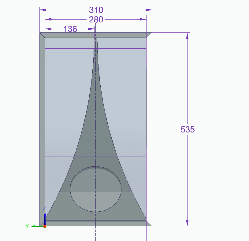

Hello, I just build a slightly modified Karlsonator to fit Tb W6-658E out of 12mm (shitty) plywood.
X-max:4.10 mm
Vas:28.31 Litr
Qts:0.44
Qms:4.49
Qes:0.49
Complete speaker data here: W6-658I - 6.5" PPM. Woofer - TB SPEAKER CO., LTD.

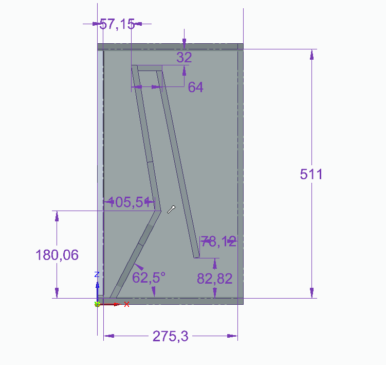

The dimensions i ended up with was something close to this:
So far it does its job but i expect a more refined version sound better. The final version will probably be 16mm MDF.
The "original" karlsonator dimensions i have found seems to be this:
And the 6" version has more changes than just scaling:
Are the W6-658E suited for a Karlsonator at all and what would be the correct way to scale?
In more general terms, what different options would be usable to be able to scale individually? I am thinking of making an parametrisation/automation where it will generate new plans according to new conditions, so any input regarding what dimensions you would like to modify and i will be happy to automate plans for you.

Let me run a simulation and see what ideal scaling is for W6-658E.
Thanks for offer to make plans.
Thank you XKR,
So when you simulate, what dimensions do you generate? I put out A-Z on the attached PDF and if you could point out what you would like to be "driving" i could make everything else adjust accordingly. Also If there is some other relations or so please try to explain what should relate and i will try to make the whole thing automatic.

Thank you XKR,
I adjust scale in two dimensions: the height and depth at same time, and width independently. Sometimes all dimensions together like the 0.40x and 0.53x are scaled globally.
Alright, I made a template that spits out a drawing. I don't know if it will be to use for anyone but just let me know and i can make one according to your needs. if you would like other dimensions visible or another format please let me know.
I attached how it would look like based on a 1:1 scale in mm.
It can scale independently in all directions and adjust according to material thickness. You can enter custom thickness to every piece.
looks like the tuning of the old Karlsonator 6 prototype was around 60Hz
(Karlsonator8 ~41Hz tuning)
Do you know why more changes than just scaling was done on those two?
