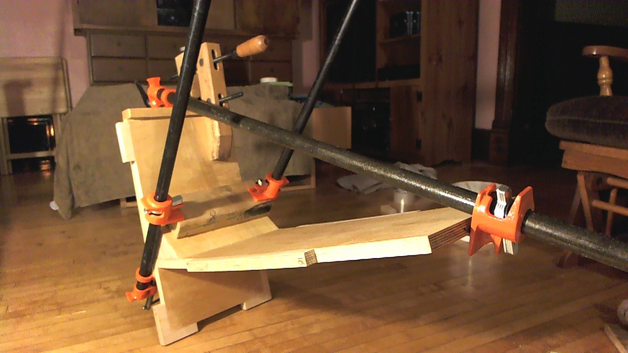

Yahoo, all the "stacked" pieces are glued, that being the backchambers and exit triangles. So I am done with all the slipping glue joints. I had to make I special jig to glue the triangles in place. Next I will be getting some 2X4s to assist me glueing the sides on. We are getting there.

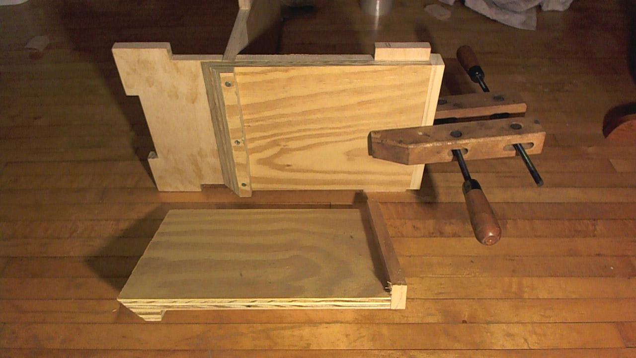

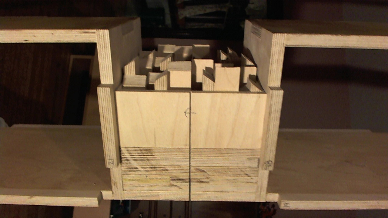

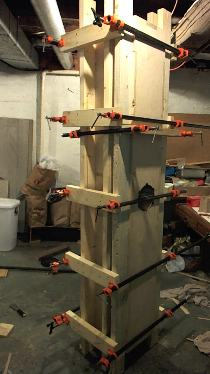

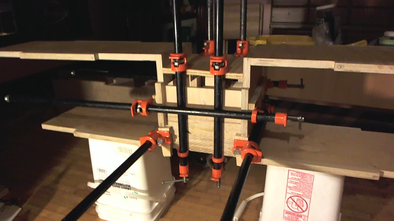

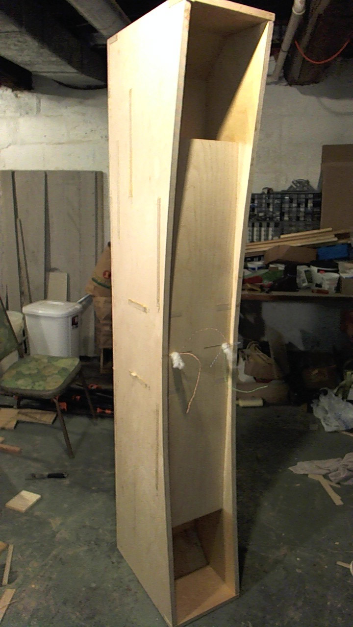

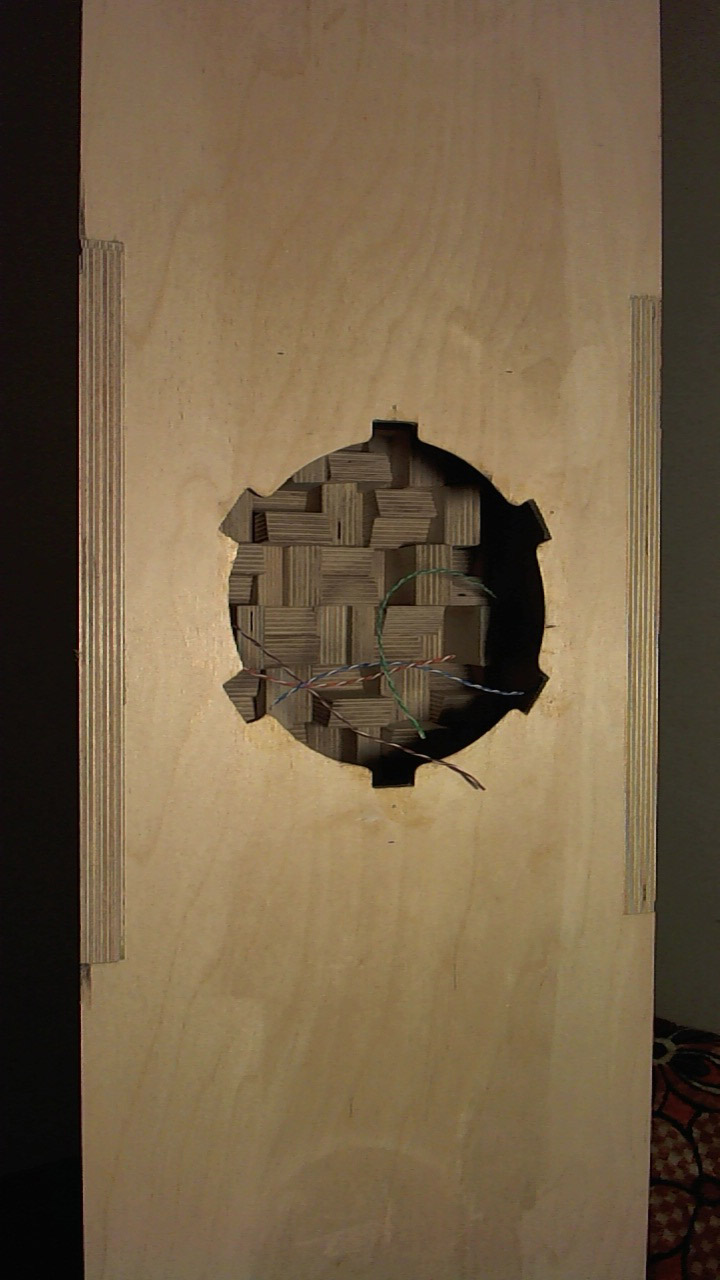

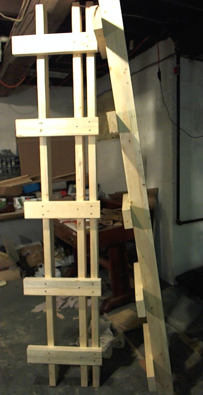

Here are the final preparations before the final gluing:
Picture 1 shows the final horn internals before they are permanently hidden with-in the finished cabinets.
Picture 2 shows the groove I cut for the speaker wire, it would be bad to forget that! I thought about running the wire down the horn throat to exit on the bottom of the cabinet, but did not want to chance it vibrating inside the horn. I stuffed some fluff inside the groove with the wire before gluing.

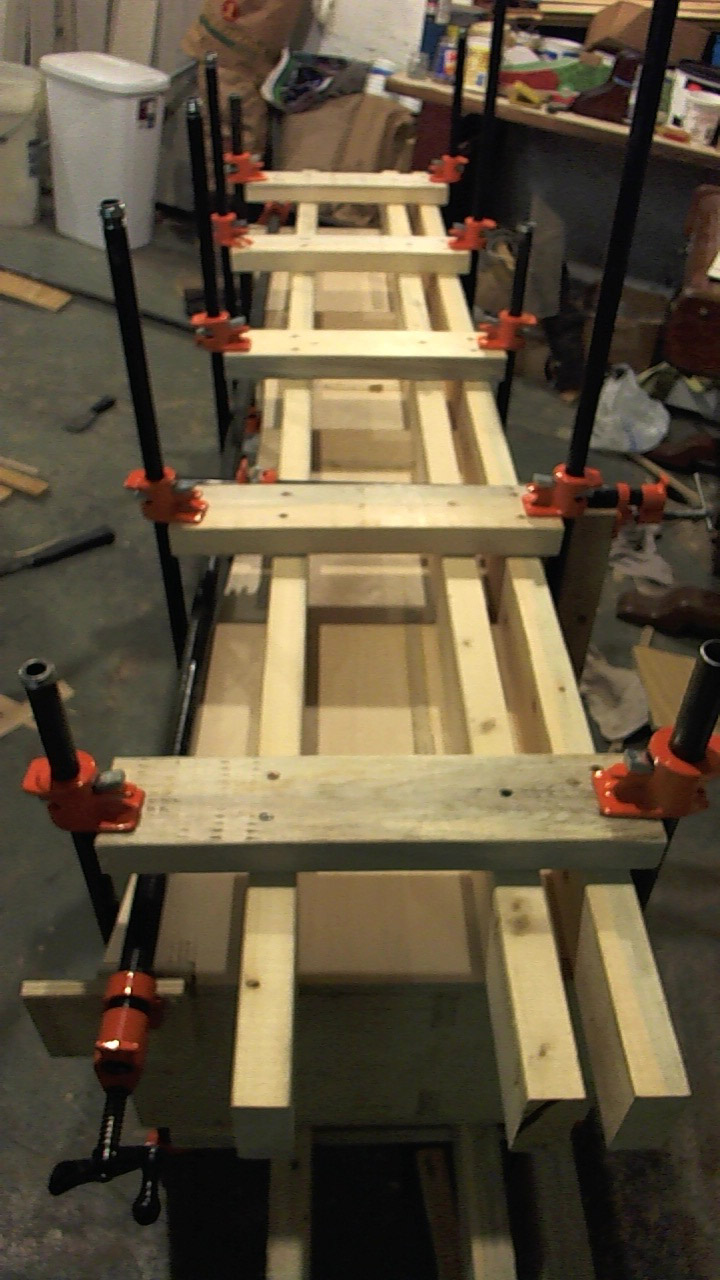

Picture 3 shows the jig I built to get even pressure down the entire length and width of the sides. At this point, I want to minimize any possibility of a clamp shortage!
Everything is wiped down and ready to go... Ready... Aim... Aim... Aim...

First cabinet getting glued:![mischievous :mischiev: :mischiev:](https://files.diyaudio.com/forums/images/smilies/mischiev.gif)
I would have to say, this was the most stressful part of this journey to date, becuase you must move fast as there is so much to glue all at once. And being the detailed person I am, this is very nerve-racking for me. In addition to glueing the cabinets, I filled in some of the gaps in the joinery. I would be gluing the second cabinet now, but I do not have a big enough slot of time!
One done, one to go...

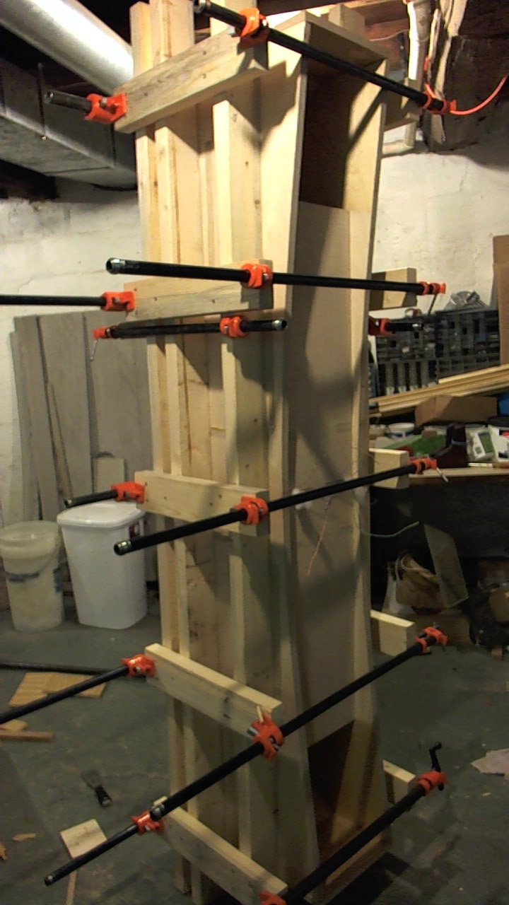

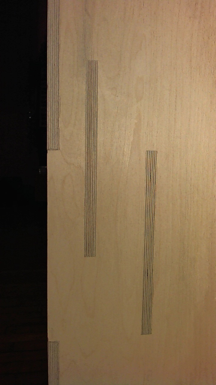

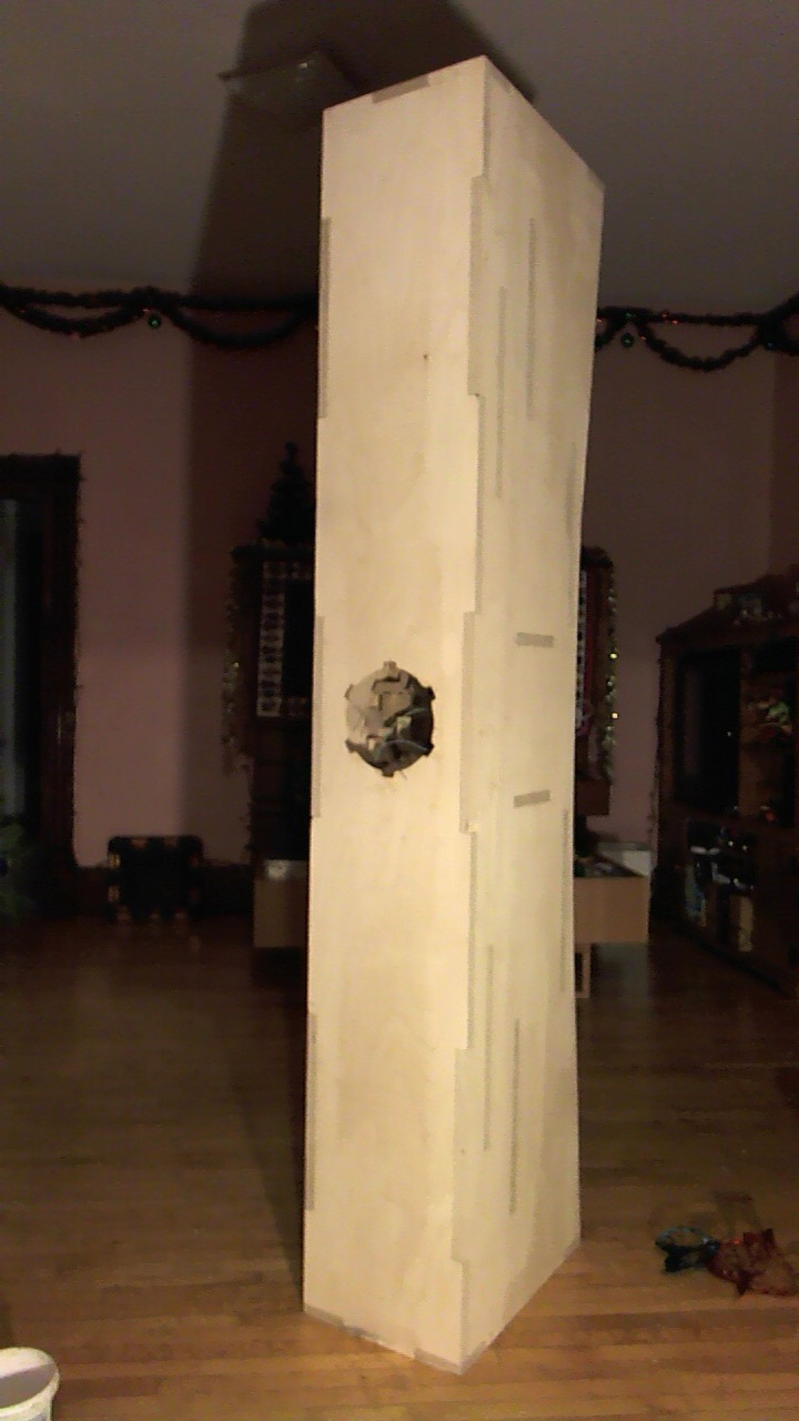

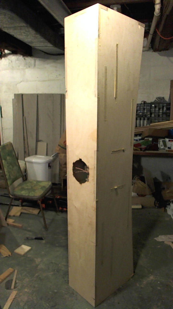

Both cabinets glued
Have reached another big milestone on this adventure. All the gluing is done. Feeling a little excitement now.

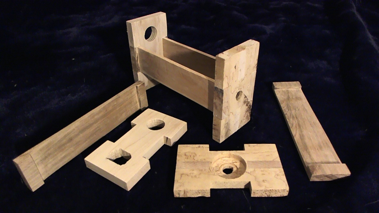

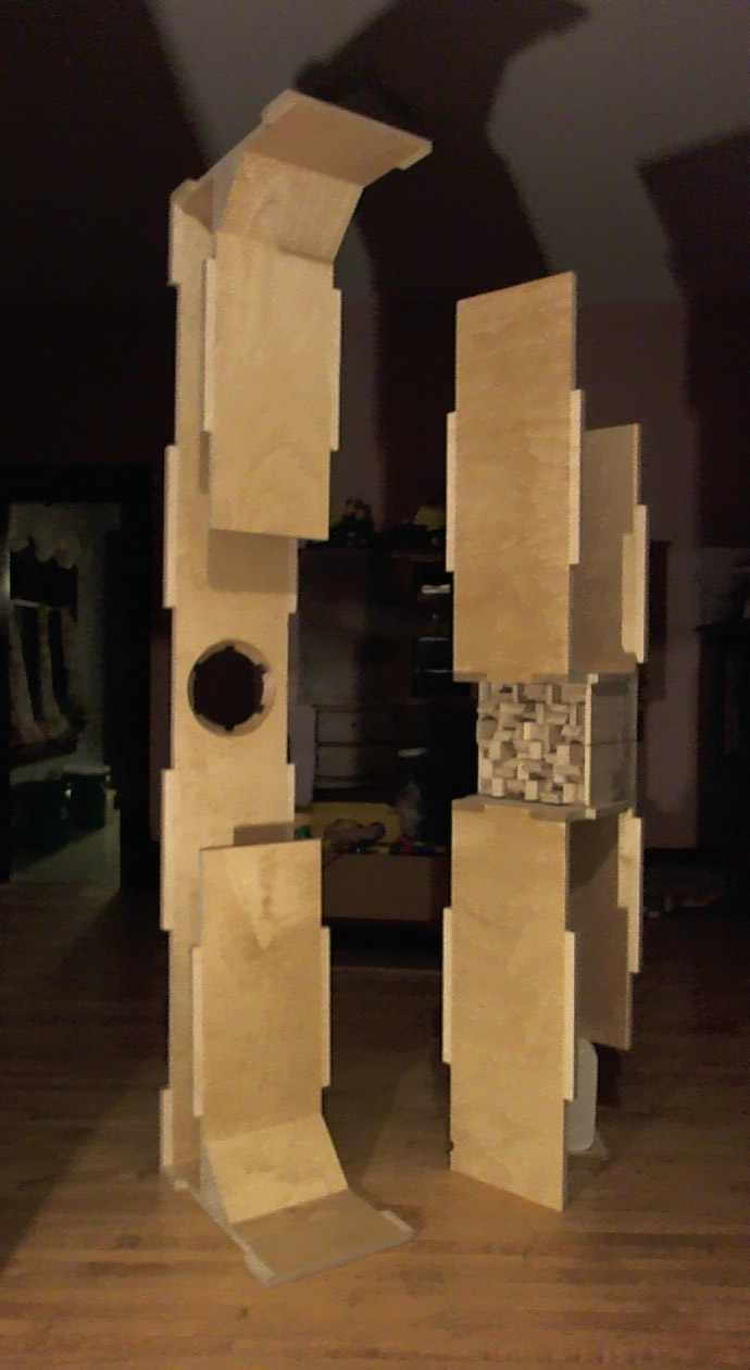

Now if I had this exact design, joinery and diffusion assembly to do again, this is what I would do different:
I would cut all the internal pieces first (same joinery style). I would then glue all the internal pieces together (incluing diffusion assembly). By this time I would have the assemblies you see in picture 1 on post #222 without the tung oil. Then I would cut the sides to fit into these completed assemblies. Then everything would be finished with tung oil and finally glued together as above. This process would eliminate some sanding I had to do from seeping tung oil (post #219) and some of the joinery inaccuracies I experienced *post #224, pictures 3 & 4).
I would seriously consider plexiglass sides.
Golly, I have not even heard this system yet, and am already thinking of ways to make another one! Doubtingthomas has really got me thinking on the whole modern art bit. The cabinets as they stand are very ho hum to my eye considering all the art hidden inside. All is not lost, as I have the maple exteriors yet . I am not sure if I have been able to communicate my intentions to you all on what I am doing with that. As for now, I want to get this raw system going first as that will inspire and clarify my vision on this.
Namaste,
Allen

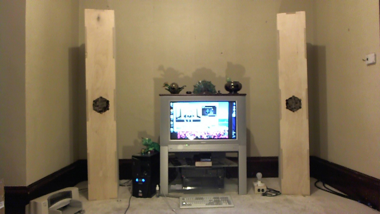

Cabinets Awaiting Amps

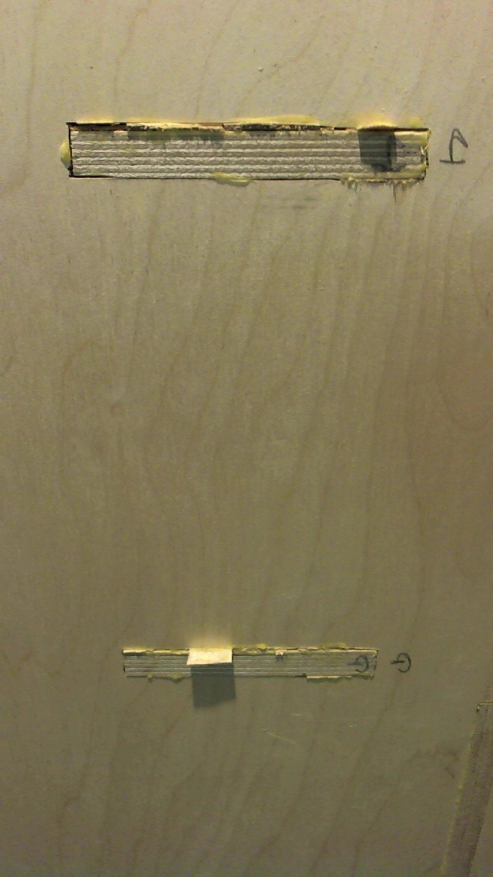

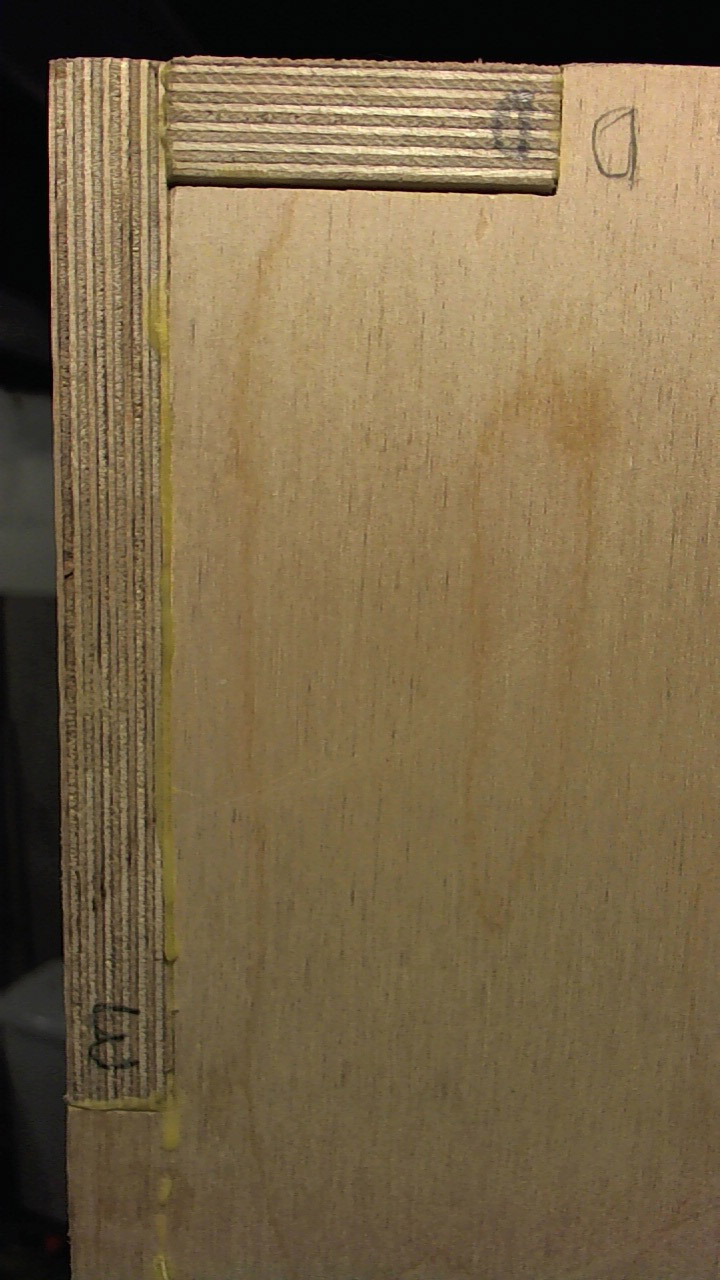

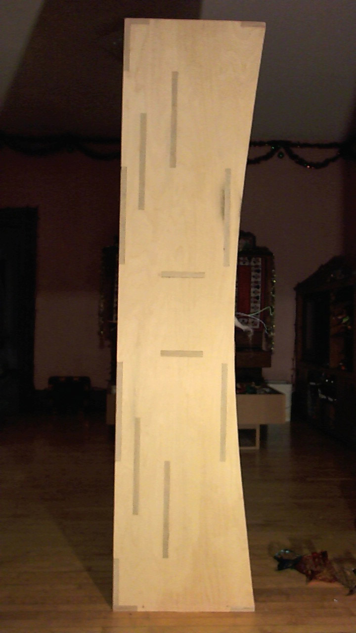

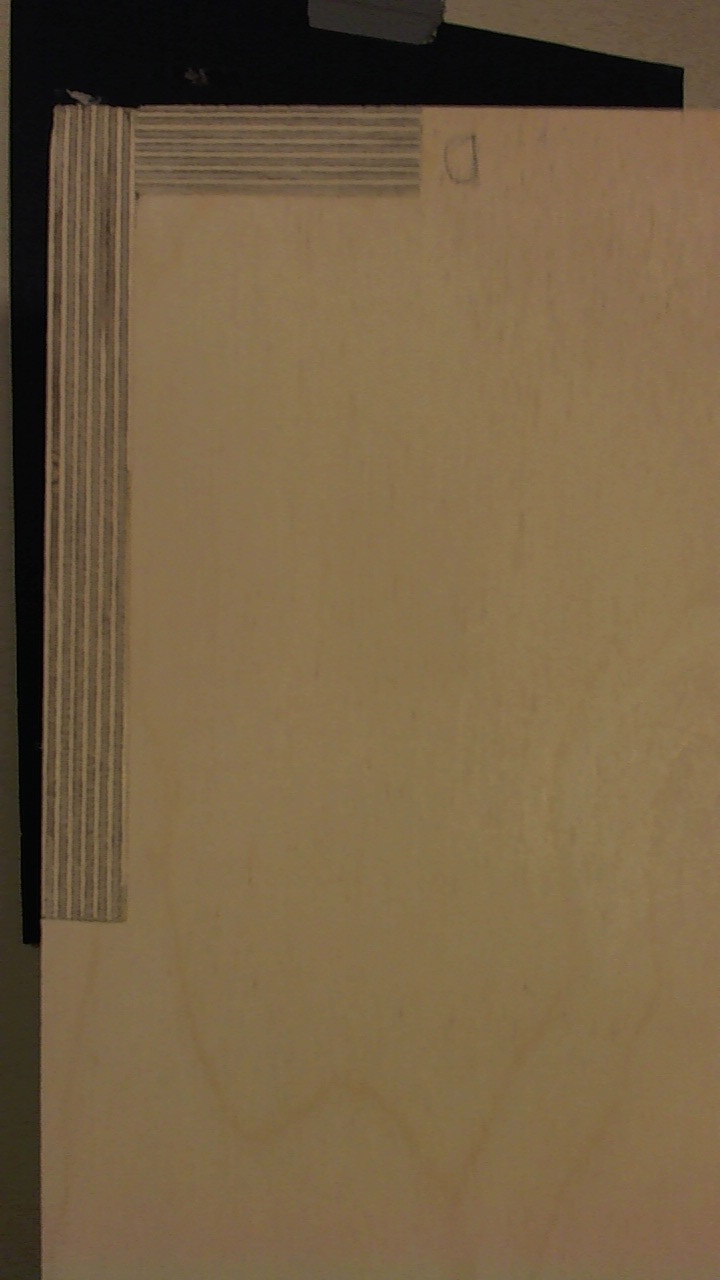

Joinery Repairs were a success: I went a little heavy in some areas with the belt sander and removed the first ply on the birch. It does not take much as the plys are so thin. This does not matter to me, but if you are not covering the cabinets with something else, great care will need to be given even with finish sanding. I still plan on covering these, as both the plys and veneer do not have enough "depth" for the sheer presence these Avebury cabinets present to the room. Very solid build...

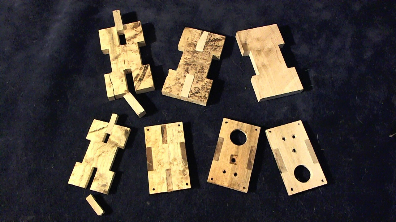

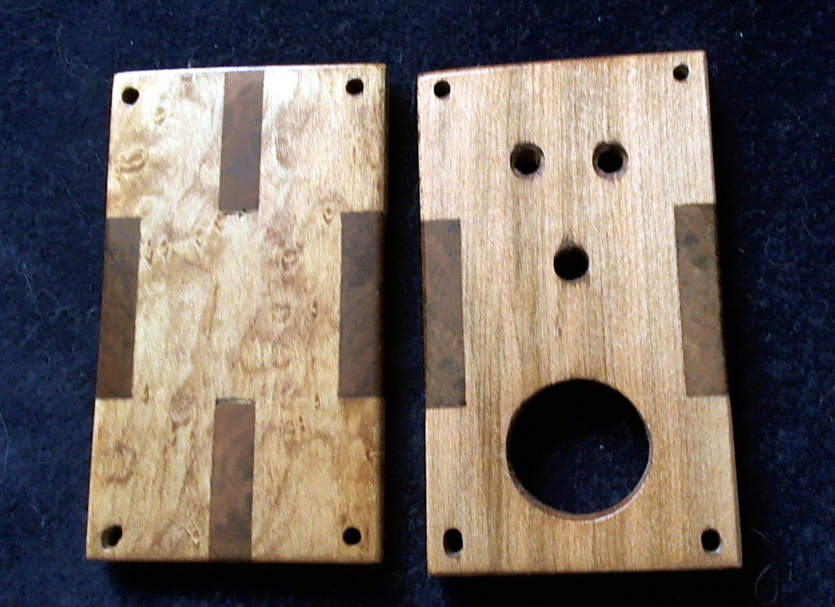

Amp Cases
It is not the assembly of the amps that take the time, it is the design and fabrication of the cases. I decided to go with solid maple here, to warm me up to the maple work on the Aveburys. I have metal heatsink cases for the Amps and heavy gauge metal speaker grills to fabricate the metal ventalated sides for the PSUs. I have made some extra wood panels for the Lightspeed volume control. The hardest part is cutting all the holes where the switches, plugs, and jacks, go. Some of the hardware needed to be "recessed" into the wood to accommidate proper mounting. This is a project in and of itself.

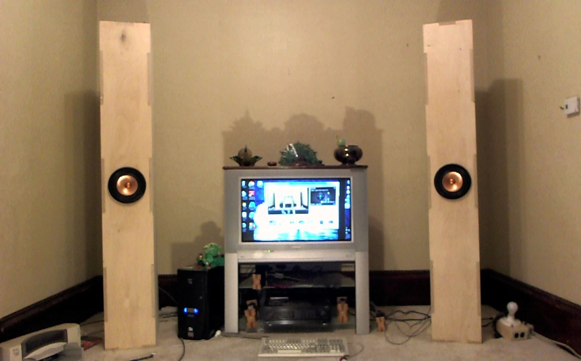

We have Bass!
I have a lot to share with you today... your patience has paid off!
I will start with the begining of the end, share the journey to the end and end with the present begining.
I am pleased to announce that after breaking in the Alpair 12s in for 14 hours unbaffled on the floor hooked up to my working chip amps, I was ready to install one into one completed Avebury "in the raw" cabinets...
First impression - Holy Wow, that is a lot of bass, and this was with classical music. I have to say, I was skeptical that a 6" driver could do that! Excellent engineering Scott!..
