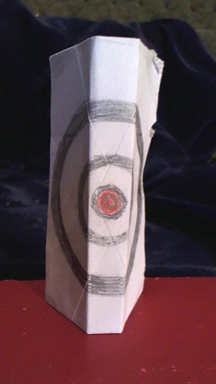

I like the Sunstar pattern also (thrid photo, right drawing), but not sure if it would be a bit much!
If there is any particular design the inspires any of you, put your votes in!
You do not think I am over doing it a little do ya!?!
I personally like the minimalist look. Sleek and simple.

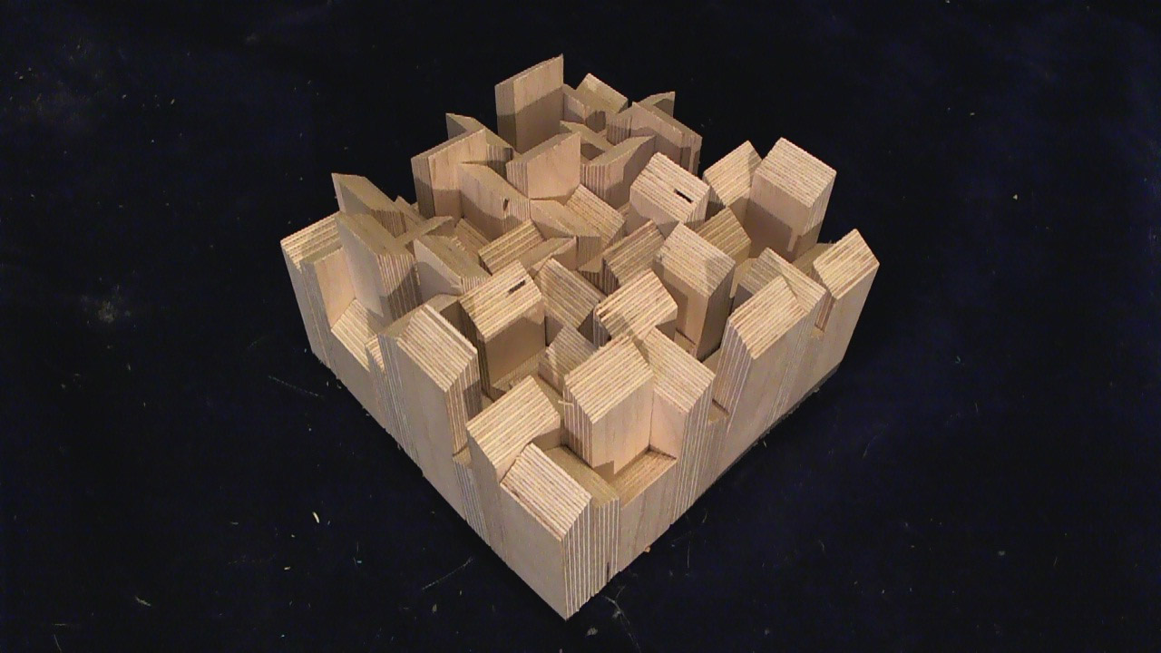

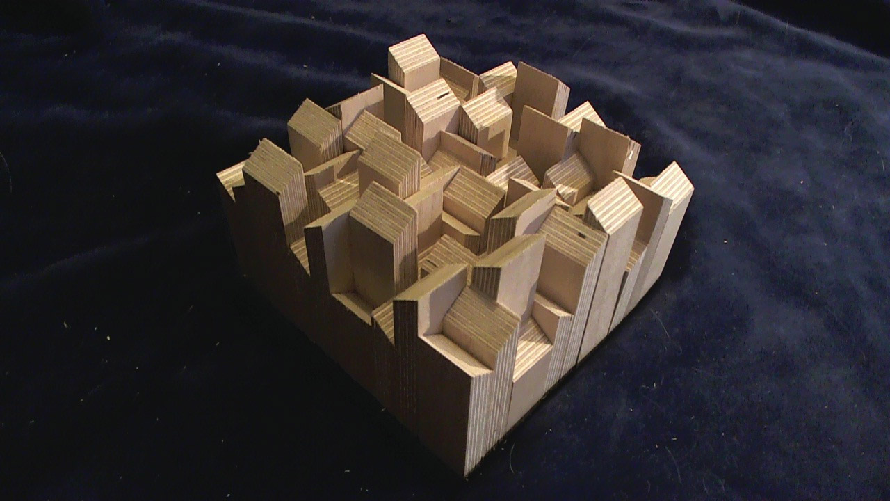

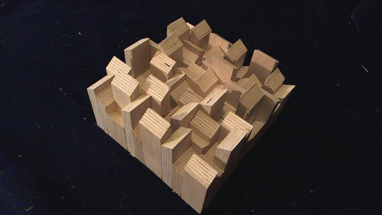

I got the horn exit triangles cut and the back chamber diffusion blocks cut. As you can see, I am filling the voids in with birch on the triangles, instead of sand. Less mess.
I am looking forward to figuring out how I am going to install the diffusion blocks. There are a lot of possibilities. I am quite geeked out by them, they are really cool! Play time!
God Bless
Allen
These diffusion blocks are going into the Mikasa? Are they taking the place of the step diffusers at the bottom and top? Are they going in at a 45 or 90 degree angle?
Are you going to use filler material? Where? I think I would leave a side capable of quick removal to be able to "tune" the cabinet.
