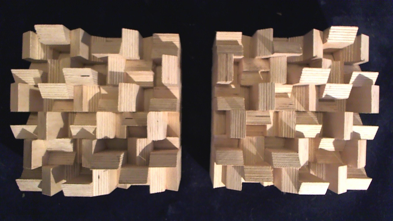

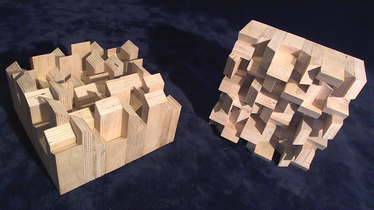

Lots of income earning work this week. Make hay while the sun is shining. Winter coming soon. Perfect time for the tedious glueing of these diffusers. Glue a row in the morning, glue another on break, and yet another between those two jobs...

I have a feeling you could glue and assemble the whole lot and secure them with rubber bands while they dry.

As for gluing with clamps, it can be a problem when everything isn't perfectly alligned, glue is very slippery when wet, I think the diffuser blocks are worth a try with rubber bands though.
I will give this a try on a future project. I got one diffuser completely glued and half the next one... ...I do not want to change the processthis close to the end. A freind of mine see these diffuser blocks and would like me to make him a whole wall of something similiar for his home recording studio! A rubberbanding party sounds like the best way to go on something like that!

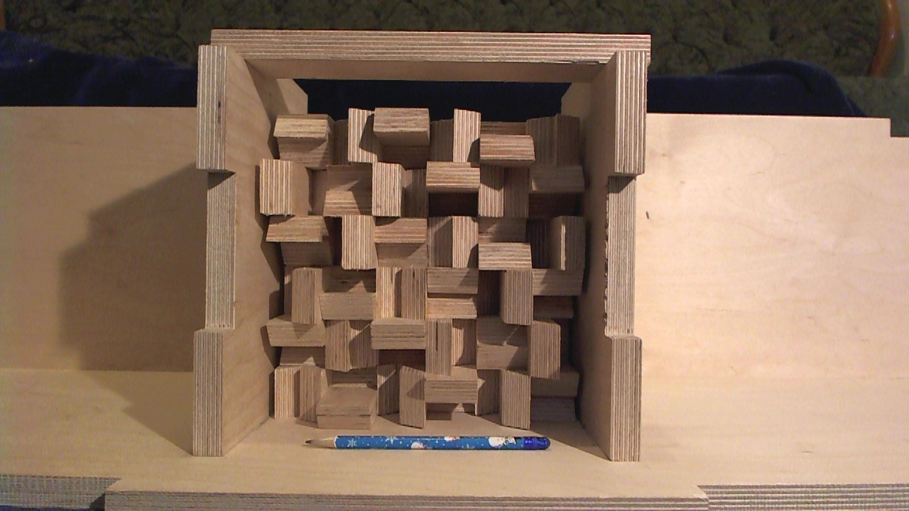

Here is where my diffuser sits in the back chamber. So I will line the top, bottom, and side walls up to the throats with the Denim product, in addition to having the piece behind the driver. The driver sits where I have laid the pencil. You all will note also, that the diffuser does not fit perfectly in the back chamber, which I planned on happening, just was not sure on the exact shortage, so now I can move forward on solving that problem. We are getting there guys.

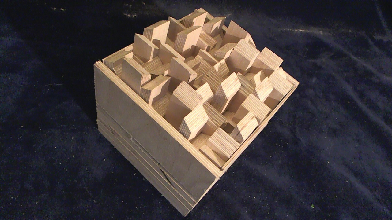

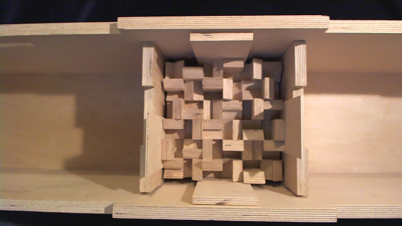

Back Chamber Assembly
It feels good to have moved this project forward today. This is the last of the birch plywood cuts for two reasons: #1 all the cuts are done and #2 I have used up all the birch! The scrap pieces left are good for fillers at best. But it is good to know that if you choose to fill all the voids in the cabinet with birch, you indeed can.

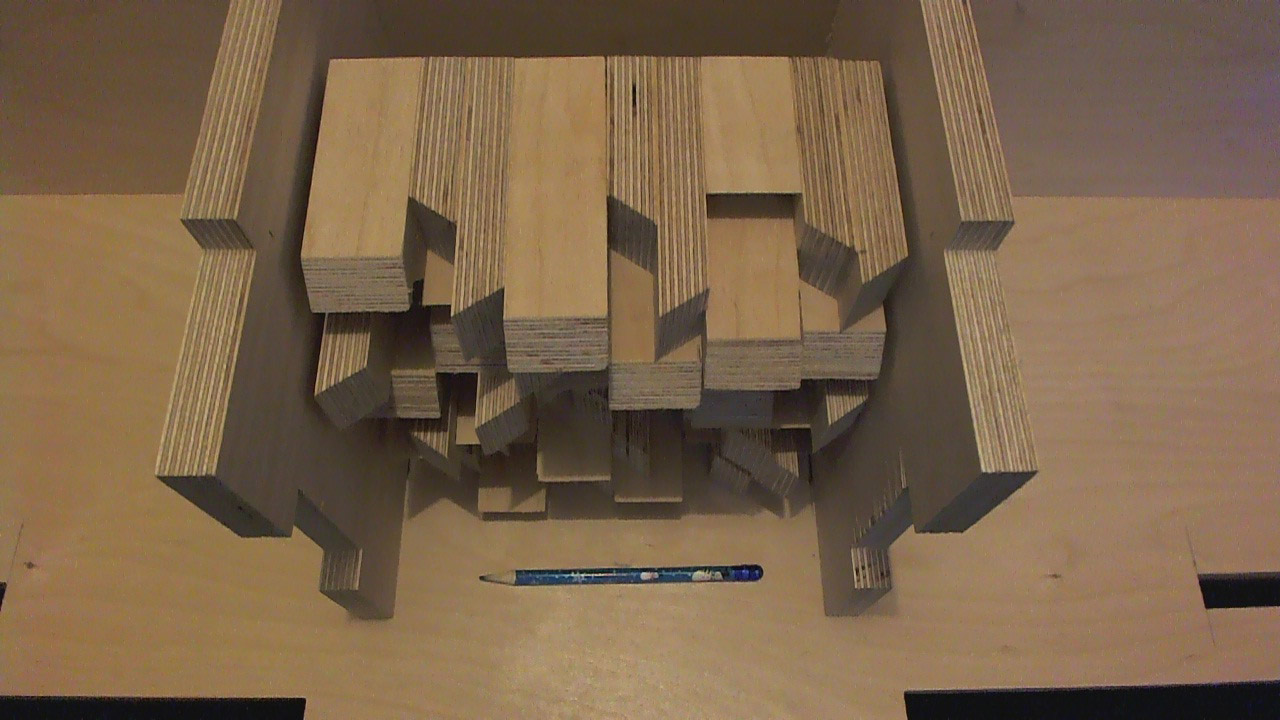

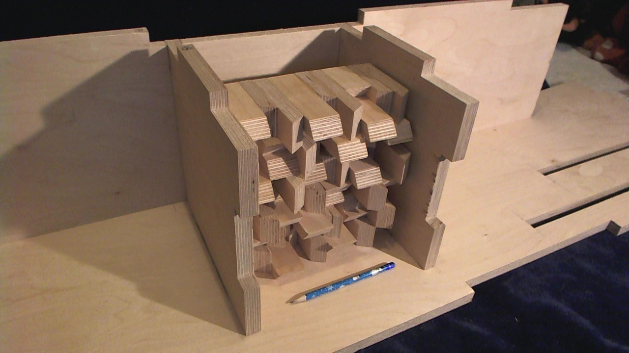

So here is the back chamber assembly so far:

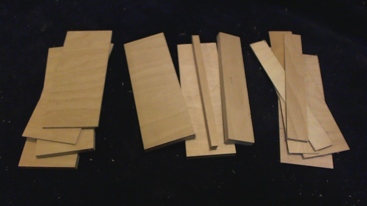

Picture 1 shows how I trail fit fillers to get the correct spacing.
Picture 2 shows the various fillers I created. On the left are the difuser spacers from picture 1. In the middle are the cut downs I used to fill in the void behind the diffuser assembly. And on the right are the cut offs from the fillers, which will be used to fill in misalignments in the joinery.
Picture 3 shows the complete back chamber dry fitted together waiting to be glued.
The next step is to finish the inside of the horn. I have never finished something before gluing it, so this will be a good experiment for me. Don't worry, I will not be finishing the glue joints. I am attempting to avoid any glue residue wrecking havoc on a good finish.

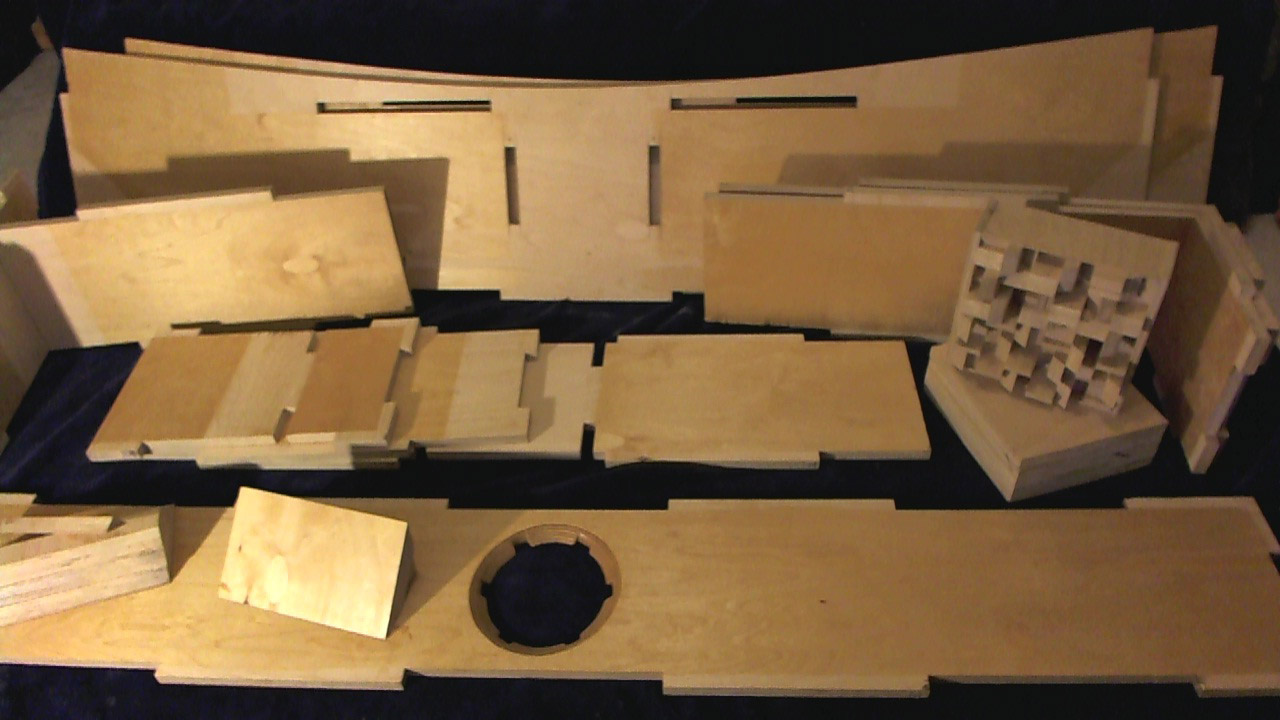

i am back!
I got majorly inspired by the Leadership Convention I went to. A life changing event, so much so, that I feel very sigificant changes occuring in my life. What role these speakers play in all of this is uncertain... ...I am finishing them to find out.
So here is what has transpired in the last three weeks:

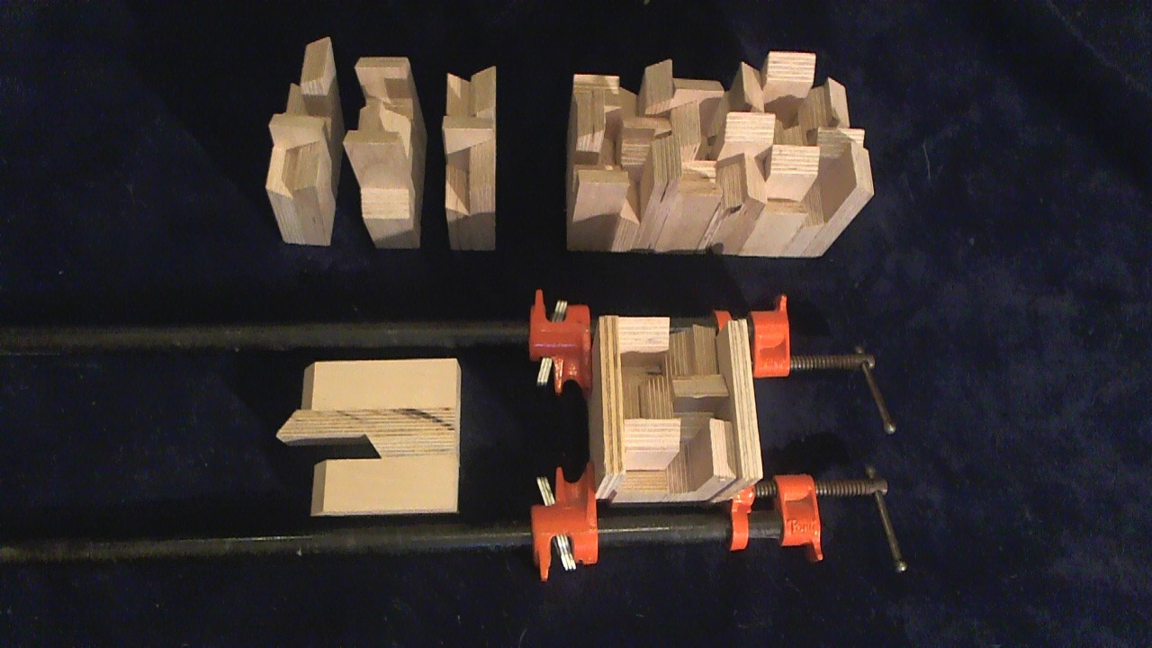

I finshed the inside surfaces of the cabinets with tung oil. I did this with the cabinets dry fit together. If I had this to do again, I would mask off each glue joint with blue tape and finish each piece individually. The reason being is the tung oil did "leak" onto the glue joints, so I had to sand it off these areas. Either way is a sizable time commitment. I am glad I did this, becuase it does work as planned. The glue does not stick to the tung oil and is easily removed from the finished panels. (picture 1)

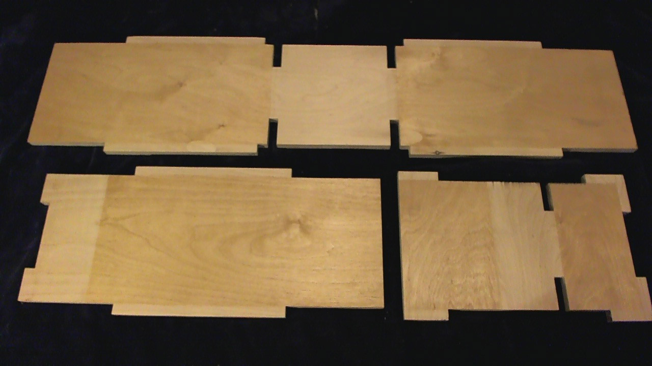

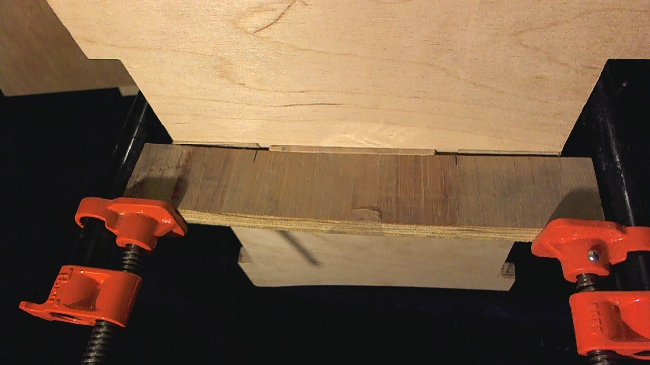

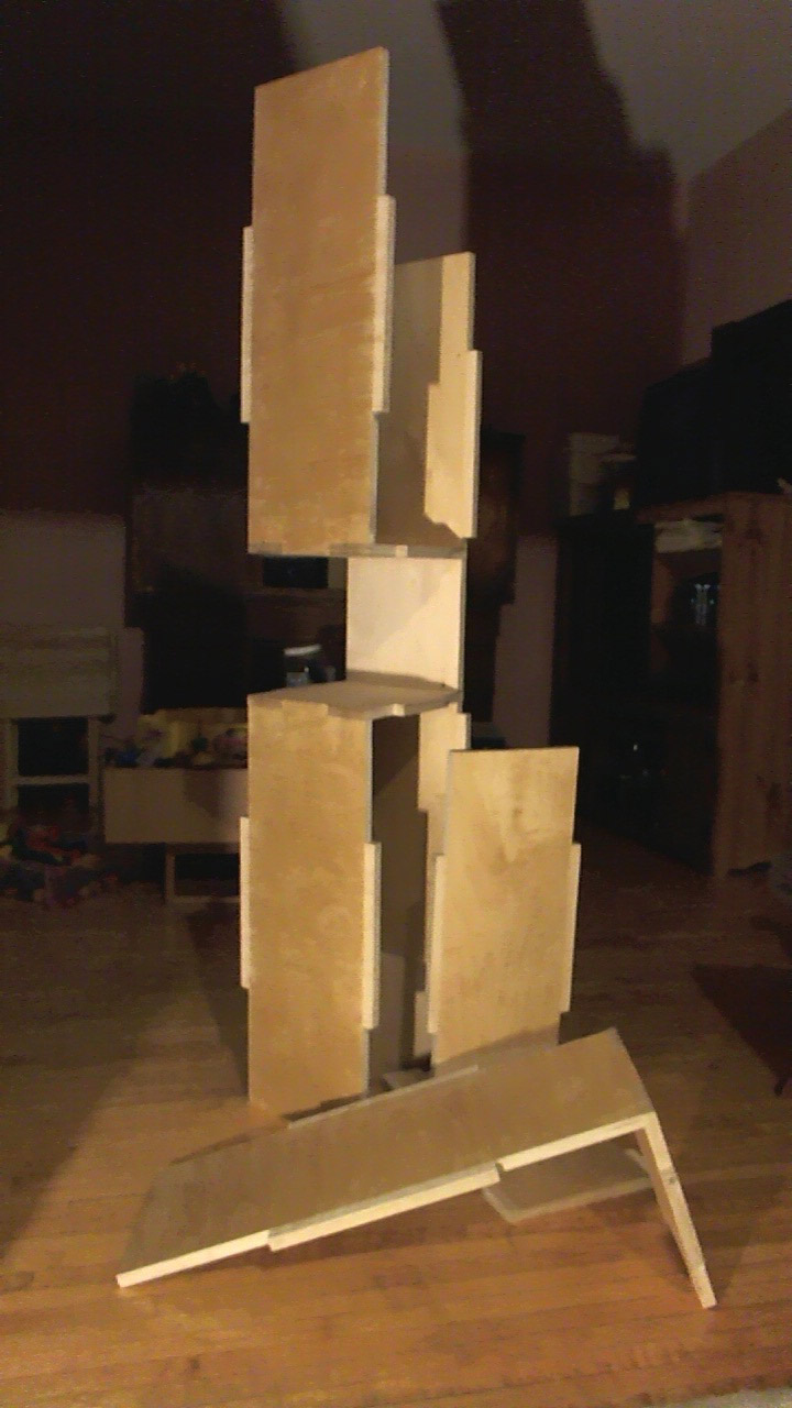

Picture 2 shows what I like to call "The Avebury Kit". All the parts are ready to be assembled. I think if a design like this was made into a kit one could order and assemble themselves, this is one possibility...

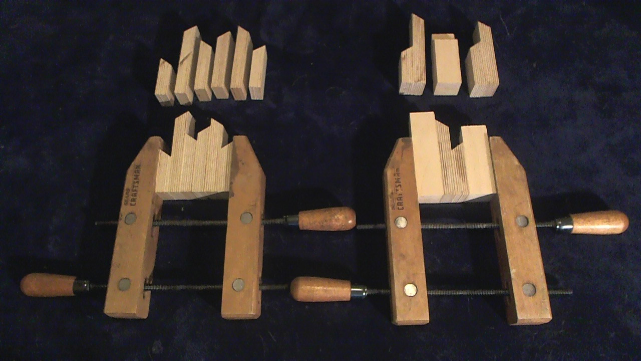

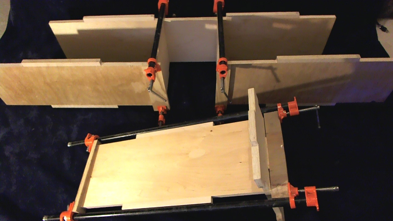

Picture 3 - glue and clamps.

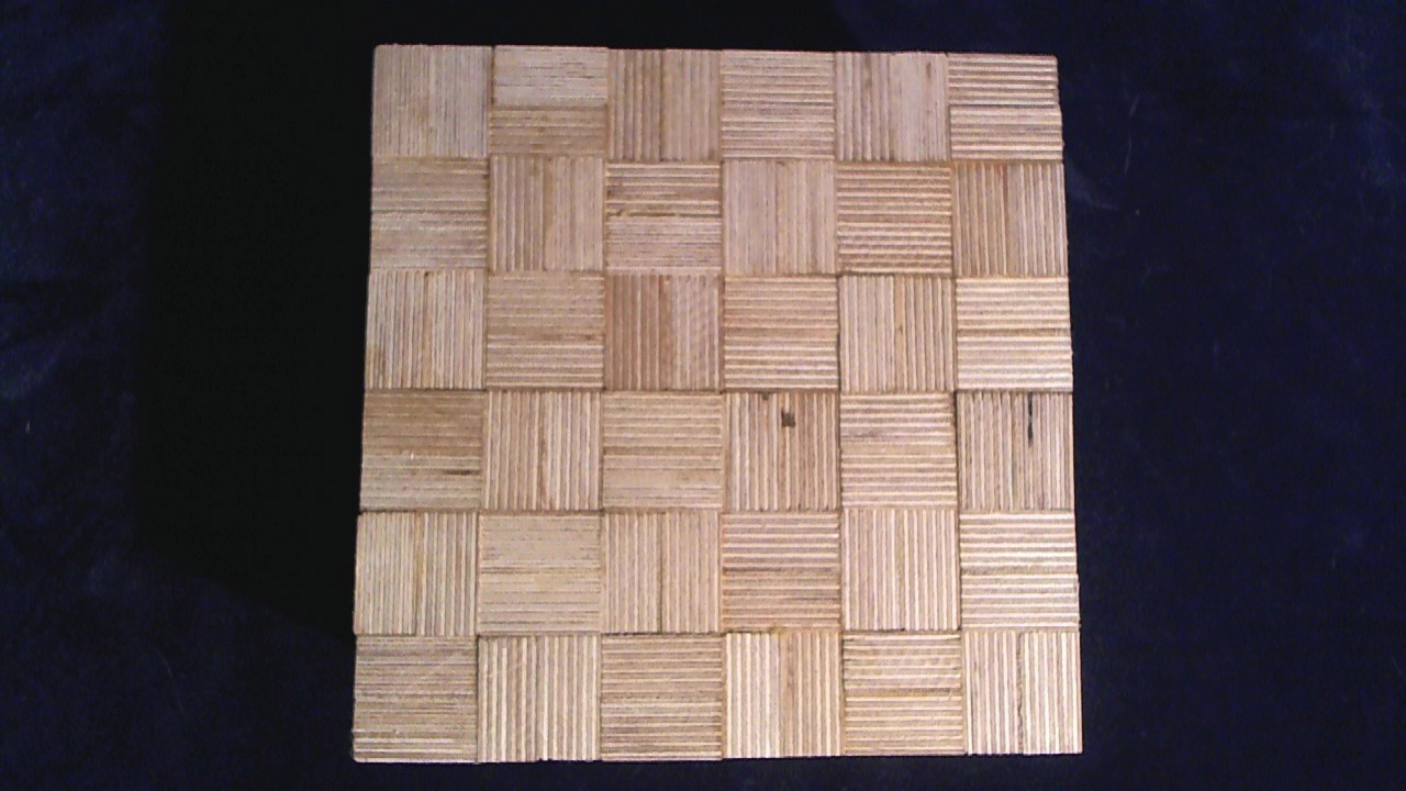

Picture 4 - the joinery jig used to place the clamp pressure where it needs to be.
Picture 5 - glued pieces "making a stand".
