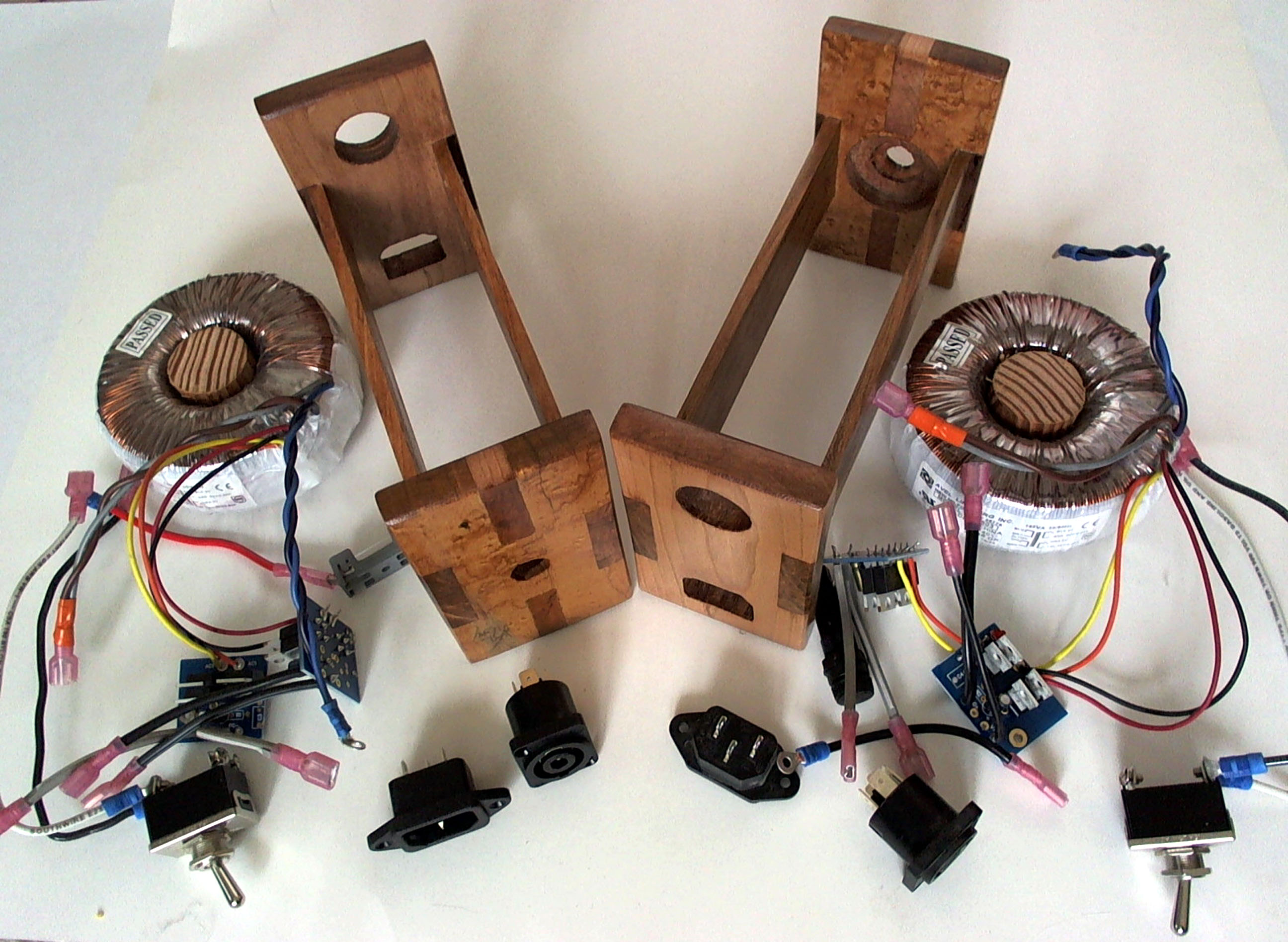

Now to the electronics

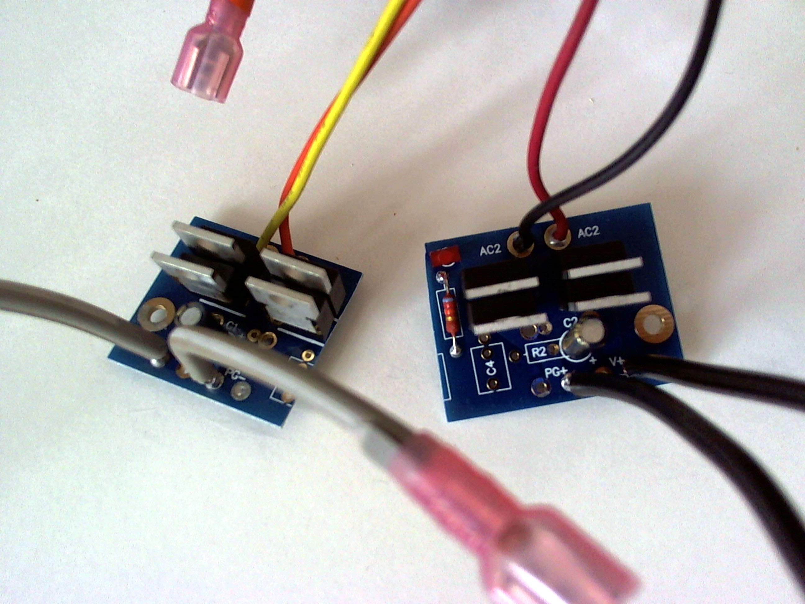

I had my wood box, now I needed to fit those PSU components in there... Opps, I would not have minded going a little bigger, esp on my first PSU build... ended up having to cut the rectifier board in half. I was lucky I could, as I could not "see" all the traces, but the multi-meter said it was a go, so...
I tested everything out before installing it in the box, and it worked! There is nothing as gratifying as seeing that little LED light up, on flicker in the bulb tester and no sparks!
It was even better once it was installed in the wood box
I do have a metal case that will wrap around the top bottom and sides - I am hiring out that part as I do not have the tools to do that well.

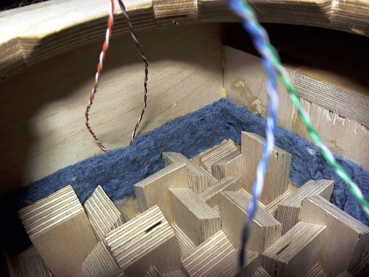

Hi there: Noticed in the last open picture through the driver hole numerous blocks of wood. Could those blocks be reflecting various frequencys that are clouding the mid range sound? Often sound deading material is placed behind the driver to prevent reflections back through the cone material. ...regards, Michael
I have a lot to share with you today...
But then I heard the midrange... Have you ever had one of them dry oranges, it looks like an orange, smells like an orange, but you eat the slightly shrivelled up insides hoping for that rehydrating juice and it is not there! Oh my, maybe I should have stuck with open baffles!...

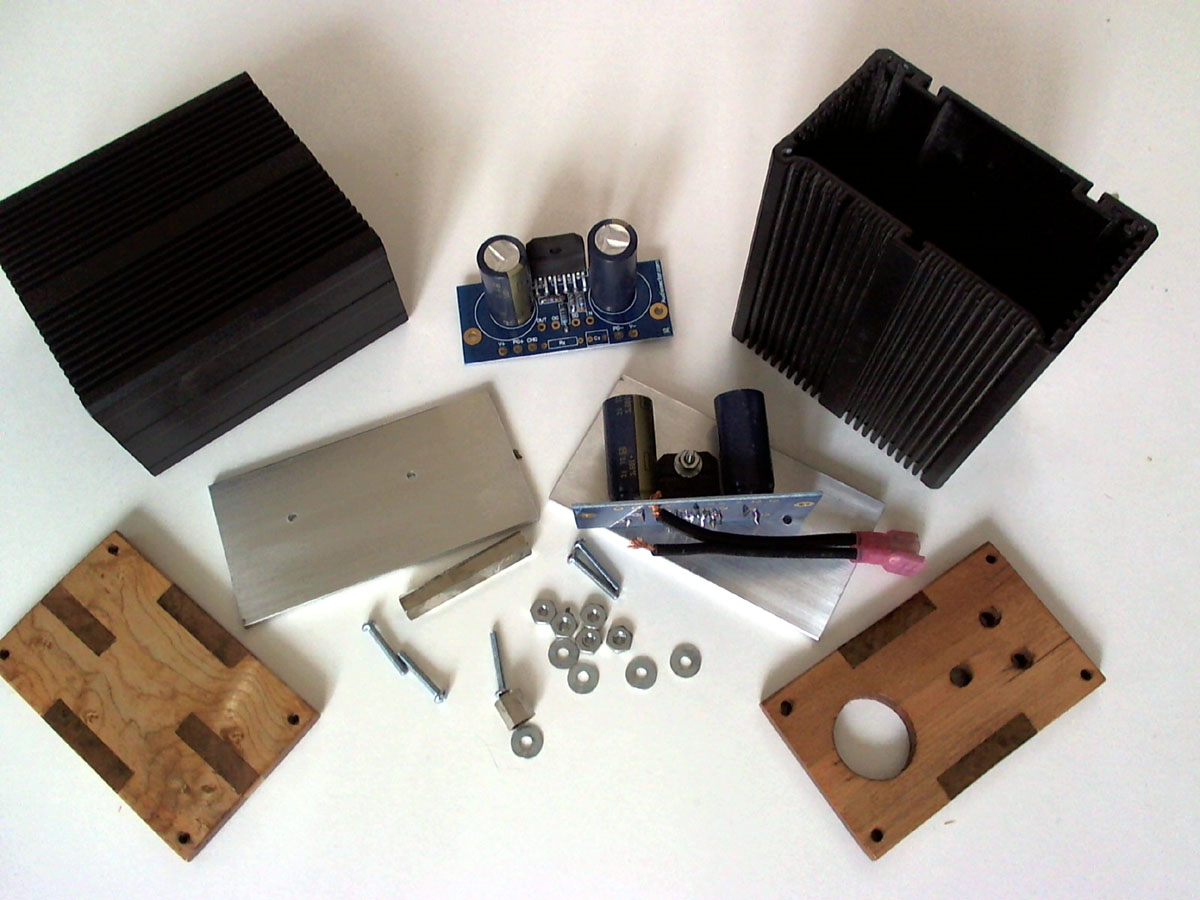

Now the amps

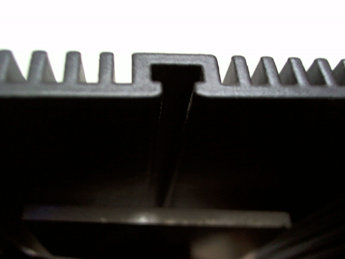

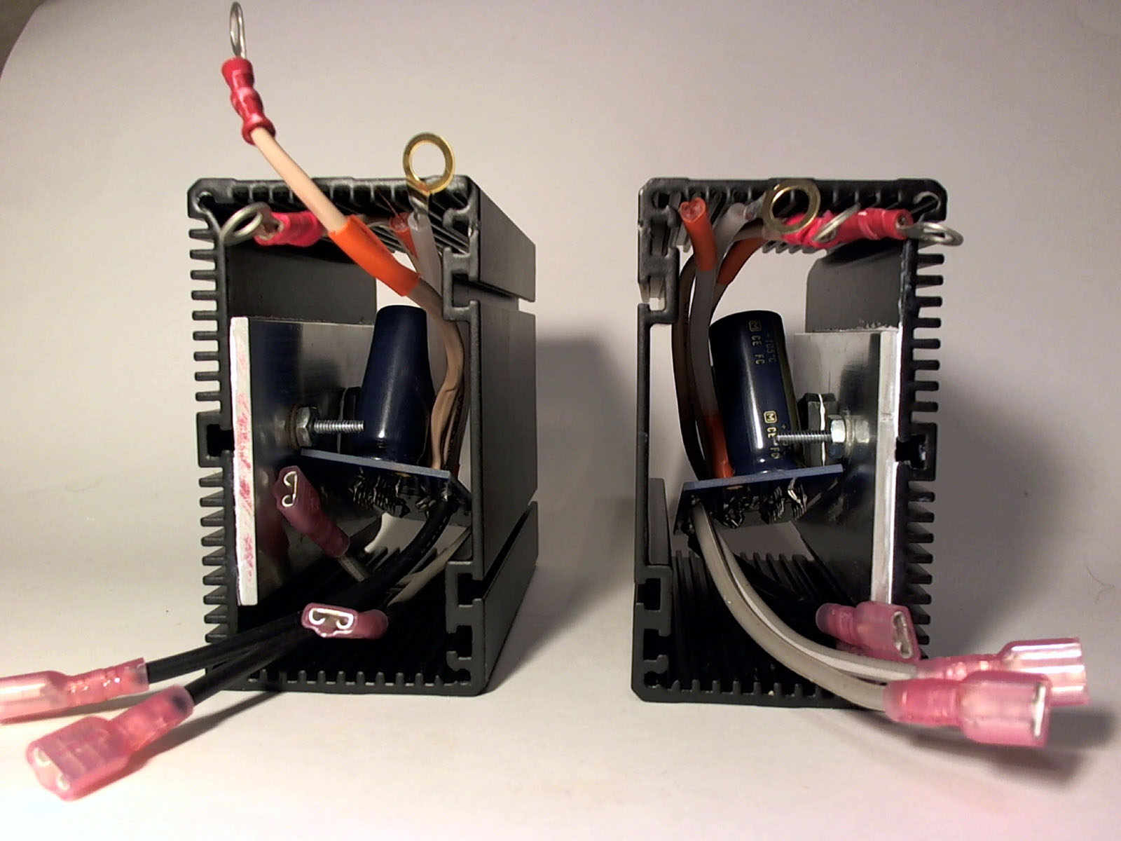

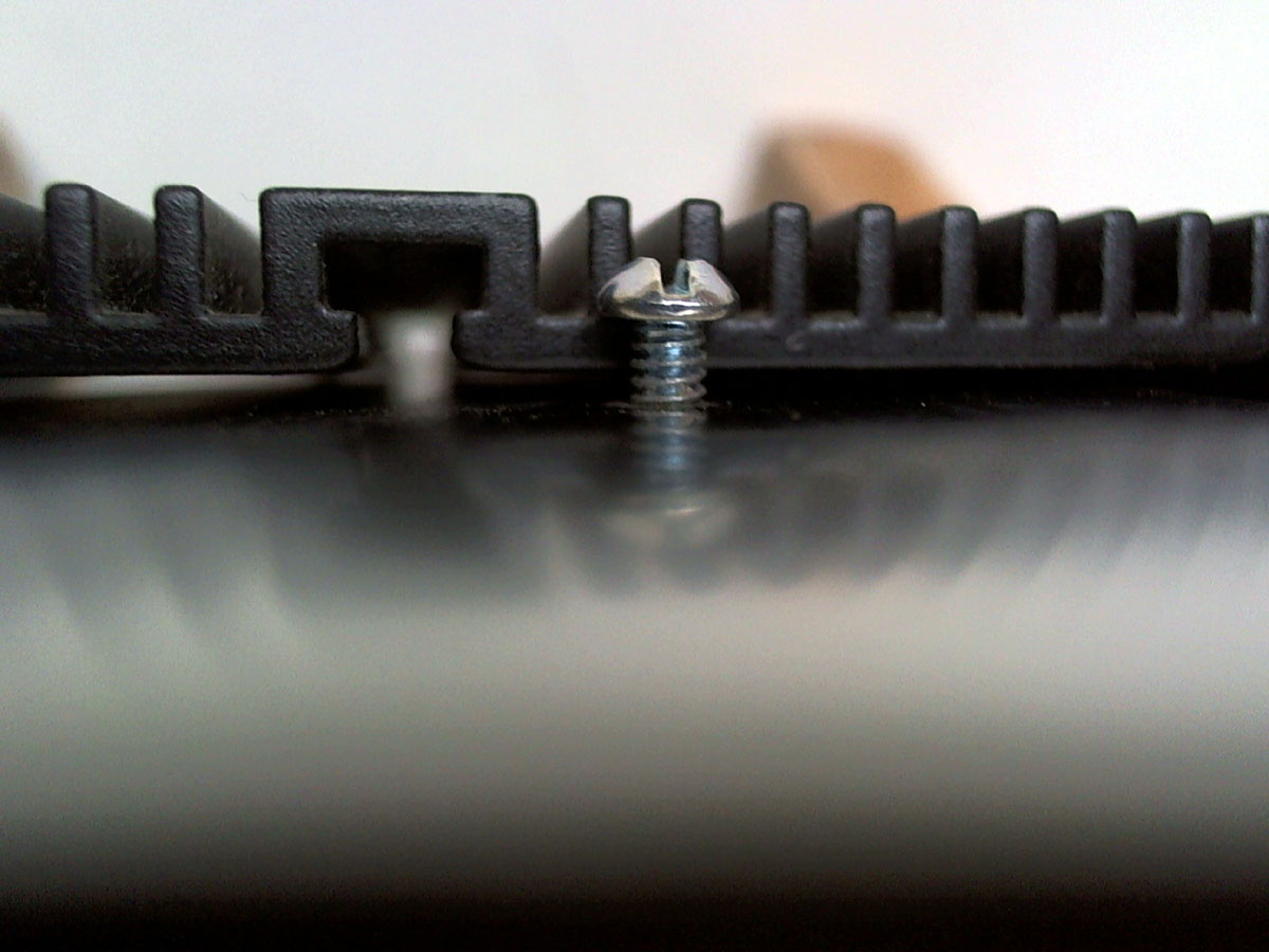

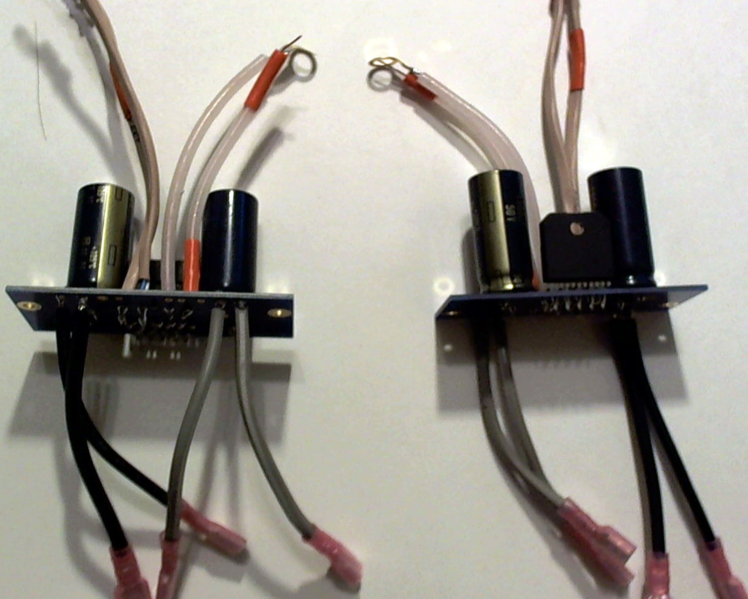

I ordered the Penn-Elcom Heat Sink boxes for the amps. These are some well manufactured products. You can order fronts and backs also, but I didn't becuase I was using the wood. I tried several types of screws with these. The #4 machine screws held in two of the 16 holes (4 per panel) and the medium thread were no better. The #6 machine screws I had broke while screwing them in, but these where "gold" colored screws, made out of cheap metal. The best screws where #6 medium thread 1" length screws. I would like to find better looking ones then the silver colored ones I used, but these did not brake. The picture of the wood panels screwed on the cases are on a later post.
These pictures show the grove you can use in these cases to bolt down the chip. I also cut a piece of alumium because I wanted the whole chip to have contact with metal (without a groove down the middle). The #4 machine screws I had fit down this groove well. I shopped around for a nut head screw that would fit this groove, but no one here had anything. I had to add solder to the screw heads to prevent them from spinning around while I tightened the nut to bolt the chip and alumium down to the case. I used thermal paste on both the chip and alumium. I am amazed that I did this without making a mess. The cost for all this was a lot of figuring time. Designing custom cases requires creativity and time... I am really glad you all have patience!

Okay, after many hours turning into days of threading screw holes and mounting hardware, jacks and crimping wires, it came time to solder the signal and power wires to the boards. Actually, I had the wires on before I moulted the chips to the heat sinks cases.
PSU tested out perfect, now time to plug in the amps and test the DC off set. A little high with no load, but the bulb did not light and there where no sparks. I can not believe how excitingly nerveracking (in a good way)this simple circuit is. The last photo shows my JVC Hi-Fi Stereo VHS machine that recently bloke. Look at the board in that thing, and it has worked, stills works faithfully to this day since 1990! It is a mechanical problem that I am not willing to fix, time to upgrade to blu-ray. Anyway, I digress...
Do you know the elation you feel when you plug an input signal into an amp you built from a kit in a custom designed case and it produces clean music thru your test speaker... then you have the chance to experience it again with channel 2!![heartbeat :hbeat: :hbeat:](https://files.diyaudio.com/forums/images/smilies/hbeat.gif)

Now it is time to install the denim product. I am thinking at this point if I had it to do again, I would build the amps first!
So I cut the denim to fit in the gap between the disfusion assembly and the back chamber walls. The big piece goes in front of the disfusion chamber and up the rest of the sides to the horn throats as per Dave's instructions. I tacked this in with small dabs of wood glue in case I want to change it later. This denim product was very agreeable to work with. I have not installed any fluff into the horn throats yet, i want to hear it raw first... which brings us back to the dry orange...
My thoughts where the same as micheal's and Zman's, they need more time, oh God! More Time! Aghhh!... yes, deep down I knew that! This project has been all about Time, so much time, and carving out more Time from nothingness and still needing more, so much more! Overtime at work. Artwork to create for ChristMas presents, hand made cards to 64 people, brownies and big dinners. I absolutely Love it! That is what makes the journey so great! I am so glad I can share the joy and tribulations with you all out there. But there is more...
Okay, so begins the breaking in process. Alpair 12s unbaffled, playing classical music at a low volume level thru completed chip amps still hooked up to the bulb tester...

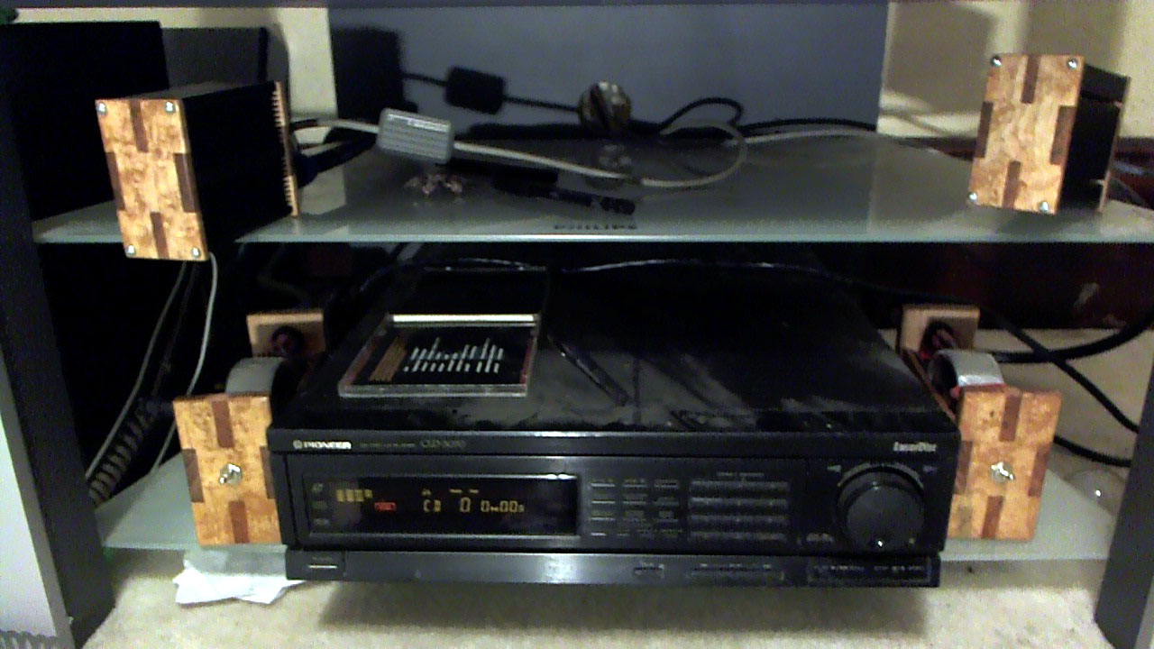

I have not built my light speed yet, but I decided to hook-up my laser disc player to my TV which has an audio out... Okay, sounding better, now more like rubbing my hand across a nice thick rug that needs to be vacuumed. I also could try my PC thru the HDMI hook-up, and actually that was better then the mother board. TV adds hum and noise, but I can minimize it with the visualizer in I-tunes.
Discovery #1: DAC matters. What is better, HDMI - Philips TV DAC or Pioneer CLD-3070 DAC?..
Now comes discovery #2...
The pioneer has more gain, and I forgot to lower the volume on one of the comparisons. No, I did not blow the drivers, I instead got a light show form the bulb tester! What surprised me with this, is the song I was playing was just vocal and paino, but when Emma was belting it out, the bulb lit. That bulb tester is the coolest thing! I have read that this is a normal occurance. I also noticed that when the bulb lit, my rug get dirtier! So I pushed the bypass button... like a vacuum - the dirt gone. Out come the bulb tester, I am present, so I can keep an eye and ear on the amps... They have been running fine since and the heat sinks seem to be sufficant so far...
Sounding much better, the war of the DAC's continue:
-1- Mother board is the quietest (I know that is hard to believe) And has the deepest bass, but it is the lifeless of them all.
-2- HDMI thru Philips - noisyest, has something to do with the computer to TV interface, it even affects all the other inputs on the TV when the computer is on. But this DAC has the silkyest high. Soundstange is confined to the front of the room to between the speakers.
-3- Poineer CLD-3070 - as noisy as the HDMI when the computer is on, as quiet as the mother board when off. The highs have less resolution. This player is from 1991. I was not kidding you when I mentioned that I was starting this system from anew, look at my VCR above!! Anyway the nice thing about this DAC is the Sound stage extends to the sides of the room and sneeks a little bit to the back. I would like more in the back but maybe the light speed will bring that, along with more break-in.
-1B- I tried the mother board thru the TV also (PC volume all the way up) It sounded better, but still not as good as the HDMI. Sound stage is almost mono on this set-up.

Out come the cat-5 wire. I still had the zip cord test wire in place between the amp and speaker. So I set up one run of cat-5 for each side, that is four strands per connection. Hang on Dave, I am getting to that... This fixed the problem! This is when I realized that these speakers can produce a soundstage!
Discovery #3 - Wire matters! We all know this kind of stuff matters, but it is nice to prove it!
