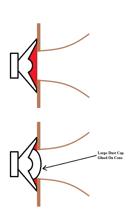

So front cavity compliance is indeed a driver property, which is what you target by adding the dustcap you propose.
You can try to replicate what Avantgarde Acoustic does. They add a large dust cap to the cone of the driver to reduce the front chamber volume. Of course there is a mass penalty to pay, but how much will have to be tested for.
This is a great idea! I wasn't aware Avantgarde did this. I thought of a phase plug, but never thought of this one.
Why a large dustcap instead of a phase plug, though? Not that I favor phase plugs, but they seem to be two alternative approaches of tackling a similar issue and wanted to benefit from your experience. Probably practical limitations for the DIYer come into play.
The dust cap is a lot easier. The results of a properly designed phase plug will be better, but a lot harder to execute. While I'm not 100% convinced, it is said that the dust cap shape will launch a spherical wave front instead of a flat plane wave. In theory it should match up to the throat of the tractrix horn really well.
Yes. It has also been said that a dome will radiate a forward moving wave which resembles a spherical wave in shape only at the start, that requires the horn to tease it out.While I'm not 100% convinced, it is said that the dust cap shape will launch a spherical wave front instead of a flat plane wave.
