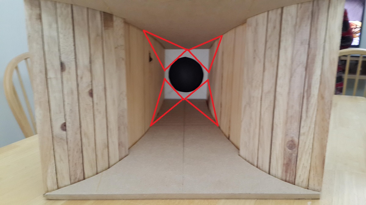

I agree with the suggestions about the throat being too large. I would recommend the throat be made square and such that the side walls are the same width as the cone opening. Then fill the corners to make a smooth transition to the rectangular mouth. The dust cap will add a negligible amount of mass to the driver. When I've build similar horns, I go into it knowing I might trash the cone of the driver if it doesn't work out. However, the knowledge gained far out weights the cost of a recone kit. Recone kits aren't that expensive.

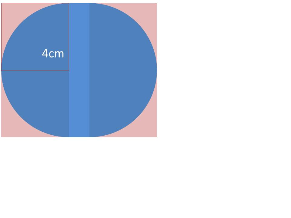

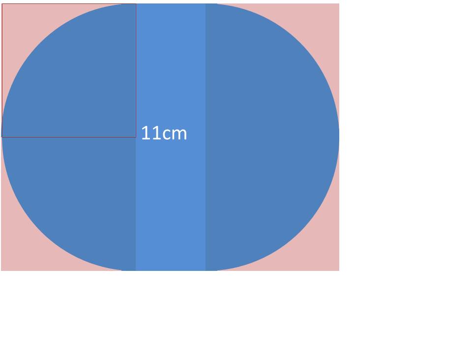

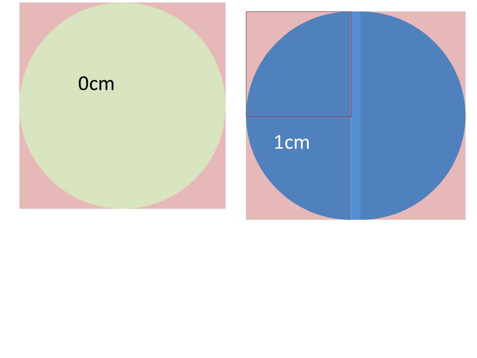

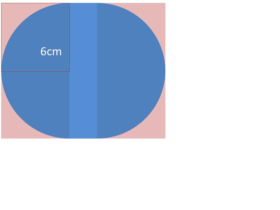

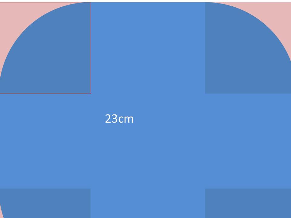

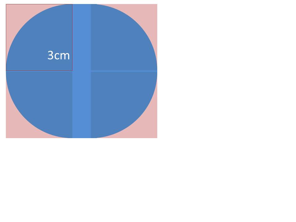

Not sure if I'm making myself clear about what my plan is. The plan is to fill the angles along the first 23cm of axial length with a filler such that the white plate will not be seen anymore, except for a 1cm wide ring around the throat.

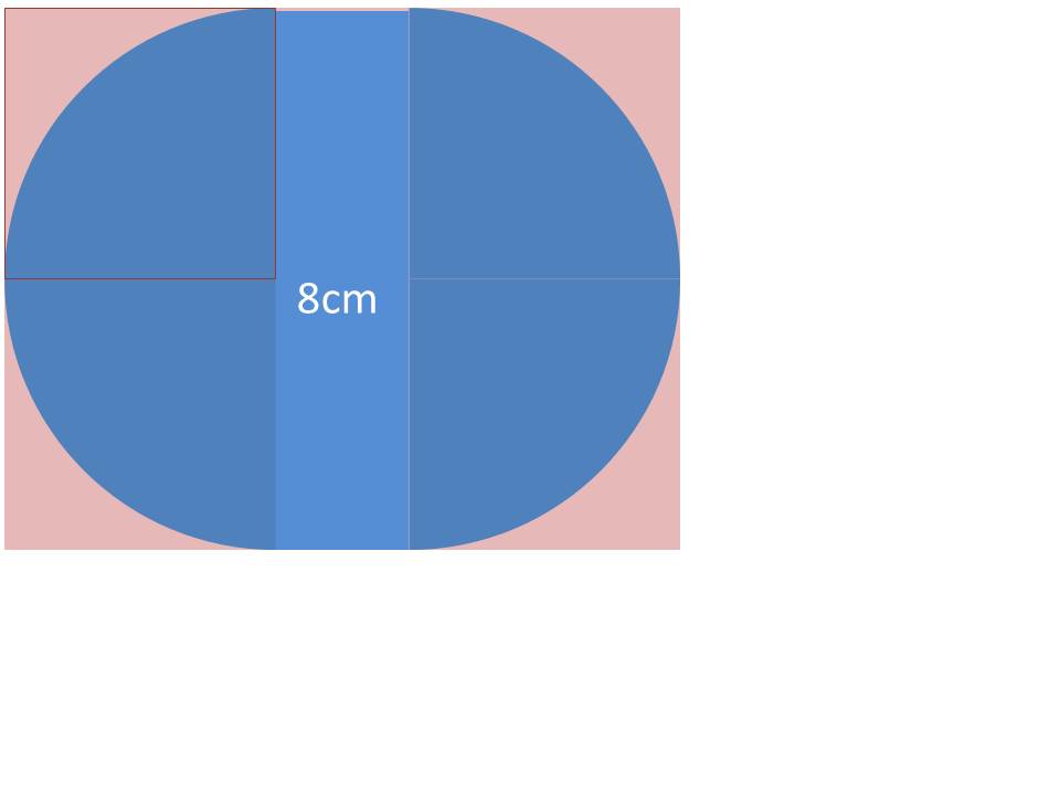

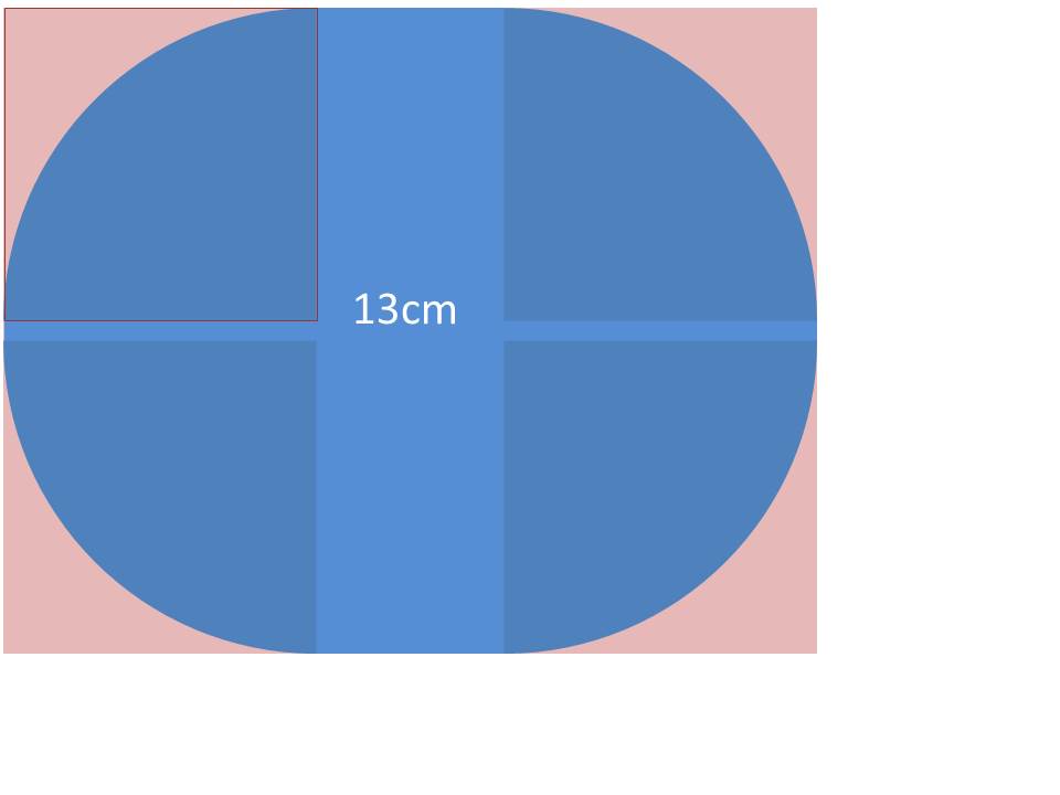

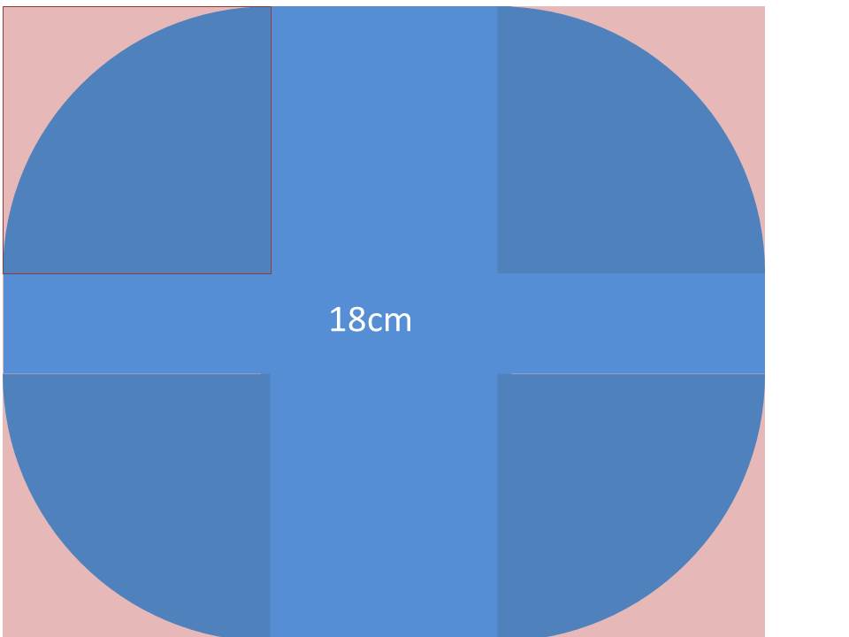

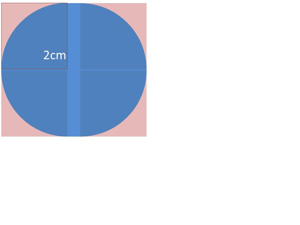

I'm attaching a schematic of the cross-sections every 1cm along the axial length. The blue area is the horn cross-section. The red is filler, and the rectangular edges around it are the edges of the wooden horn you see in the above pictures.
At 0cm, or S1, it's painted green because that is a circle. That circle is 94.2cm2 (same as Sd), or 11cm diameter. The white plate seen in the pictures above has a 9cm diameter opening, thus the 1cm ring one would see.
What do you think? Am I on a bad track?

Lewinski,
That looks like the very first horn throat I ever did with hand calculated math for a round to square transition. If you are using the inside of the surround as the Sd dimension what I will predict it that the surround will slap the back of the horn mounting flange. You will need to make a spacer ring to fit between the back of the horn and the frame of the driver to keep that from happening. Been there, done that!
Yes, I noticed you mentioned this before and I'm keeping it in mind. I have a hard time understanding how could that happen when the distance from surround to back of the mounting flange is smaller than the driver's Xmax, but since you've been there I'm going to keep my eyes open.
Somewhat related, I'm more concerned with the dustcap hitting the 45 degree cutout, as it is close to Xmax. Still, per the simulations the driver should never come close to Xmax, but...

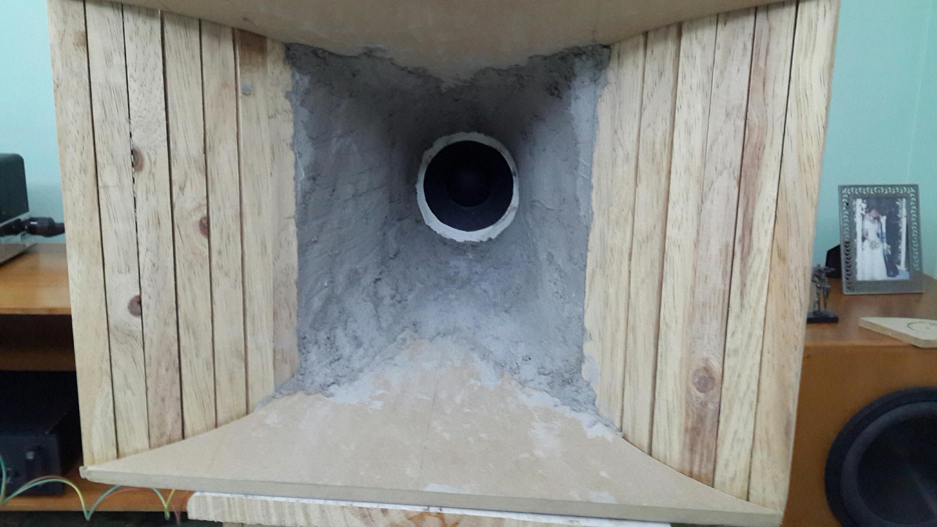

I was able to make some progress with the new horn iteration. To summarize the horn design:

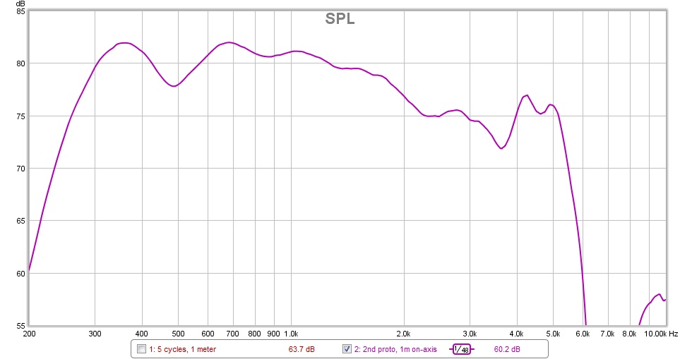

You might recall I got a dustcap to afix to the cone, yet these measurements are without the dustcap. That will be a next step. I first want to draw conclusions from this trial.
What do you think?

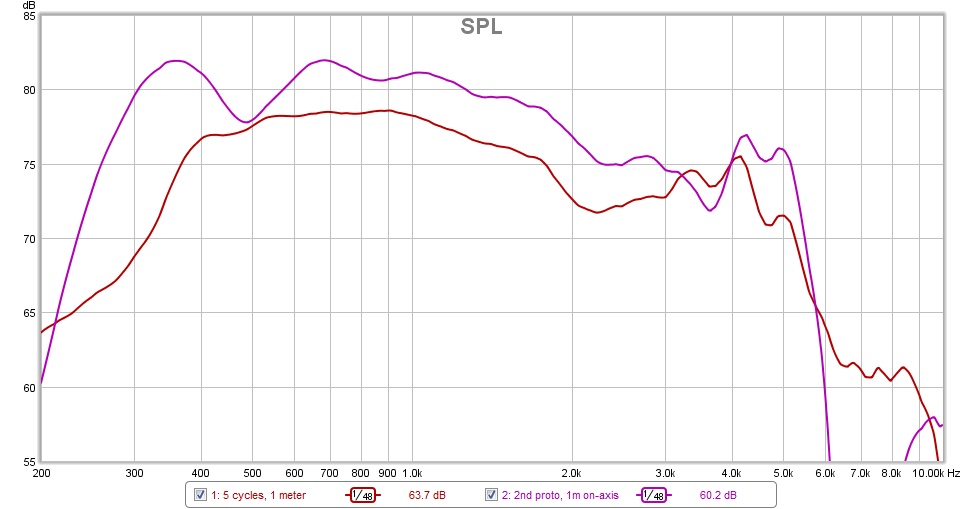

I'm thinking above about 1.7kHz both performances are equally poor. Of course this is what the dustcap is supposed to improve. My takeaway is without a dustcap I might be OK crossing over at 2kHz, but not higher. Also worth noting is the cement job didn't do much in this region, which is the region where it could have had some impact.
The lower end is puzzling. The wood horn reaches lower much better than the foam horn, but displays that wide valley centered around 480Hz...puzzling
FWIW 480Hz has a wavelength of 72cm...shorter than the height of the driver to floor...half a WL is 36cm vs mouth width of 33cm...I don't know. I'm shooting in the dark.
What do you think is causing the dip centered around 480Hz?
- The goal is to cross it over somewhere in 400-500Hz and 2-2.5kHz.
- Based on learnings from the foam prototype above I reduced S2 and introduced the white flange to reduce Atc, while keeping S1 large.
- On Hornresp I modelled a tractrix with F12=185Hz, limiting S2 to 1667cm2.
- Using a 1.5:1 length:width ratio and roundings of the corners such that the cross-section at any given point equalled that of an axisymmetric tractrix, I applied cement and used a piece of wood cut to the specified radius to get the roundings. Not too pretty, but should be effective given what I learned above.
What do you think?

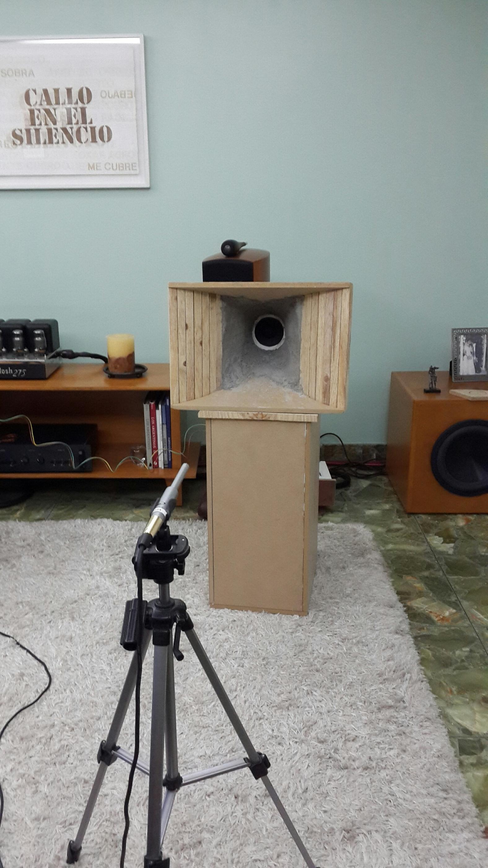

The peaks (of the wood horn response) might be caused by the lack of mouth termination in vertical direction. Without proper termination, there could be a standing wave between throat and mouth. Foam appears to be lossier, so peaks are also less pronounced.
My guess is that the valley at 450 hz is a floor bounce null mitigated by the absorption of the carpet. Good, heavy pile carpet with a relatively open back on a .5" felt pad can have an absorption factor of .57 but its hard to translate absorption factor into depth of null. Intuitively, if the reflection comes in 180 out of phase and at half the strength of the direct path, it will cancel have the direct signal resulting in a 3 db depression.
Initially I thought the same, but the math isn't backing up my reasoning: The driver and mic are 83cm from floor. The mic is 100cm away from the mouth, and the horn is 34cm long, so driver to mic is 134cm.
So the distance from driver to floor bounce and back to mic is 213cm. A 162Hz wavelength is 213cm, so an 81Hz is half wavelength at 213cm, and 40Hz is 1/4 WL at 213cm...but the dip is centered around 450Hz...where am I loosing it?

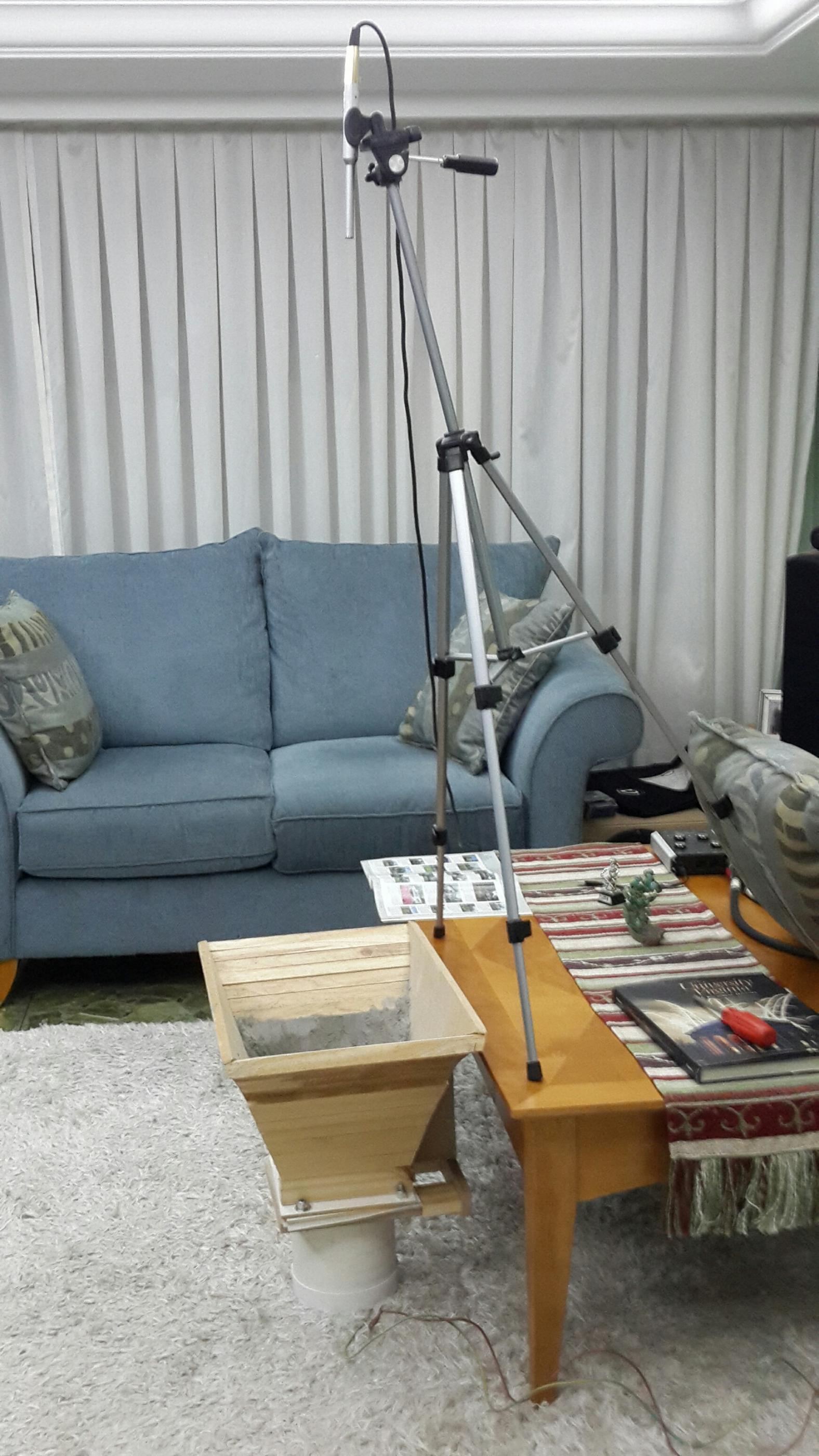

Lewinski,
Take the horn outside and point it straight up and place the mic above the mouth opening on a suitable mic stand. If the same response is seen it is in the horn and not from the environment. If you wanted to get anal about it you could dig a hole and place the mouth of the horn at the ground level and measure that. Another things you can do in room is move the horn vertically with the mic still on axis and see if the dip shifts in frequency.

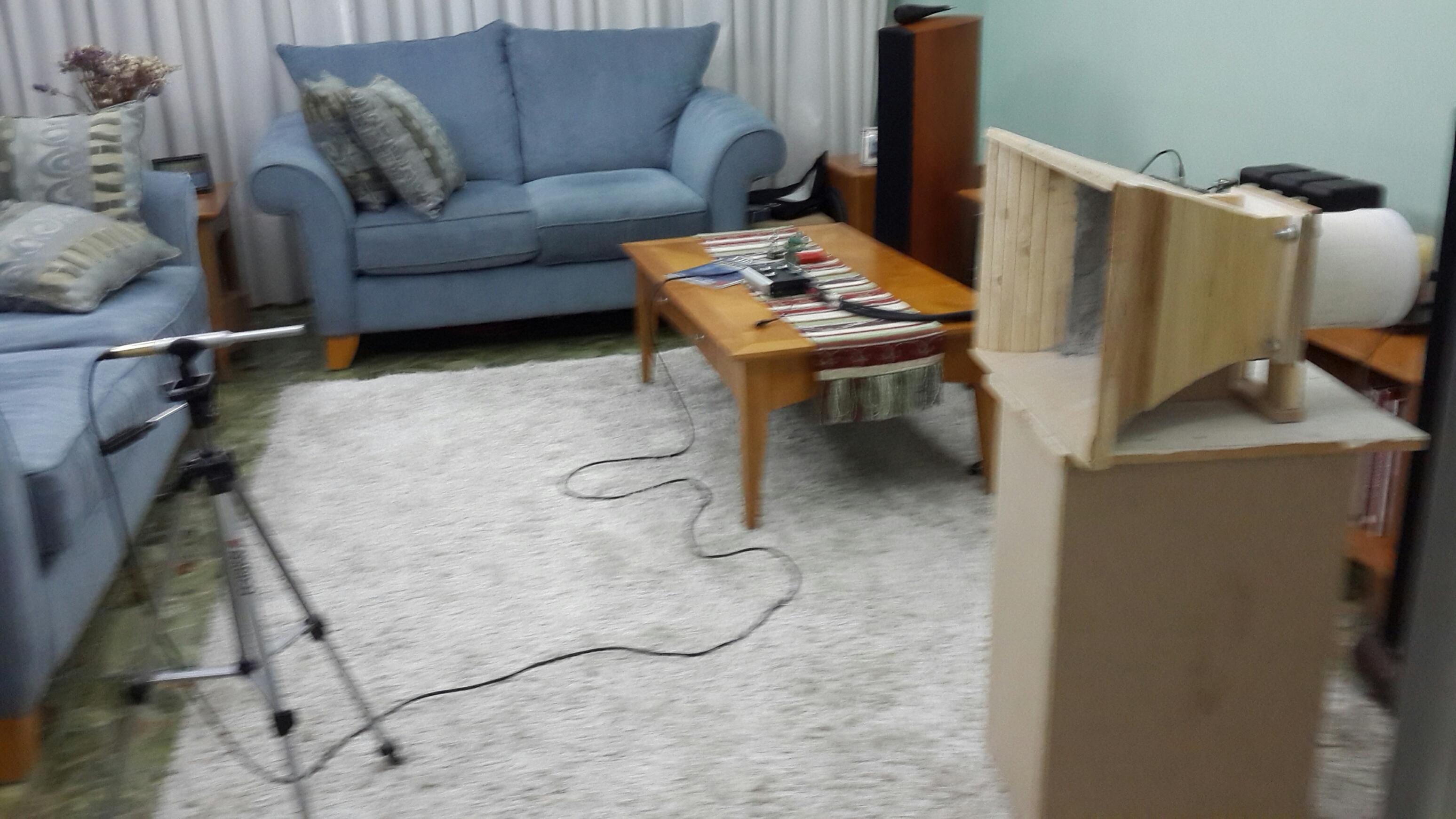

I like this idea! Taking everything outside entails a 1-hour drive each way...so last night I took a shortcut to verify directionally. See picture below. I placed the horn on the floor, pointing up, and placed the mic 1m away from the mouth. First reflection points are further away than before.
There is still a dip, but it has moved down in frequency. I'm guessing this suggests the dip is a cancellation from a reflection, right?
But how come the foam horn didn't display this?
Interesting experiment would be to go back to that first measurement setup and move the horn closer to or further away from the wall behind it; perhaps the same spacing you have from the floor in this picture.
My guess was going to be an axial standing wave between the throat and mouth termination (someone else suggested this too). It's plausible that the coffee table is modifying this. This measurement also adds some weight to the thought that it isn't the room.
A wild idea, what if you rest the bottom panel on the floor so the horn leans back and upturn the coffee table over the top panel?
