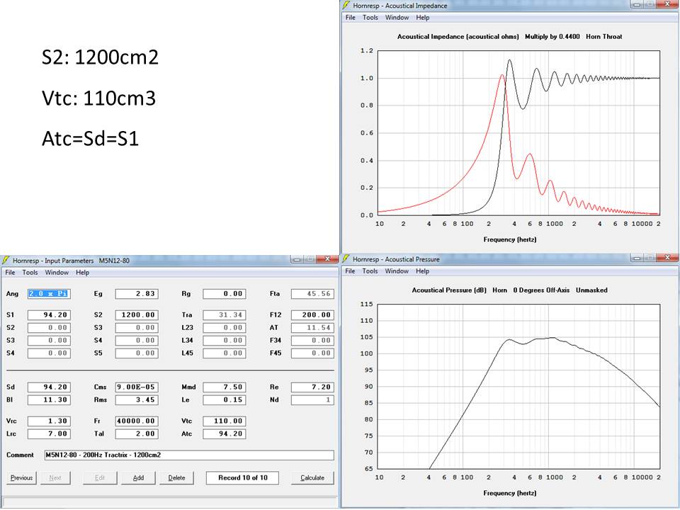

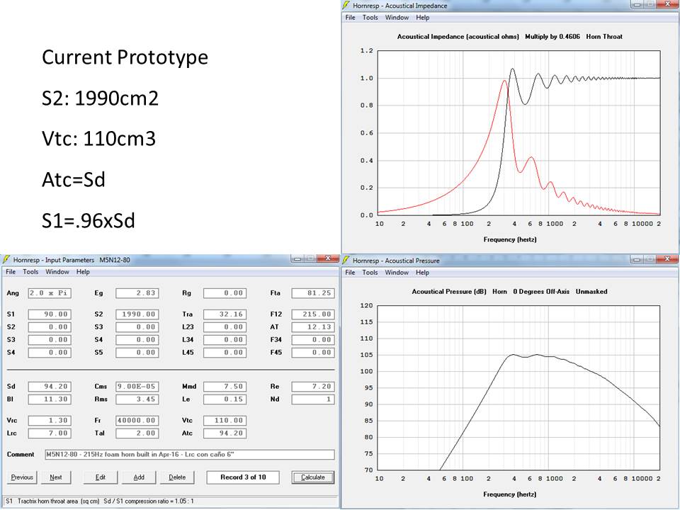

Mouth Size

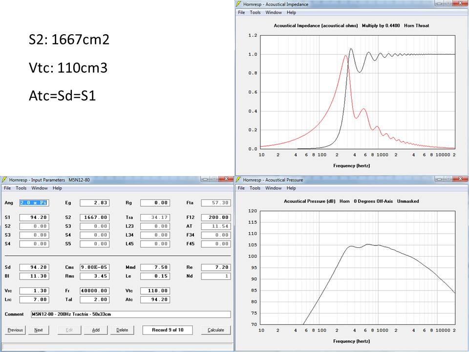

As the many inputs sunk in, I played around with Hornresp a bit more and I'm coming to some conclusions which I''d like to bounce against you.
Mouth Size
I learnt once you go beyond the minimum size, the trade-off with a smaller mouth is increased ripples in the acoustic impedance. And center-to-center distance to the tweeter is a compromise I will need to live with - and see if I can live with it once up and running.
The current mouth is 1990cm2 at 2:1 aspect ratio, leading to 63 x 31cm. A bit too wide for my living room.
Adopting a 1.5:1 aspect ratio seems to have some merit. Leads to a square S1, and seems a better approximation of an axisymmetrical horn. Plus some reports favoring this ratio.
Attached are 4 simulations:
On 2) the highest amplitude ripple happens at 475Hz. Since this crossover point is going to be active and very steep (like 8th order), and targeted at 400hz, it seems at 475Hz the response is going to be diminished already. The 1667cm2 mouth horn is looking like a good compromise to me. What do you think?
BTW 1667cm2 was chosen arbitrarily, starting with 50cm wife-acceptable width and applying 1.5:1 aspect ratio.😀

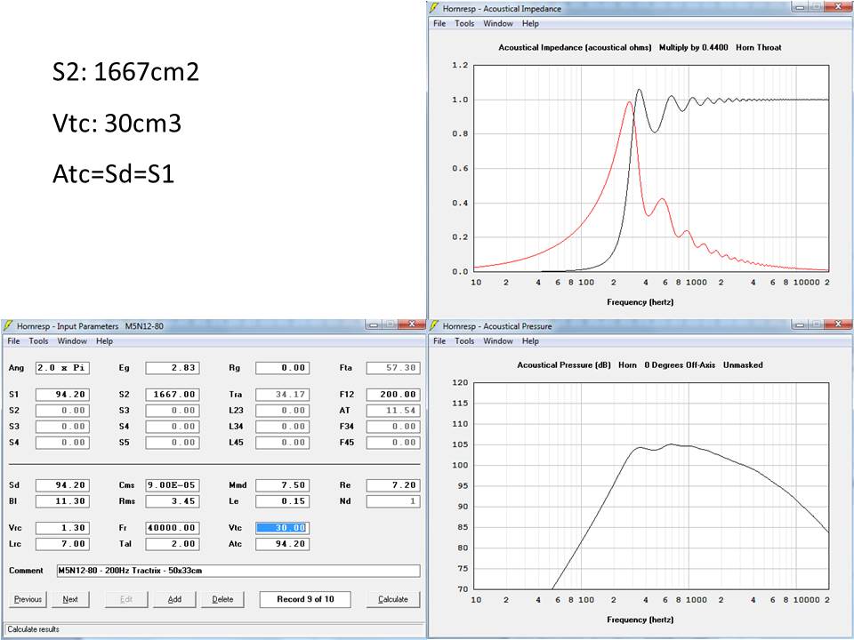

My attempt at modelling with the dustcap was just reducing Vtc from 110 to 30cm3. I was surprised to find almost no difference in simulated performance both on frequency response SPL and acoustic impedance. A 0.2dB lowering of the higher end response with 30cm3 vs 110cm3...odd isn't it?
- Current prototype
- Mouth at 1667cm2=50x33.3cm (1.5:1 ratio), without dustcap
- Mouth at 1667cm2 with dustcap
- Mouth at 1200cm2, without dustcap

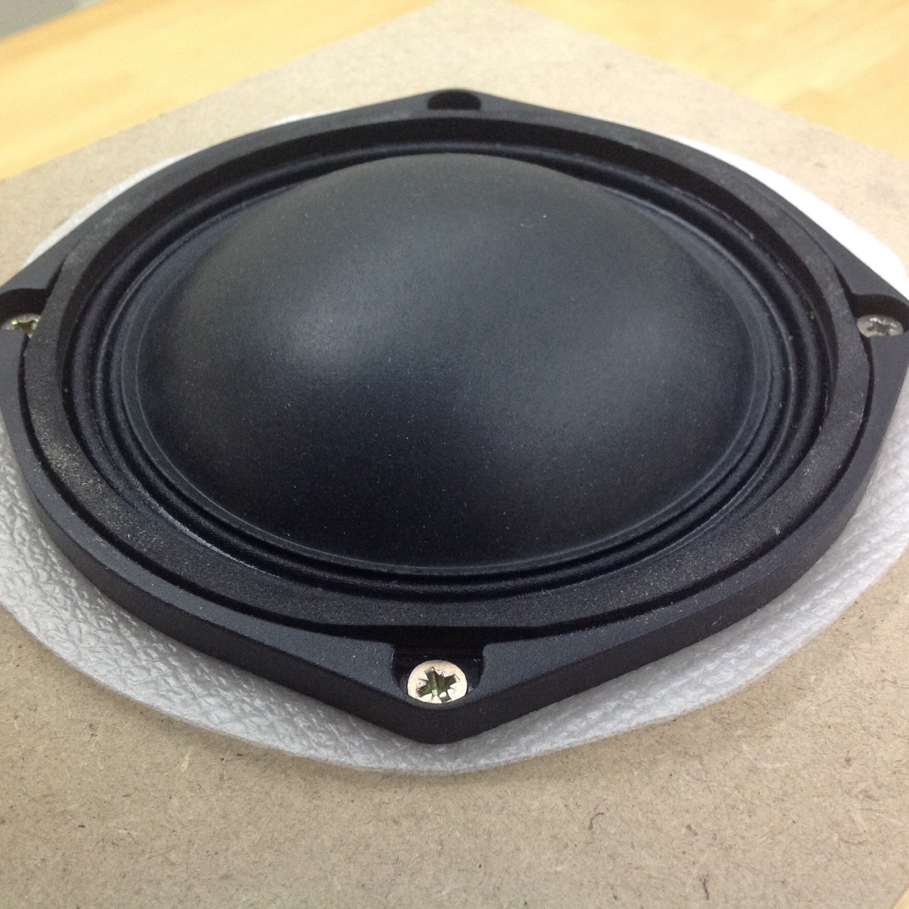

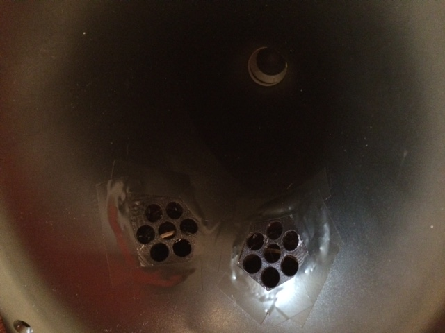

Would you happen to have a picture of the driver + dustcap + adapter assembled? I think I could introduce a variation of this concept in my next prototype.
It's hard to get a photo of the cone when it is installed in the horn as it is pretty deep in there. If you look, you will see the silver aluminum cone and a black plastic dustcap.

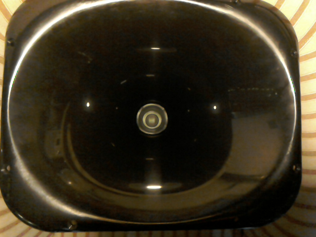

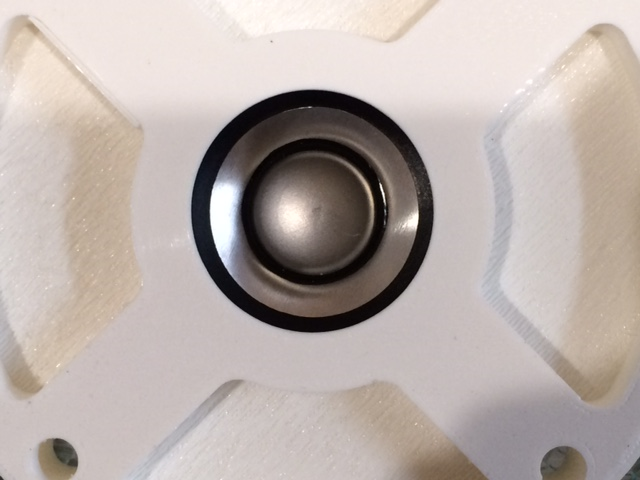

Here is a photo of the adapter and the FR58EX driver (did not work so well - aluminum dustcap rings too much):

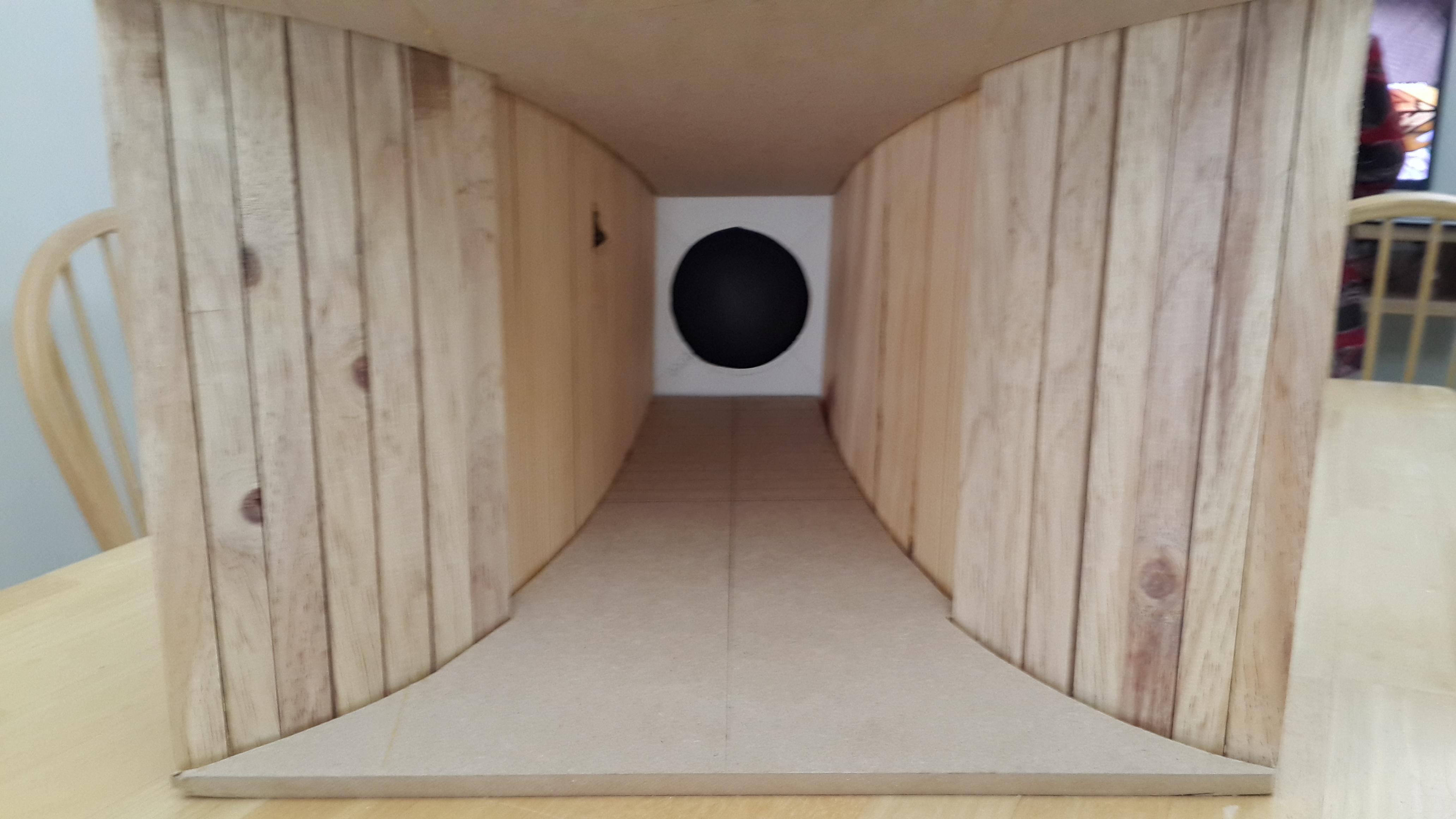

If you look down the bore of horn that Bushmeister made, you can also see the same driver with the black plastic dustcap:
Here is a closeup of Bushmeister's cone and throat adapter:
It was really Bushmeister who found that making a smooth adapter provided the smooth response - he did it the old fashioned way using Bondo autobody filler putty and elbow grease. He has a nice diagram of what it should aim to look like here:

Thank you.
I'm having a hard time matching the picture and schematic above. My understanding from the picture is the adapter edge is right at the internal edge of the cone surround. And the picture notes how close the adapter is to the cone, so somehow the adapter seems to be wrapping around the surround - like if the adapter had a recessed grove where the sorround fits. Tough to explain in words I guess. How close is the back of the adapter to the cone?
But the schematic shows the adapter finishing on the outside edge of the surround, hence contradicting what I said above. Could you please explain?
And the adapter also introduces compression and later expansion starts at the horn, right?

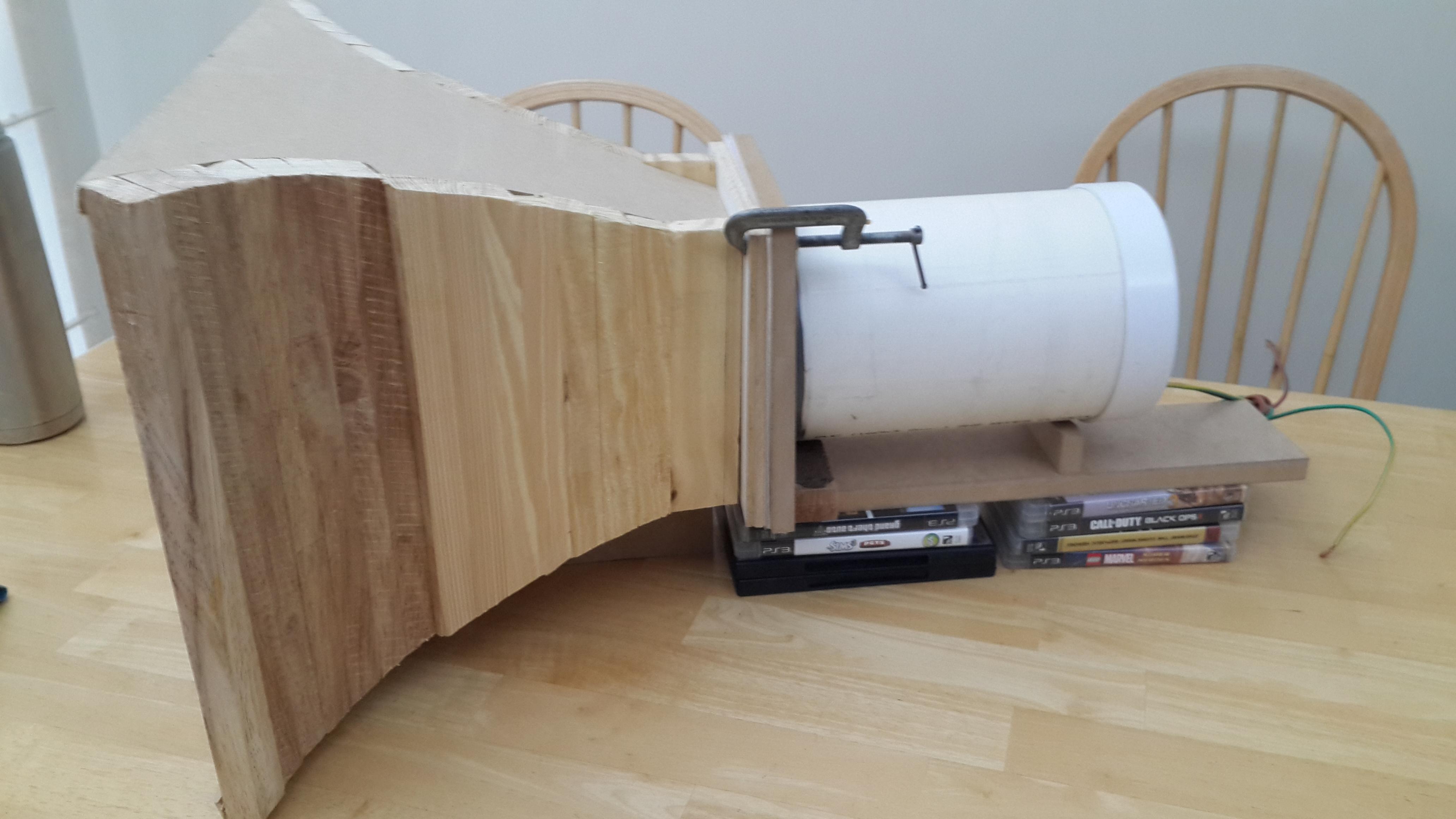

I'm also building another horn prototype with what I learnt here. Hopefully tomorrow I will be able to share where I'm at.

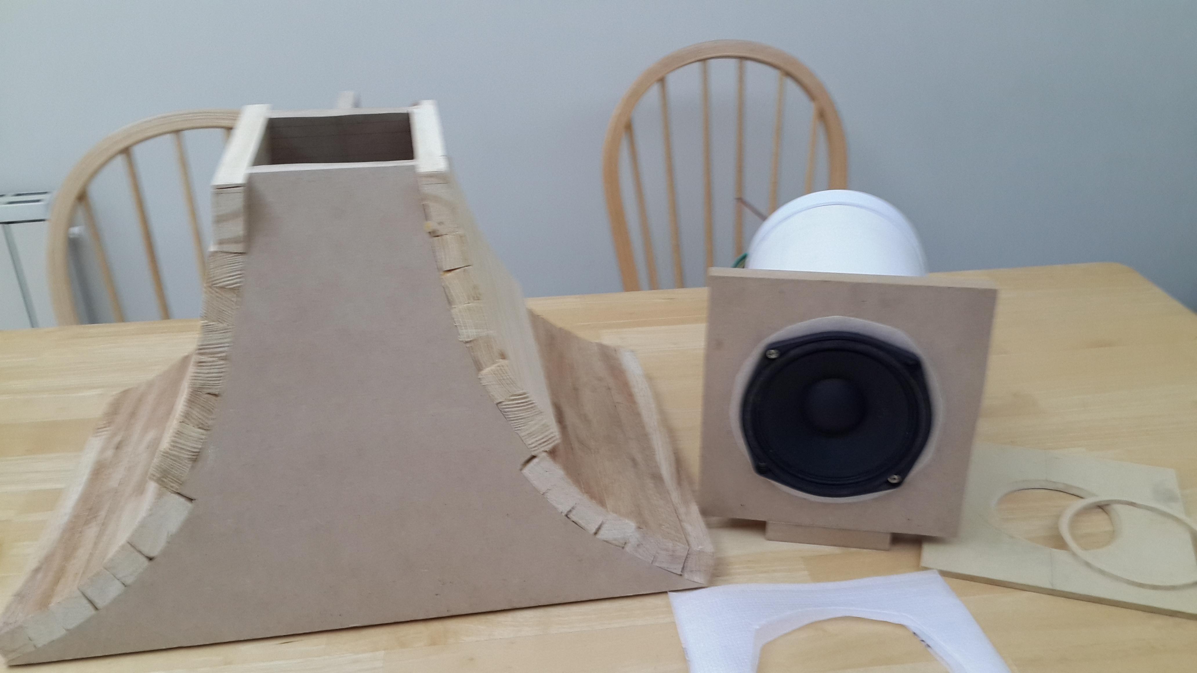

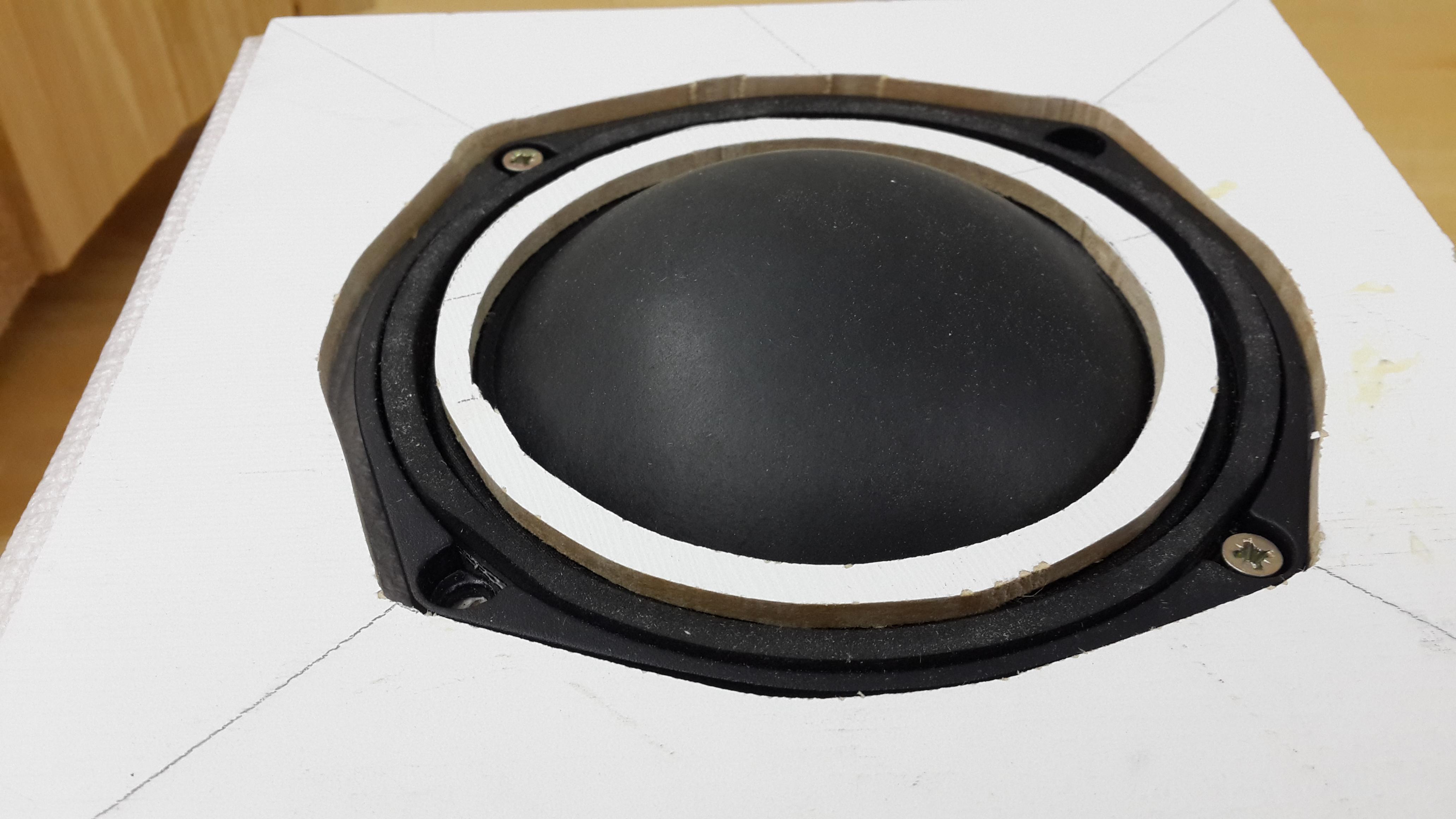

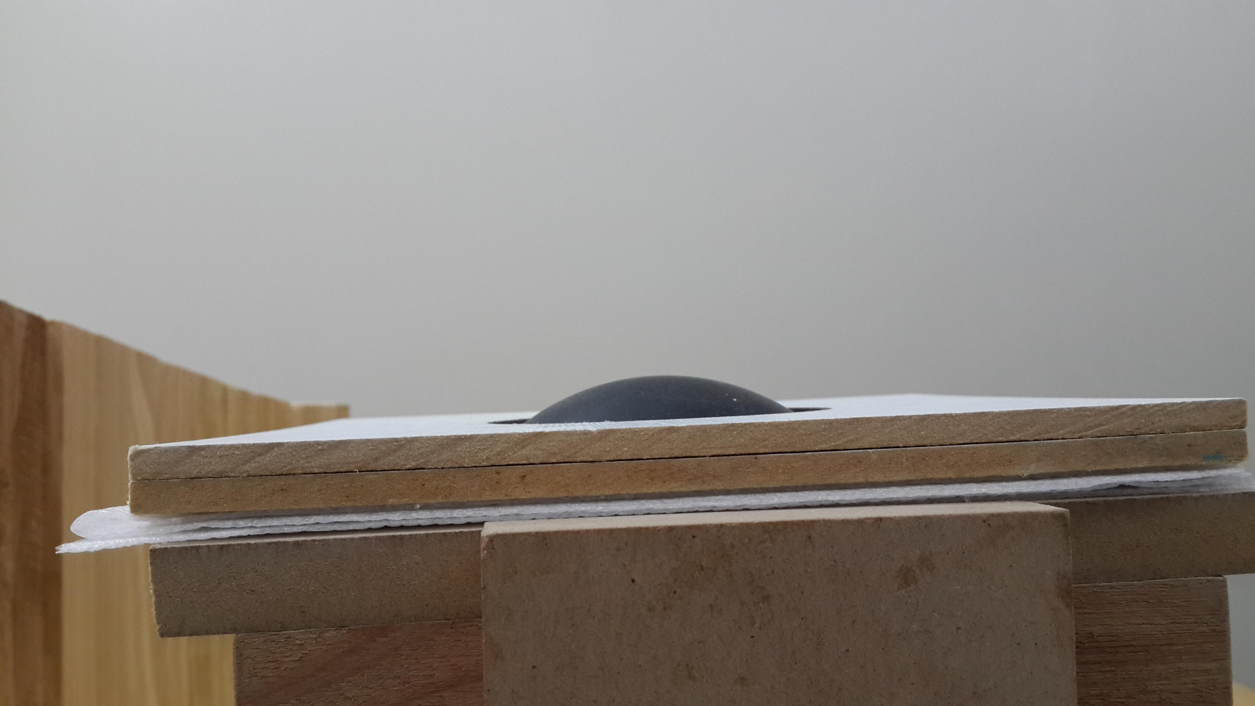

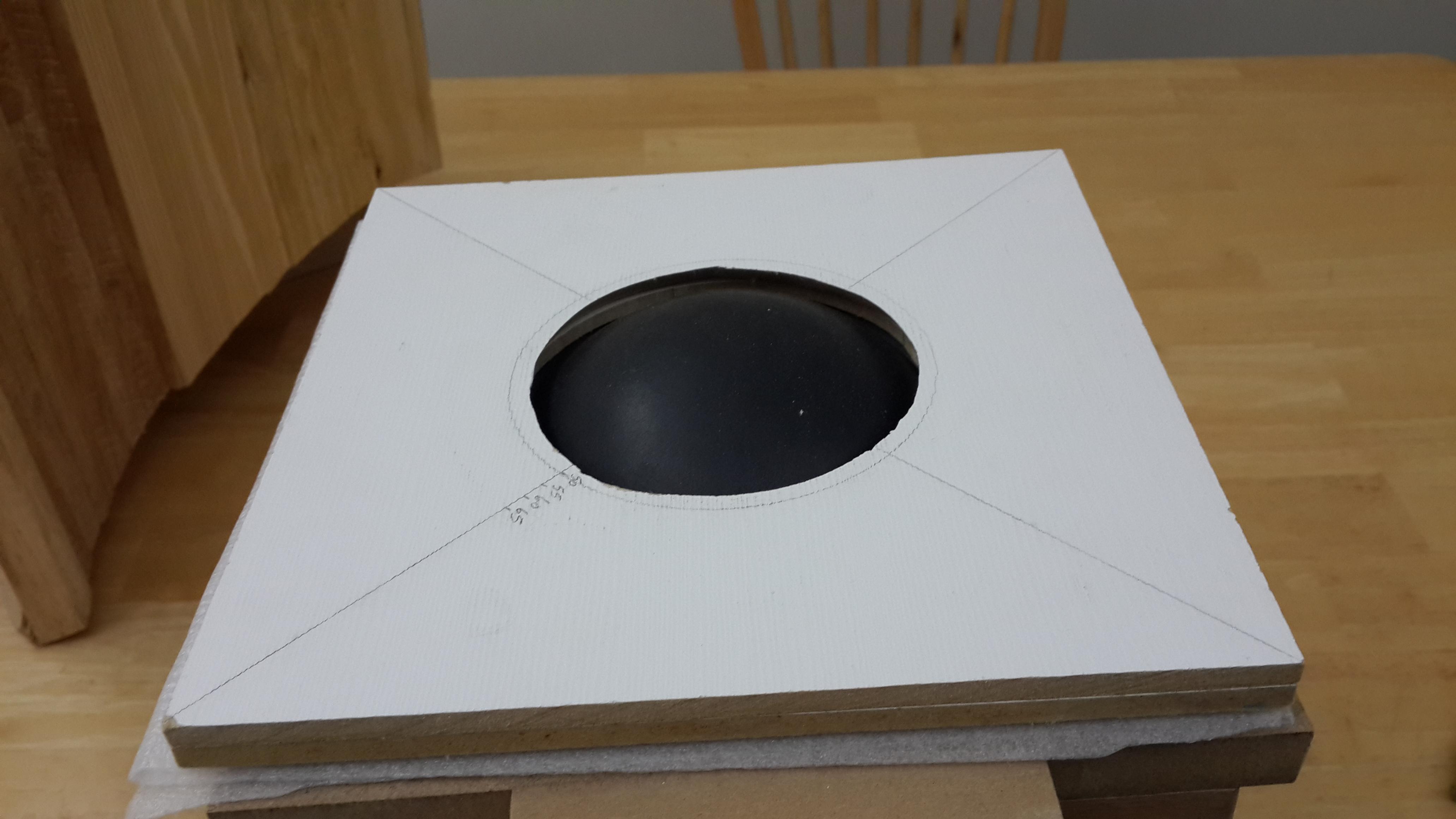

Here's an update of where I'm at, after the feedback I received here.
I'm building a smaller mouth horn (S2=1200cm2 vs 1990cm2 before), 1:1.5 instead of 1:2 before, and S1=Sd (before it was smaller). As before, fc=200Hz.
Stilll work in progress.

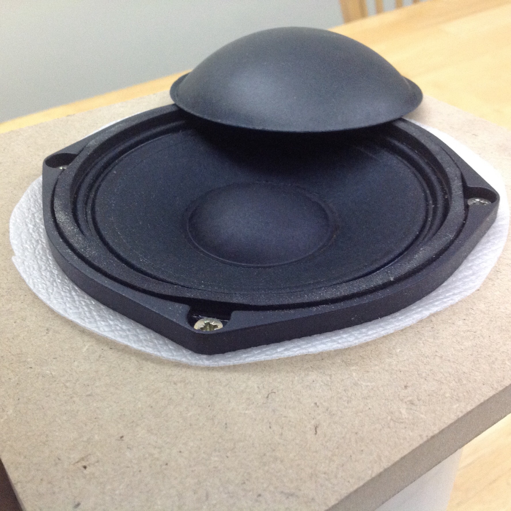

The other prong is regarding the chamber volume and throat. JLH recommended to add a dustcap, and I have the 4" dustcap I mentioned yesterday.
Attached some pictures of how I plan to implement it, for feedback.
I don't have proper tools, so used a jigsaw to cut the throat opening at 45°, 90mm diameter (3.5"). Not pretty! 😱
The white ring you see placed on top of the cone surround is to be glued to the top plate (throat) so to further reduce the chamber volume.
I guess after doing this S1 is not equal to Sd anymore and I should re-run the simulation.
Looking forward to your feedback!
Progress is good. A couple of things don't quite look ideal to me but more importantly how does it sound?
What are the things that don't look quite ideal? I don't know how it sounds yet as I haven't asembled it yet. I was asking for feedback before doing so, so to minimize mistakes.
And the horn itself still needs a lot of work.
But I'm interested in feedback.
I'm thinking adding the mass of that dustcap will lower the mass rolloff frequency.
So am I. But this was recommended by JLH, who is very knowledgeable, so it's a leap of faith on my part. Yet I don't want to make the mod a permanent one until I can try it.
The expansion at the throat after the baffle around the dustcap. I don't know what effect this is going to have on the extreme high end of the band. Thinking of the geometry, I'm unsure that the dustcap benefit will be fully realised.

Hi LewinskiH01,
Not sure about the S1, Vtc and Atc values.
Don't use the 4" dustcap.
The horn throat area appears to be larger than the driver diaphragm area. This is not good practice in a midrange horn as it results in a significant discontinuity at the throat.
Kind regards,
David
